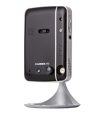

Offline upa
  • Full Member
  • Posts: 112
Re: My 15.75 x 30 Jemez Cabin
« Reply #1393 on: March 22, 2015, 07:12:52 AM »
Don
I have been running  a Lorex IP camera for this past winter and its been the bomb for letting me know what is going before I get there. Its nice because it also has motion and PIR sensors and can act like a security system and uses push email notification when it picks up something. I keep a 32 gig micro sd card in it and acts like a DVR and roughly runs 6-7 days before it starts to rewrite itself with new video image data. I use an android app on my phone to see real time video. When I use the lowest image setting for transmission its very thrifty on bandwidth.  The Sierra Wifi hotspot hub I use also connects my Wifi thermostat. I have a pay as you go arrangement for data, its a stepped usage plan, $5/month base buys you  a measly 10 meg and $10/month gets you 100 meg , and up from there. During the winter I have never exceeded $10/month with my frequent calls up for real time video. In the summer I rarely get charged more than $5/month. From a power perspective the camera and hotspot use only a few watts concurrently. The only problem I came across was that the hub has a lithium ion battery that refuses to work once the temperature drop below freezing in the unheated house. I ended up making a insulted enclosure out of a cardboard box/foam to house the hub and included a 10 watt aquarium heater in a sealed water filled quart mason jar. The heater turns itself off once water temperature reaches 25 degrees Celsius. This adequately  kept the interior of enclosure warm to keep the hub alive the last 2 winters and maybe uses 50 watts in a 24 hour period on very cold days.
Offline hpinson
  • Administrator
  • Senior Member
  • Posts: 850
« Reply #1394 on: March 22, 2015, 08:44:46 AM »
The last post is invaluable. Thank you UPA, for that.
Offline MountainDon
  • Administrator
  • Journeyman
  • Posts: 16,845
    • My 15.75 x 30 Jemez Cabin
« Reply #1395 on: March 22, 2015, 02:11:25 PM »
Way cool upa!    Thanks very much!
