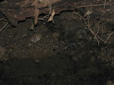

Here is the spring as it has unfailingly come from the mountain since forever as far as I know.

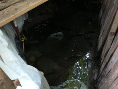

How fancy is good enough for a spring box?
Well -- maybe not perfect but no one has died from it.  Never even got sick from it. :)
