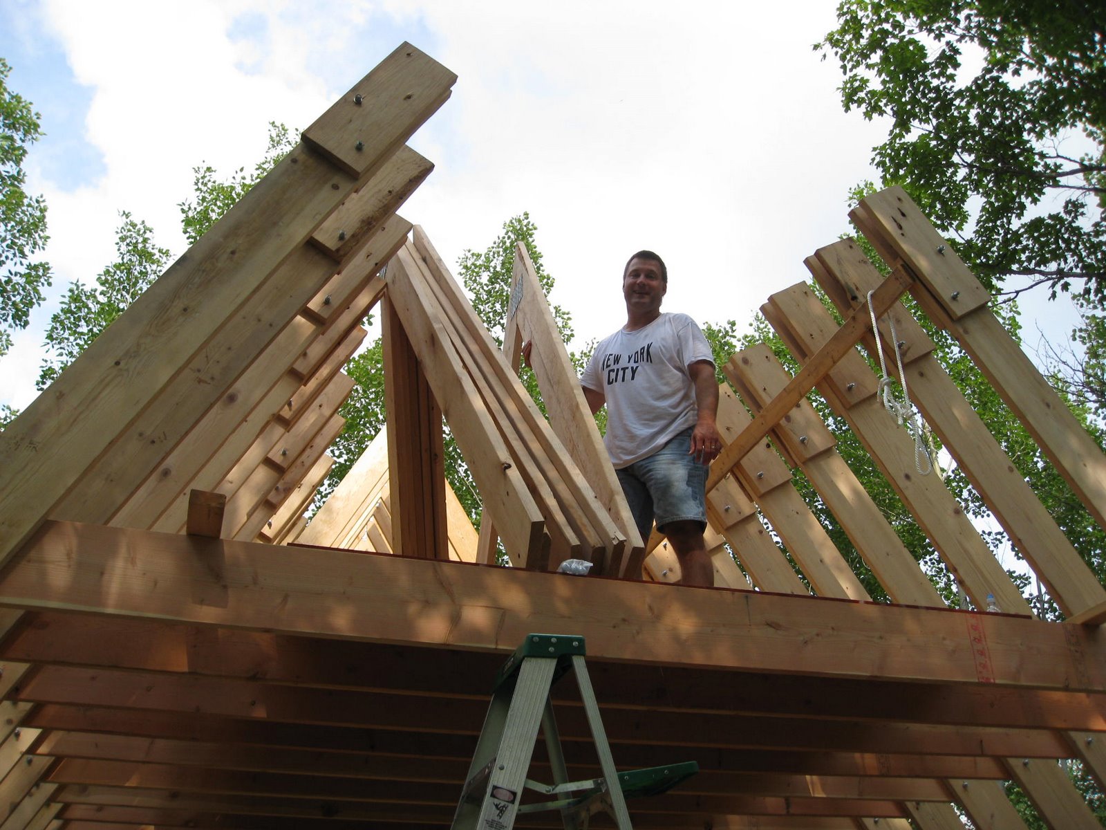

Seeing the post title and that pic pop up my first thought was "too late to ask questions now". Glad that isn't you.
Yes that weakened it.
Need some dimensions/rough sketch to determine member dimensions.
