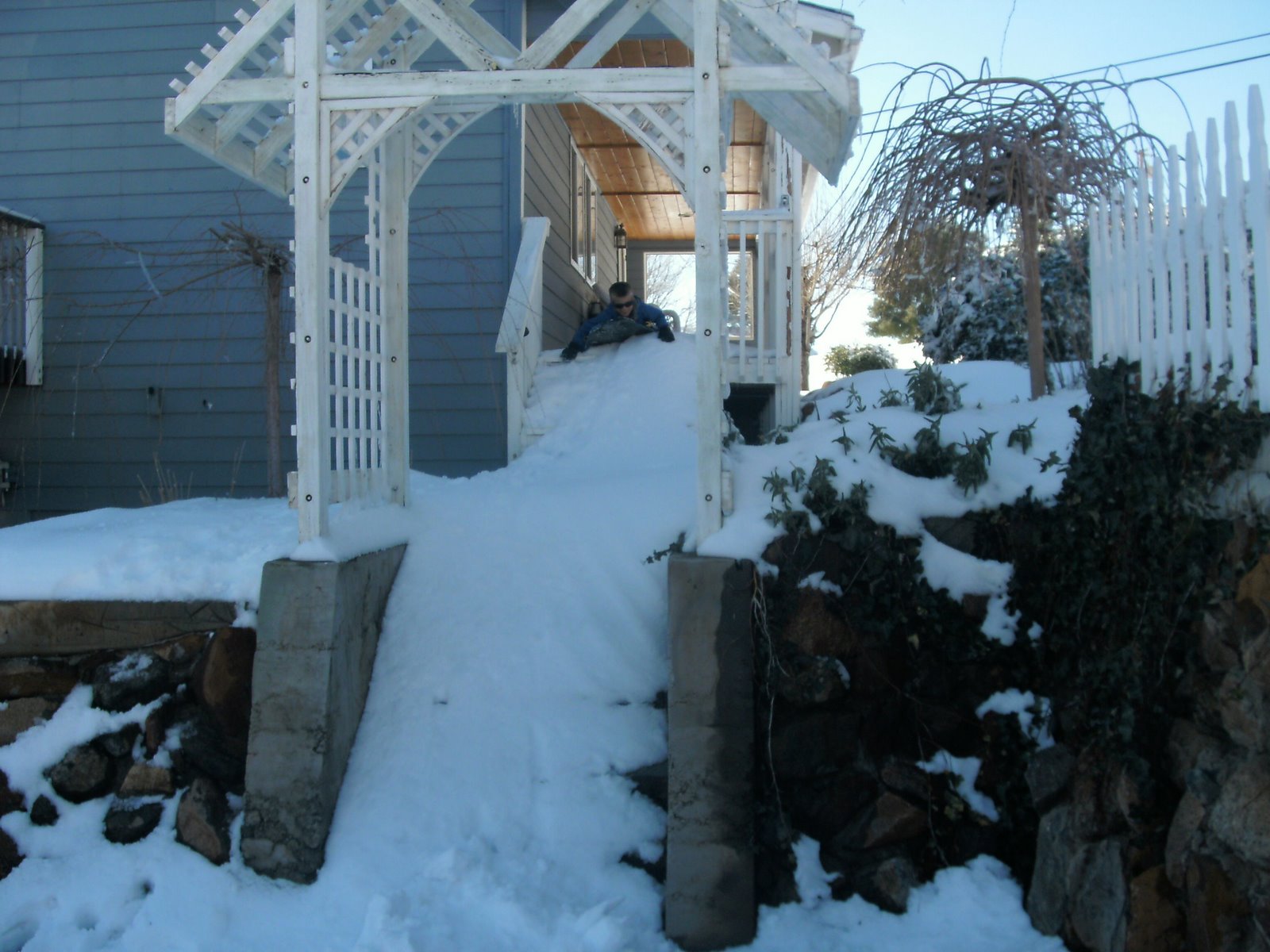

If I were going to build like that (actually I have! lemme find some pictures)  I would turn the three 2x4's 90 degrees and run the crossbeam through the center, and continue it along the length of the structure.  Instead of going thick I'd go deep---like a 2x12 or14.  This works out neat because you can slip the crossbeam between the two outer 2x's, get it dead-nuts on level, then cut the peice that supports it.  You'd run carraige bolts through the whole mess, providing some diagonal support your current plan lacks
   That's my pavilion at home.  At the AirOps station I built a similar thing---- except it was supposed to last one year until we got our hangar, and had to withstand 400 MPH winds.  Having it blow apart in rotorwash into Lear Jets would be bad.  That was 7 years ago; still no hangar.
My front porch is built this way too.  I need a better close-up.
    All this said, I've only used this for building lightweight outdoor structures.    Someone esle with actual structural engineering background will have to tell you whether it's suitable for the increased deadloads associated with a habitable structure---but it's similar to pole construction so the numbers exist somewhere
Here's a little bit better picture.  YOu can see how the rail is sandwiched between the studs.  The rim joist below the decking is the same.  I just stuck it in and blocked it to match the ledger against the house
« Last Edit: April 07, 2014, 03:43:03 PM by flyingvan »
