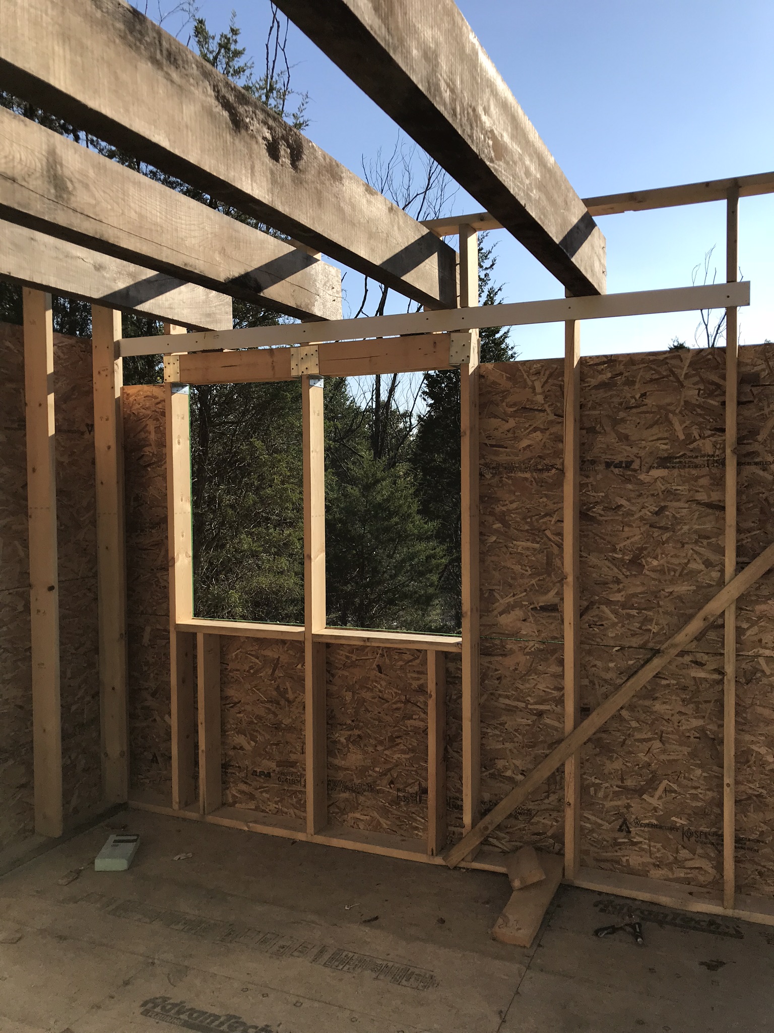

Looks like you are having fun and the driveway looks great!  Are three of those beams above a window?  I'm a belt and suspenders kind of guy when it come to building and for the beams that aren't above a window, I could put another stud (jack stud) that runs from the bottom of the beam down to the bottom plate.

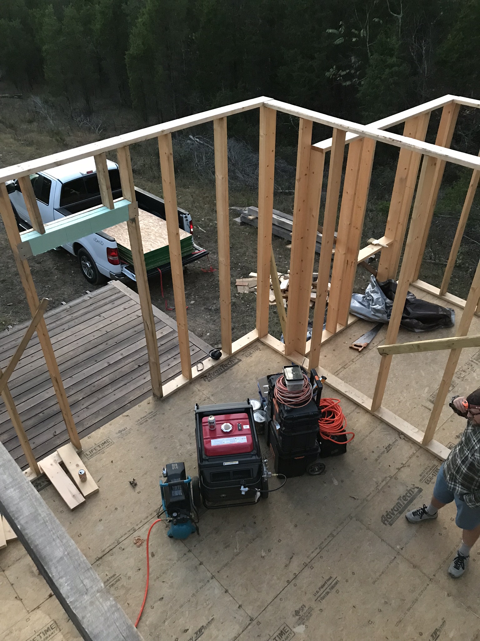

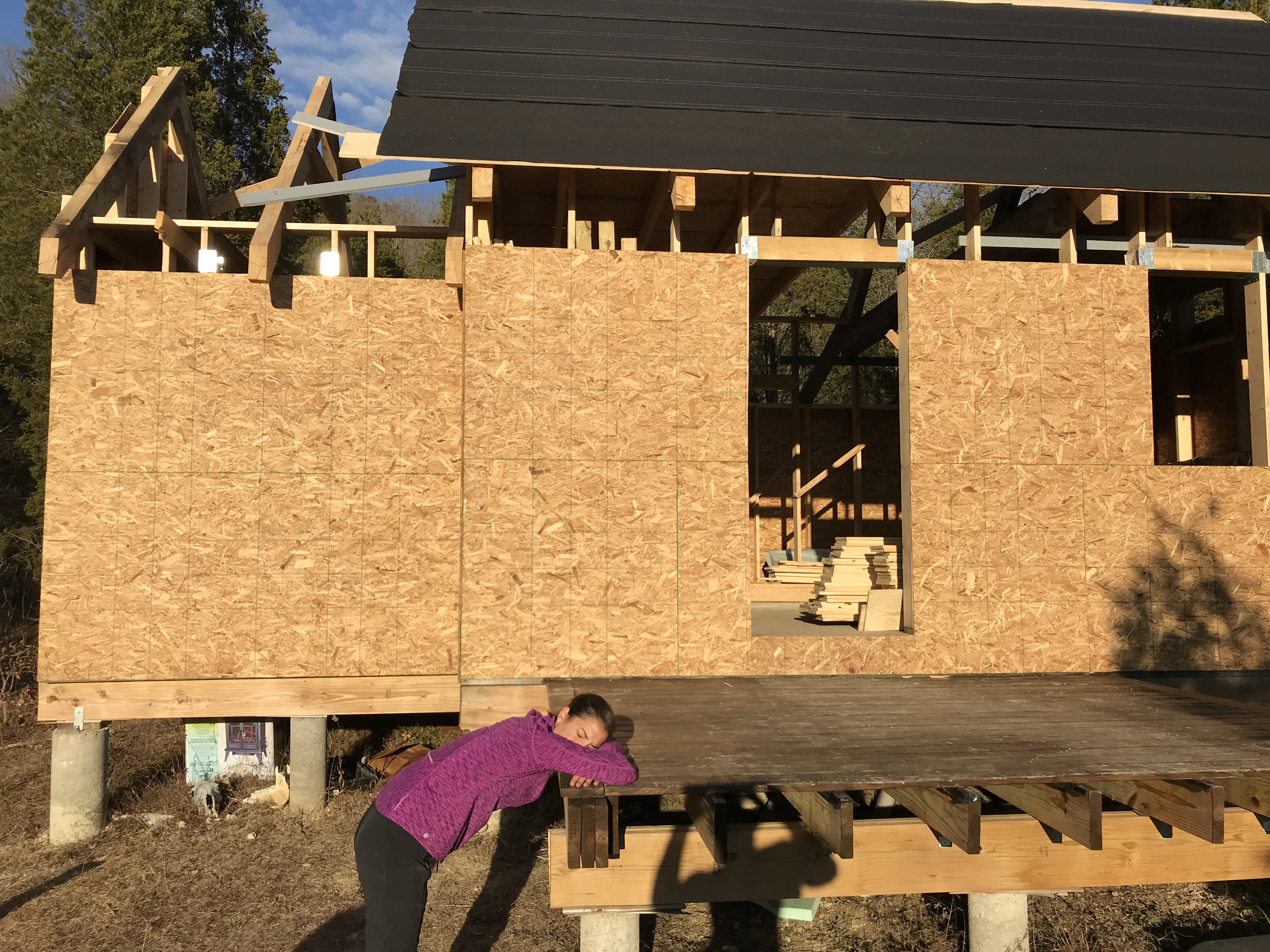

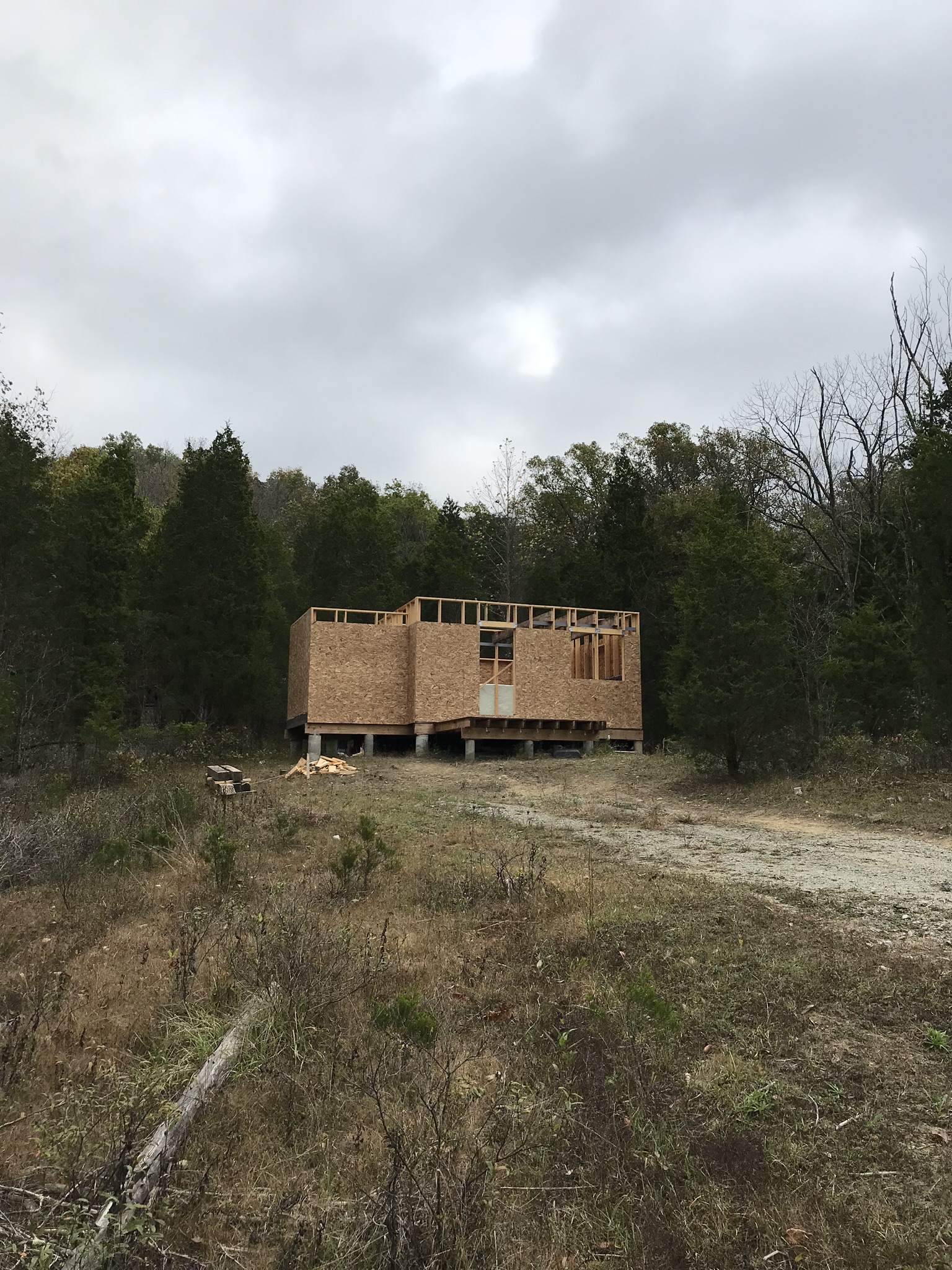

I had another productive work weekend this past weekend.  First thing I did when I got there after unloading was to stain the deck.  I didn't really wan't to do this but I knew if I put it off I'd never get it done.  Plus the cedar had been sitting outside for a year so it was ready and really took the stain well.

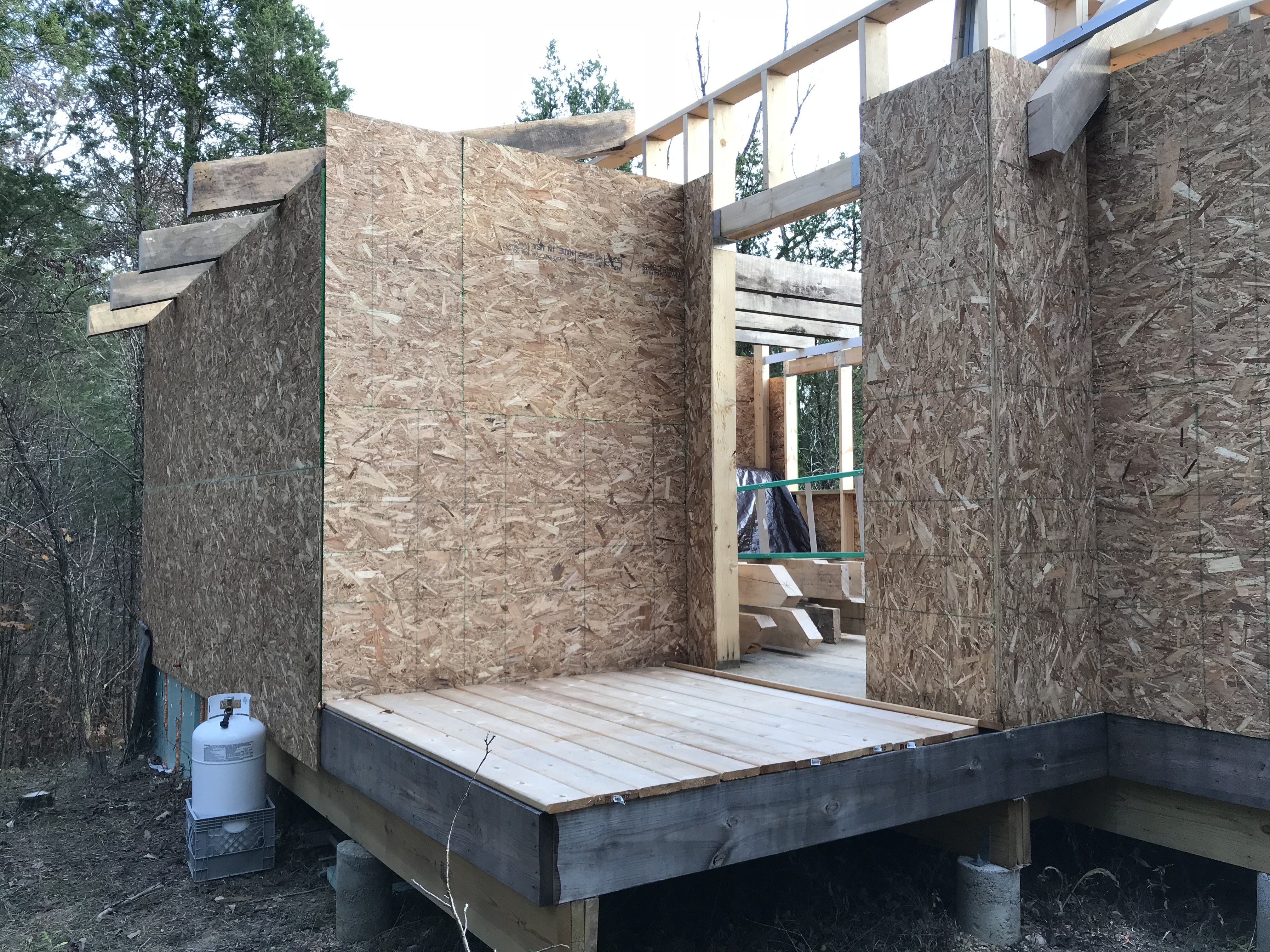

I bought 31 sheets of OSB, and it looks like it's going to be about the right amount, we got down to sheathing and got just about everything we could do done.  I can't do the top bit yet.  My rafters are at a timber framers barn getting cut and he is making the span between the birds mouth 14 feet.

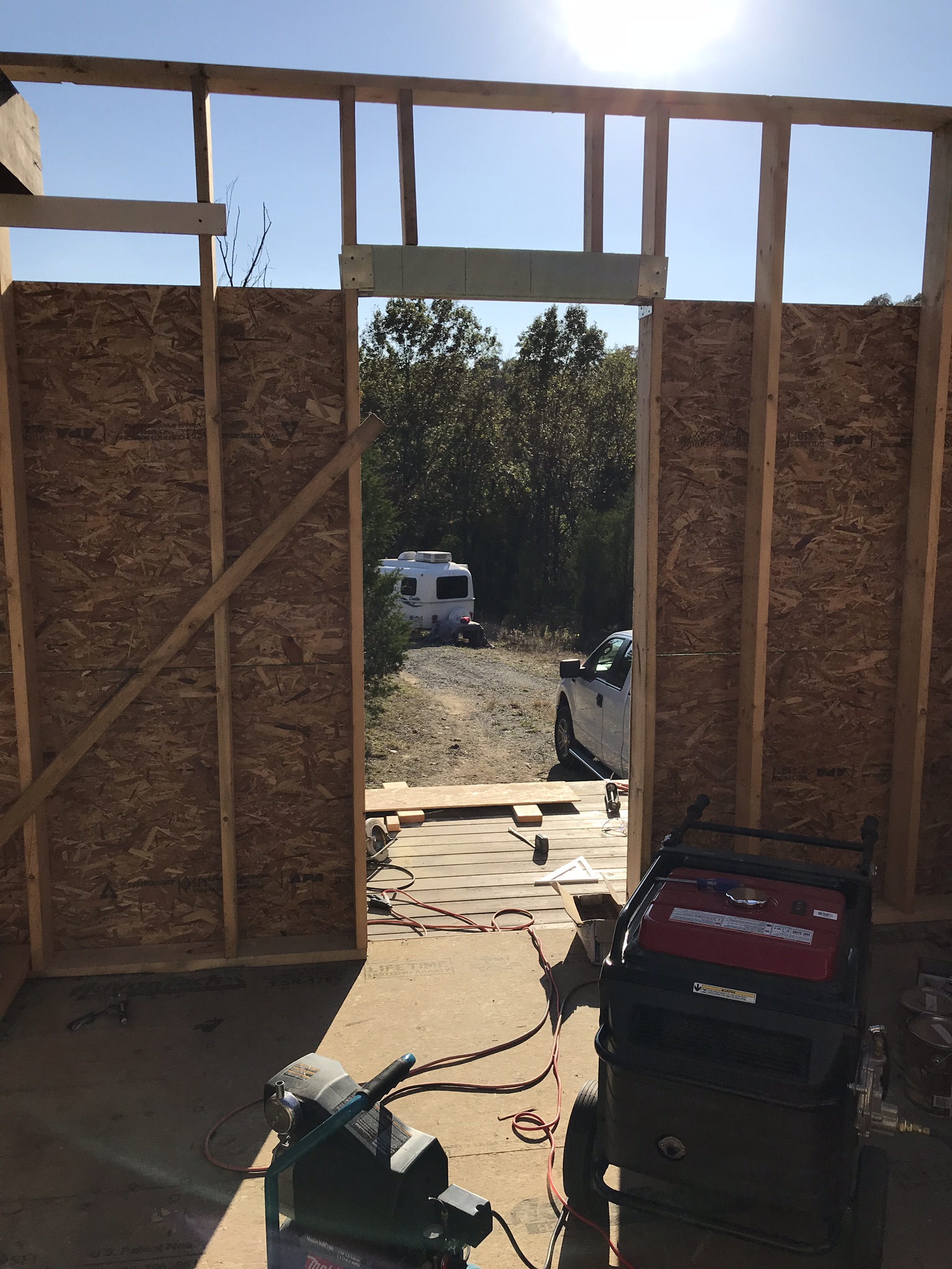

The front door I framed to be 3-6 wide and one size larger than standard height.  It will be a Marvin wood ultrex French door so it should let in a lot of good light.  The SYP span tables don't go down to my building width or 20psf snow load, so I used the next size up which called for a single 2x6.  It didn't feel right so I doubled them up for the rest of my window and doors.
This window is where there will be a built in dining nook.

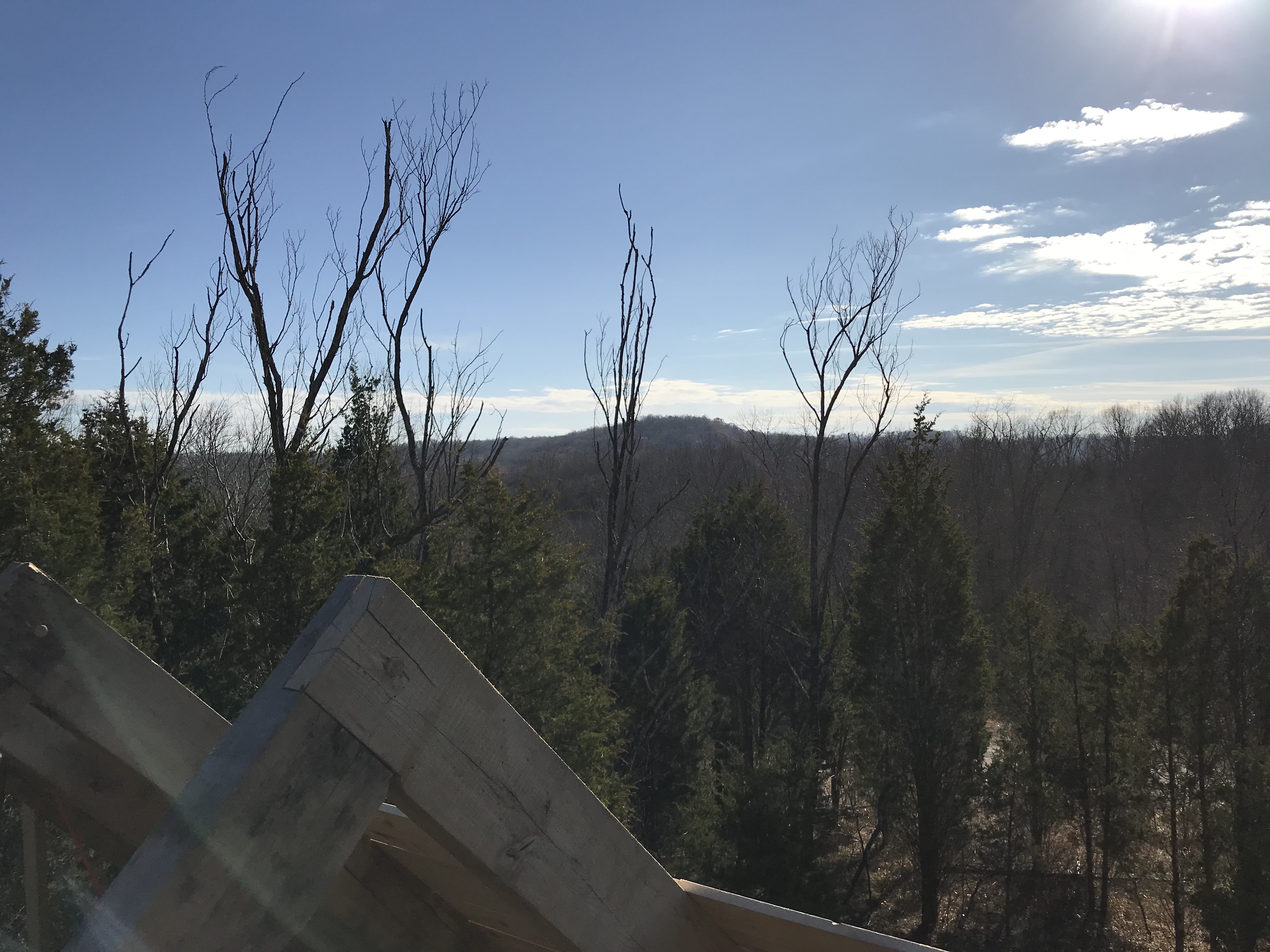

View from the loft, may have to frame in a dormer to take advantage of that!

I'm regretting not putting a dormer in the loft of the 12x16 cabin that is currently in progress.  The view when standing up there is just too nice.  If your loft is intended for daily use, you really ought to consider that dormer.

Yea, I'm pretty well convinced.  The rafters are on 4 ft centers so I can fit a decent sized one right in between, shouldn't be too much effort as long as I am organized enough to put the siding on before the former roof.  Probably a simple shed dormer would look nice and add some visual interest from the outside.

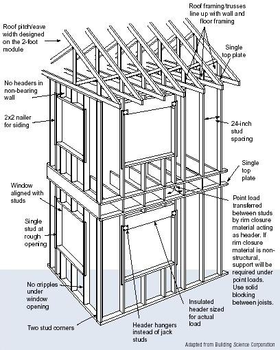

dmanley

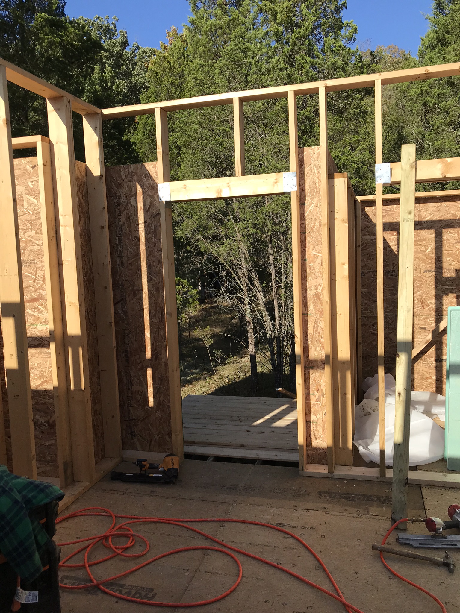

Am I missing something? I don't see any jackstuds.  Also, the headers over the windows seem small to me.
Mike 870
Nope you're not missing anything, there are no jack studs.  I used Simpson header hangers instead.  The headers are sized (oversized actually) based on my building width, stories, and snow load per the Southern Pine span tables.
dmanley
Interesting.  I have never seen that done before.  Good looking build.

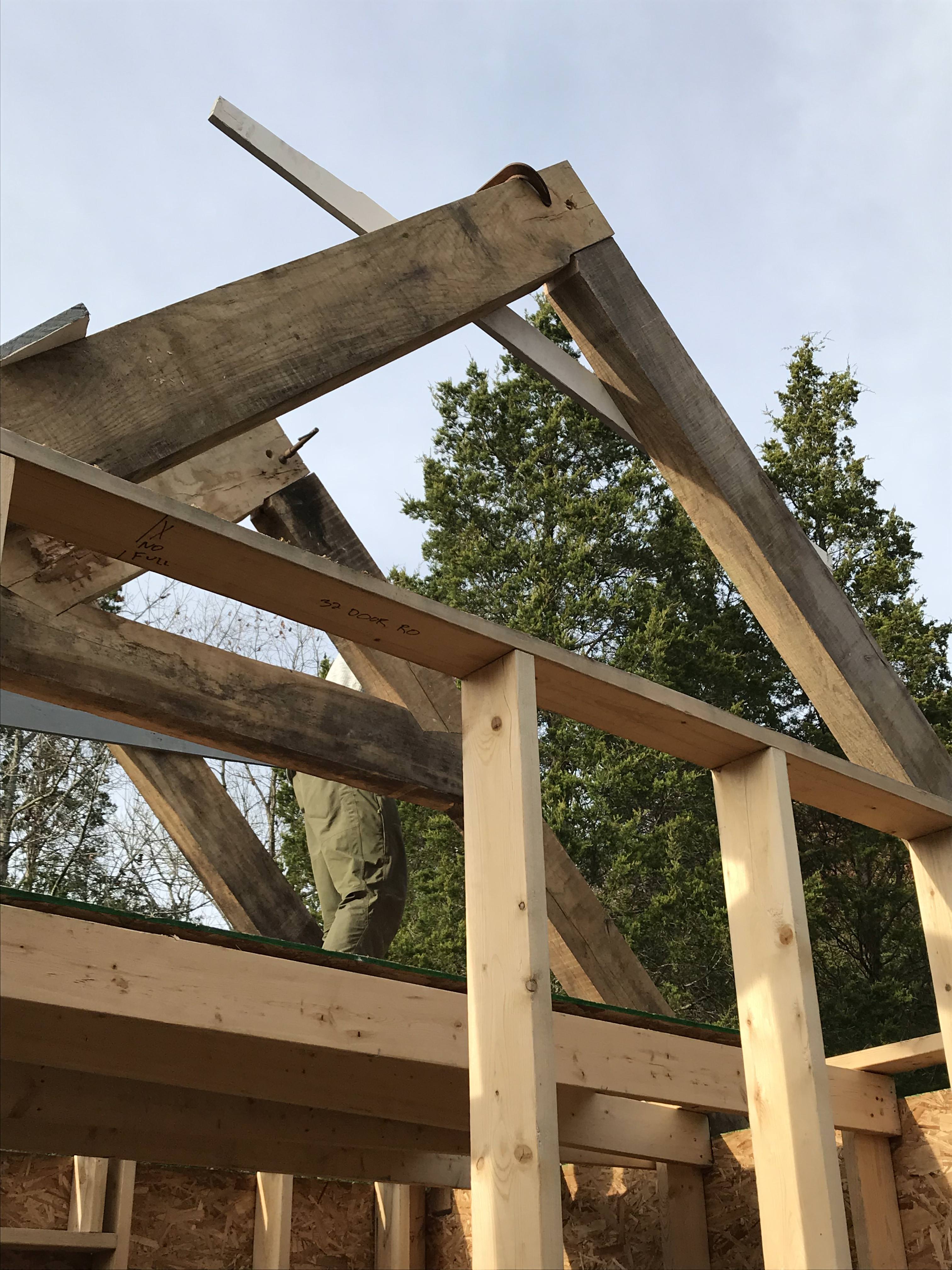

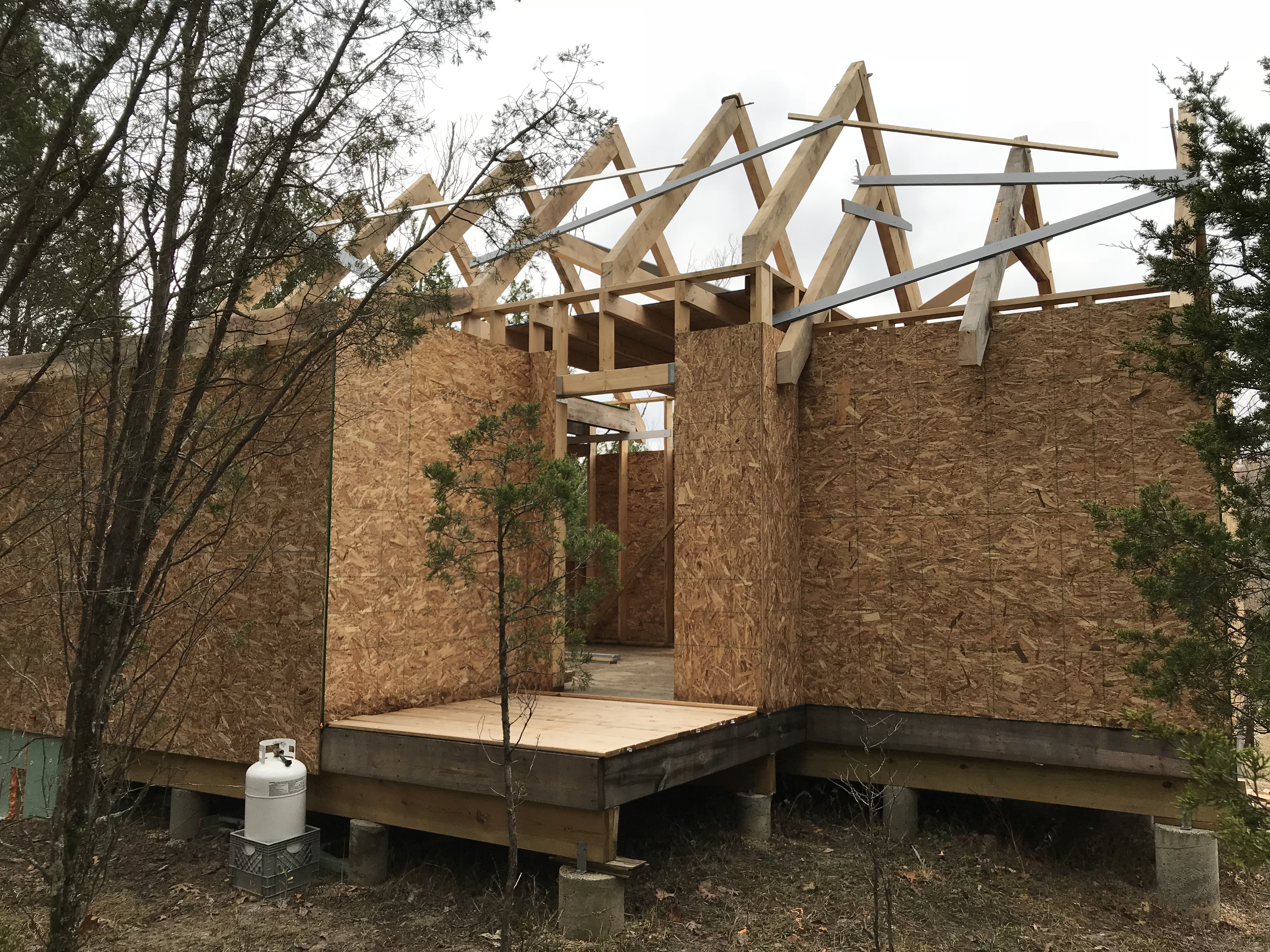

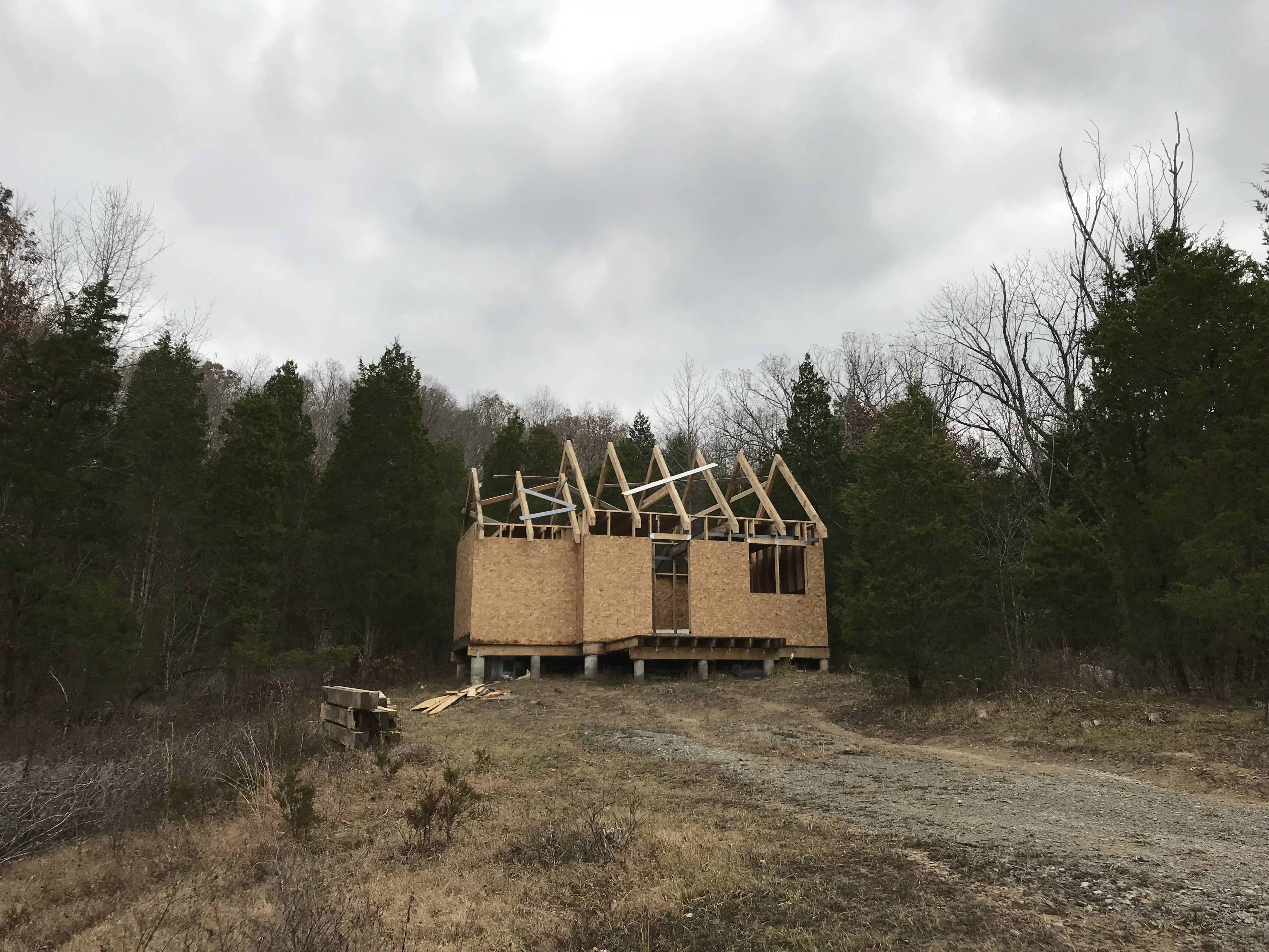

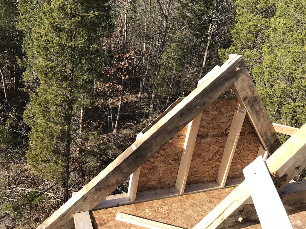

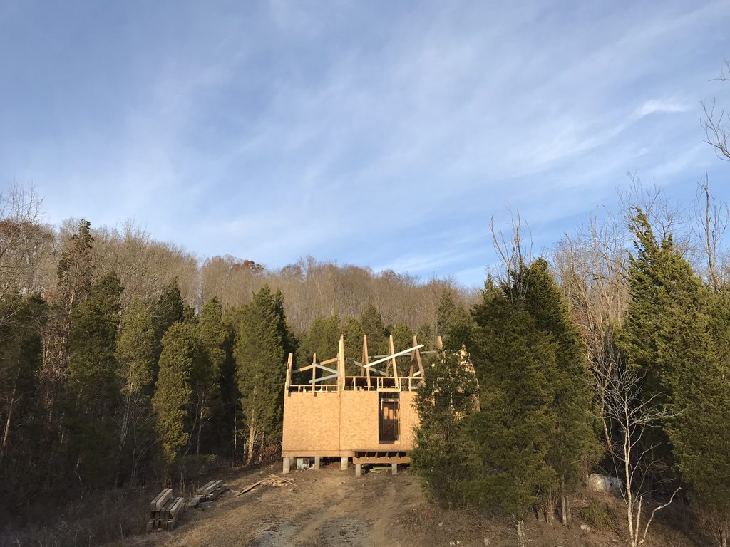

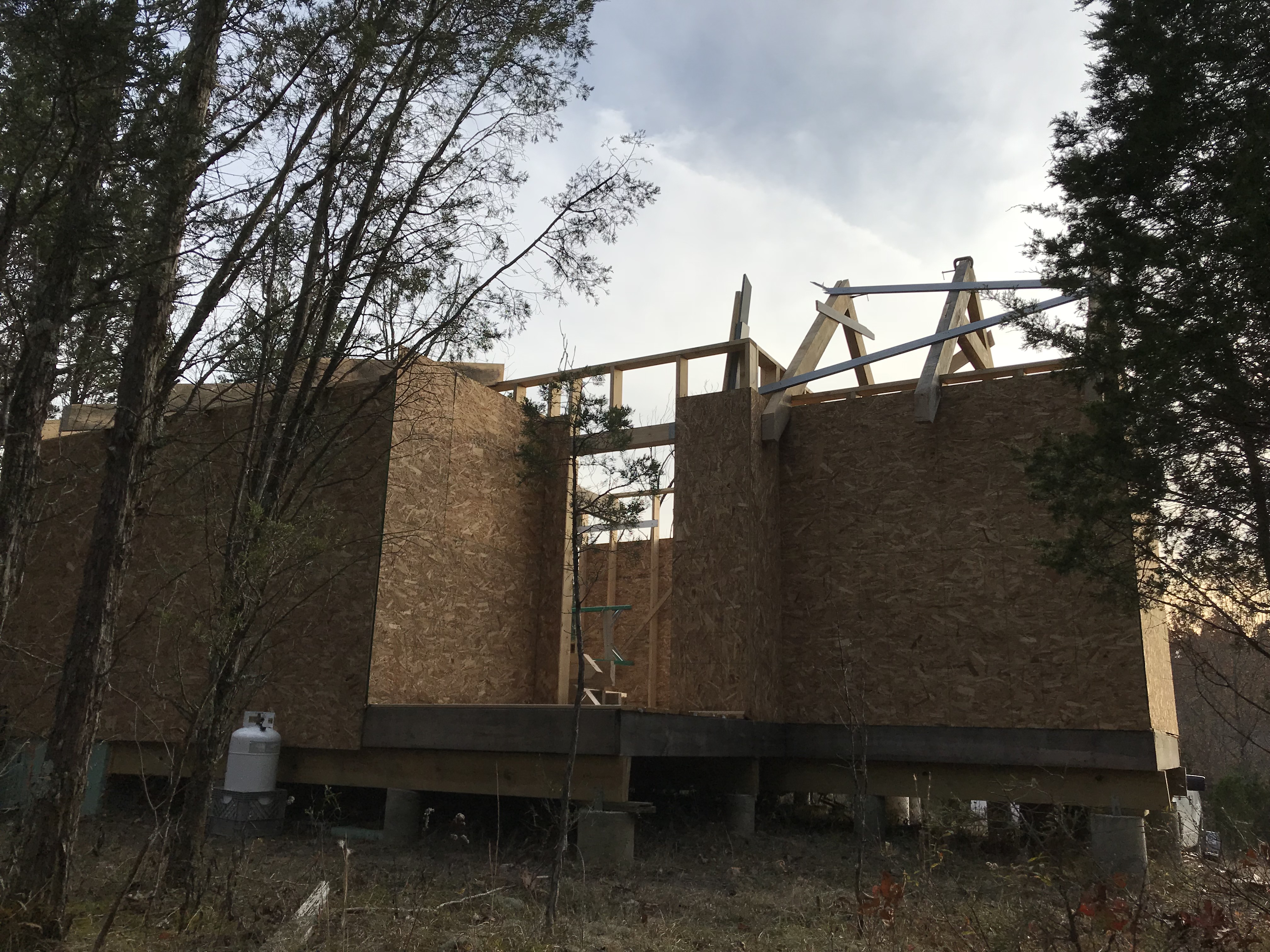

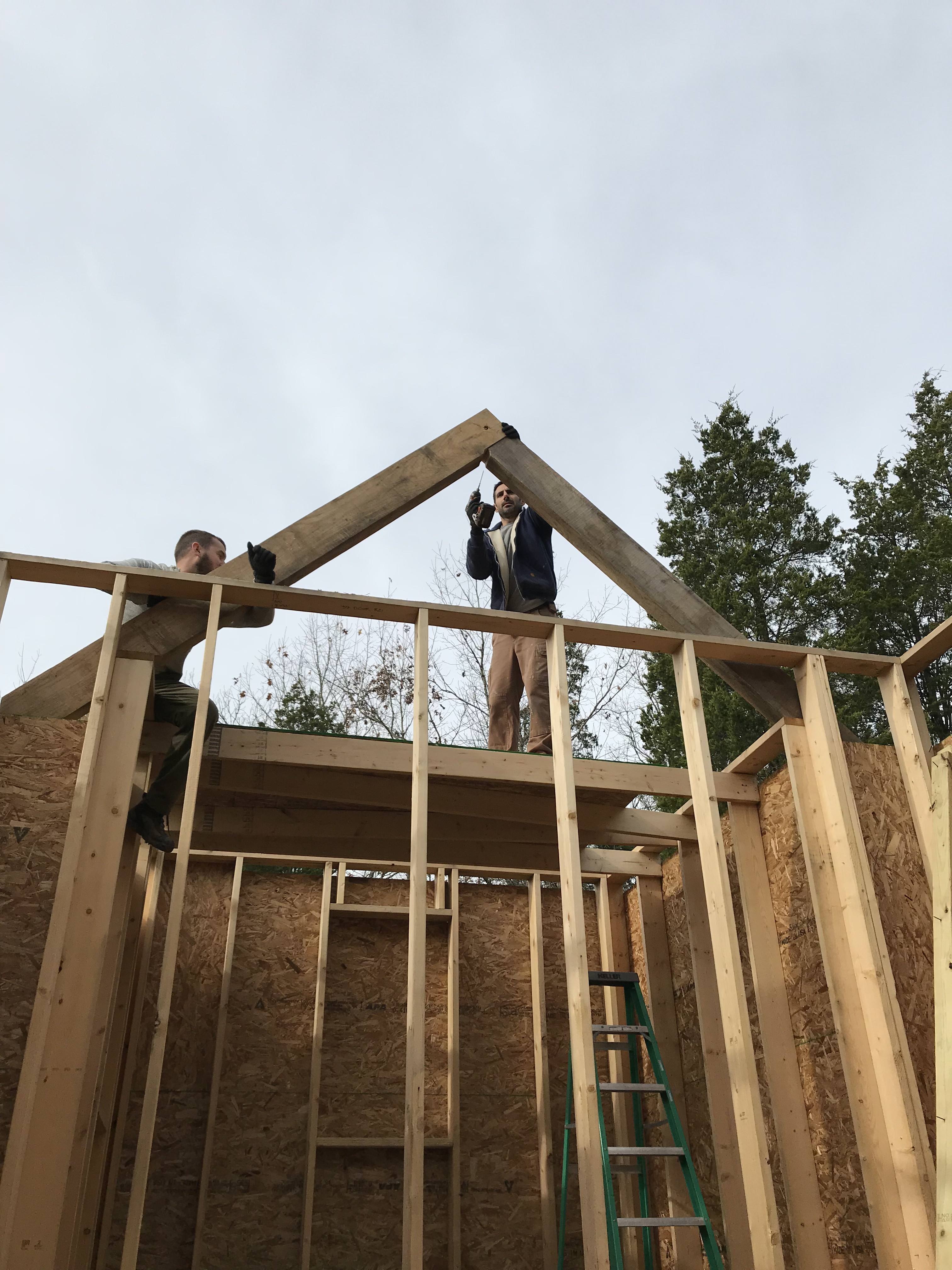

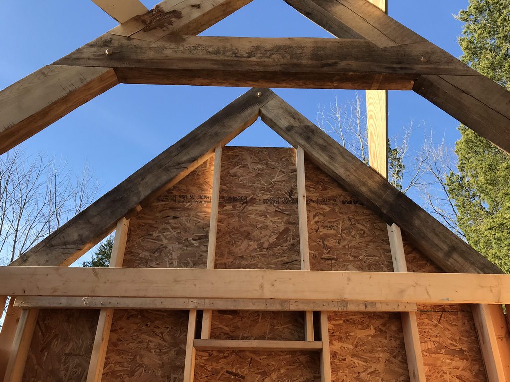

Sorry, huge image dump, using imagur, and wow it's almost as bad as photbucket from a usability standpoint.  Here is a tip, if you have the app, just remove it and use the desktop version.  Made a bit of progress with the timber frame roof, got everything moved into the cabin and assembled the bedroom and the utility bumpout.  I will make the proviso, there are a couple framing pieces missing especially over windows and doors.I ran out of HH 6s and also 2x 6s. Heading out tomorrow to assemble the biggest rafters over the main room.
Mike 870

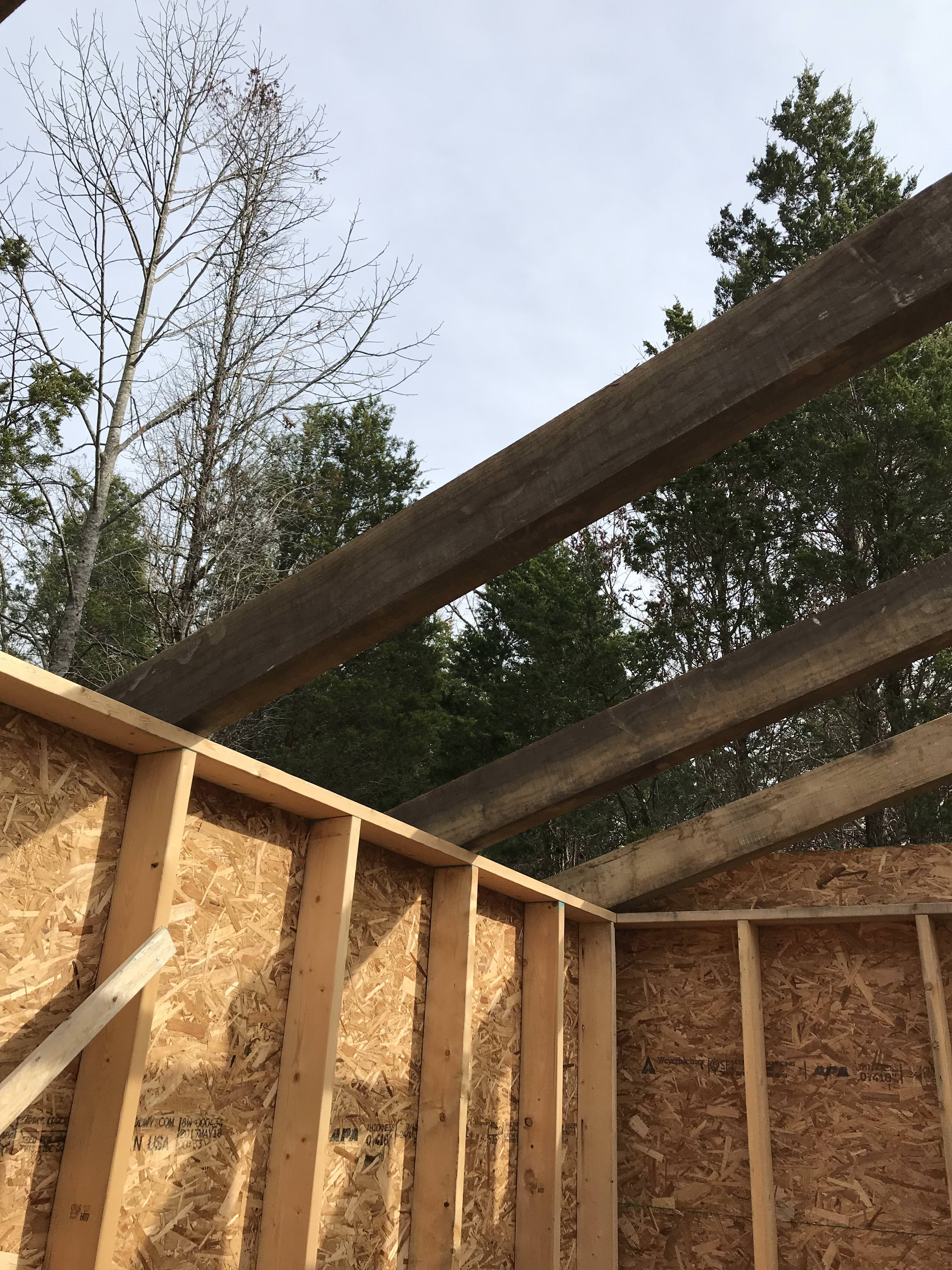

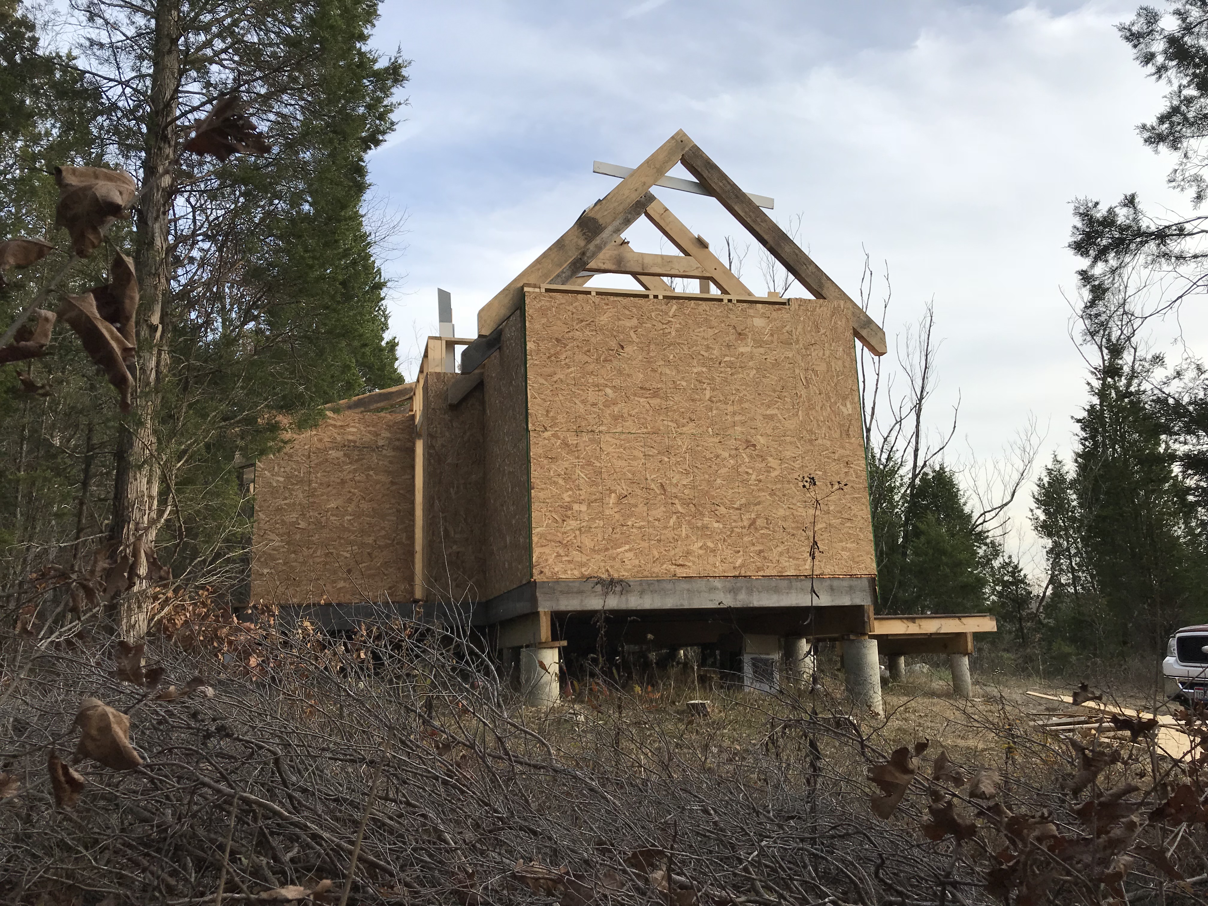

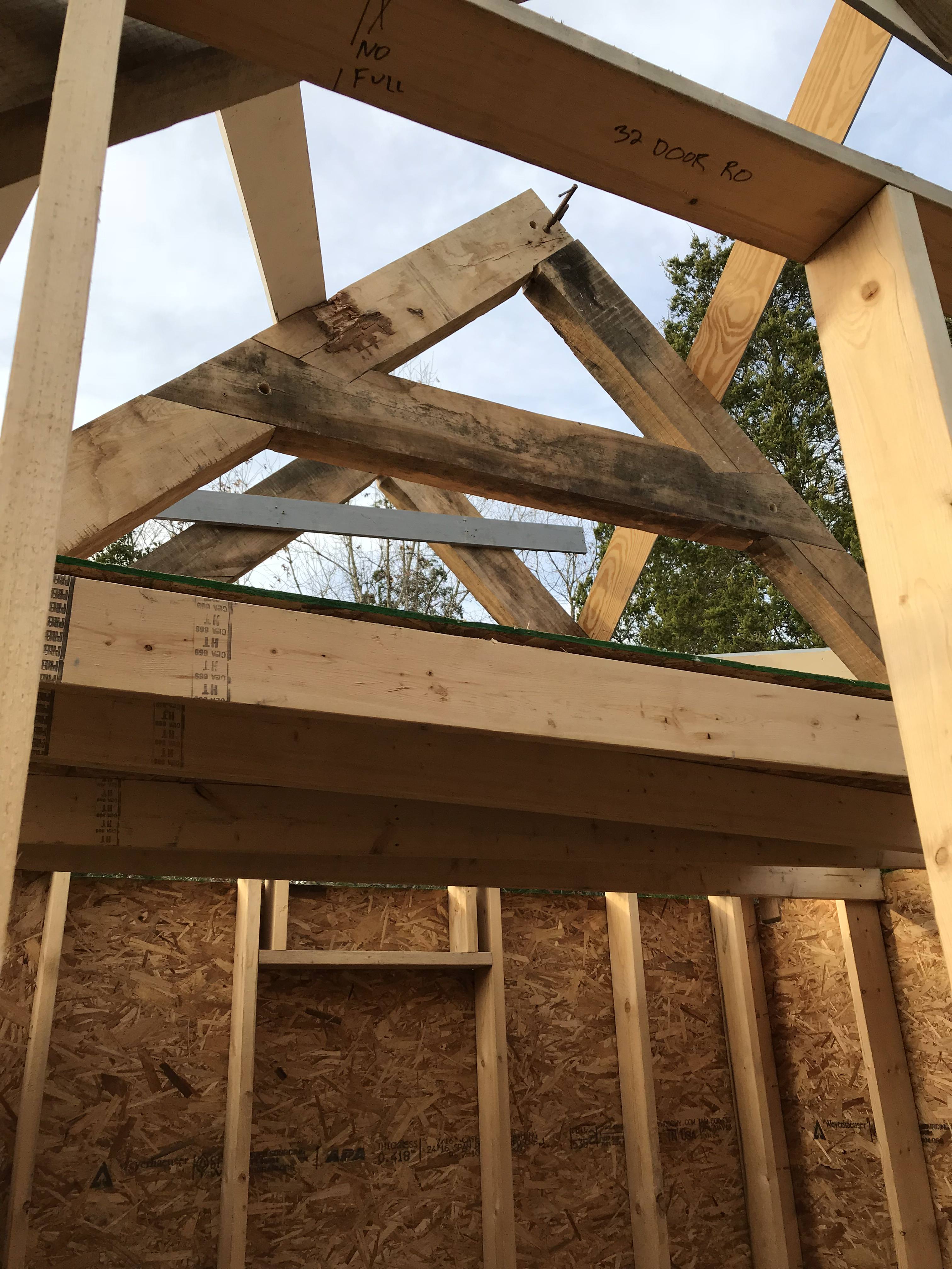

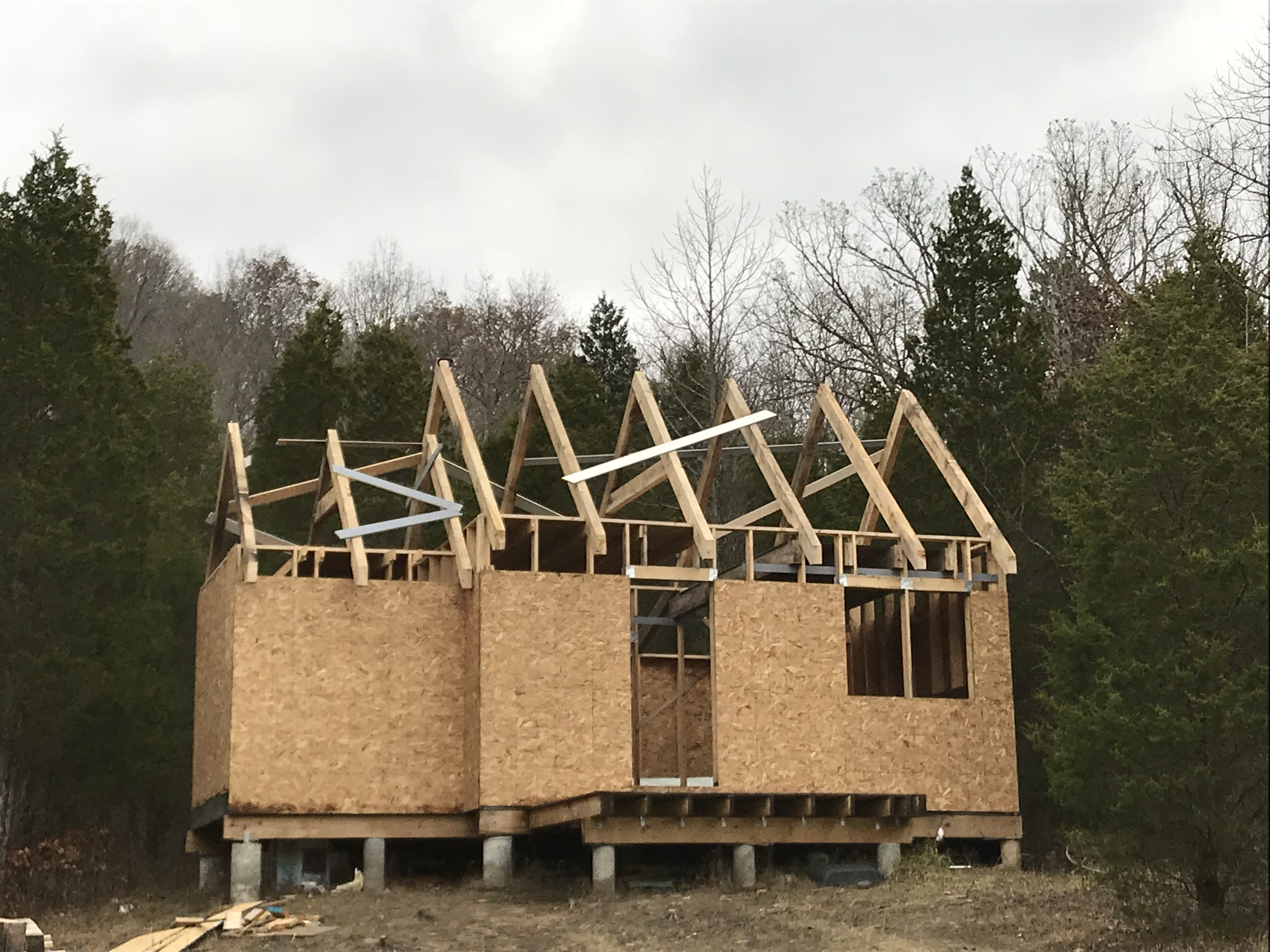

So in the bedroom, the middle rafters have a tie and the end rafters will be prevented from splitting by the sheathing, but in the main area I will need some sort of strapping or hardware to prevent the rafters from slipping off the top plate.  There will be 6 total rafters, one has a rafter tie, two will be on the ends of the structure, but 3 will need to be prevented from slipping off the top plate.  Any suggestions?
Mike 870

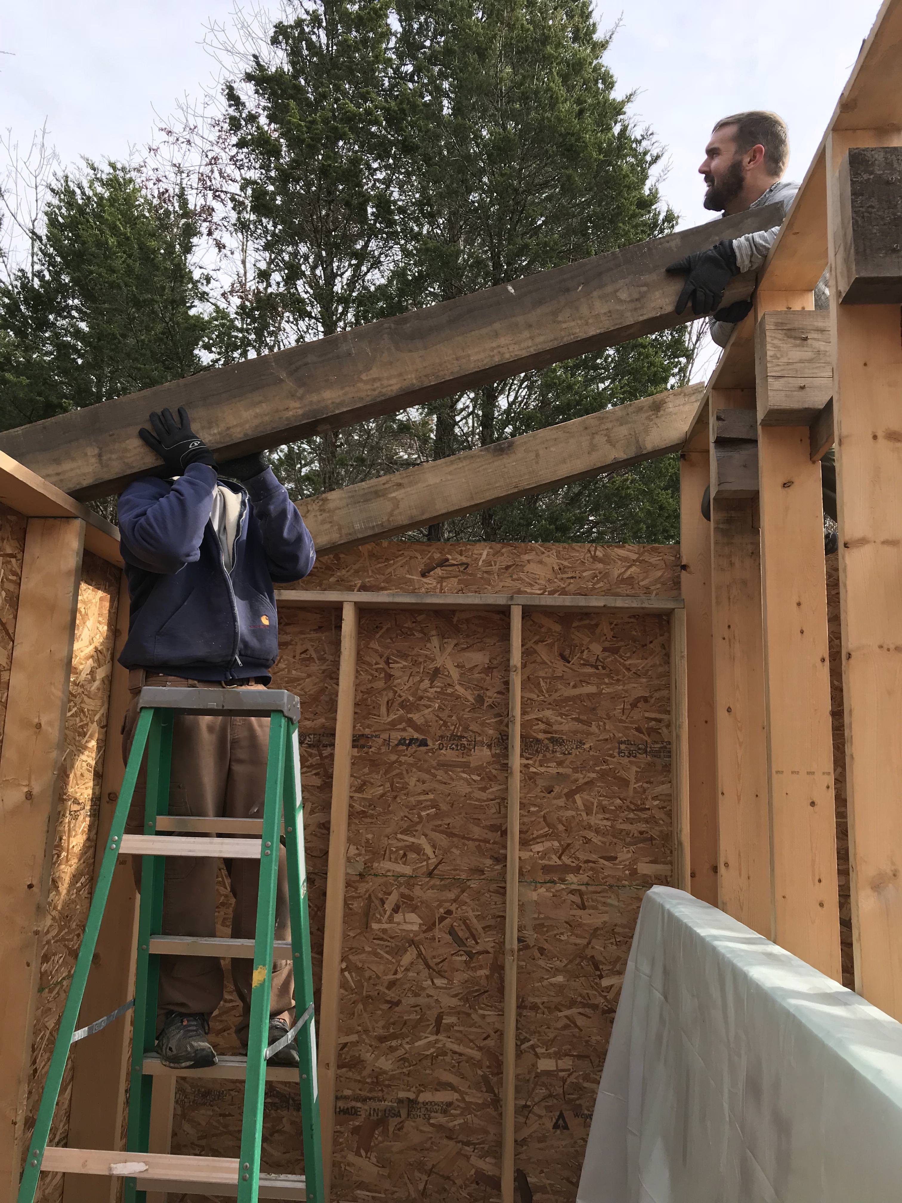

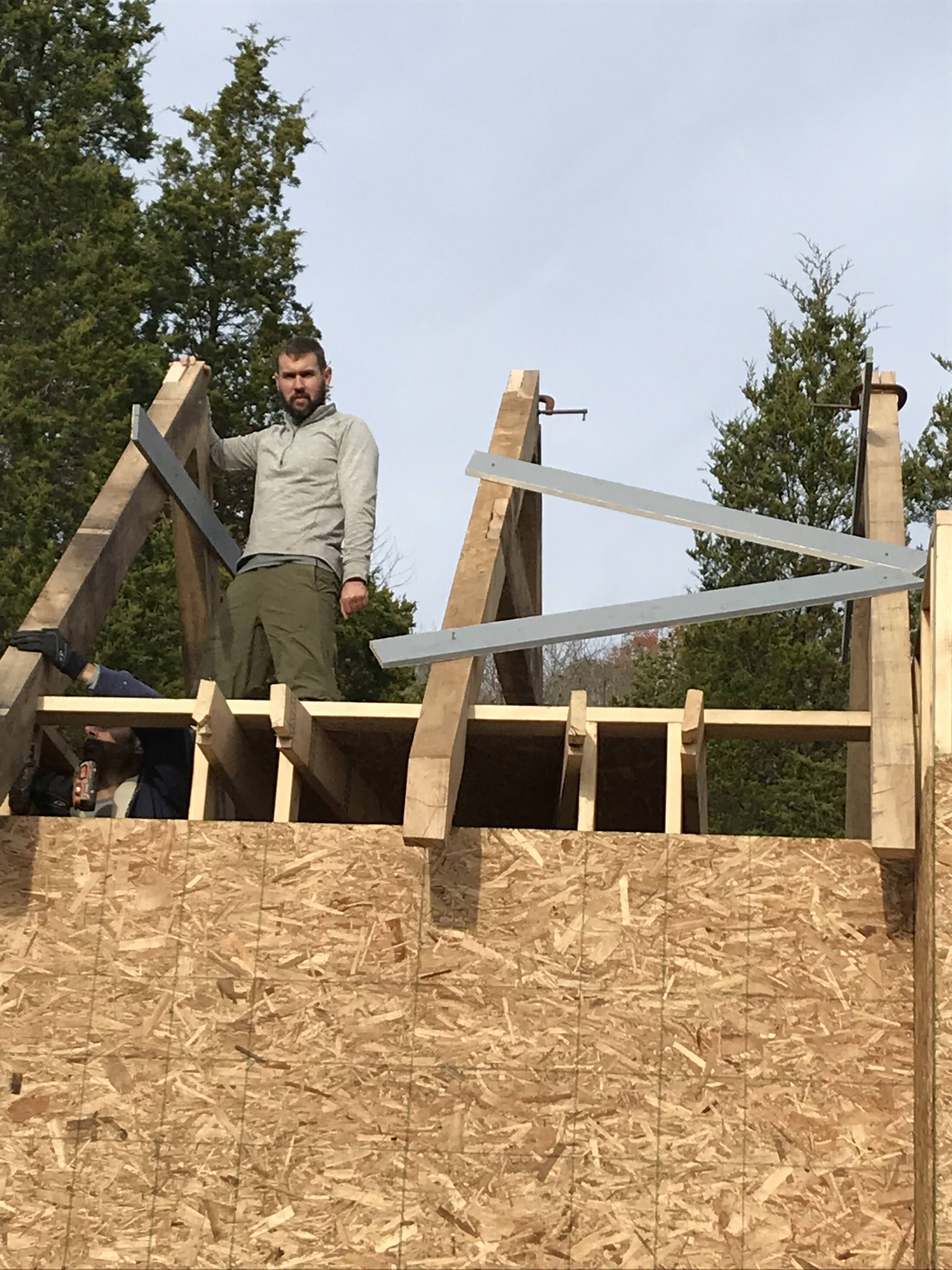

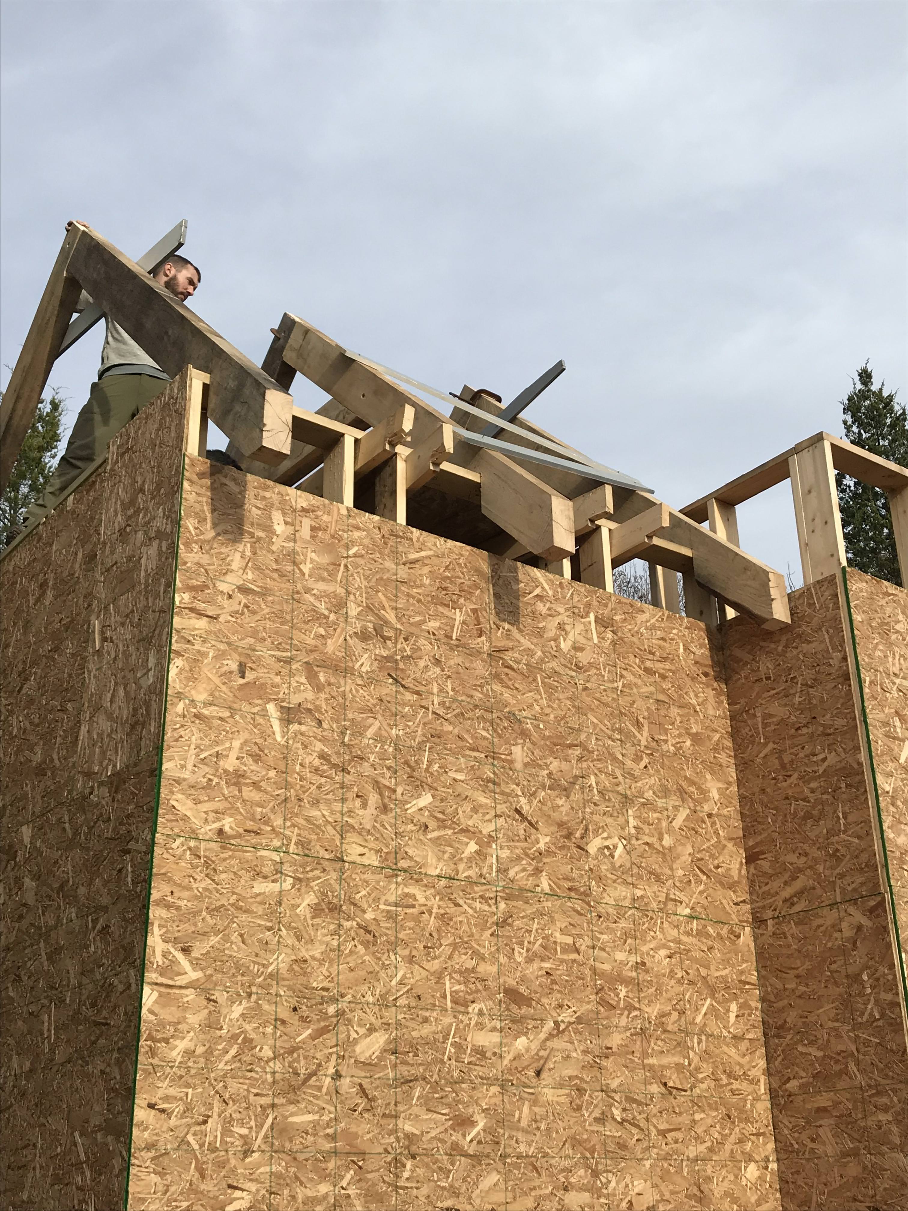

Got the rest of the rafters up today.  Went up really easy, built a temporary 2nd floor then just assembled and pegged them laying down and leaned em up.
Mike 870

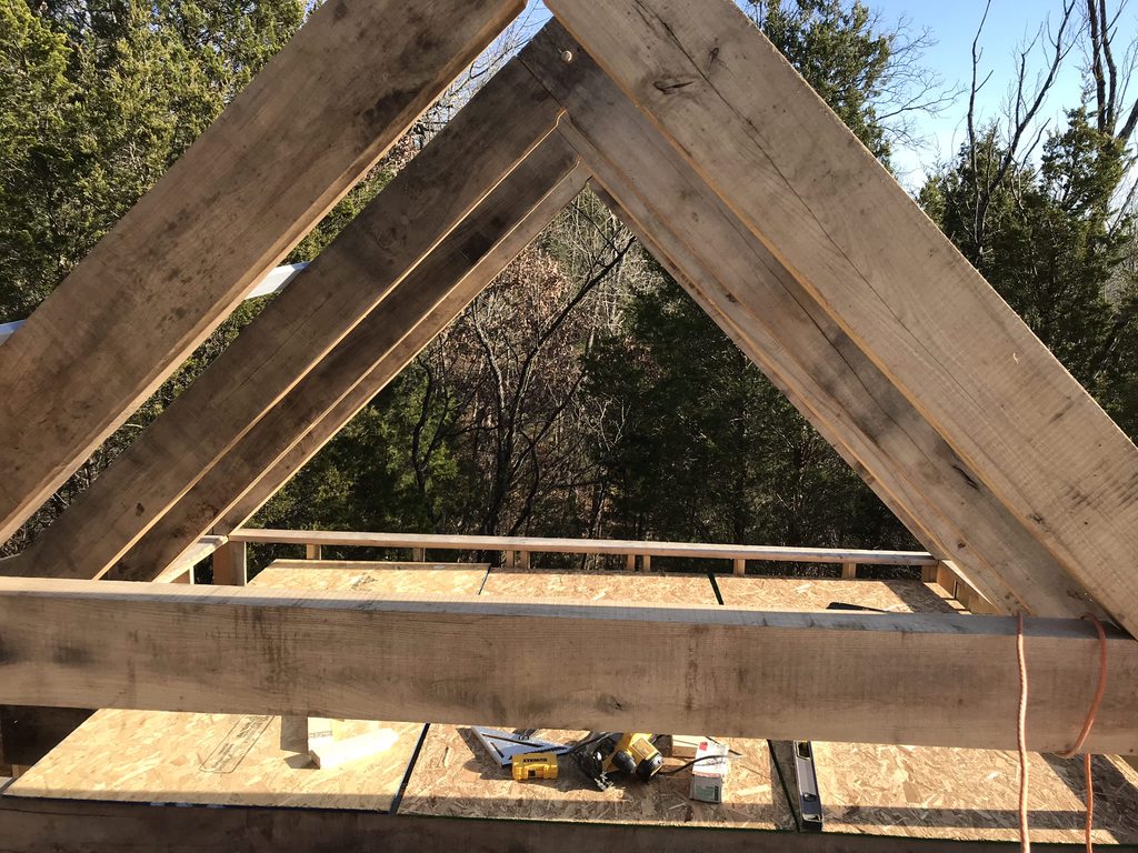

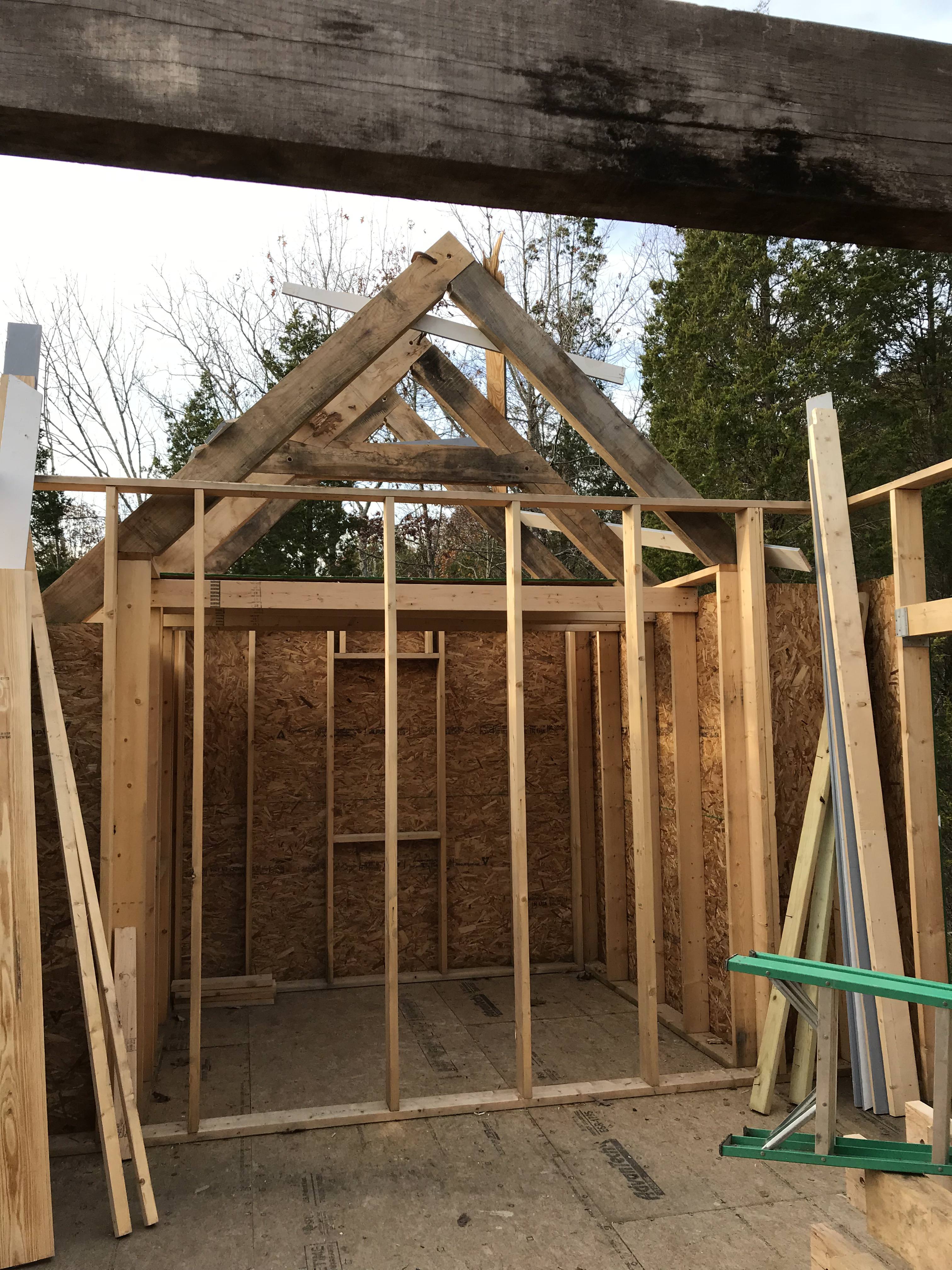

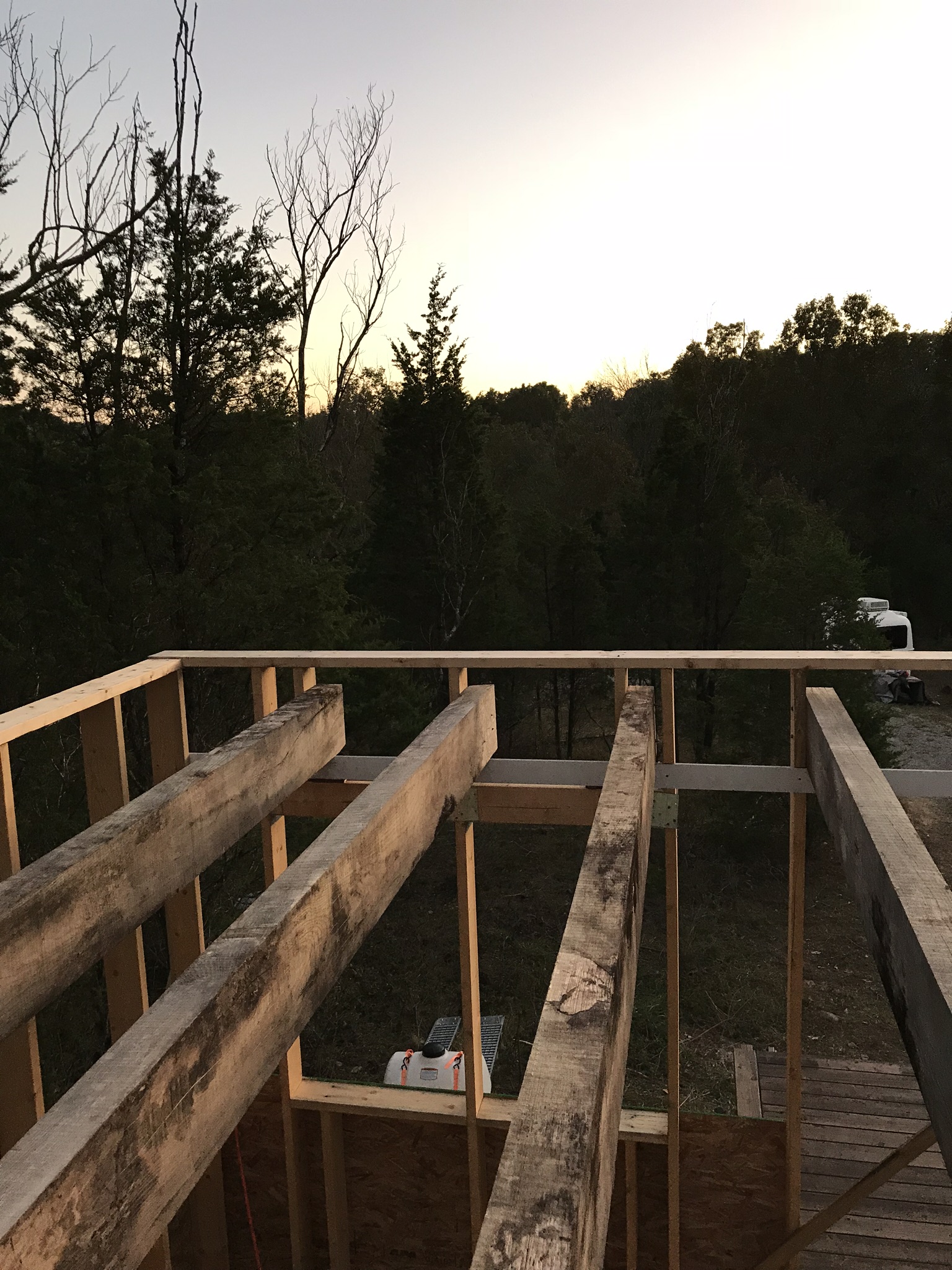

I took a day trip today. All I got done was to add the studs in the second story gable ends.  It took forever because I offset the rafters on the ends so they would be 3/4 inch proud on the inside.  Which leaves them around 2 and 1/2 inches off the end of the building.  So I had to notch all the studs out, what a pain.  I'm contemplating adding another rafter tie in the main room.  Right now there is 8 feet without a tie.

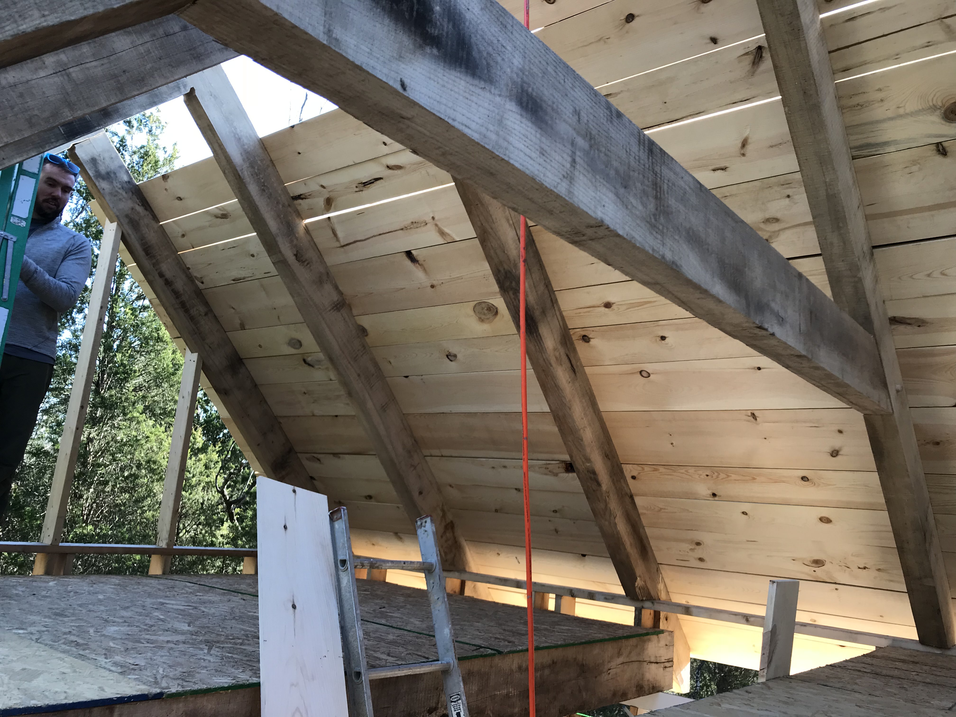

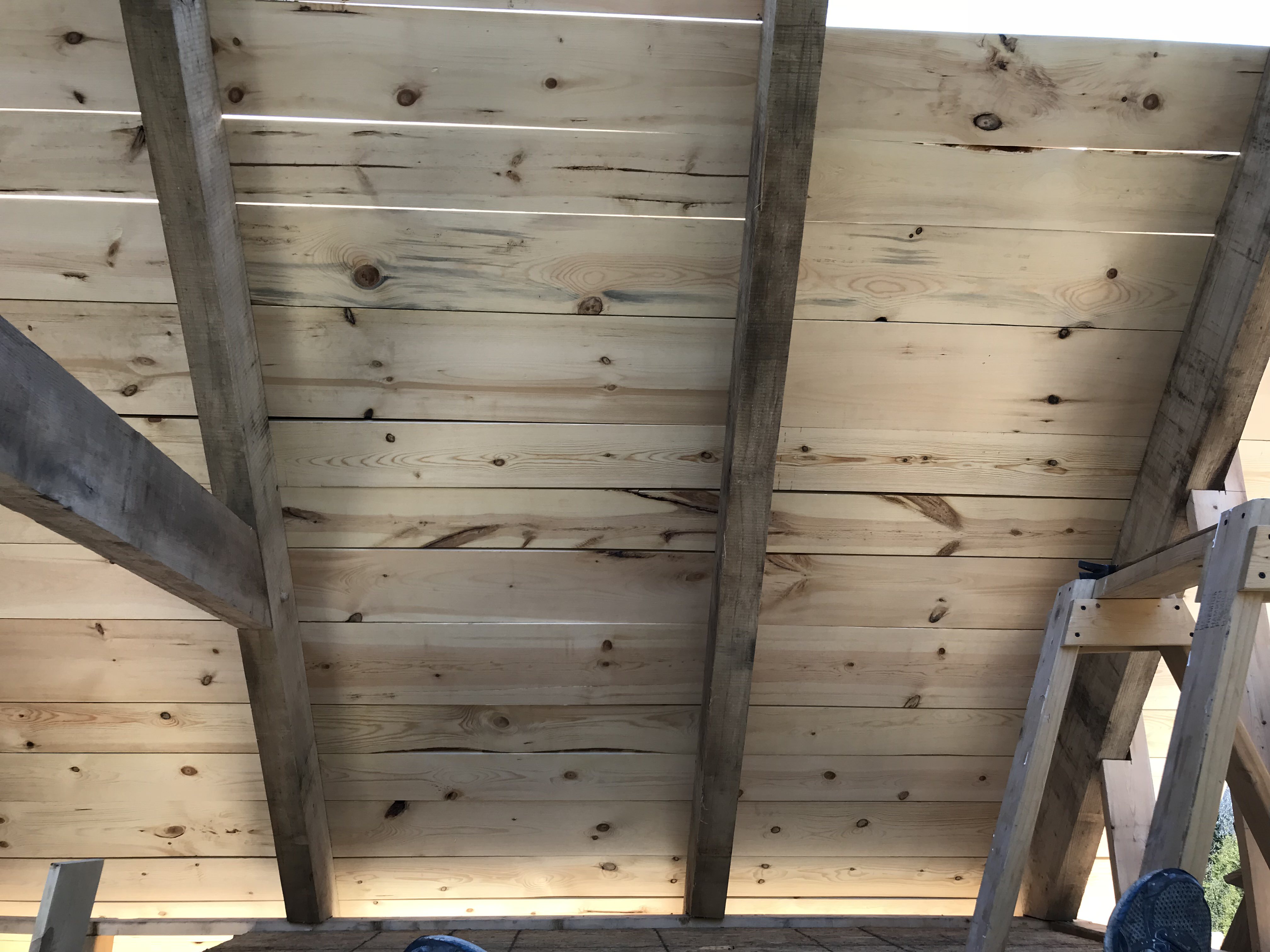

Thanks for the kind words pm, enjoy your time with yours and treat him/her well.  I did another day trip yesterday.  Began installing various widths of #3 pine.  Got the cheapest stuff I could from menards with zero sorting.  Thankfully that's ok with the kind of look we are going for.  Mixing it up between 8 10 and 12 inch widths.  I like the look of the lighter pine against the rough sawn ash.
NathanS
Looks really good. I almost commented earlier on how clear your rafters look, didn't realize it was Ash.
Are you going to lay foam on top of the sheathing? I found a really good deal on used polyiso insulation off a school roof, you might be able to find some good deals on craigslist.
In the cathedral area where you don't have any rafter ties it probably wouldn't look bad at all if you just ran two timber joists across to shore everything up.
Mike 870
Thanks, we have loads of Ash available because of the Emrald Ash Borer, I can get it milled any way I want for $1 bf so I'm using it any way I can.  Yes I am going to lay foam on top and then add strapping or sheathing on top of that.  The big question is how much to add, it's pretty pricey and I need around 700 sq ft of coverage.
There is one " kind of" rafter tie across the cathedral area.  It's closer to the middle of the rafter than it is the bottom 1/3.  It's pretty strong, still being 3 inches thick where the tie connects to the rafter.  The cathedral area is 12 feet long, and the tie is at 4 feet over from the loft then it is 8 more feet to the gable end.  If it were 2x pine I'd add another tie in a heartbeat.  Being hardwood I'm waiverig a bit and more inclined to add it just because I don't like the dissymetry of going 4 to 8 ft of open ceiling.
