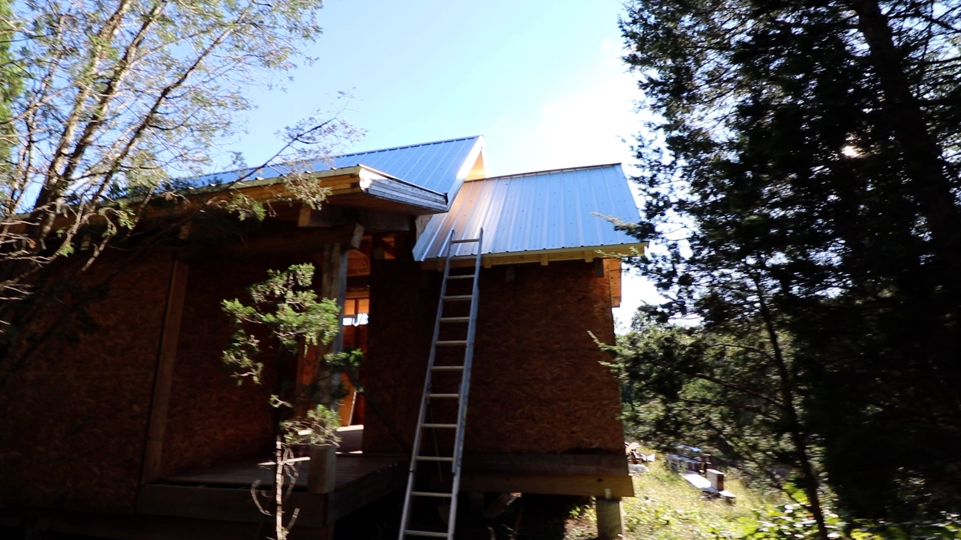

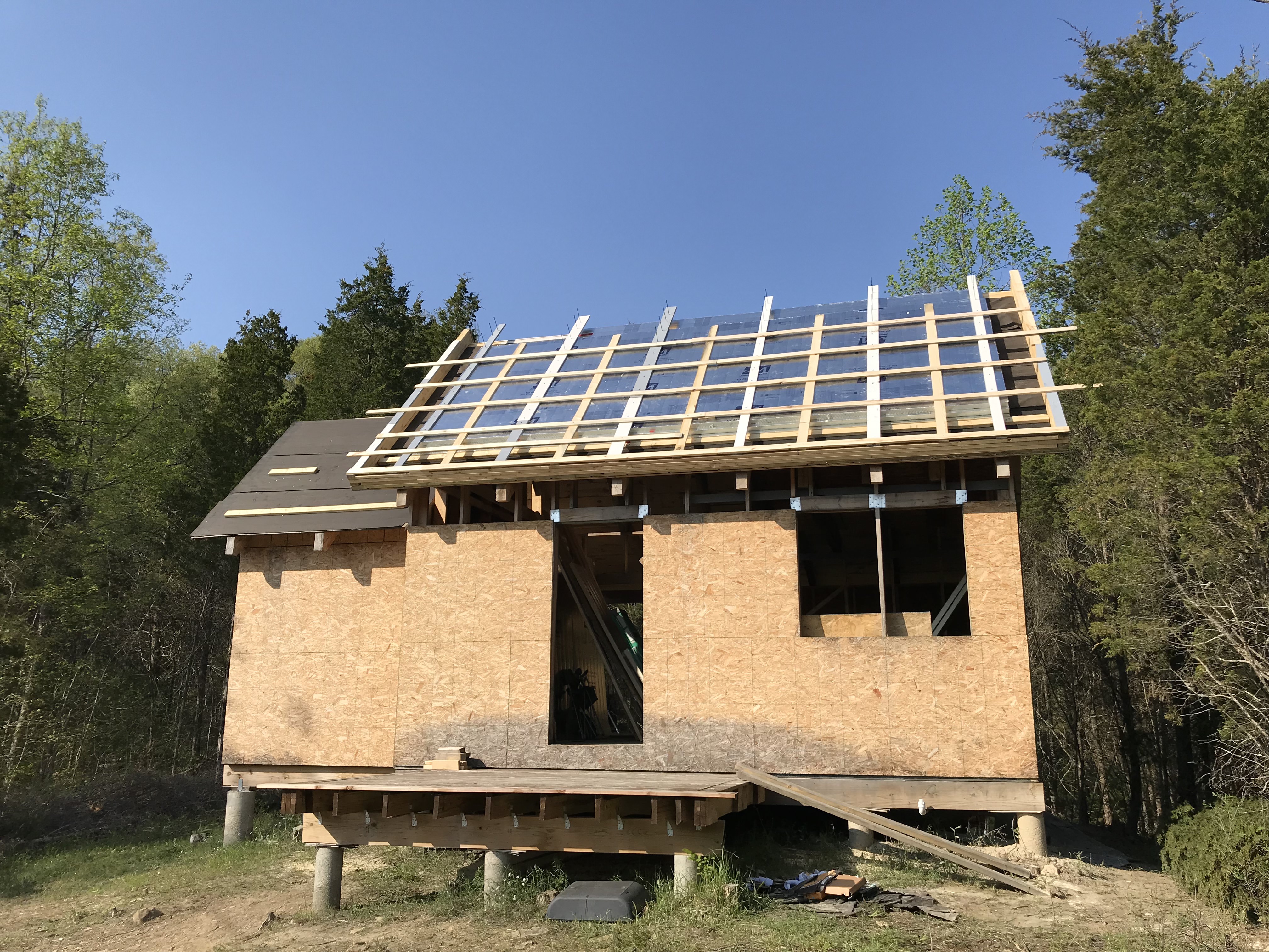

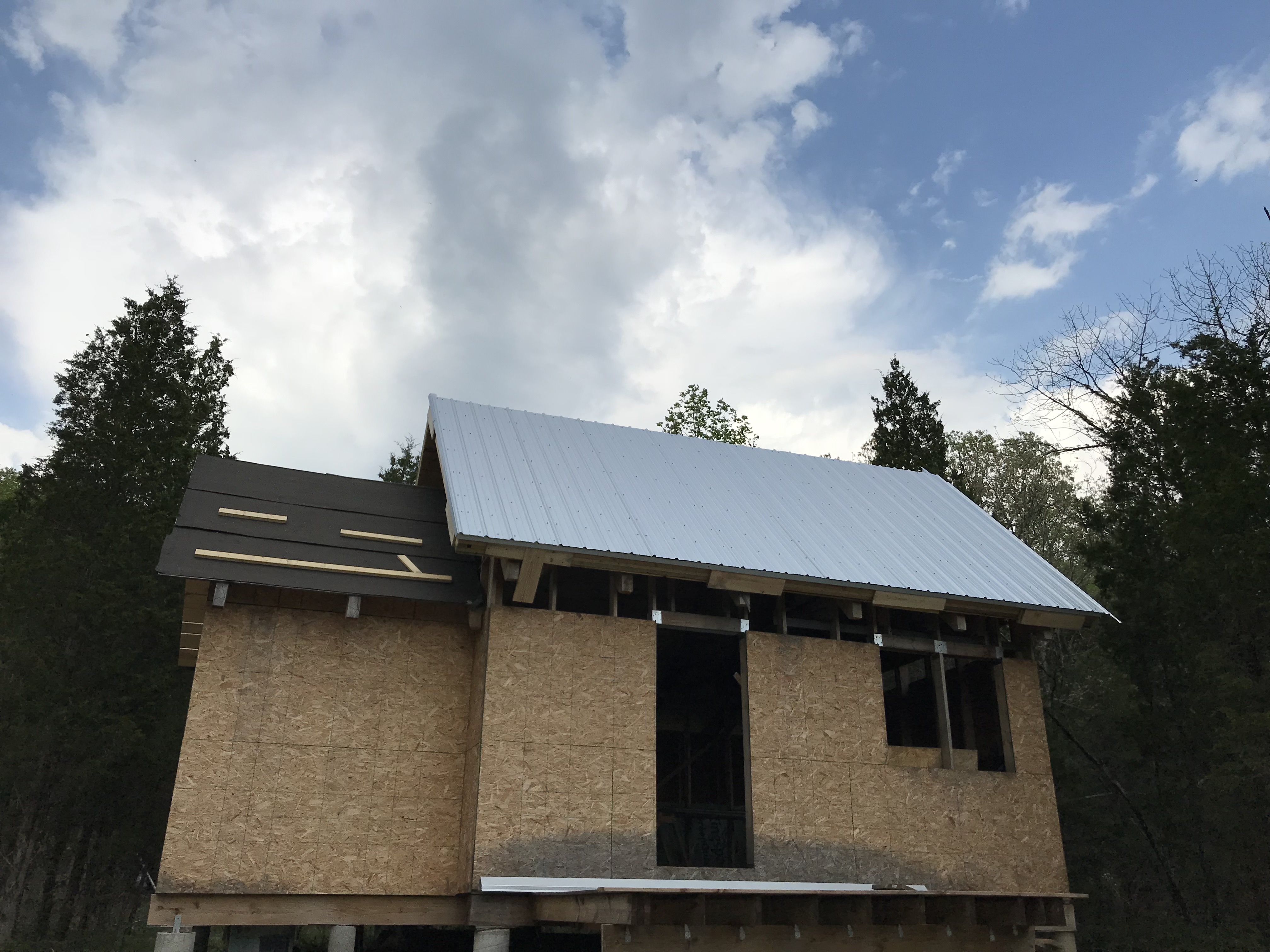

Here's what I got done so far.  Hopefully this picture helps it make more sense.  It's not for siding it's for a metal roof.  I still have a two foot strip to add at the top before I can finish this front section.  The screws are biting into the ash rafters, it's solid I've been climbing all over it today.  At the bottom and the sides the strapping fastens to built up 2x4's.
dablack
That's a horse of a different color!
I think what you have done looks pretty good and if you have been climbing all over it and feel good about it, then do it to it!
Just for historical info, if someone else reads this thread and wants to copy what you are doing, I would want a little more bite with the fasteners.  In this instance, gravity is helping and the angle between the downward pull (gravity) and the fasteners are less due to it being a roof, but with siding, the angle would be 90 degrees and I wouldn't really feel comfortable with this at all.

Here's yesterday's progress. I have a time-lapse of putting up the felt, strapping insulation and roof coming soon.
Mike 870
Here's the video of insulating and roofing the front side of the cabin: https://youtu.be/viabiXnrcjs

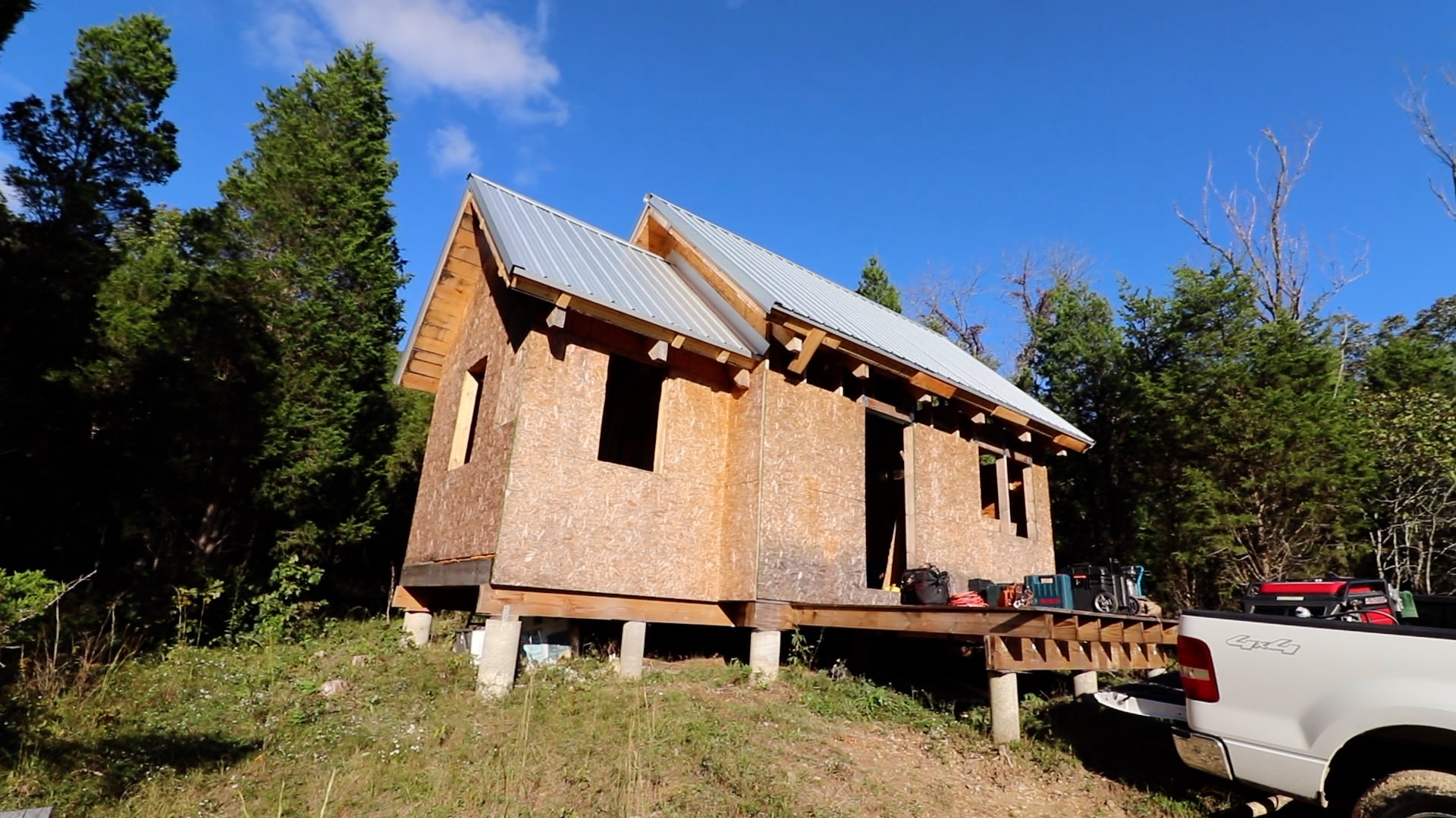

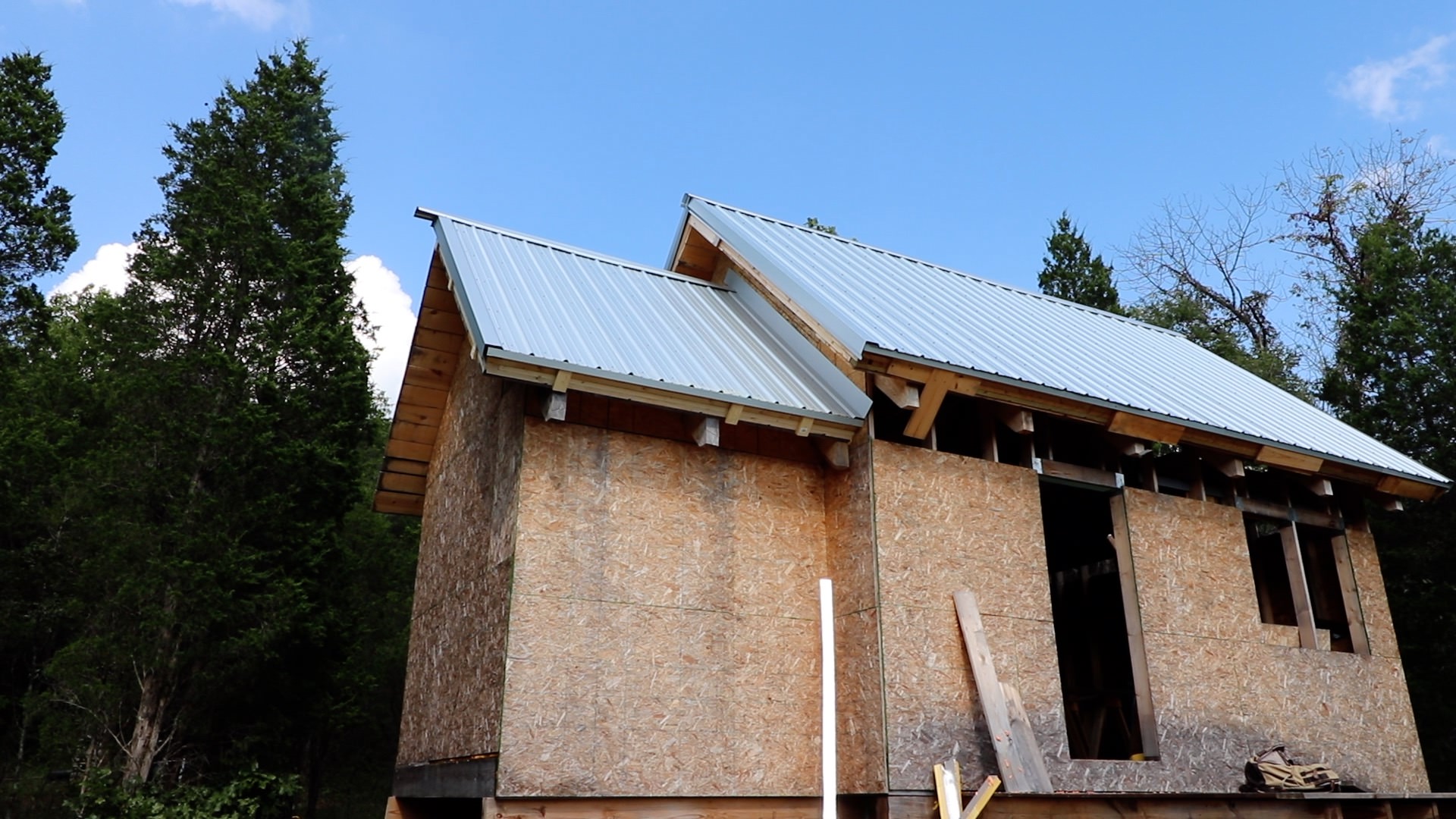

Made a bit more progress on Friday.  Finished up the roof more or less, couple little odds and ends to wrap up.  Cut out the openings for my remaining windows.  I'll be finishing sheathing tomorrow and starting on house wrap.  Also taking delivery of my doors and windows so I'm renting a UHaul trailer to transport them. We ordered Marvin Wood Ultrex, really excited to see them.
https://youtu.be/bNNMnX7_2VM

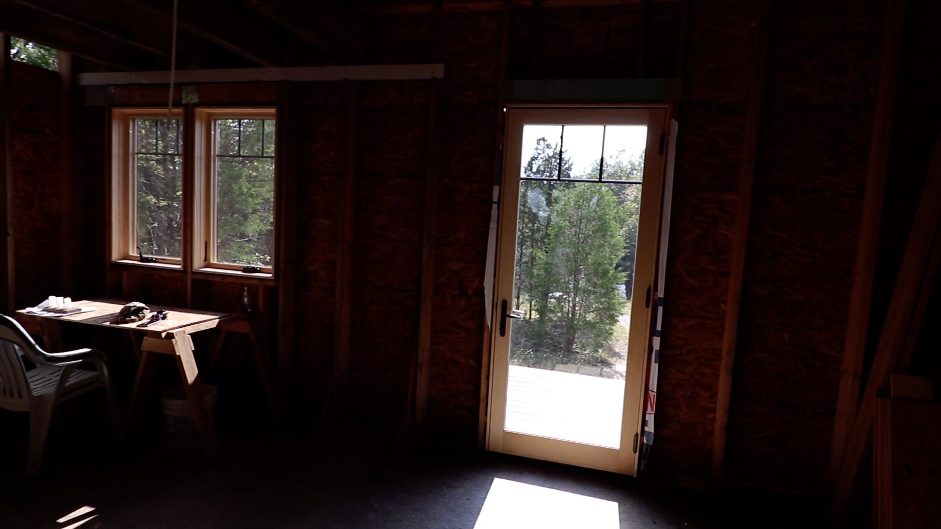

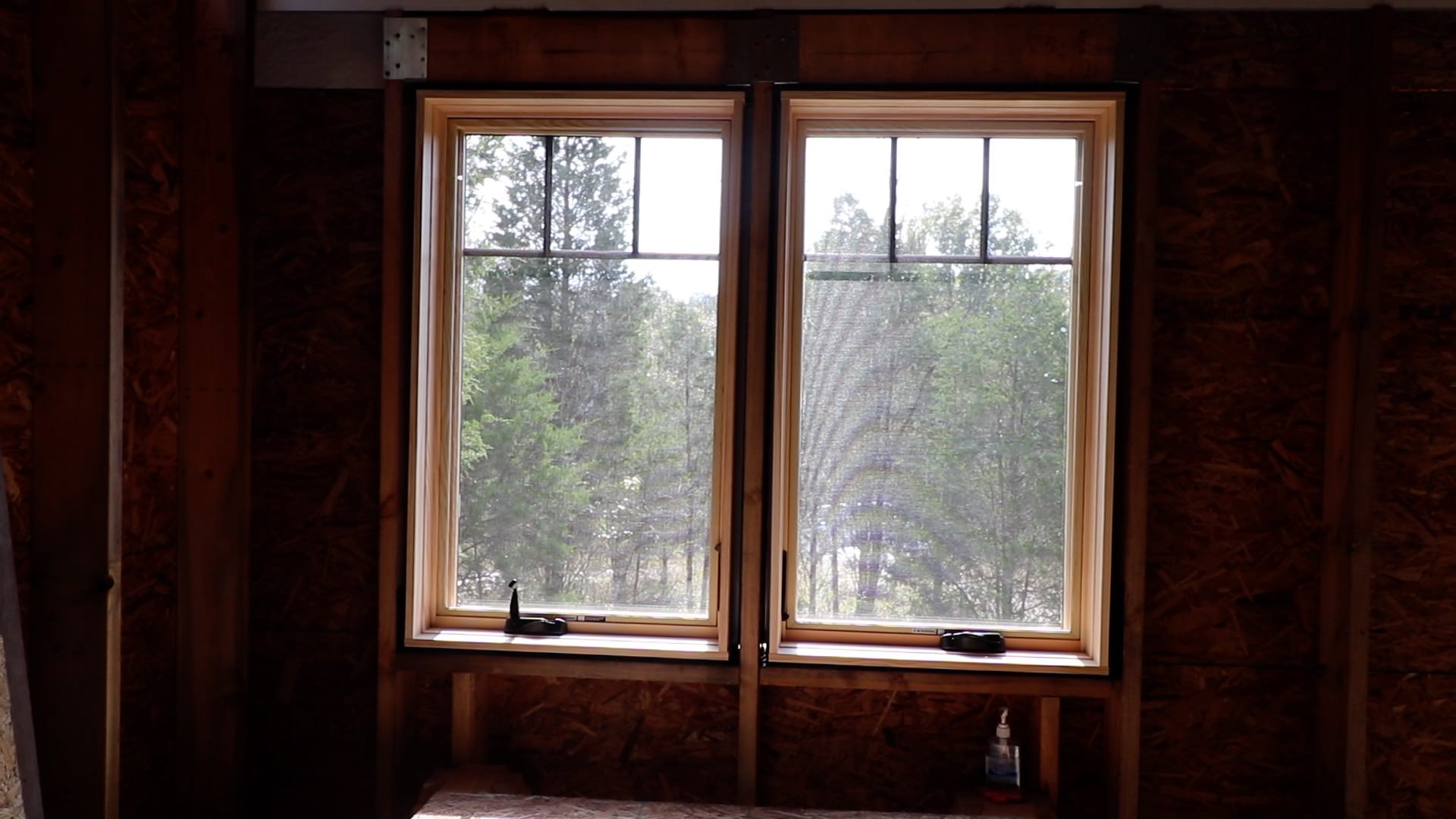

We got our doors and windows in.   They are Marvin Wood Ultrex, I'm very happy with them. Not too happy with how much they cost but what are you going to do...I feel a lot better now that they are in, it opens up a whole new season for me to work on the interior (winter).
https://youtu.be/RKb0X8bI6K8
Looks good. It is a real treat having windows in place; light comes in, no wind.
NathanS
Very nice looking windows and doors. Better to overspend once than underspend twice.

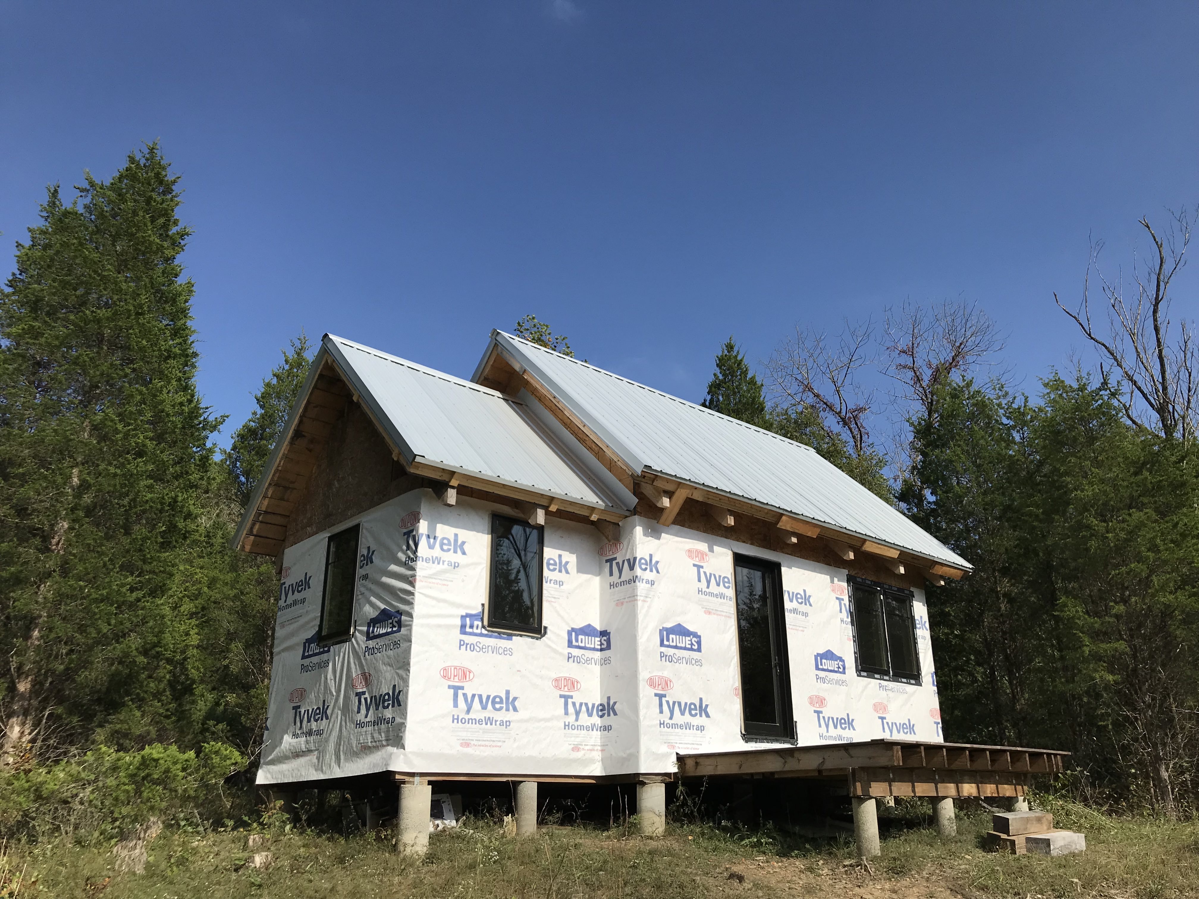

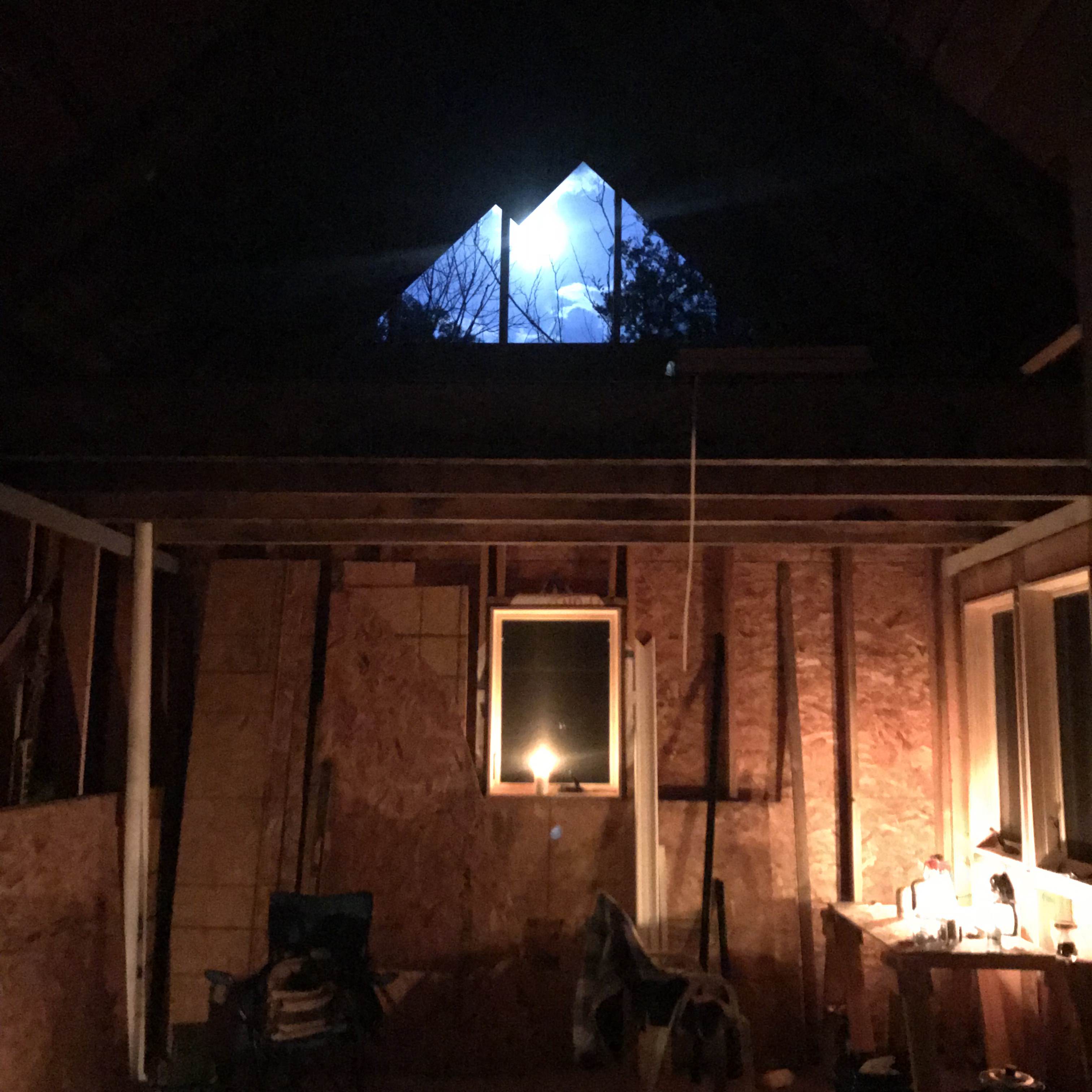

We're almost dried in except for the very top of the loft side gable end.  It was a neat coincidence that we didn't get that bit done because I was treated to a full moon shining in over the loft.  I hope to get that last bit of sheathing up tomorrow and then the rest of the tyvec on.   I also have almost everything I need for my solar installation except for one 30 amp dc breaker and some #1 wire for my inverter.  I figured I could get it local at Home Depot but they did not carry it.

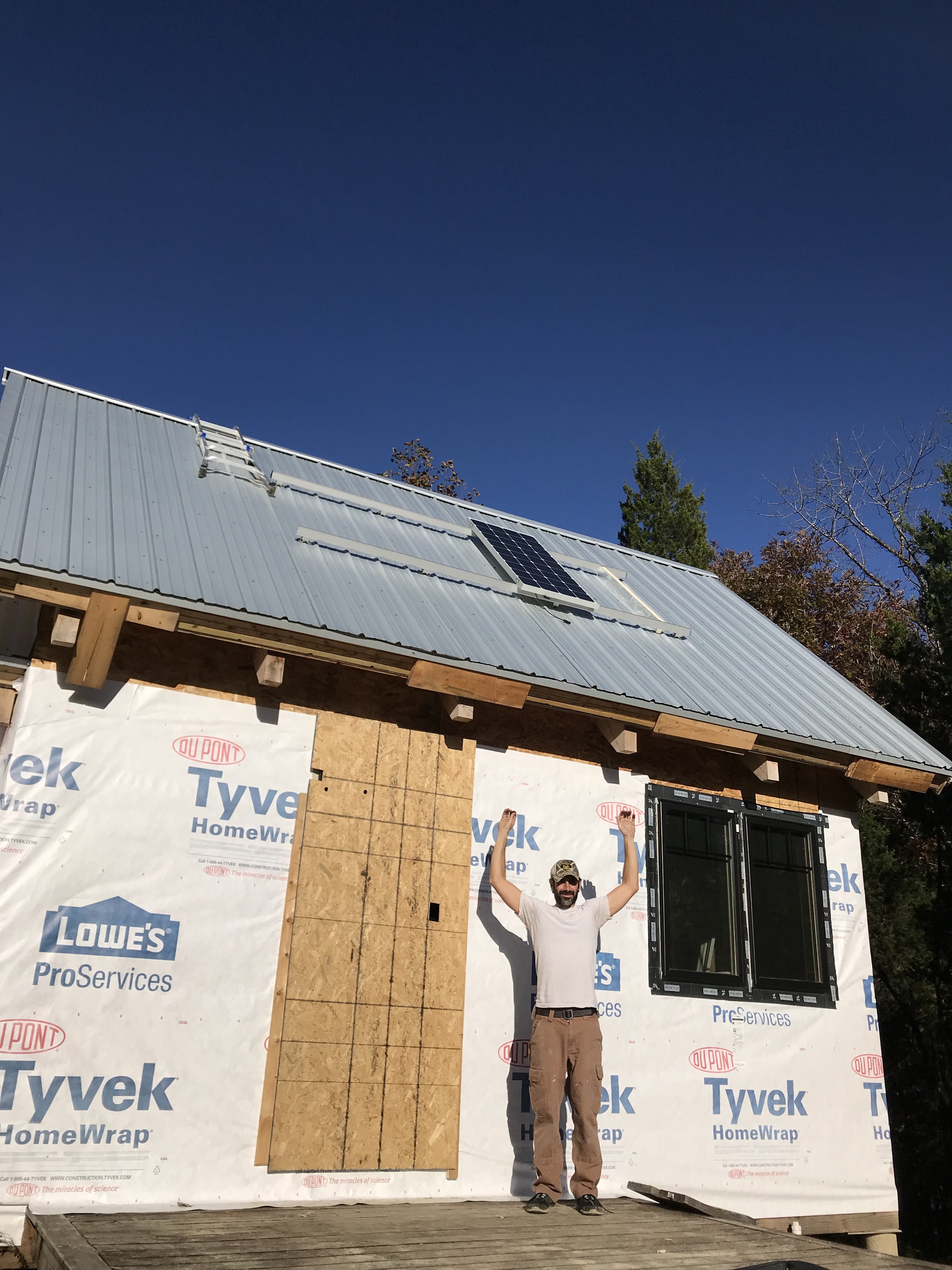

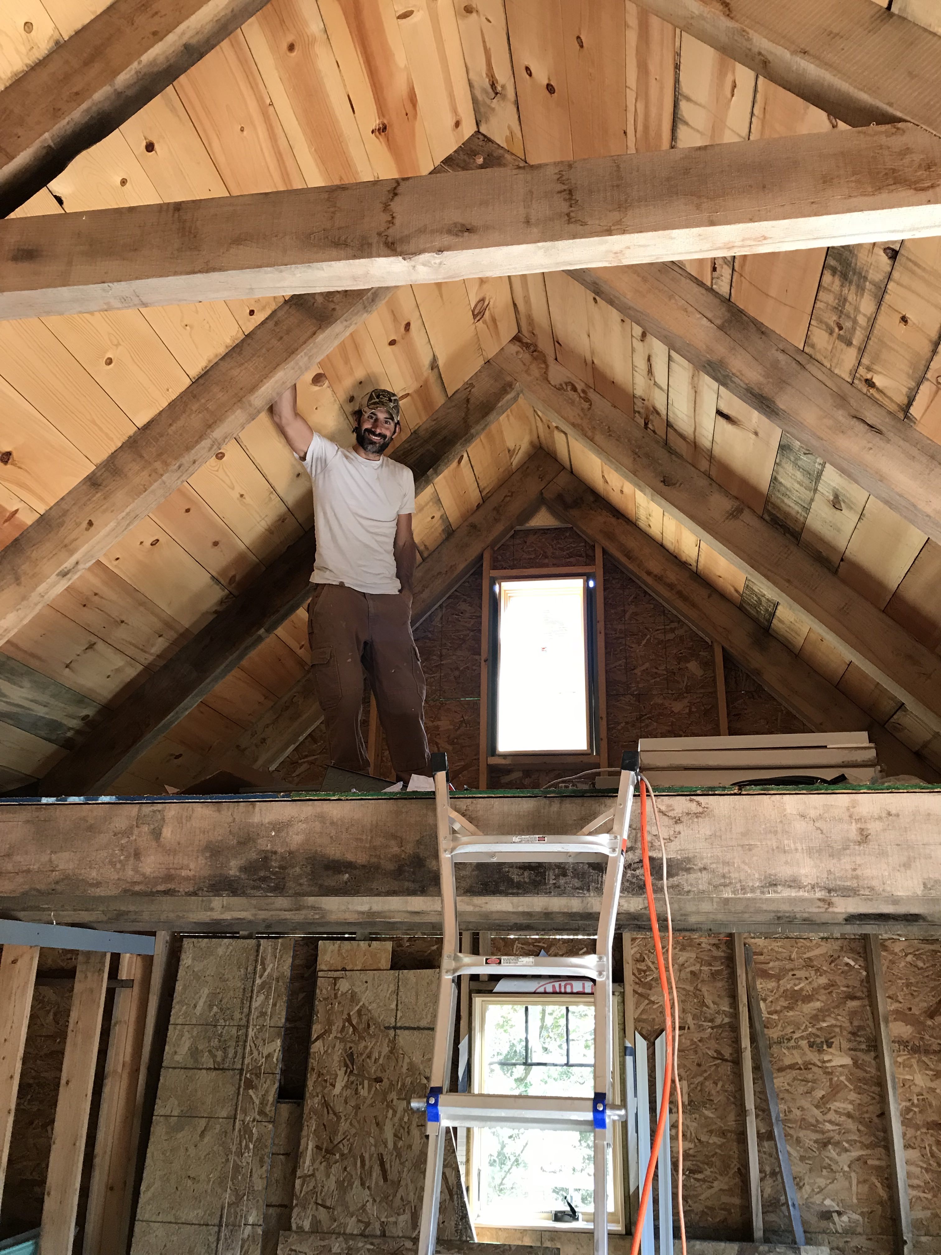

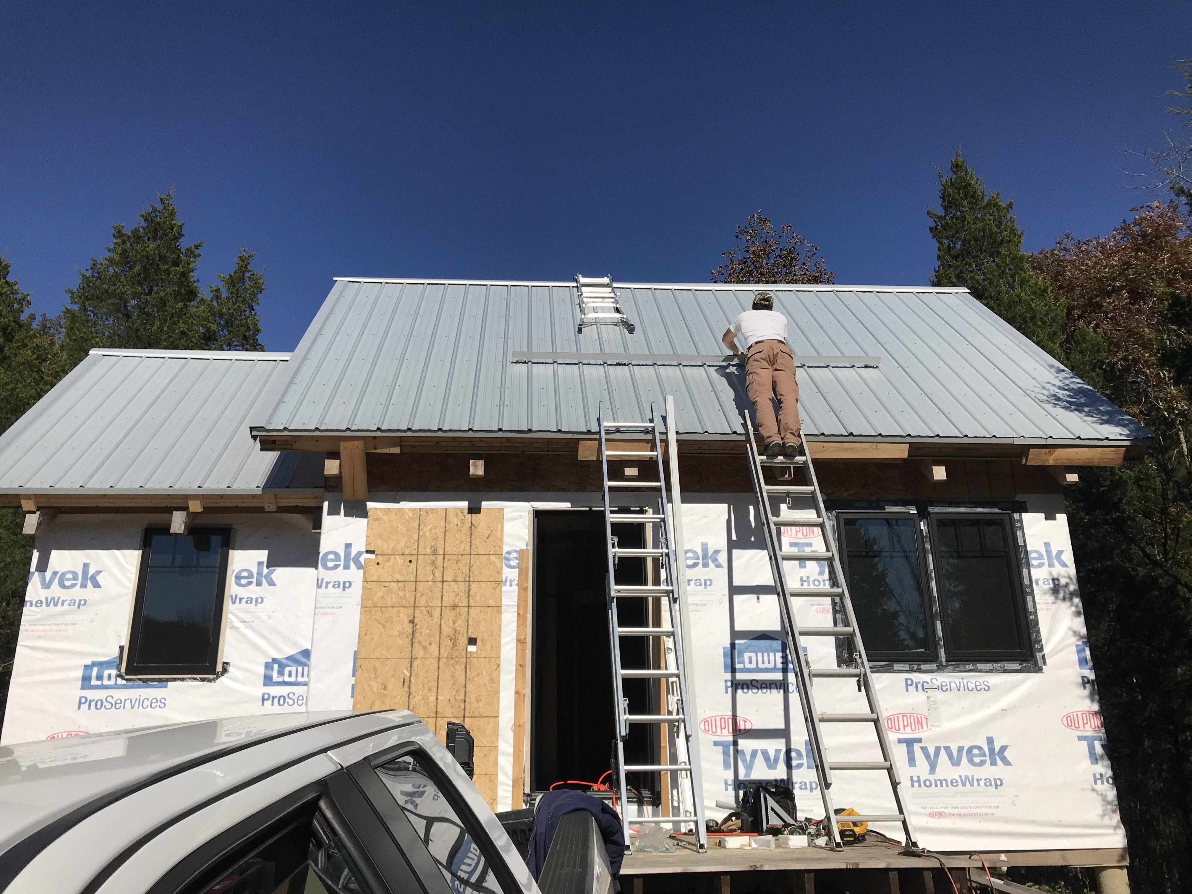

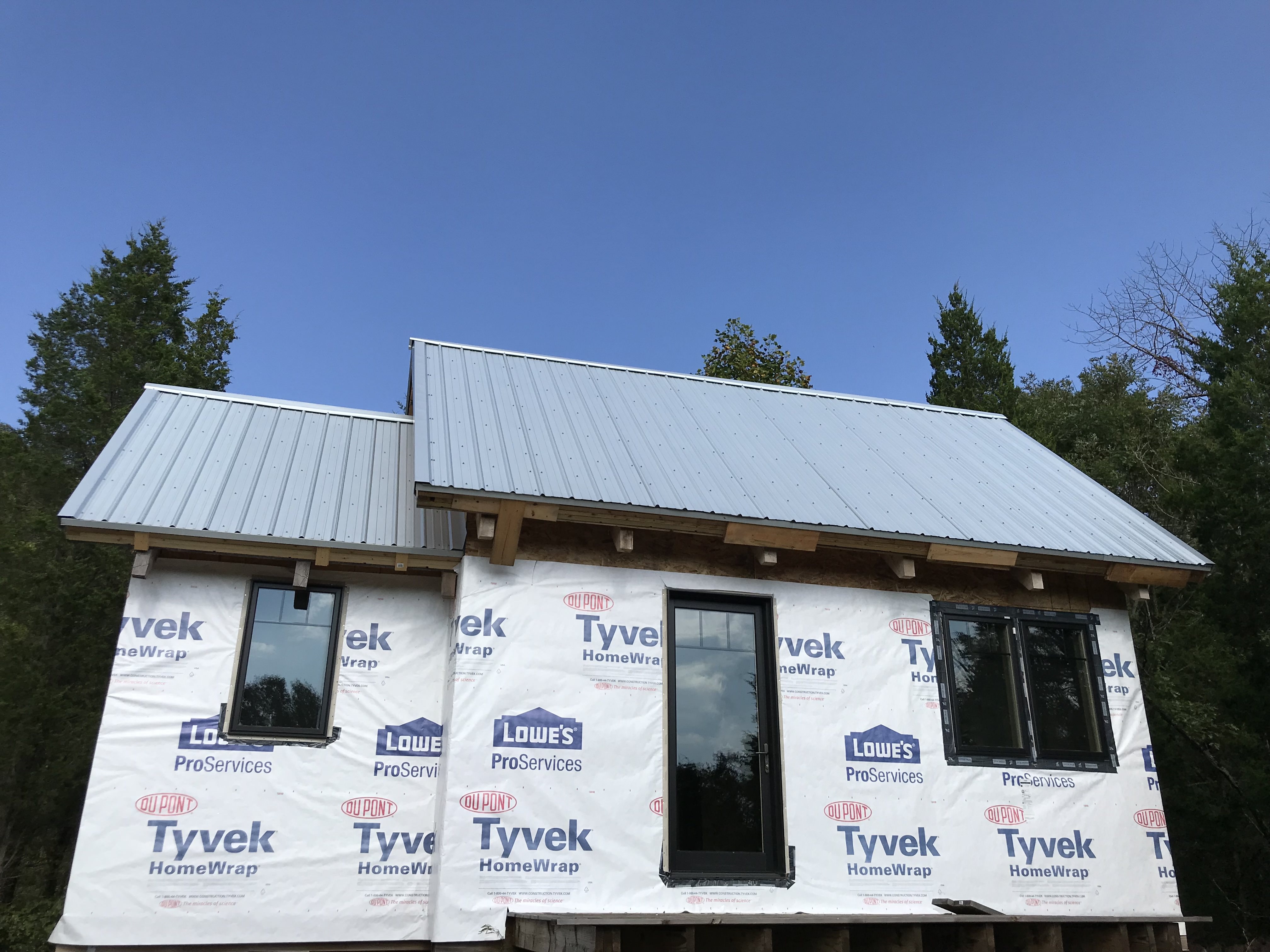

Made another trip today, got the loft in the window:
Started installing the solar panels!

Mike 870
Mike 870

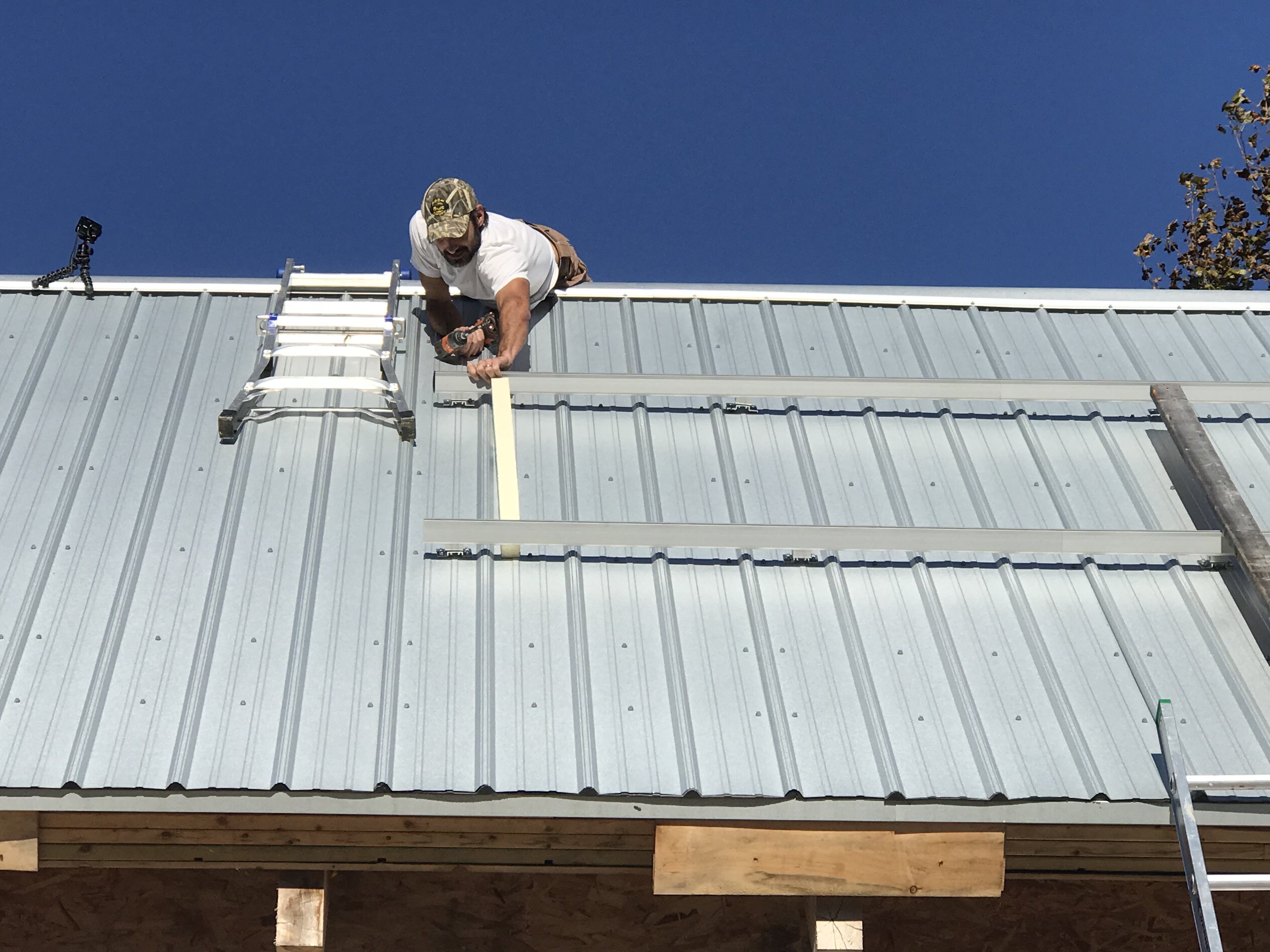

Made another video of putting in the last pieces of sheathing, the loft window and then installing the solar racking from iron ridge and got 1 panel up before we ran out of time.  My previous video kinda went mini viral, it got 18,000 views in a week, it was surreal getting so much views.
https://www.youtube.com/watch?v=hfGE0Uiwgg8
