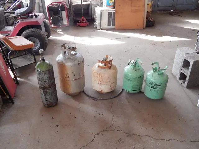

This is the majority of the materials I used.
Plus some metal from an old oil tank.

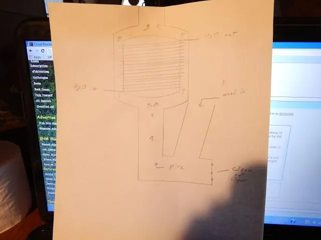

Basic design idea.

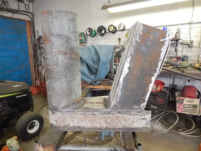

Internals mostly built.
With the outer shell.

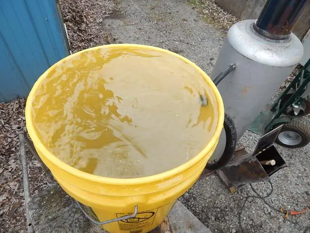

  First test with water.

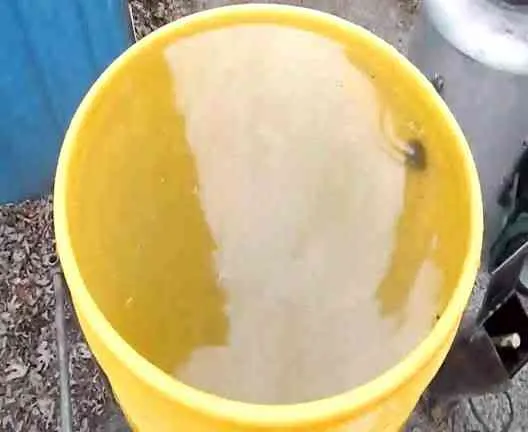

A Short video showing the therm-o-siphon effect. Click on last picture to see video.
  It works pretty well that bucket of water started at 50* and ended at 105* 15 minutes later. (Pat had a thermometer) Also note how clean it burns, and that was white oak cut last week.

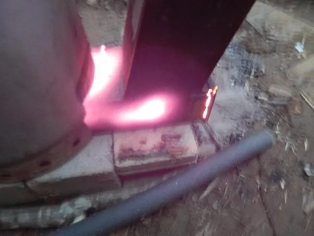

I haven't been burning this at dusk before. So I just noticed it looks like it gets warm.
    Wonder just how hot that is?
Have a nice night
Larry   :)
Larry
tommytebco
IIRC. red heat is around 1000 deg F, yellow is around 1300 deg F and  white heat pushes 2000 deg F.
tommytebco
no edit.
I just checked myself
red starts around 1000 and goes to 1500 ish Yellow is high teen to 2000 and white hot is over 2000
BiggKidd
Thank you so a brilliant orange I would guess between the two? Pretty hot for a wood fire!    [cool]
  Thanks again.
Larry
Larry
That looks about like the sides of my old woodstove just before it distorted heavily. I wonder what you can do to cool that zone without losing the fire's heat? I've come into most of the parts, this is looking really neat.
