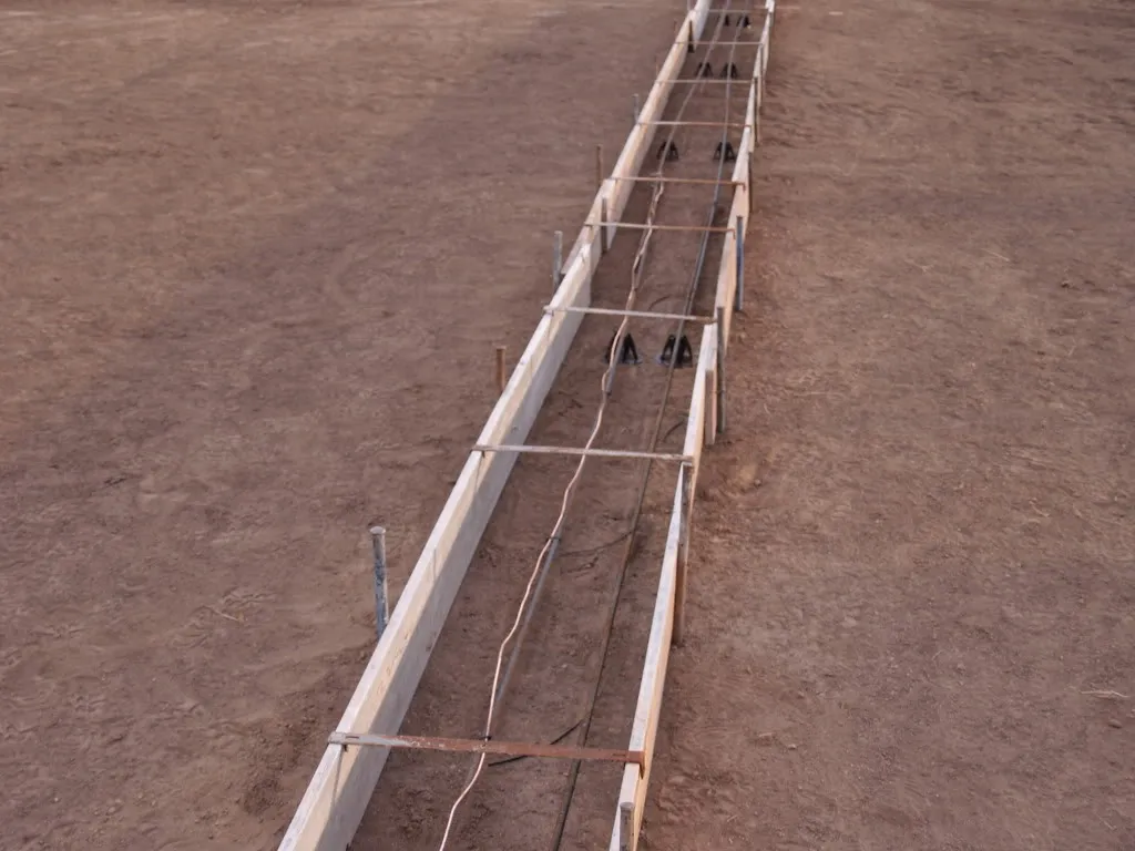

Two #4 down the center is most common and in all the books I read.
I used concrete bricks to hold up the rebar.  The concrete stands from the store sucked and kept falling over.
Overlapped and tied at the corners.
The concrete truck was able to drive the chute around and drop in strait in the form.
Tamp and screed.

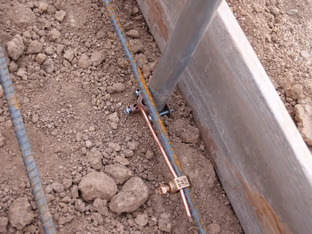

My shop photo shows - Technically rebar has to sit in chars that will not act as a conduit for moisture,  or be suspended from the top of the form down via tie wire.  Per the electrical code at the time I ran my grounding wire to the rebar and connected the ground to a frost free as well.

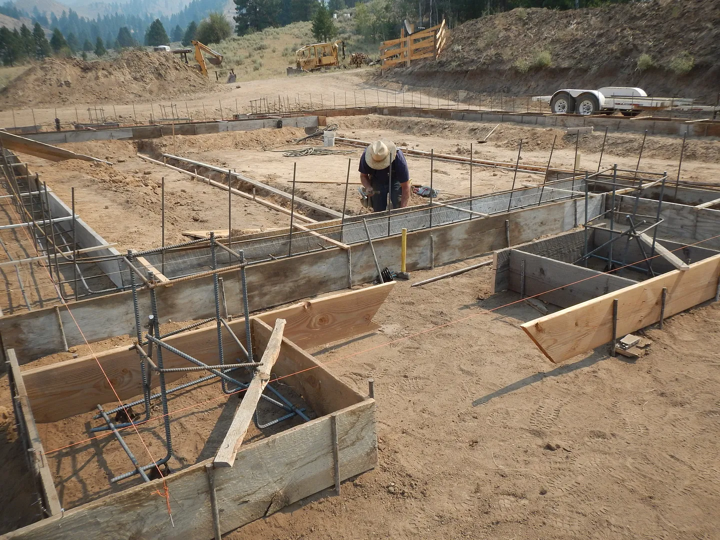

Proper corner note the splice out side run near corner.

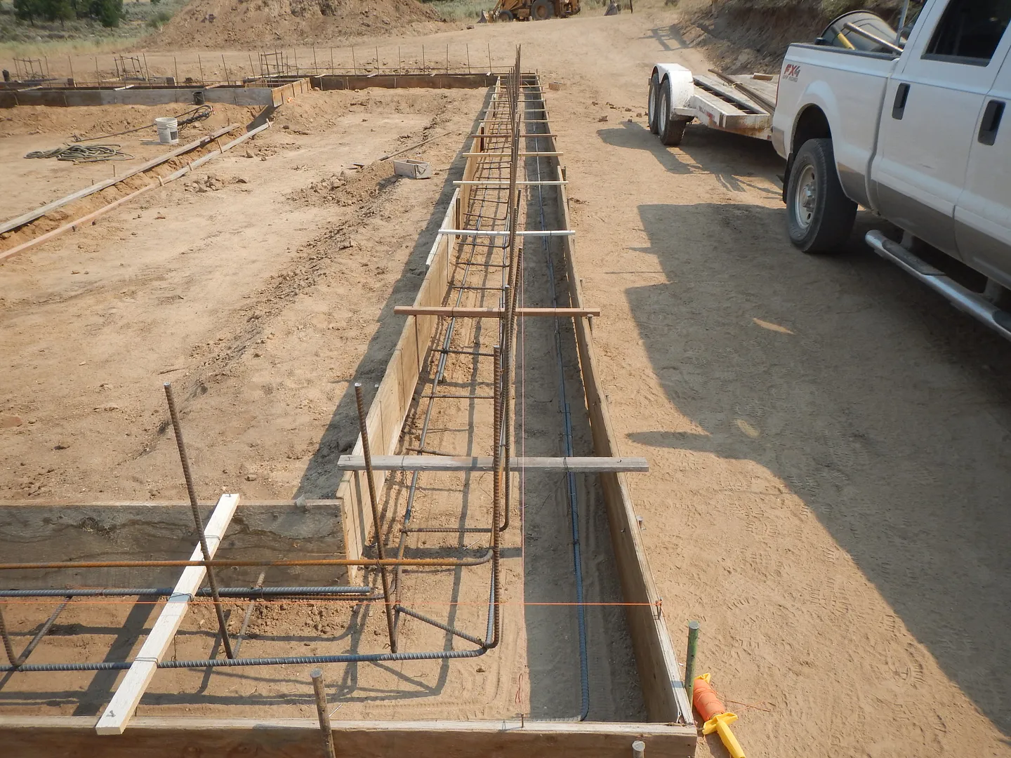

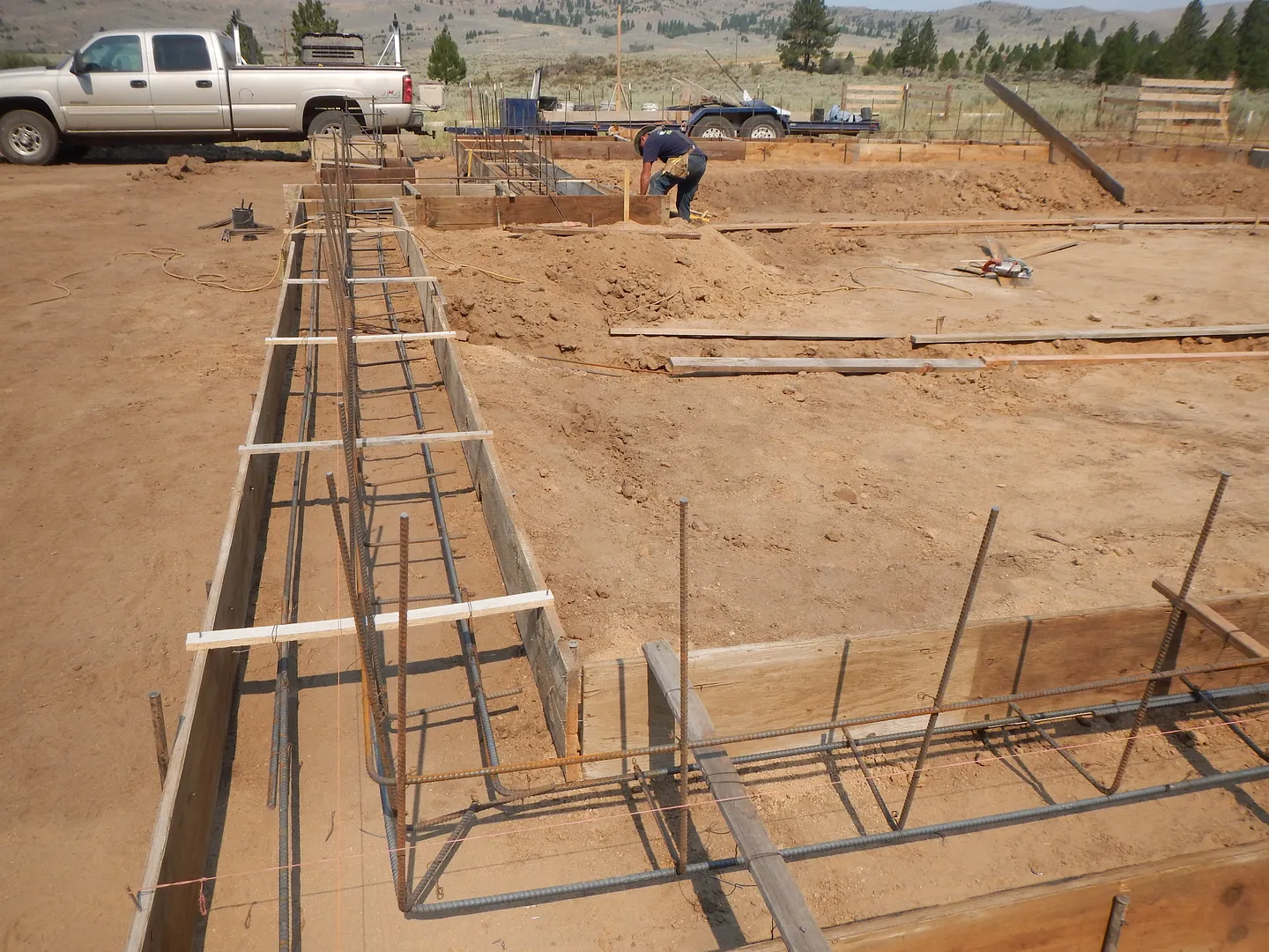

Note the verticals for the walls wired to the footing rebar and the the first run of the horizontal rebar.  We did not use any chairs here on this job in the footing but suspended it all from the footing forms.  Note the string line used to keep distance in the verticals so they will not touch and lined up properly for when we set the walls.
I did slip in some chairs under these pier rebar cages because it seemed easier than suspending them.
This is only about half the rebar that was required to go in to our home

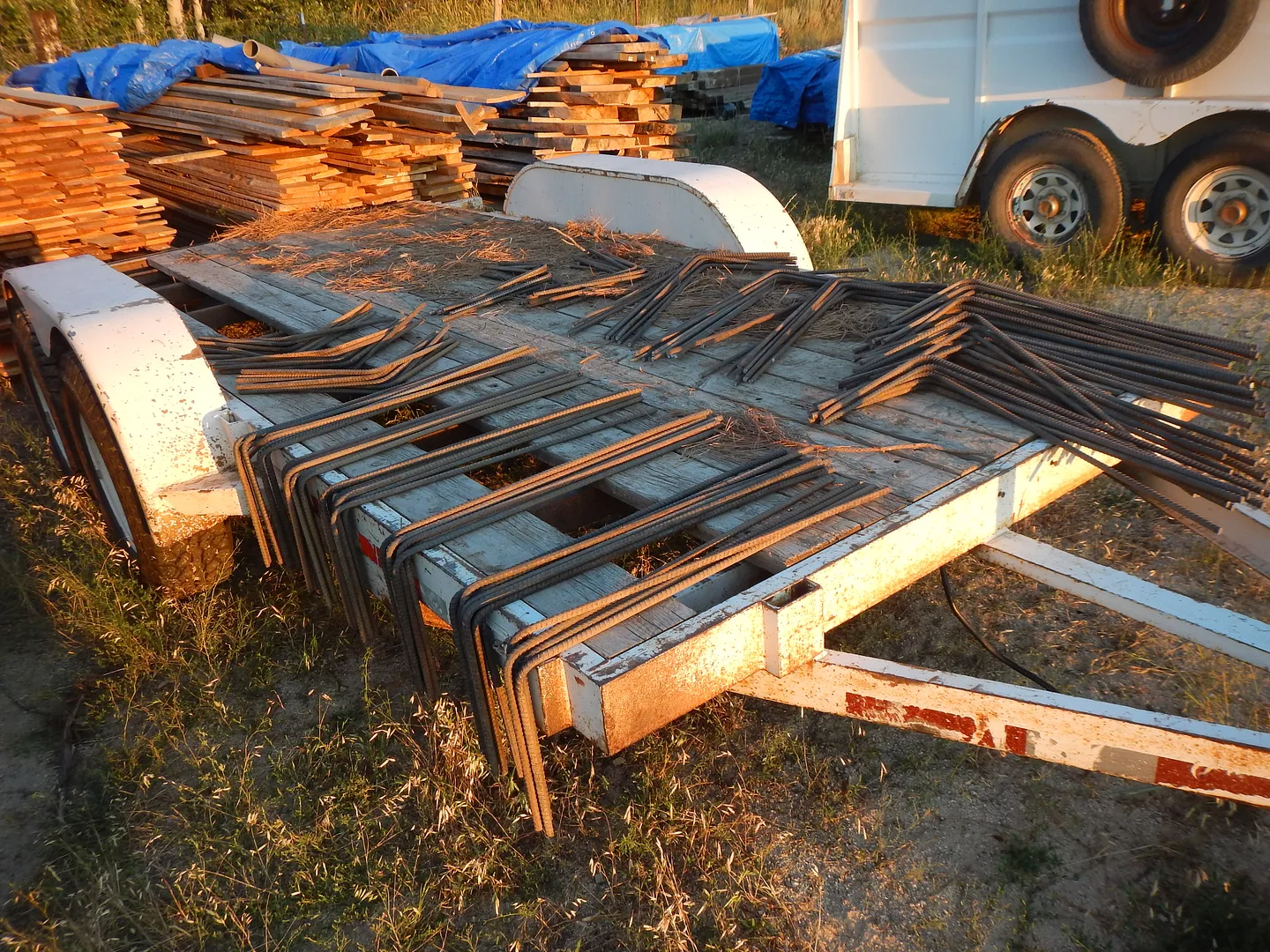

This is a cheap rebar cutter and bender that works well with 3/8 and half inch rebar.  5/8 even gives the big commercial cutter and benders a work out.  Just a side bar if 5/8 is required a person might want to look at buying them cut and bent at the jobber.  Long bars are bent as you place then in the forms.  measure and allow for the bend and the joint laps mark the bar and go to the bender.
Most of the verticals and horizontals cut and bent for the house.
