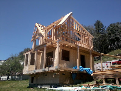

  I just got the same Simpson post caps that join beams and flipped them upside-down.  They hold the ridge beam and the 6x6's, too.  They weren't cheap though
  If you can't imagine what these strongties were actually designed for, here they are in action--
  You have to pay attention to lefts, rights, and corners and order the correct thing.  You also have to carefully drill really big holes very straight (it's best to drill part way through one side then find that hole drilling from the other)  So in your case you'd order them with W1 (and W3 if needed) at 4", and W2 at 6" (or 4" if you go with 4x6 and they are turned that way.  I really like the stout look and feel of the 6x6's though)
