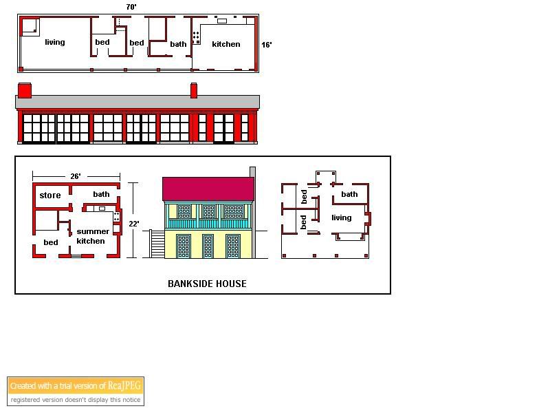

Rather than hijack the other thread where I posted some of my designs using the Paint Program, I thought I would start a new one to show you what can be done.
I've used  the basic Paint Program that is part of Windows for years as a way to work out ideas and draw relatively simple plans and elevations.   Actually it isnt that hard to do although it does take a good solid knowledge of the 12times multiplication table. Wink   If you have ever drawn with paint, you may have noticed that it can be set with a grid pattern.  Ive always assumed that each grid was a pixel and I  generally use the scale of 1pixel:1inch.   So if I want a line 12 feet long  I draw a line that is 144 pixels.  You can set paint to draw a box automatically so I usually decide the dimensions of the building and draw the basic box first. I usually make all the walls 6inches thick just for convenience sake. I then draw the inside box of the structure and then just start measuring out the rooms and laying out the walls.  Its a bit like actually laying out the sill plates of a house or building with blocks. It goes fairly quickly.  As to doors and windows, once I have drawn one of the right size,  I cut and paste it unto the plan where ever I want another of the same size.  I do have a little file made up with basic windows and doors predrawn both in plan and facade and I can pop them in as I go along.
To draw the elevation, what I usually do is cut out the wall I want from the plan and paste it at the bottom of a clean page.  Then I set a base line above it for the floor level and draw the basic box of the elevation.  Then I  run lines up from the wall plan below it to mark rough openings and other details.on the facade.  Then I pop in the windows from my little library or draw the window free hand and then cut and paste that one into all the rough openings.
So its really a combination of free hand drawing and cut and paste.  For really small detail work I crank up the magnification and work on one area at a time.  Its a bit like doing needlepoint if you ever done that.
The major limitations are ones of scale.  At 1pixel/1inch, you cant draw anything much bigger than 50x40 feet and that fills the screen.  So for anything bigger, you need to change the scale. it takes a bit of math at the start but once u decide what scale you want u can go ahead.  Also very small structures are hard to do at the 1p/1" scale unless you use the magnification feature to work.
Another limitation is that u cant really draw a clean line unless it is truly horizontal or vertical.  The cleanest diagonal line is 12/12 pitch. Its a minor problem but does make drawing  gables and eaves a bit messy.  It takes practice.  And of course drawing in perspective is impossible.   You can do curves but its tricky.  Ive done a few round rooms and it about drove me nuts. Huh
These arent by any means working drawings but a good contractor/builder would probably find them sufficient for simpler projects.  After all, a lot of grand houses in the 18th and 19th c. were built from drawings and plans in simple building books passed around town. Robert Morris, Select Architecture(1755) Alexander Jackson Downings, Cottage Residences(1852),  Asher Benjamin's, The American Builder's Companion(1806).
This is a very simple example of quick plan and sketch with very little detail work:

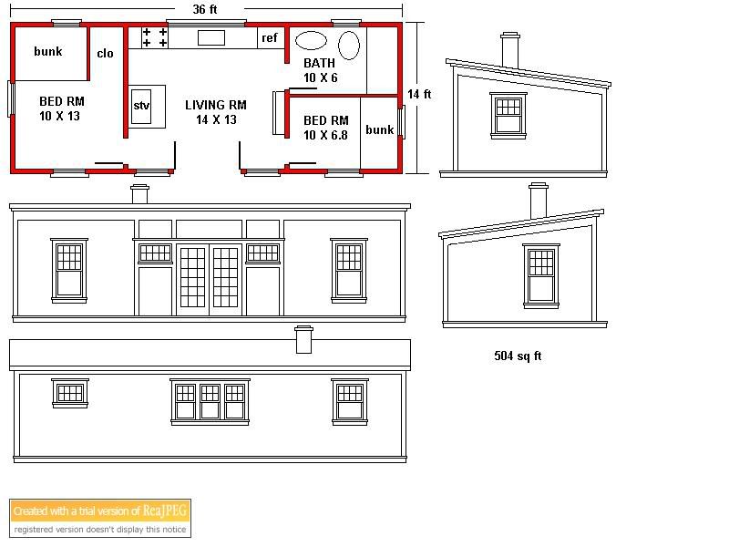

This one shows how I project the elevation from the plan and use cut and paste to add elements:

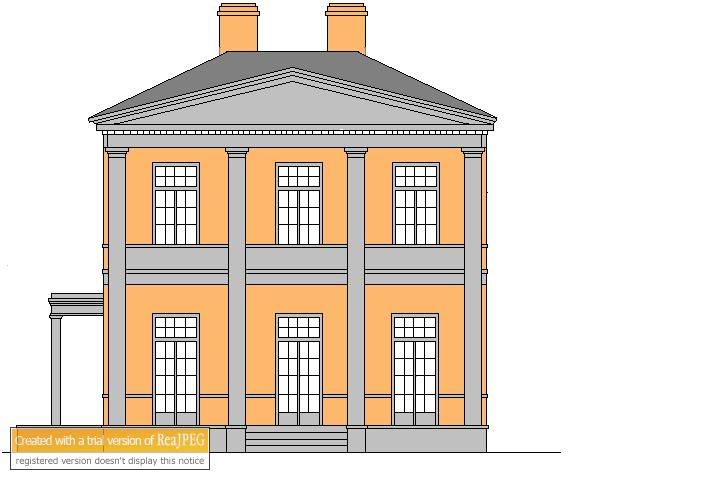

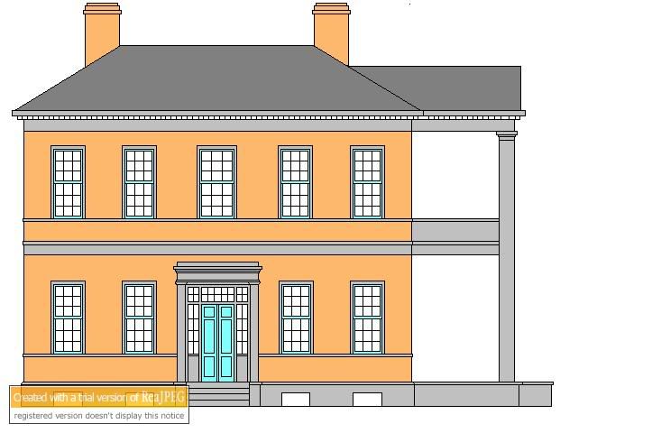

These last three drawings show just how elaborate I can get using Paint.  Most of this is still cut and paste but it permits a good deal of detail:

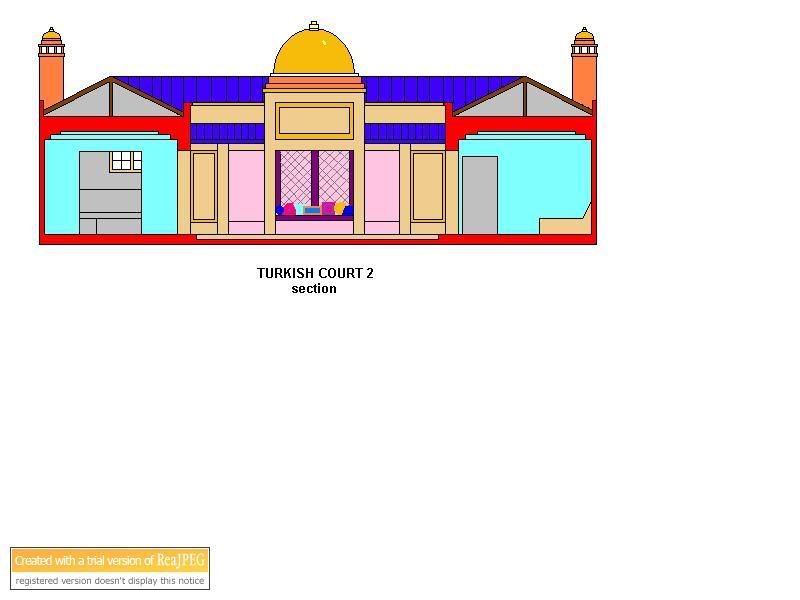

This is a section drawing for a little turkish fantasy. Shows that round elements are possible as well with a little work:
