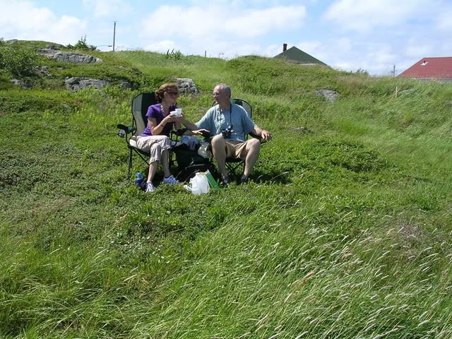

This is the view from our property facing southeast (but mostly east).  The lawn chairs are at the spot where we would like to build.  You can see the bedrock (ledge) outcrops in the photo.  This is right on "iceberg alley" so icebergs are sometimes visible in early summer.  Also sometimes see humpback whales breaching in the distance during July or August.  I grew up in this area but moved away about 35 years ago...living in Colorado now, but we try to visit every summer.
Still deciding what to build, but thinking of a small 1 story using a modified version of the Volks cottage plan.  Perhaps just the 26x28 foot section to start - 1 bedroom - with a covered porch facing east.  Due to time constraints I will probably contract the foundation and shell...then finish the inside during vacation time.  I will post a sample floorplan for comments when I get it finished.

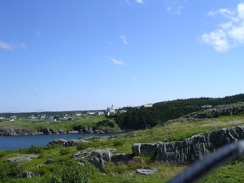

Another photo looking towards town...as you can see...more rock.  Actually, that's the nickname for the island..."The Rock".  This is the small fishing village of Elliston, Newfoundland (pop. 350) - check it out on Google Earth.  Not the end of the earth...but you can see it from there.  Beyond those islands you see from our property...the next stop is Ireland.  The next larger town (pop. 3500) is 5 miles away...and the nearest stop light is 70 miles away.
We plan to start small with something we can use for vacations, with the possibility to add another bedroom or porch/mudroom as we get to use it for longer periods in a few years.  I am thinking single story to avoid stairs and for ease/speed of construction since I will need to hire a contractor for the foundation and to put up the shell.  That's not something I can accomplish in a 3 week vacation.

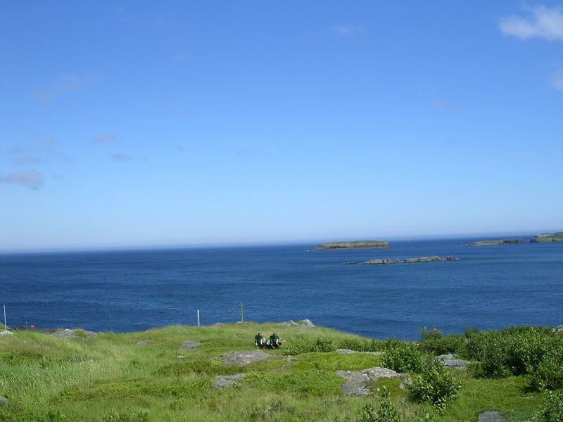

A picnic with a view.  This is where we want to build.  Not much soil...only supports grass and blueberries.
Fetching ice for my beverage ;)
Pin and pour.  Although not completely impossible to pour a footing and lay blocks but very labor intensive.   The poured foundation/crawspace would be faster.  I would also look into a coating (epoxy) for the exposed concrete being that it is exposed to salt/spray.  As for the underground lines I would say that it is almost impossible to find enough soil to cover 3-4' and  shipping from someplace else would probably be cost prohibitive. But "if" you could the elevation of the house would be made to compensate for the utilitiy lines unless you have to raise it so much on the sewer to have it flow by gravity or pump it up hill.  What an ideal location for a house.  I hope you can work through all the challanges.
