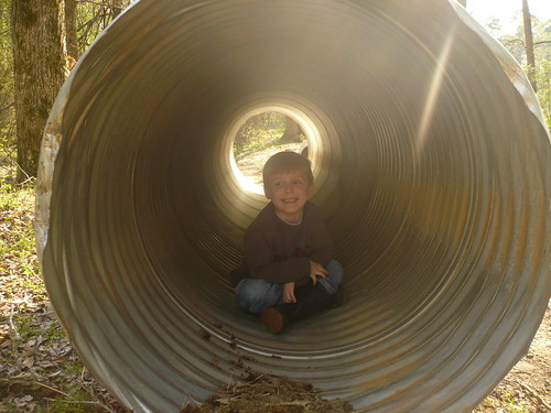

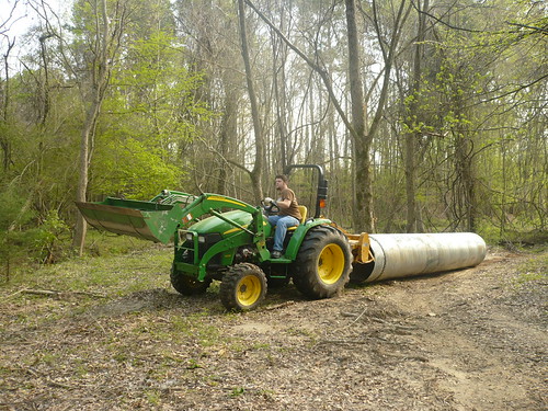

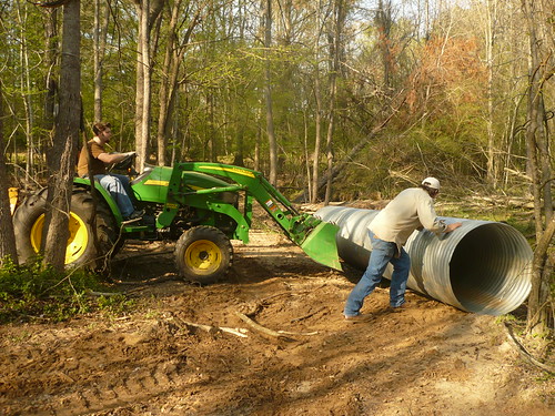

Progress. Feels Nice. In another post, I inquired about how to get across a creek. My dad found a good deal on a culvert.
Hooked it onto the Deere and off we went.
Of course, I had to clean it out first before we installed it.

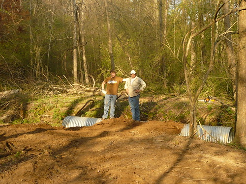

A little team work and a bit of horse power and it dropped right into place.
A bit of dirt work later, and the wife took advantage of the father/son photo op.

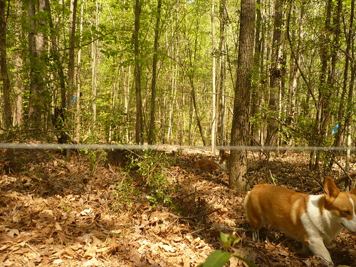

Now that I have access to the 'other side', the chainsaw got a break when I cut the perfect swinging vine. I had to show my 5 year old how it's done, and wouldn't you know, someone was there with camera in hand.

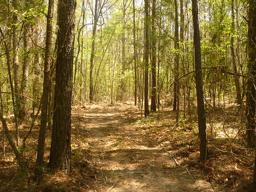

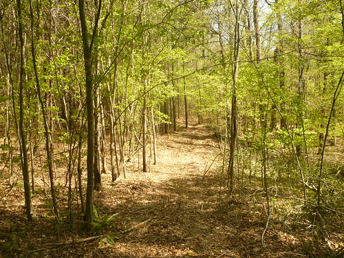

Once play time wore me out (after about 5 minutes). The real work began. Continuing to clear a path to the future cabin site.
Fast Forward 3 full days later, and about a half mile of chain saw butchering, tractor pushing road clearing fun, and me and the Corgies take a break at the future home of my hillside hide out.
Progress is good. Visual Progress is even better. And when it takes hard work to get it done, it's a nice feeling of accomplishment.
I got more done than I expected to on my 4 day break, and I'm really excited now. This was my first committing act towards building a cabin.
Thanks for everyone's support.
Looks like a nice site.
I don't know if you already know this or not, but when making a road through the trees and you have a tractor, it's easiest to use the machine to push over the trees, then cut off the stump. It's easier to deal with the stumps and root balls that way.
fraggin
Thanks for the tip. I did as many as I could that way. It's amazing that a 2" stump can stop a tractor in it's tracks.
