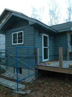

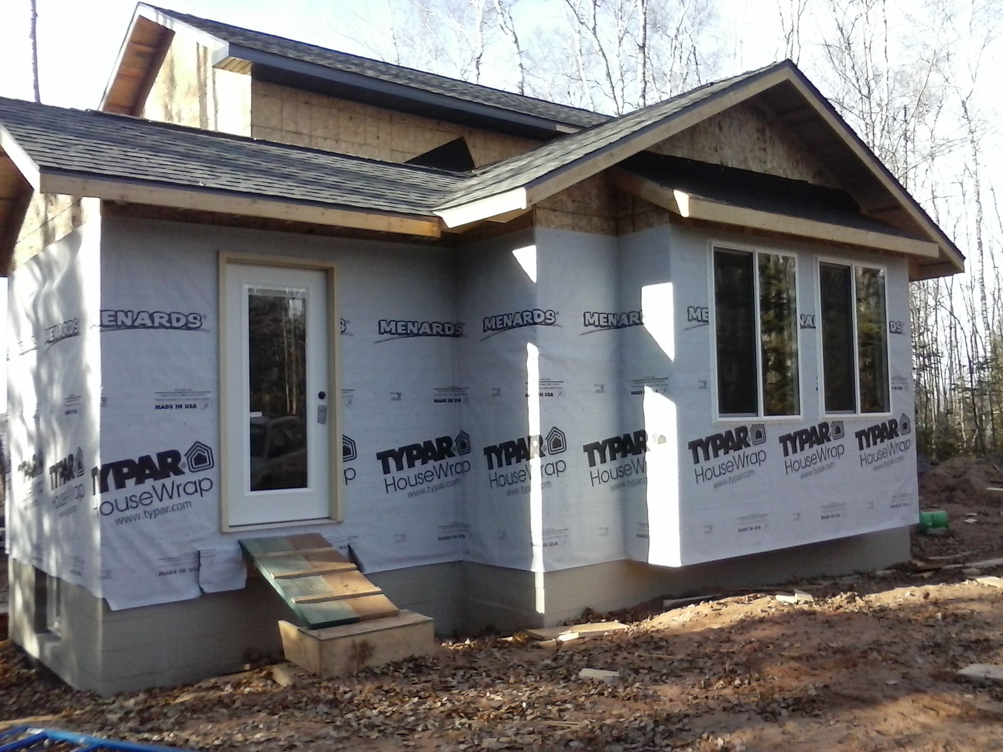

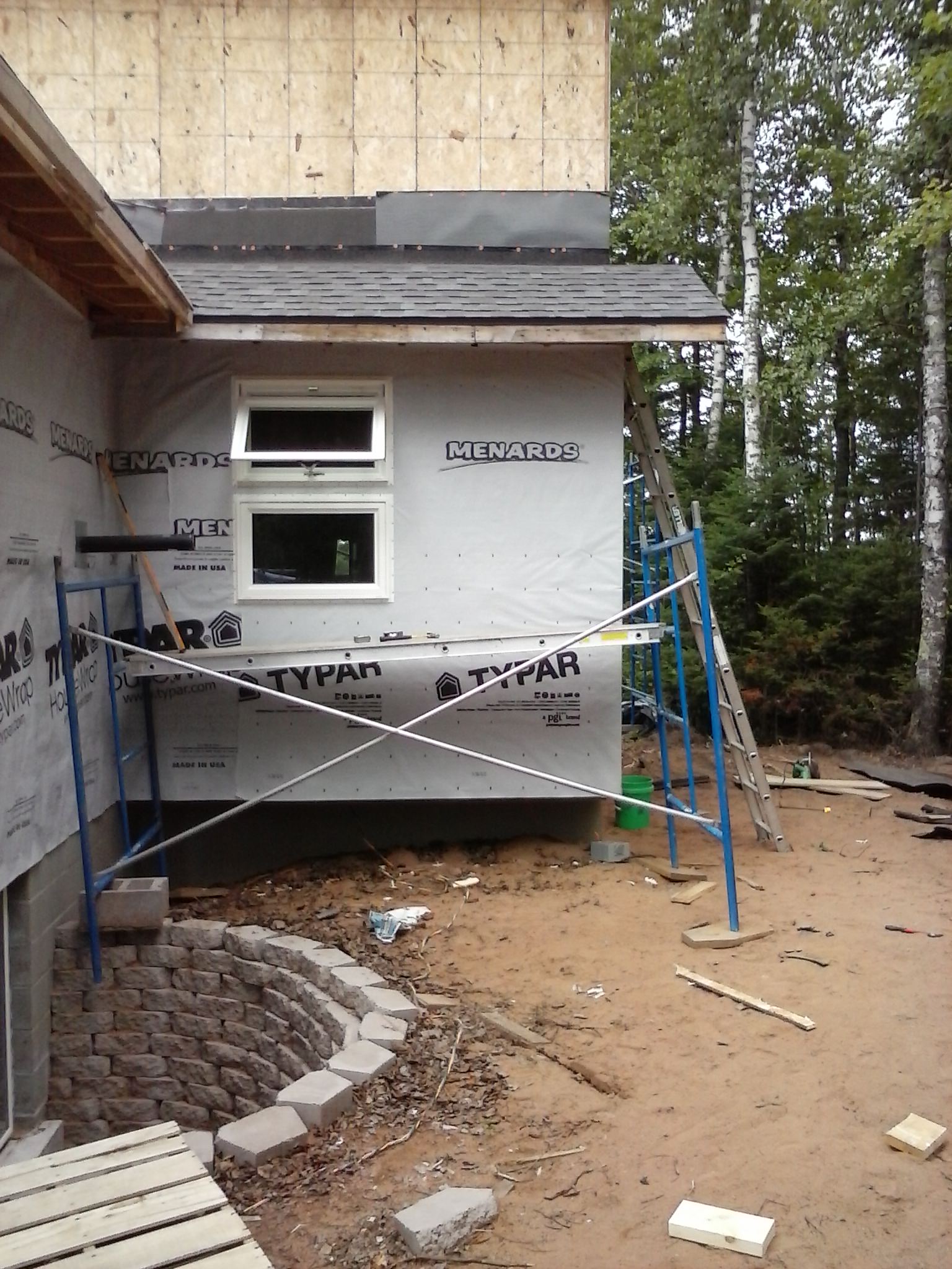

I made some more progress on the siding,not as much as I hoped I killed another air compressor and then it rained and snowed for 2 days which put me inside.I got the main bath wired and lights installed which is really nice, also put lights in the kitchen and added outlets in the bedroom and was able to insulate one wall and one of the shed roofs. Then took a couple days off to hang with the family took them to lake superior to cook hotdogs on the beach then back to bonfire and I made ribs for everyone. Of course I wish I had got more done,But I enjoy the ride probably more than the destination.

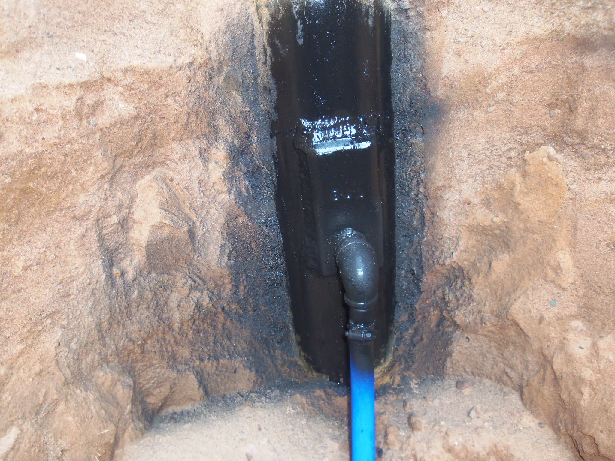

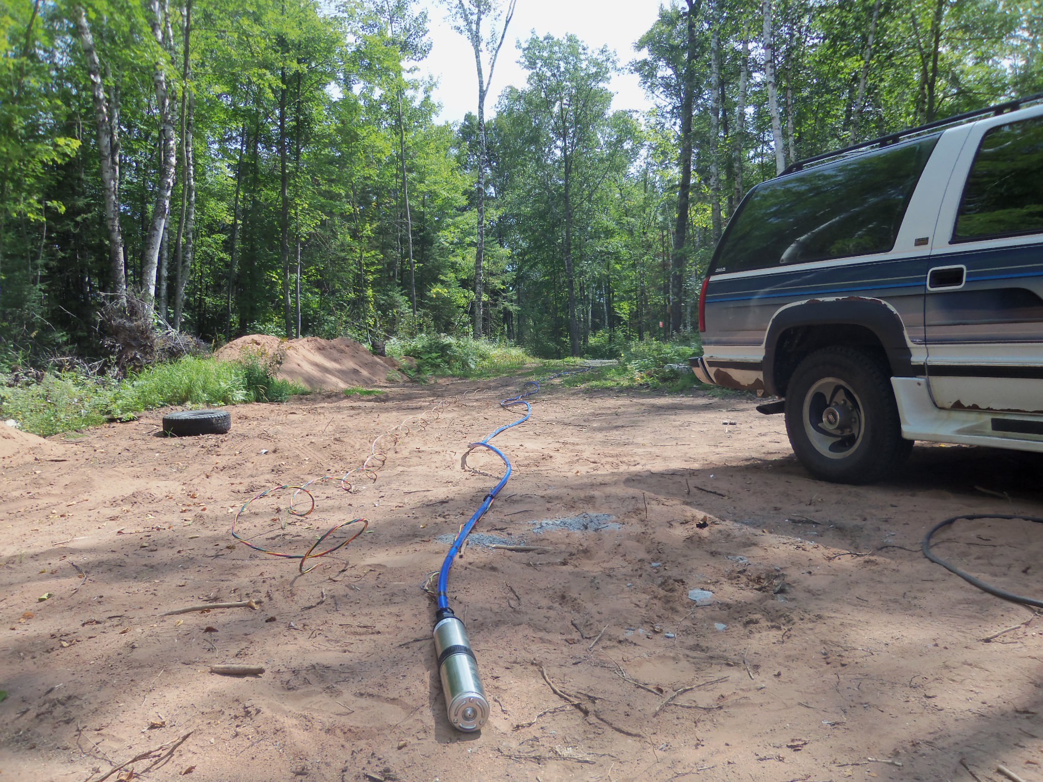

We always planned to make it bigger from the start,But after having my whole family up we fast tracked it. We build as we have the money available and plan on one more addition to the lakeside,But we are planning to move there permanently before we do that,It is very difficult to build being 3 hours away.We are shooting for 2 years from now. Welded the pitless in and installed the pump.

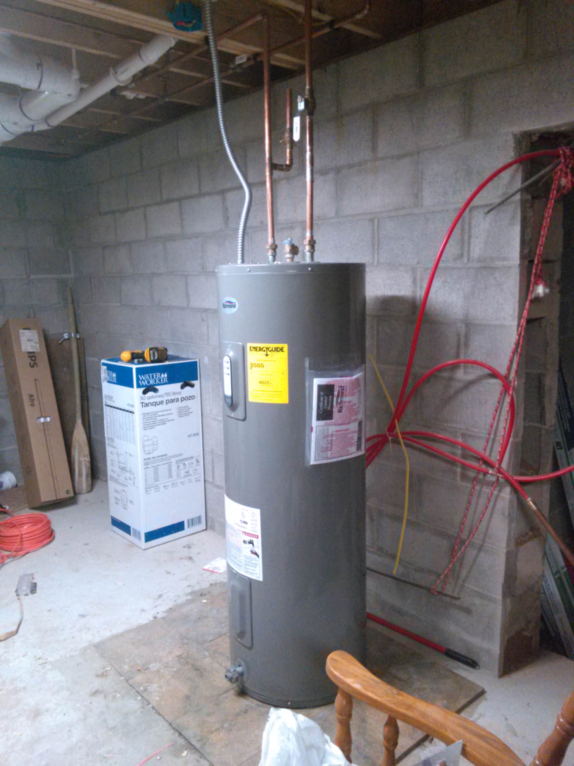

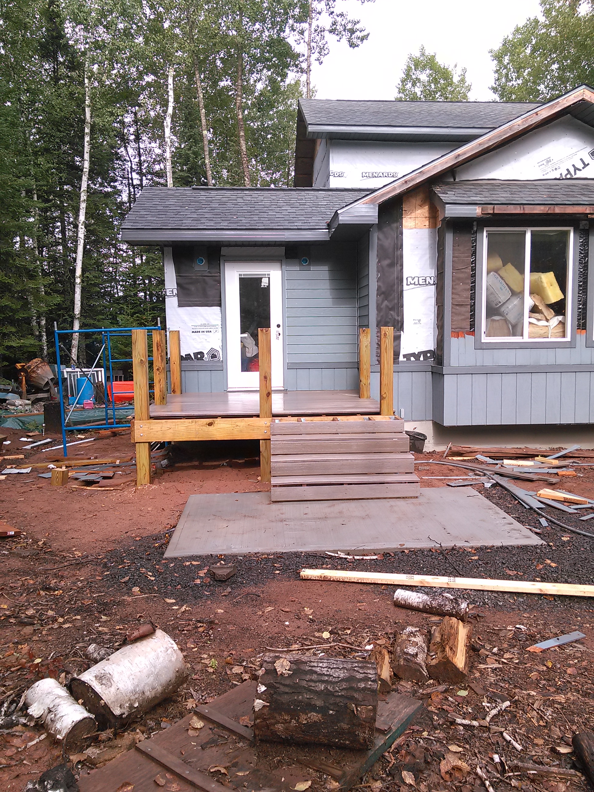

Well its been a while but we are still clipping along with the ball and chain we removed some more stumps and have been burning a lot,most of the plumbing is complete and we have hot water now via electric tank heater.the tub is in upstairs and the main level shower is in and functional.The stove pipe is in and complete for the boiler from the basement through the roof.I installed another window in the upstairs bath and just picked up one more for the mudroom.poured a pad for the deck and am almost ready to put the decking on now.More siding is on and we cleared more of the beach and started the L section of the boardwalk.Called for our garbage cans and started installing kitchen cabinets I had to order another one as the drawings did not match up with reality.We bought some canoes this year and have been able to boat around the lake which has been fun still no fish for us but we are trying.

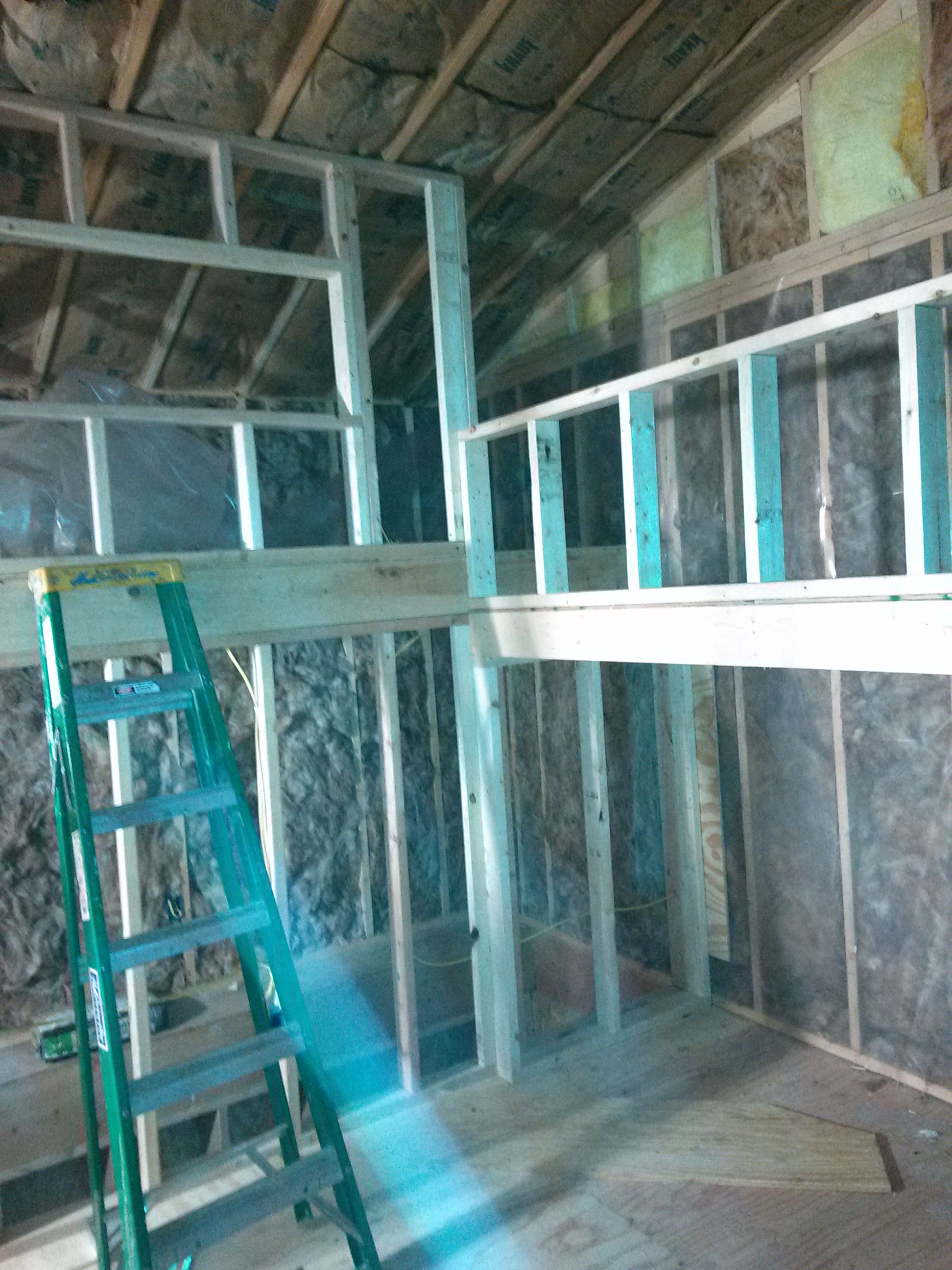

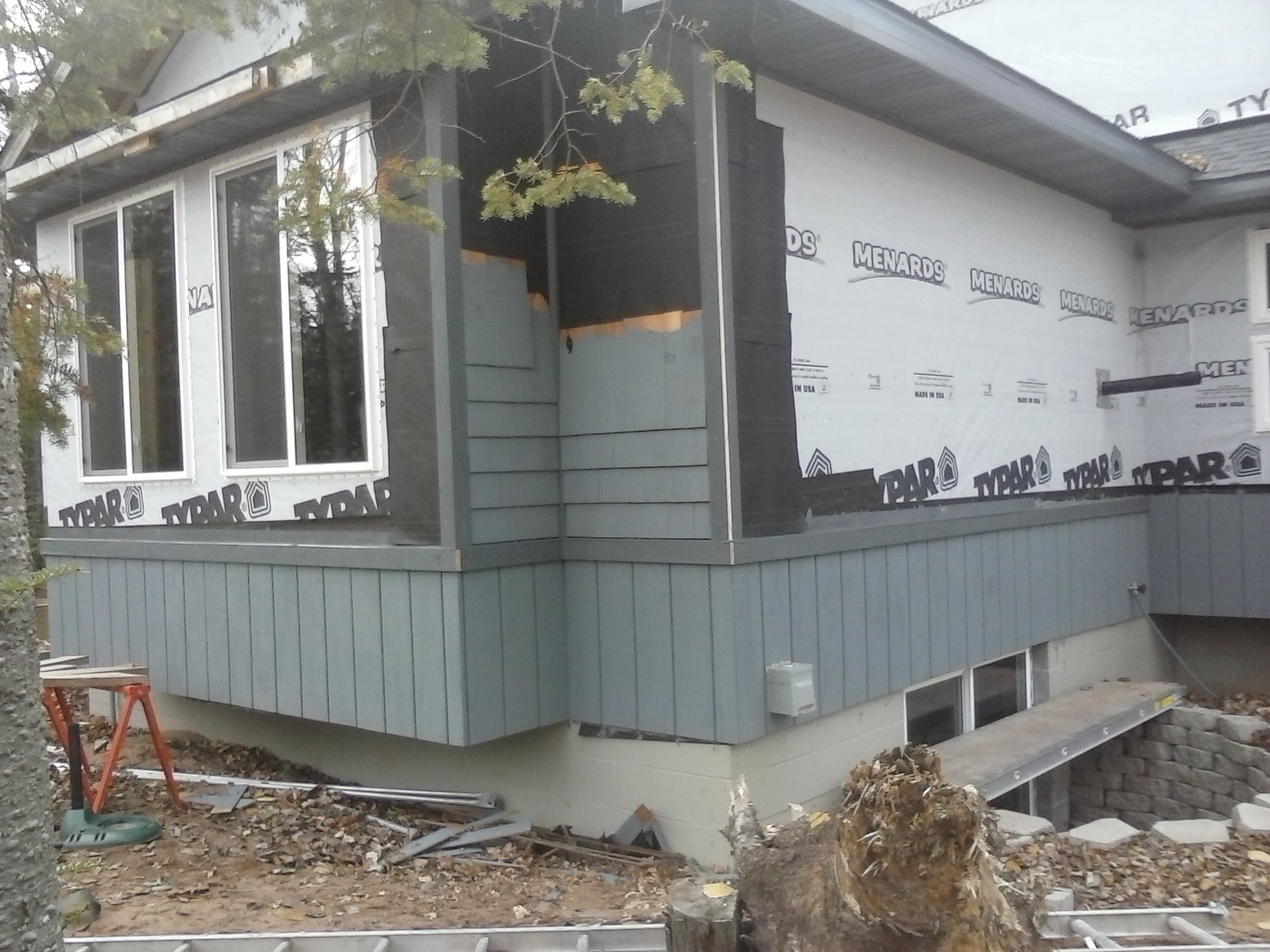

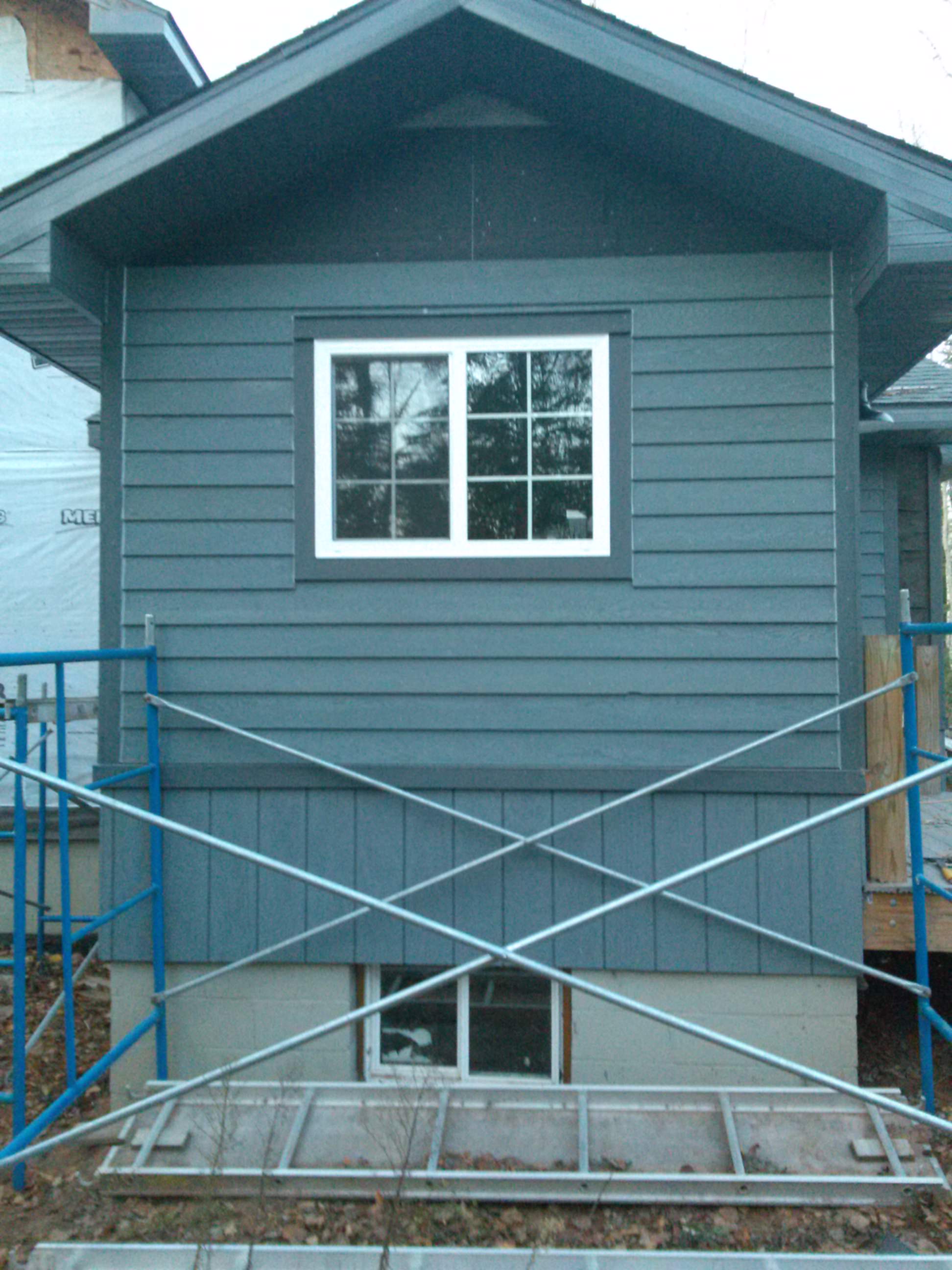

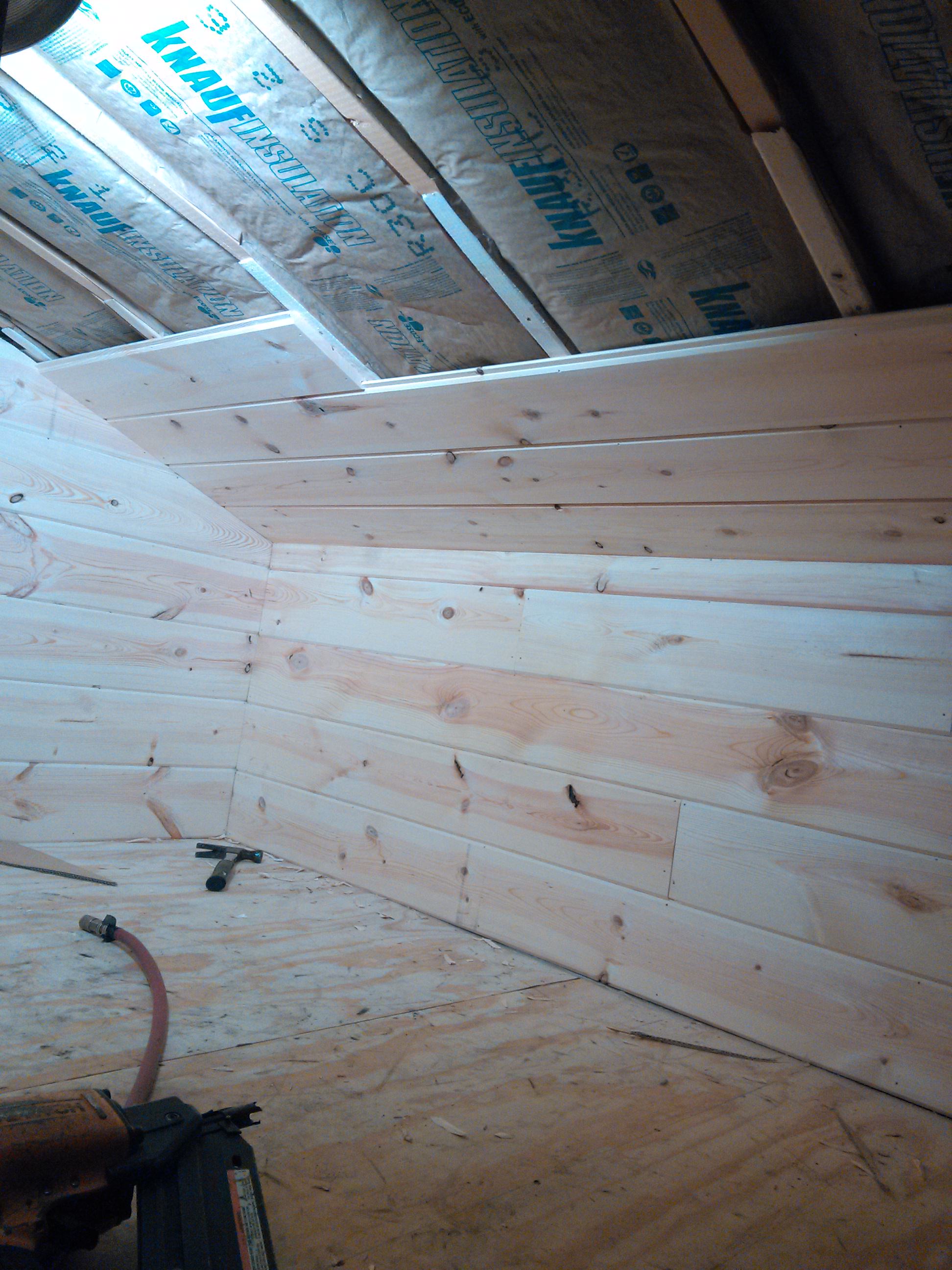

Well used up another weekend getting banged up and cut up but got alot (in my opinion) of the soffit /fascia done,I hate that stuff.I also added another window which I think really adds alot to the look of the place.Was able to get most the decking on 2 pieces short .Also some more siding and started insulating the upstairs ,hopefully finish that before winter,Finally!No more vacation days until November so progress will be harder if thats possible,LOL![

Where did you get the scaffolding?  I need some to start my siding.
thanks
Austin
Patrick
I got the scaffolding from http://www.scaffoldstore.com/Default.asp out of Houston,TX seems to be ok I got the plywood topped planks,There like a ladder with plywood on top seem to be holding up well so far.I would recommend getting the adjustable feet I really wish I had those.Some day!

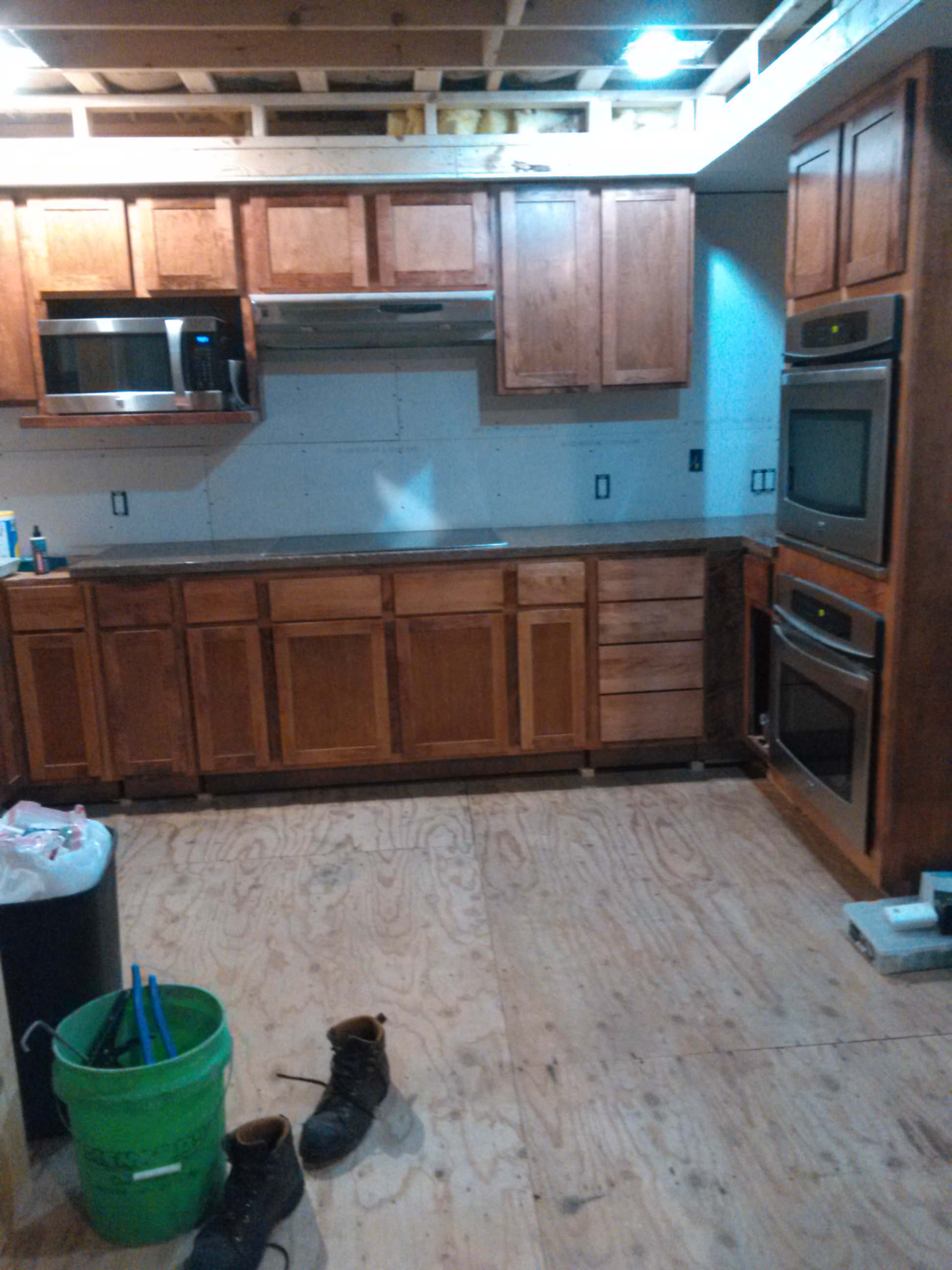

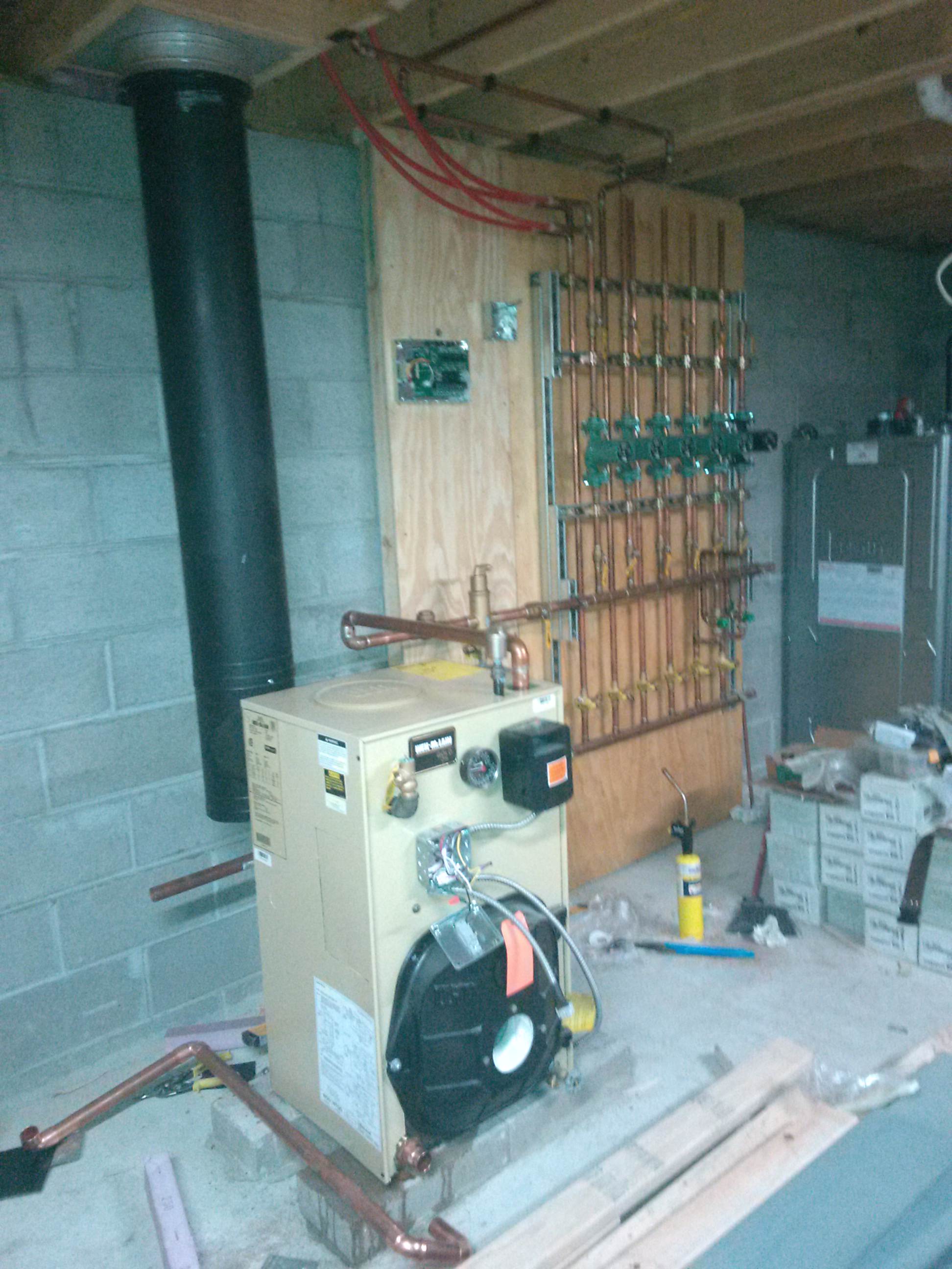

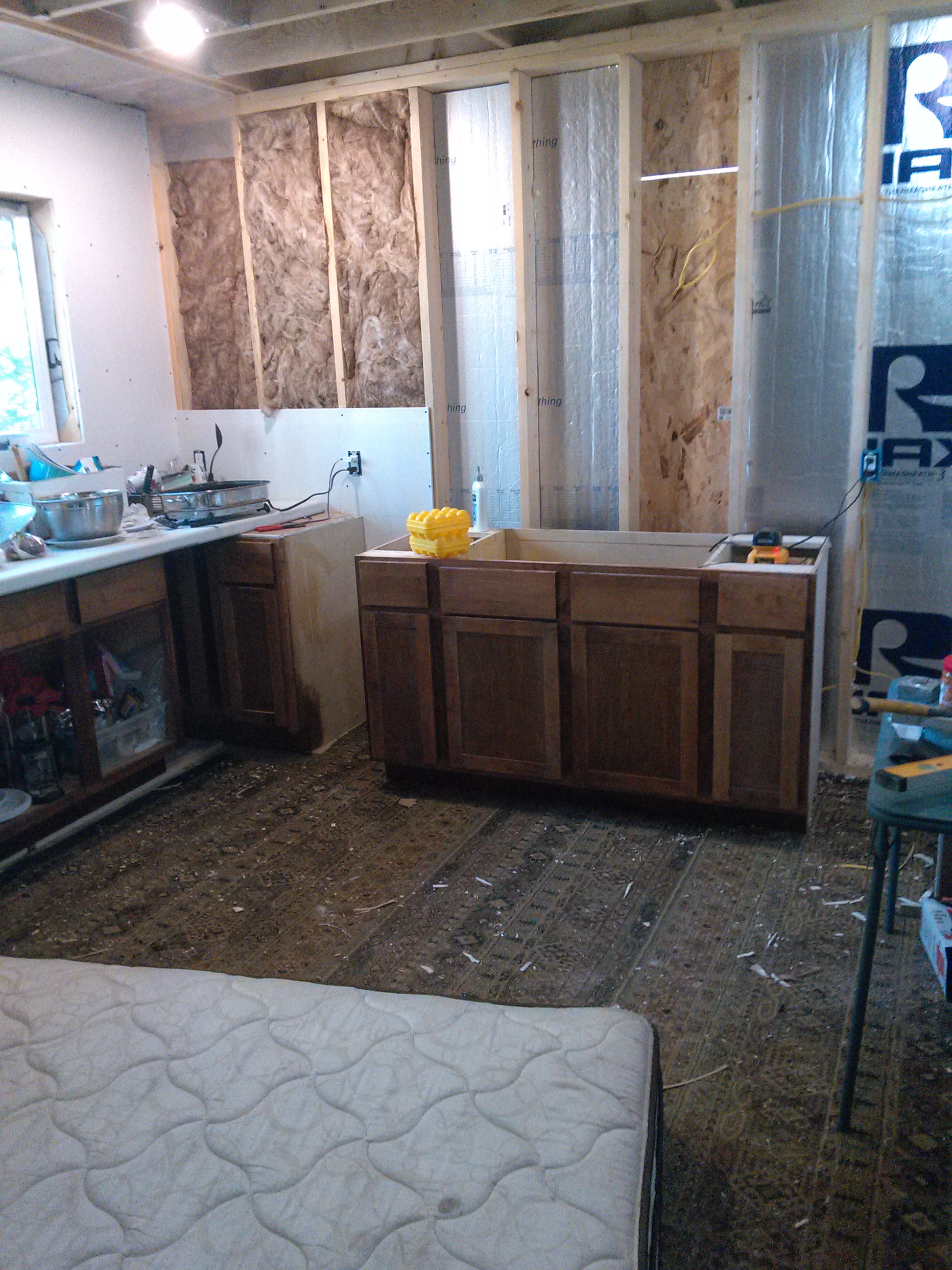

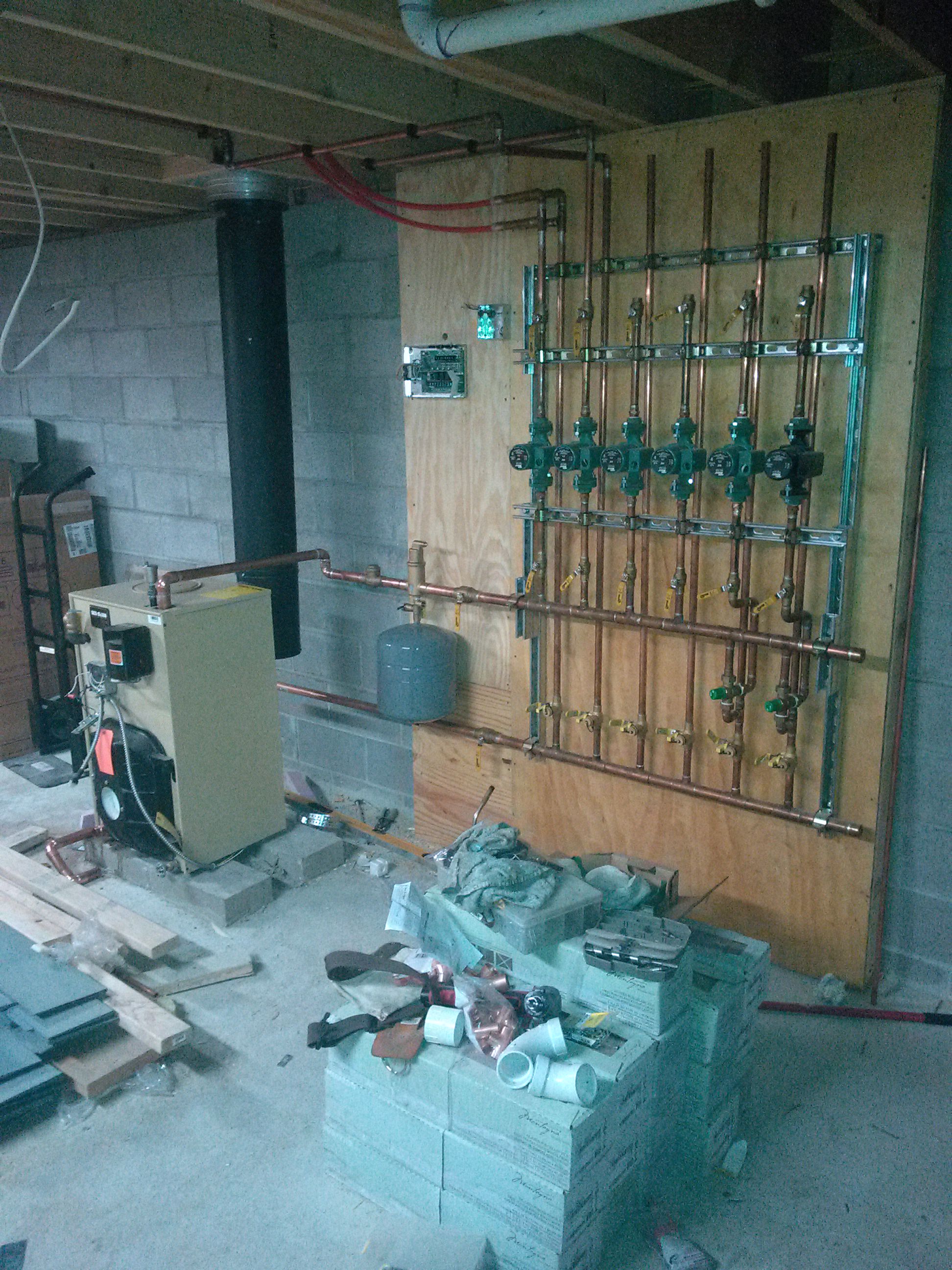

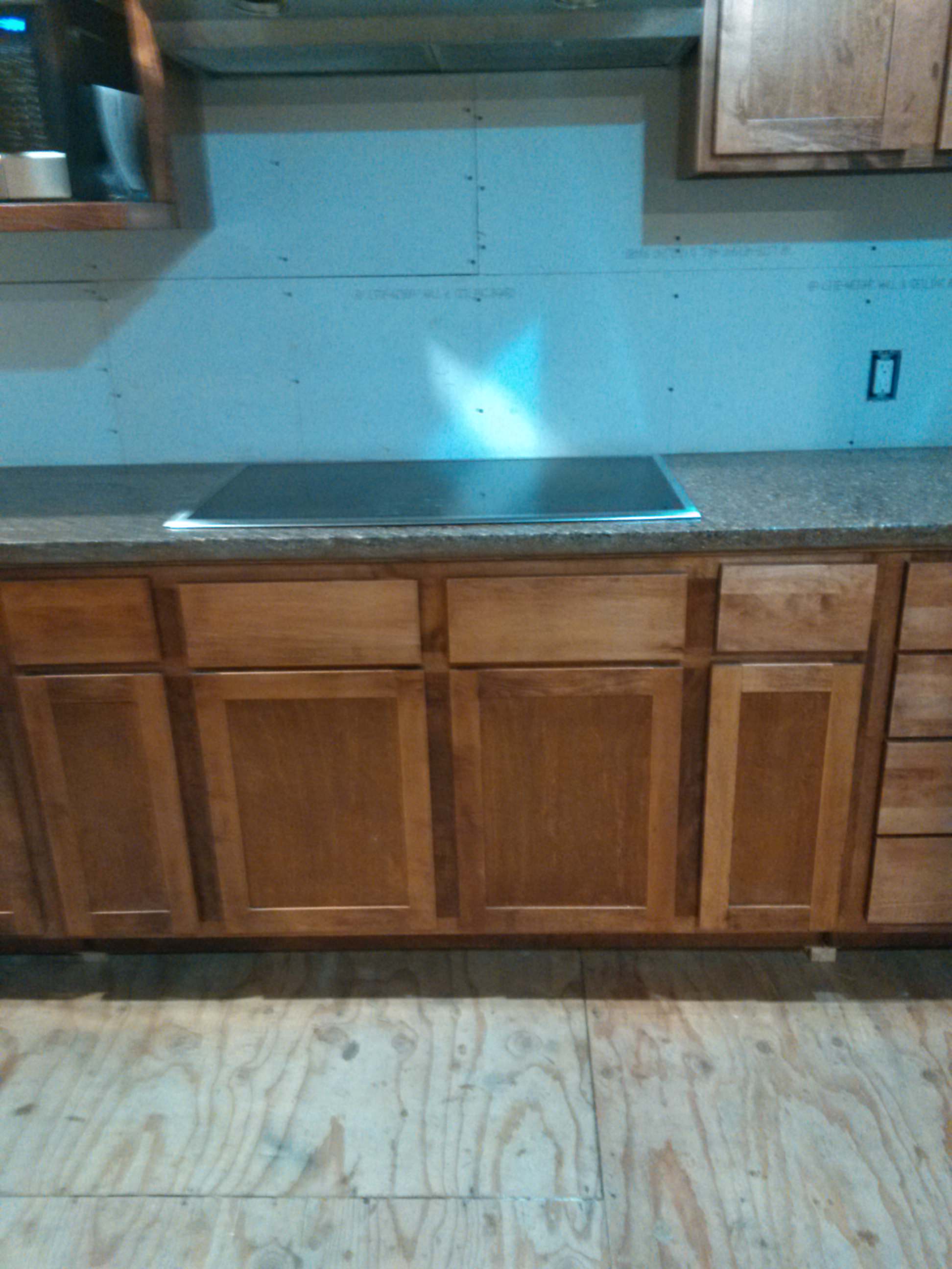

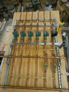

well here's another update, weather has turned cold again here with some snow to help slow things down but we did manage to get started on clearing for the future shop and Id like to think I learned a little from the first major clearing and this time we burned the brush as we cut we split as much as we could and I stacked and covered the logs we didn't have time to split so hopefully the majority will be usable firewood.We hauled the boiler into the basement thankfully it only weighed 700 lbs otherwise it might have been an issue,LOL!I got a little more insulating done in the kitchen and first floor bedroom I ran all of the radiant heat lines for the second floor,That job is not nearly as fun as it sounds!The chimney is framed in on the first floor and we found an area to add a pantry now.I built a couple cabinets that were not available through menards and the kitchen is moving along nicely.

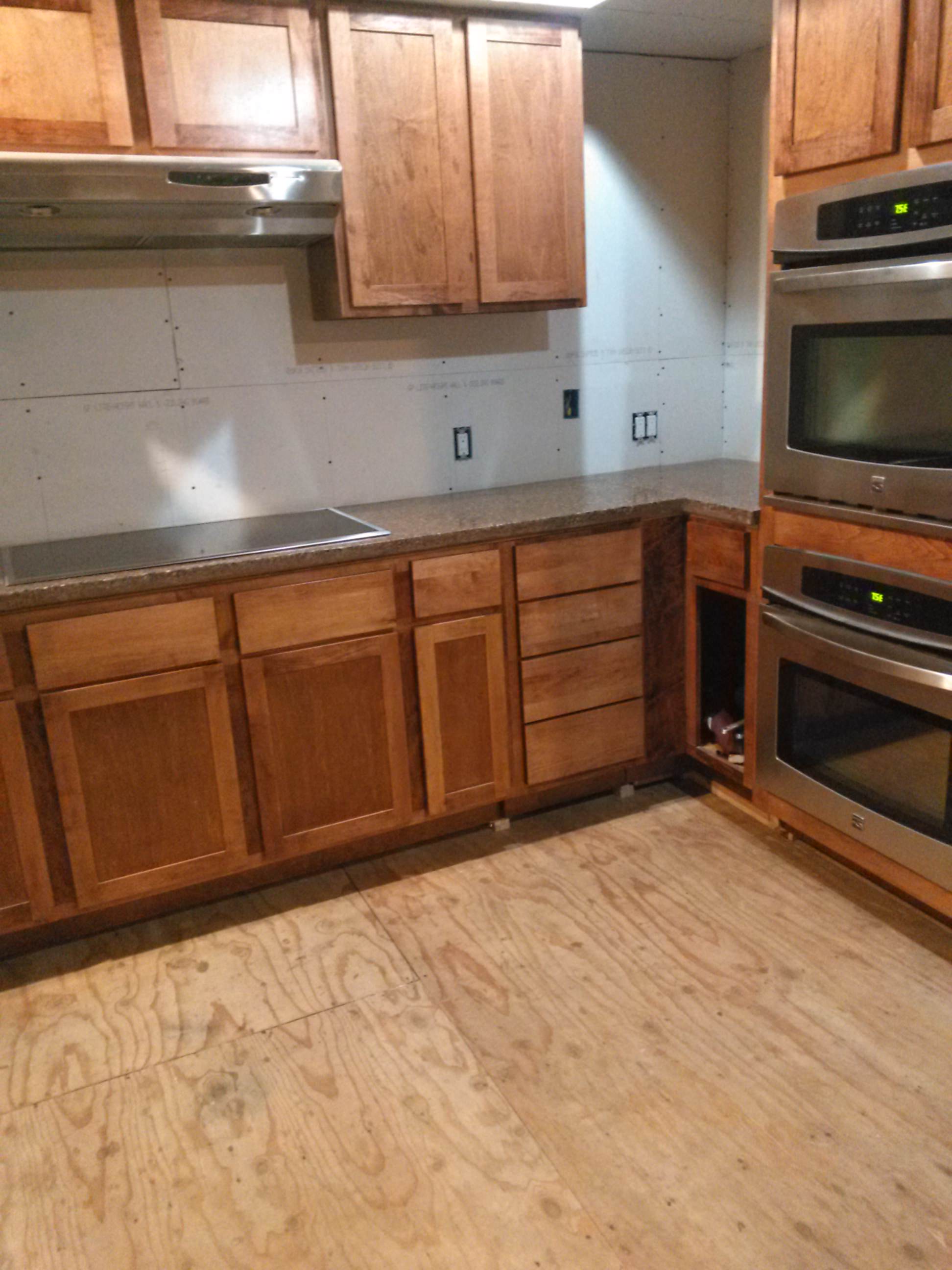

I'm still here just got super irritated by the whole photobucket issue i restored this post as best as I have time for. I have made lots of progress on the place , we still have the city house and we are getting ready to sell that this spring. The housing market here is very strong again and are hoping to make a little money to start the final addition. I started building a pole shed,heat is working,kitchen is almost done really moving along .

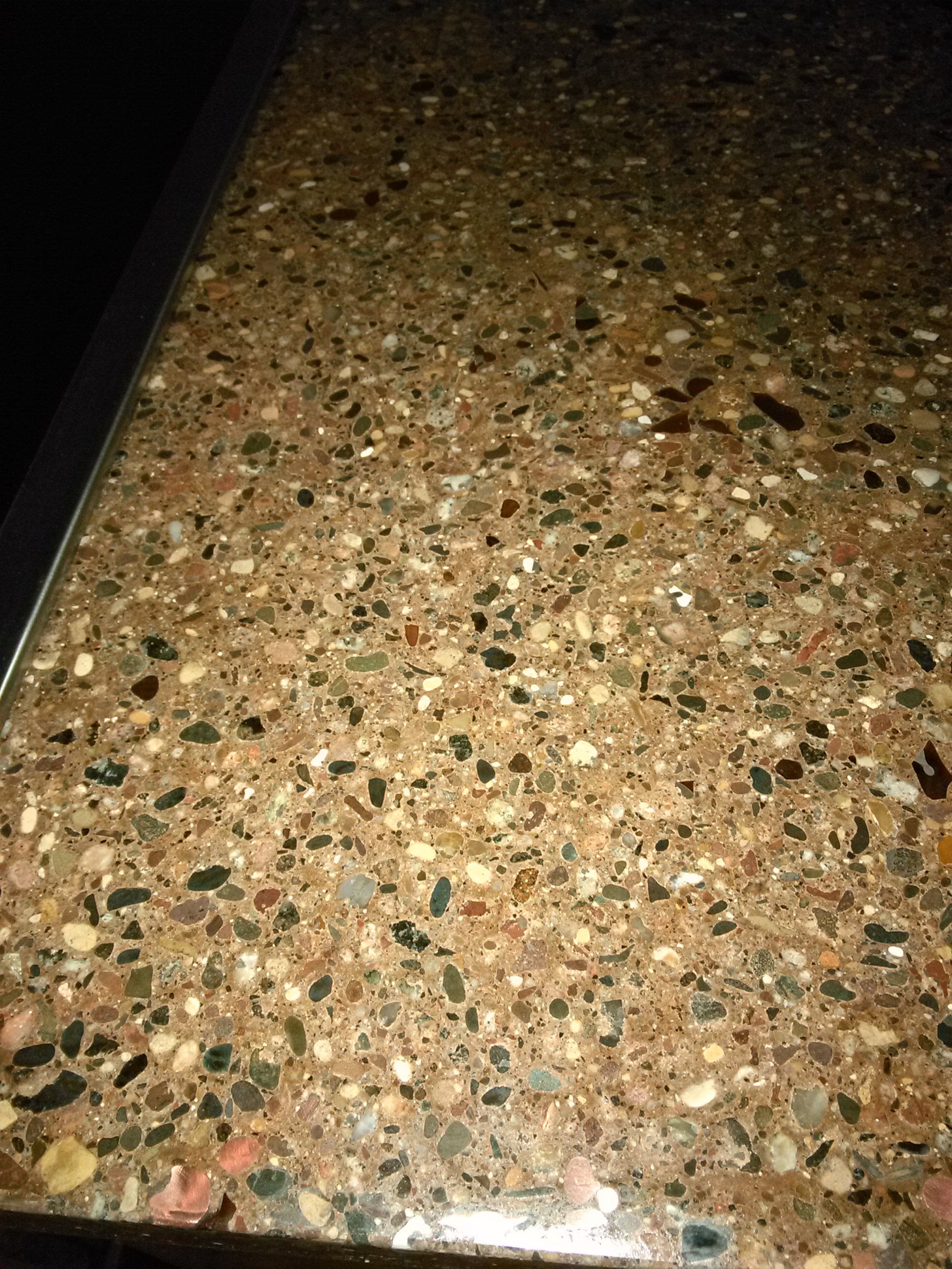

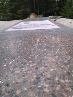

I also planted some blueberry bushes on the boardwalk,we had a bit of flooding this year. I also made another concrete counter top has broken beer bottles and pieces of melted copper in it, I've dubbed it the workin mans counter!

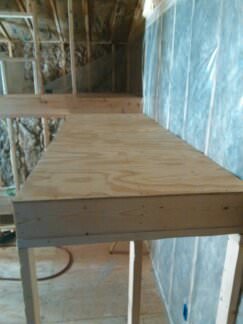

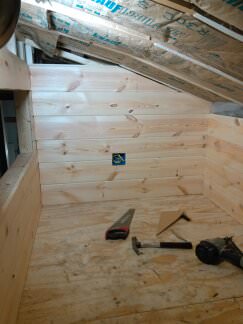

Have also been making progress on the bedrooms

8" I get it at Menards it has that V cut in the center on the other side as well.
