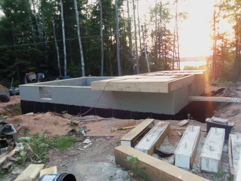

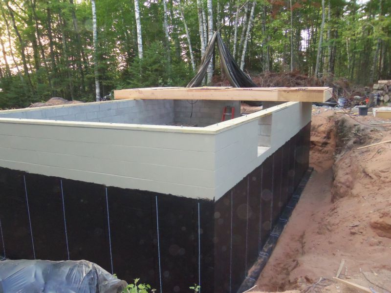

Foundation waterproofed and passed inspection

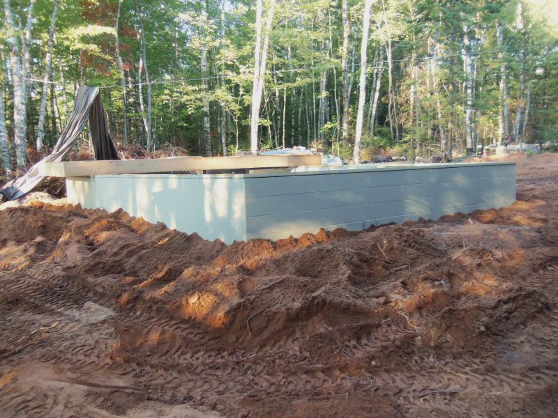

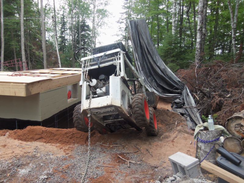

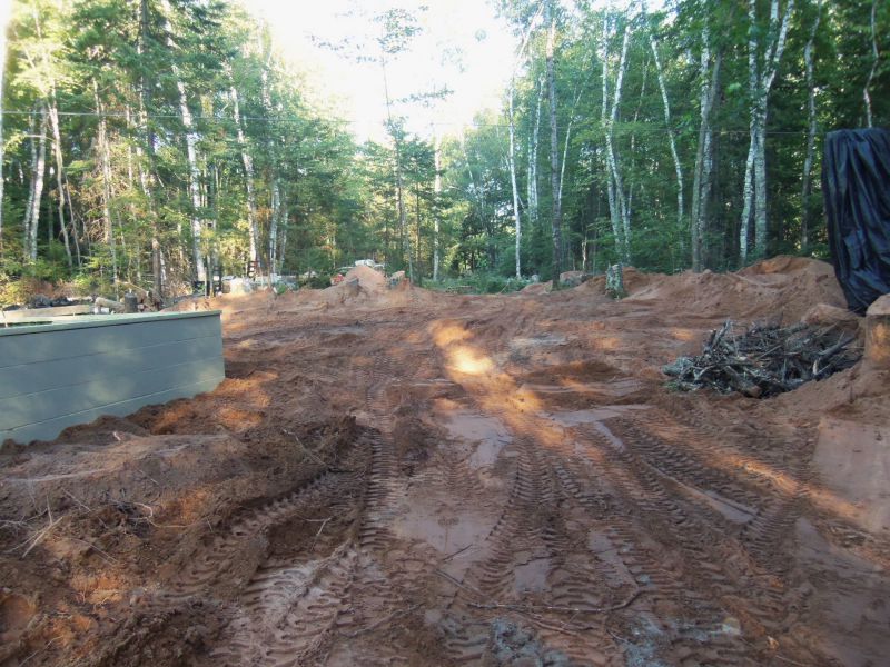

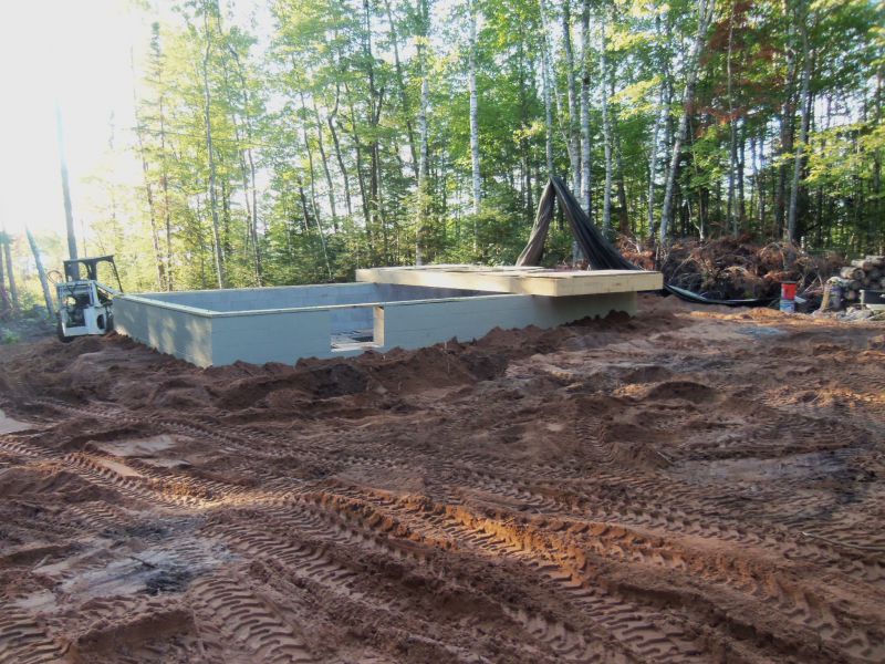

next got the place cleaned up and backfilled the foundation I did this without pouring the floor first I had no issues other than the bobcat almost falling in the hole pretty much scared the crap out of me but in the end just another lesson learned

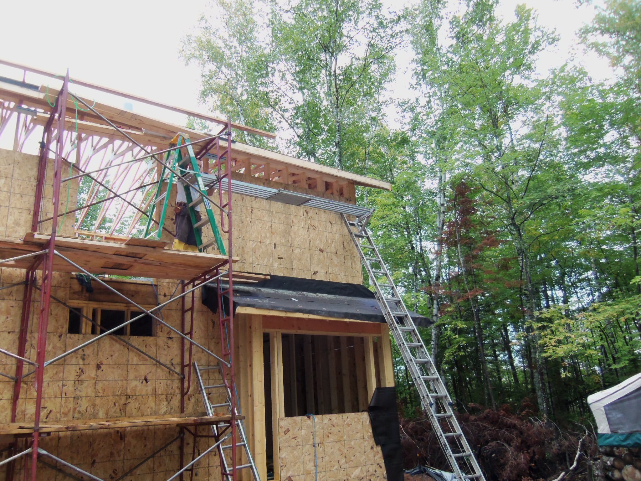

Just had some major storms up there 50 mph winds lots of trees down so hopefully everything is ok talked to the power company today all set to go there I'm installing  the meter socket and panel this weekend and as soon as they get the stamp they say maybe 2 weeks till power I cant wait  the generator I have is a real piece of something still no trusses yet I'm happy with the progress so far and really liking how its coming together was lucky to have my dad and brother come up and help this week nice to not  have to do every little thing yourself

Quote from: Patrick on August 27, 2013, 08:17:29 PM
You are not alone.
I learned that lesson the hard way.
Patrick
That stinks that happened, its so much work to get to that point and then one little mistake and its all undone.Hopefully you where not hurt that is always my concern working alone fairly far away from help.those machines can really throw you around like a rag doll. A guy I worked with was killed this summer pulling a stump and his tractors front end came up and fell on him, a real tragedy trying to live his dream and then lights out.

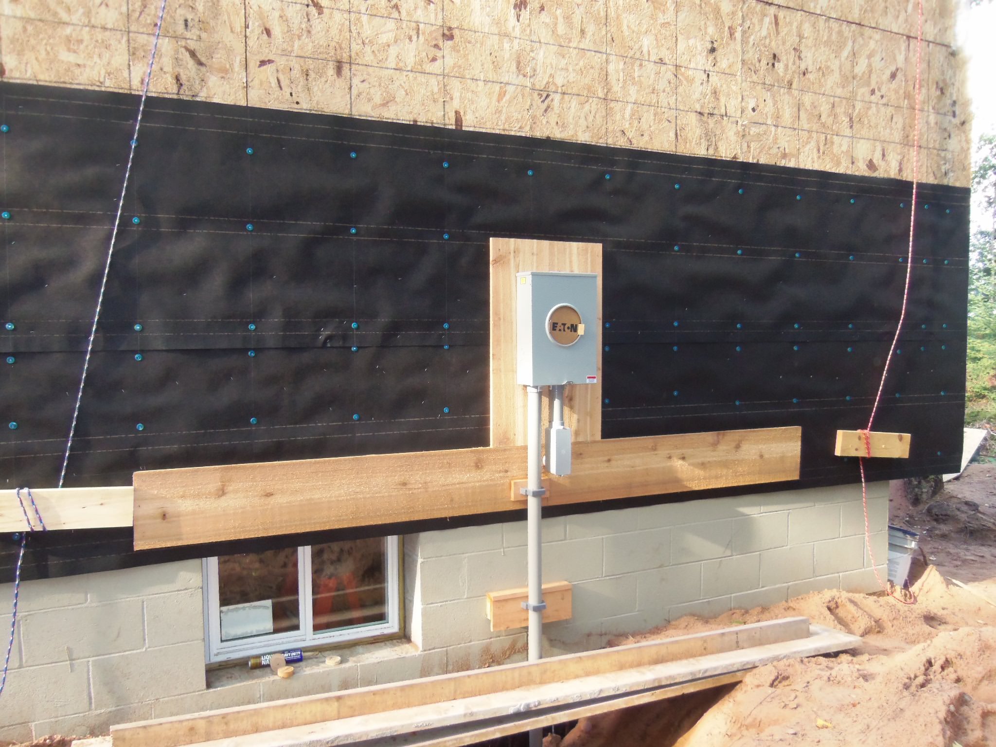

Went up last weekend and installed the meter socket and panel, Inspection passed and poco has been out and planning the run he called and was unsure where the property lines are. I have one of those solid steel fence posts painted bright yellow about 4 feet tall next to the steel pin with a red flag and his flag was about 1 foot away and he did not see this. My confidance of this going well is fading fast. I will be faxing him a map a child could understand on monday.

Went up yesterday and brought the last load of plywood hopefully, roof trusses to be delivered on friday .Started the roof on one of the canted sections the generator/compressor are not working well together the generator does not produce enough power to start the compressor when there is air in the tank, so I had to fill the tank shoot as many nails as possible drain the tank start the compressor fill the tank and repeat.Power cannot come soon enough.I still need to finish overhangs and I quickly just put some 15# on for some waterproofing I did not have any ice barrier with me.But I'm happy just getting it more weatherproof.

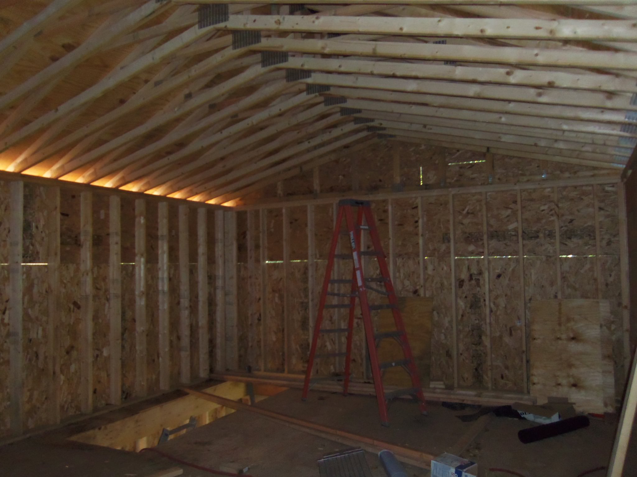

Another 5 day marathon and its mostly closed in main roof is complete and some windows are in door is in and just did a bunch of clean-up.

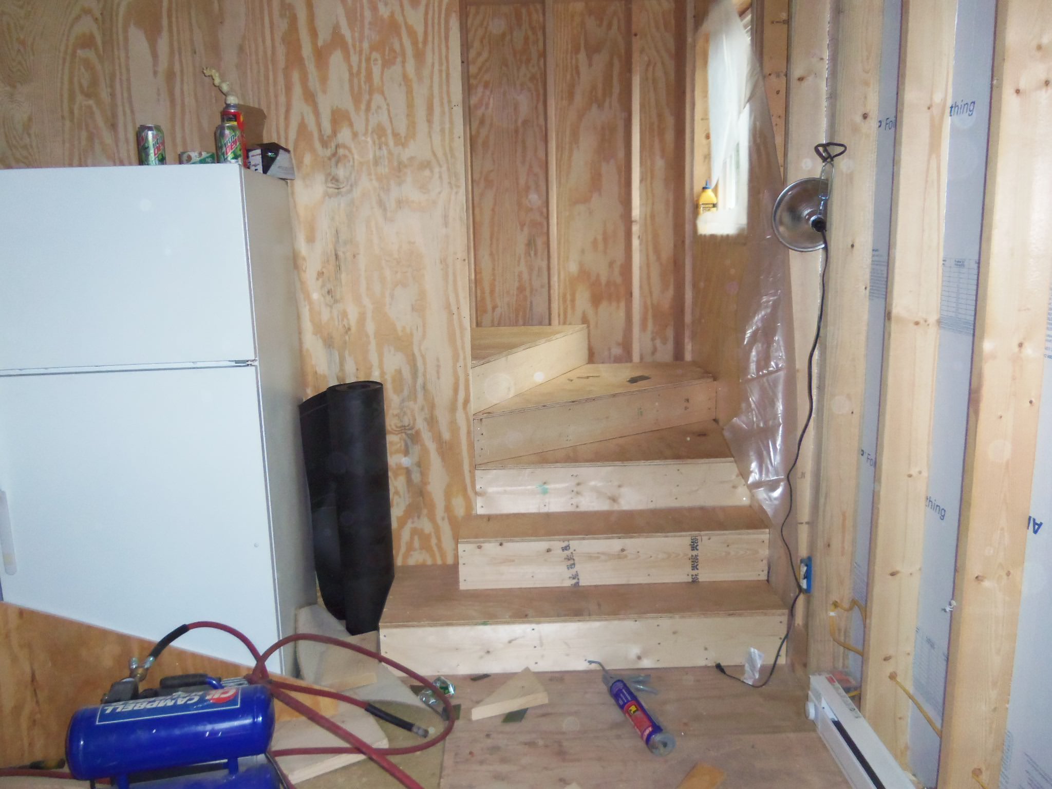

Winders are tough to build. A few of the stipulations are that they cannot be narrower than 6" at the narrowest point of the tread and must be 10" or more wide at the 12" walkline. The winding treads at the 12" walkline must also be within 3/8" of one another in width. It can take me several tries drawing to get all that to come together.
That is a nice area, we built 2 log houses and a log sauna outside of Solon Springs, there's a Superior agate hanging in our bedroom window  :)
Patrick
Wisconsin still allows winders to come to a point and they only need to be a minimum of 7" at the 12" walkpoint and I double checked this with my inspector and saved the e-mail .I am aware many states require a 6" minimum which I believe they took from commercial building codes which makes using winders pointless. Copied from Wisconsin code" `Winder treads in series.' Two or more winder treads may be placed immediately adjacent to each other anywhere in a stairway provided both of the following conditions are met:
SPS 321.04(2)(c)3.a. a. The winder treads shall have a minimum tread depth of 7 inches measured at a point 12 inches from the narrow end of the tread.
SPS 321.04(2)(c)3.b. b. The depth of the immediately adjoining winder treads shall be equal at a point 12 inches from the narrow end of the tread or inside face of spindles or balusters.
SPS 321.04(2)(c)3.c. c. Winder treads may not be used on a straight stairway.
SPS 321.04(2)(c)4. 4. `Individual winder treads.'
SPS 321.04(2)(c)4.a.a. An individual winder tread may be placed between rectangular treads or at the end of a flight of rectangular treads provided the tread depth, measured at a point 12 inches from the narrow end, is equal to the tread depth of the rectangular steps in the flight.
SPS 321.04(2)(c)4.b. b. There may be more than one individual winder tread in a stairway or in a flight of stairs.
SPS 321.04(2)(c)4.c. c. Winder treads may not be used on a straight stairway.
Excellent work on checking first and on saving the email for the future. I didn't consider it egregious just a code heads up to other builders in the planning stages. Not too long ago I had to redraw and fit in a set that had been drawn to a point, the designer had not been aware of the min width in the model, and in our state, code. Many, if not most of us are bound by this set of stair codes;
http://publicecodes.cyberregs.com/icod/irc/2012/icod_irc_2012_3_sec011.htm?bu2=undefined
It doesn't make a winder pointless (or... I guess it does  :D), it sure makes them more difficult to figure out and they do require more room. On the plus side they are less likely to cause a twisted ankle for someone who is not paying attention.
