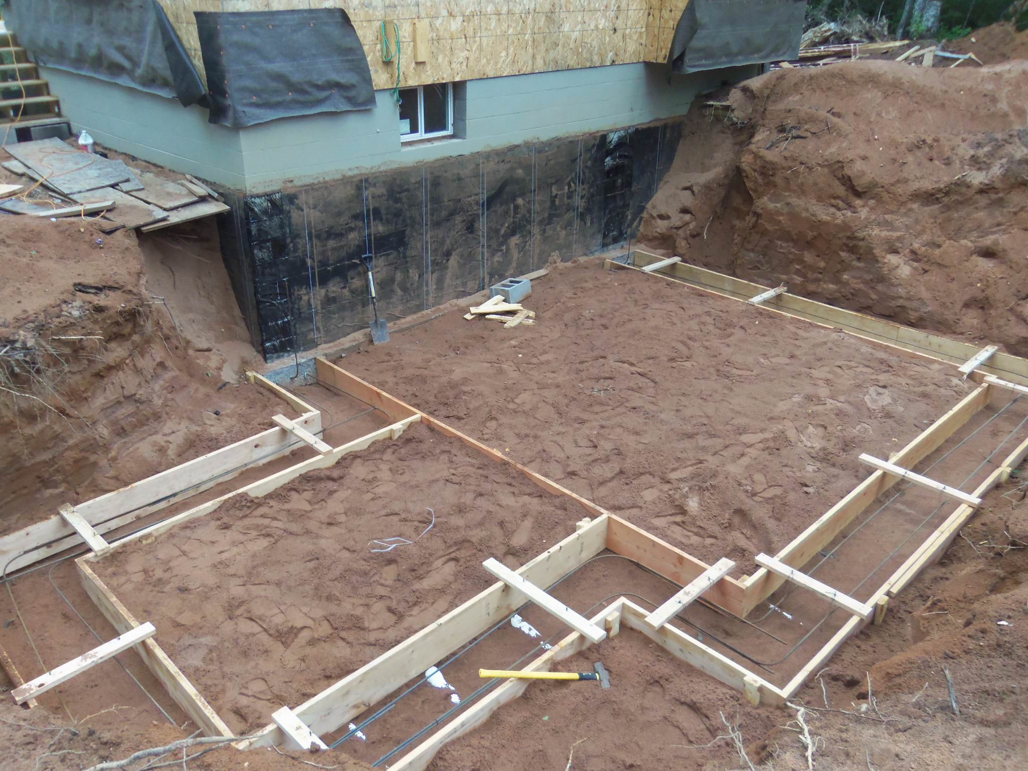

Well I got the footings done,I had an additional cave in on the house side so between the two it was a relaxing 6 hour dig out. But concrete is ordered for Thursday so hopefully no more land slides,there was a pretty heavy rain and everything has held so far.

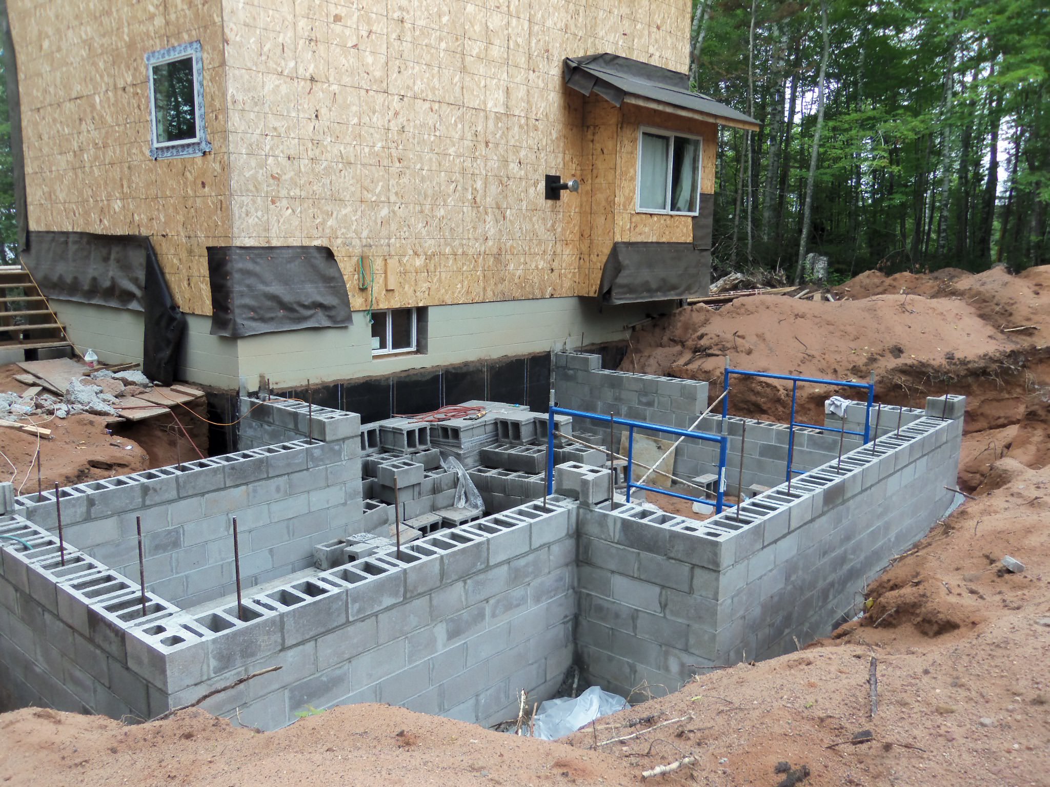

Concrete is poured ,forms are stripped ,water line to well is run and the block is started.I stepped up to a rotary laser level this year  to help set the corners and turns out I should of used one last year as well. Still learning, always learning I must say doing all this solo is pretty tuff, It's amazing how much additional time is spent on the little tasks.

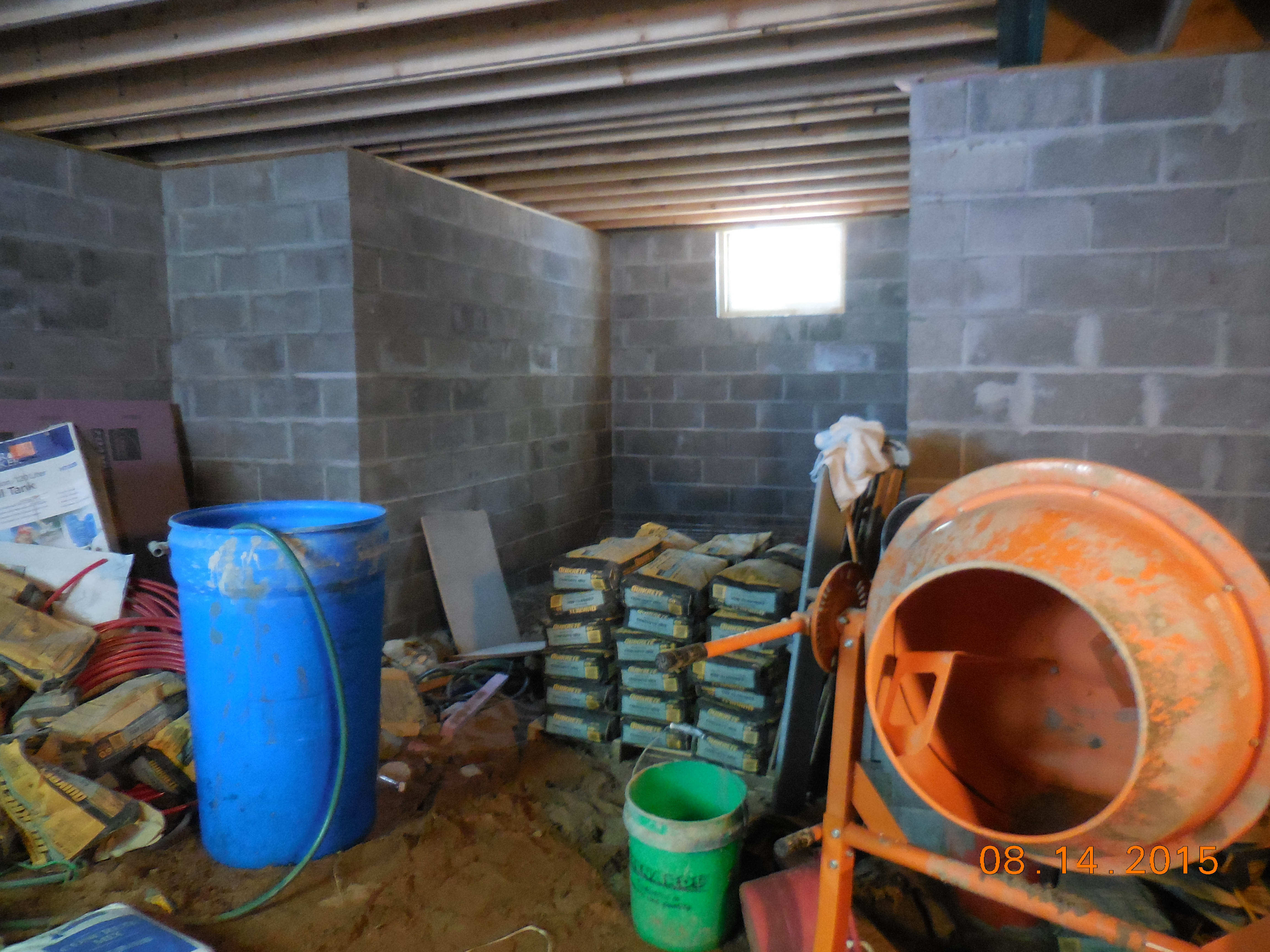

Welded the pitless in and installed the pump and we now have water no tank yet but the water comes out of the hose with alot of pressure.tastes great should be a good well.It was a bit scary laying down to weld the bottom side knowing if it caves thats it. Also got almost half the block work finished really starting to look like something.
Patrick
#57
Almost dun,duhn,done, I have almost succeeded in eliminating any signs of those annoying fingerprints on my hands.My wife asked if had named any of the blocks like they where my baby and I responded with yes,I named them all son of a b##ch!

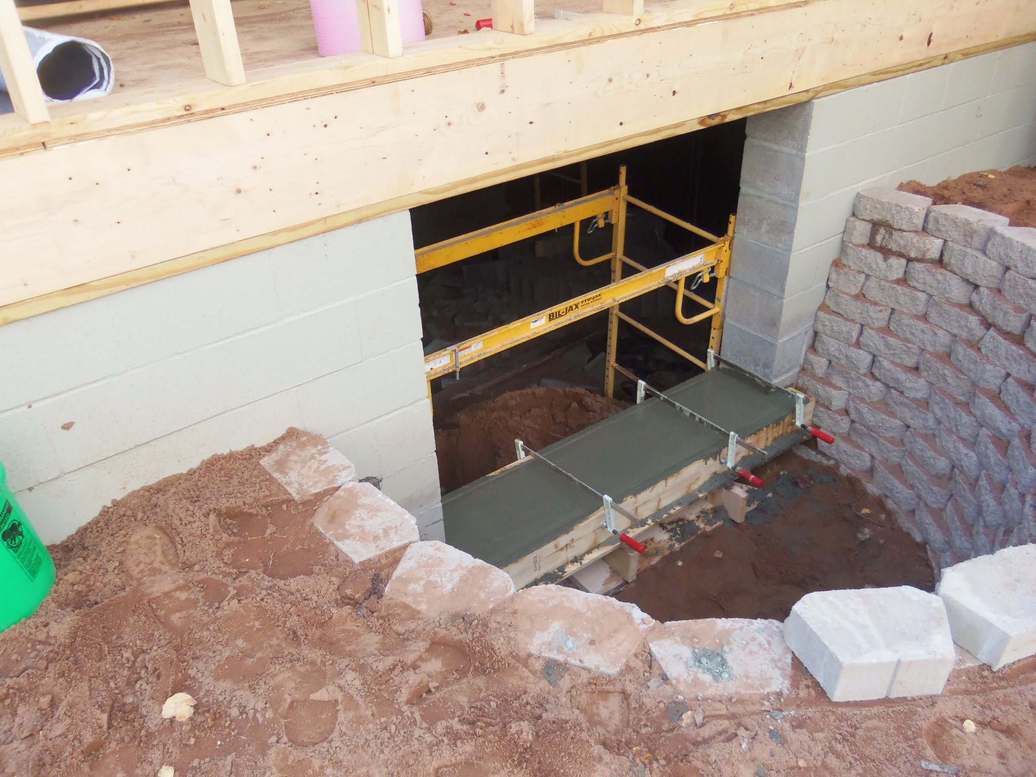

Worked on the window well and poured concrete for the window sill so hopefully get that window in this weekend.Also continued on the roof almost finished the one side the weather was cold there was some snow on the way up .
bandit1169
Love the great attitude on such a hard project.. [cool]
rdzone
Nice project!
Hard to tell from the picture, hopefully you put some slope on the concrete window sill to prevent water coming in.
Chuck
Patrick
No slope yet, the plan is to add slope with mortar after the window is installed,The concete was mainly done to bring the opening to the corect size I did'nt want to cut block and this seemed the easiest way to get the dimension correct. I'm no mason and I'm sure there are many better ways but I like the look so far.

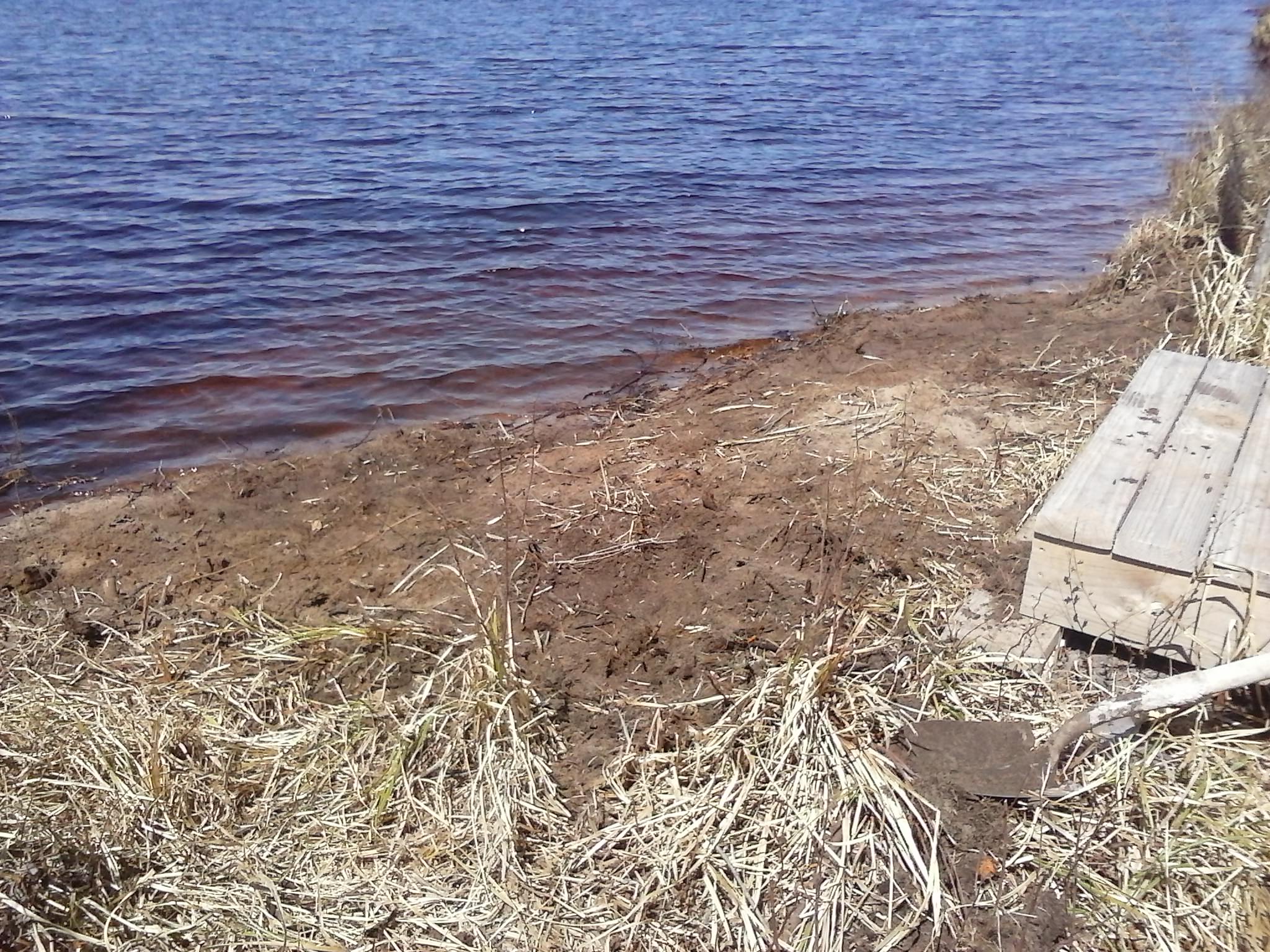

Met with a septic guy this weekend,waiting to see that estimate.Started framing off the upstairs bed rooms and bathroom.Built an over the staircase loft bed for one of the many children we have to please. Cleaned up the beach area so the kids have a play area.Started building this winters burn pile,watched 3 loons fishing right in front of the boardwalk for about 20 minutes.Saw 2 wildfires on the drive home its very dry here right now.

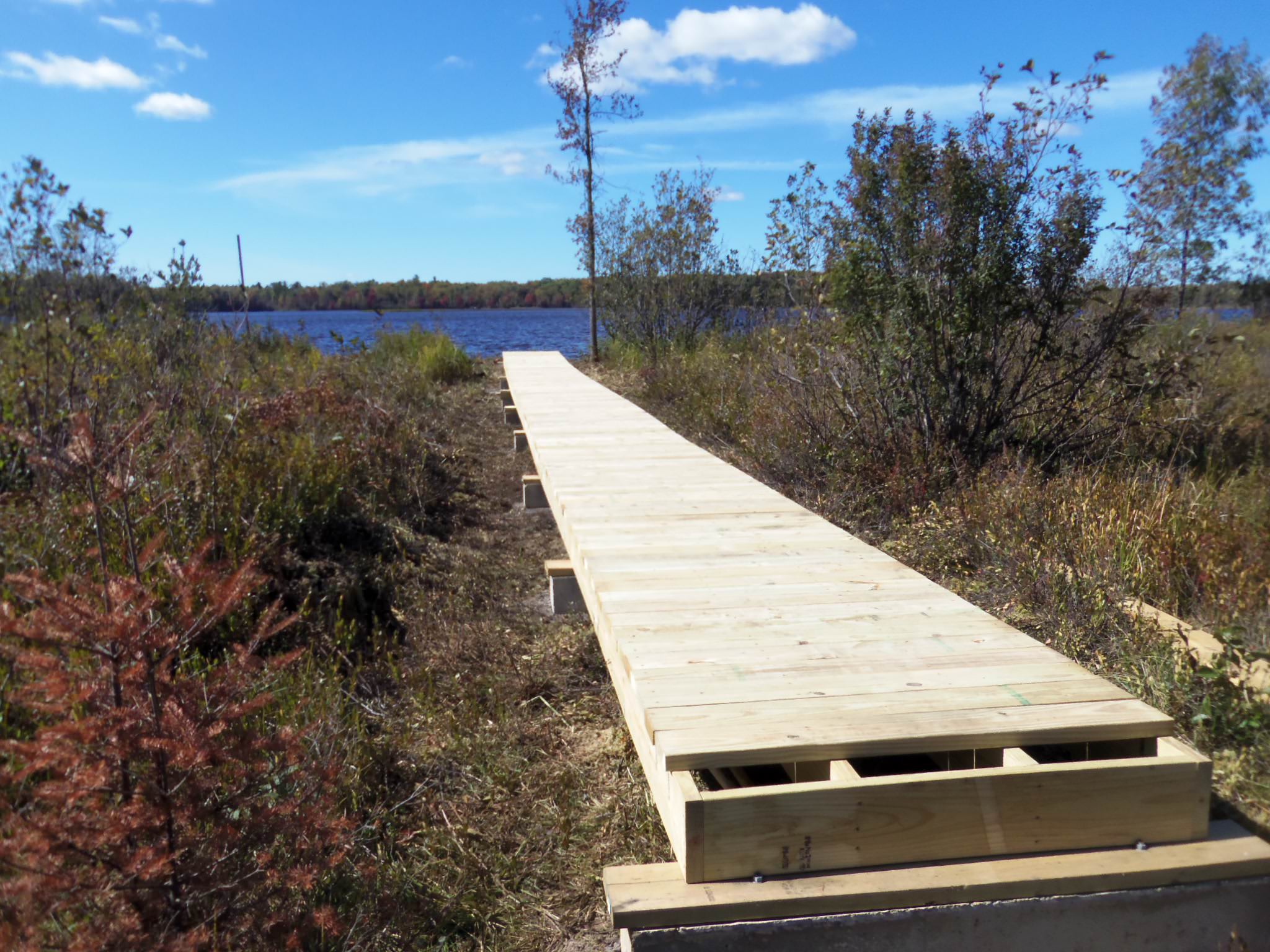

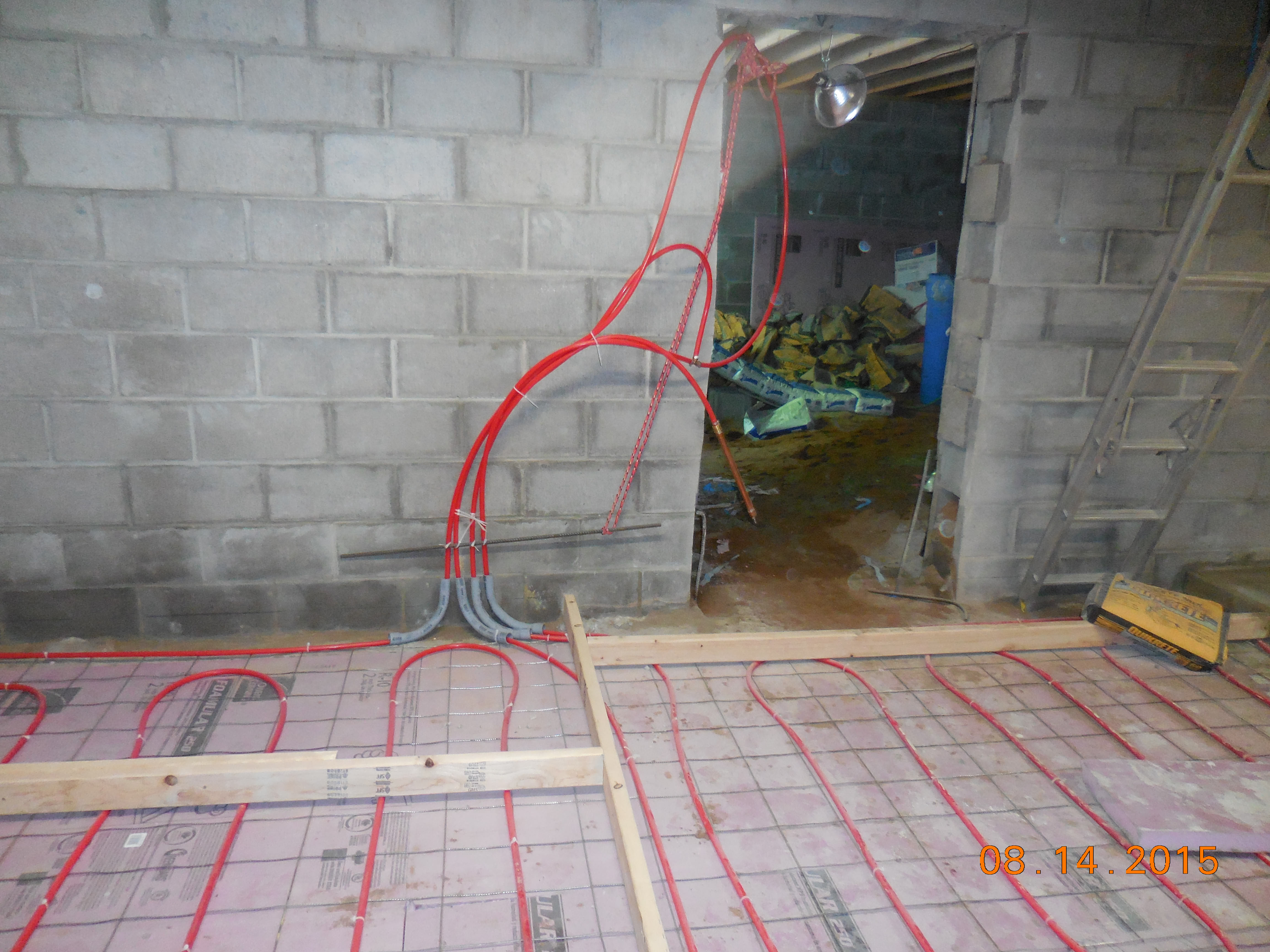

Well finally finished the boardwalk,the strait part anyways.Got some lights in the basement to start setting the insulation for the radiant heat.Buried the conduit to wire the electric for the pump and installed/painted some more siding.

Well we continued on the siding, finally changed the kitchen window out finished the insulation,radiant pipes and poured the concrete in half of the basement. I framed the header and opening to join the buildings together and framed of that bedroom and hallway and framed the stand for the pellet stove.We are going back in a week and the septic is suppose to be in so we will plumb some of that in,maybe.

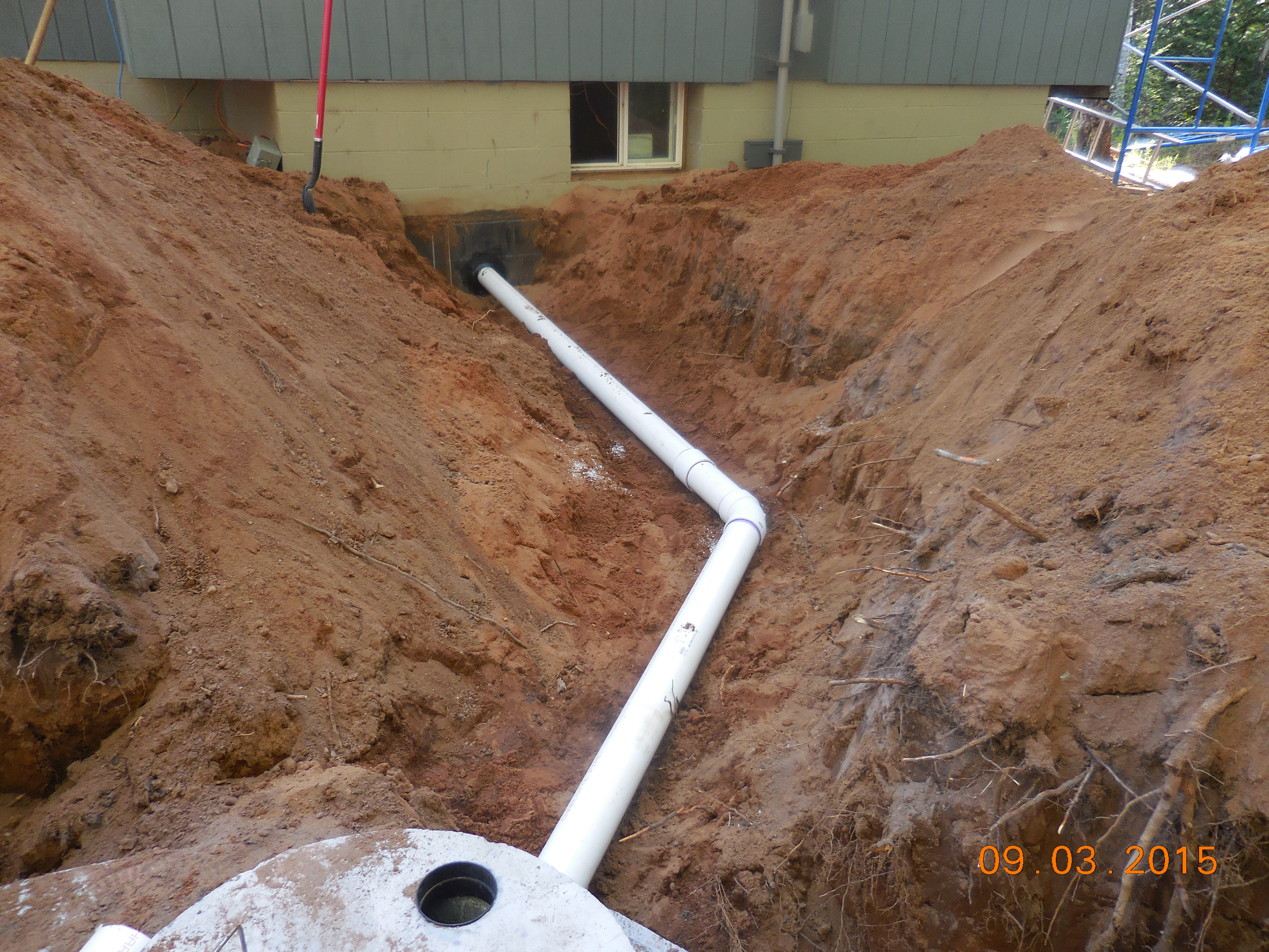

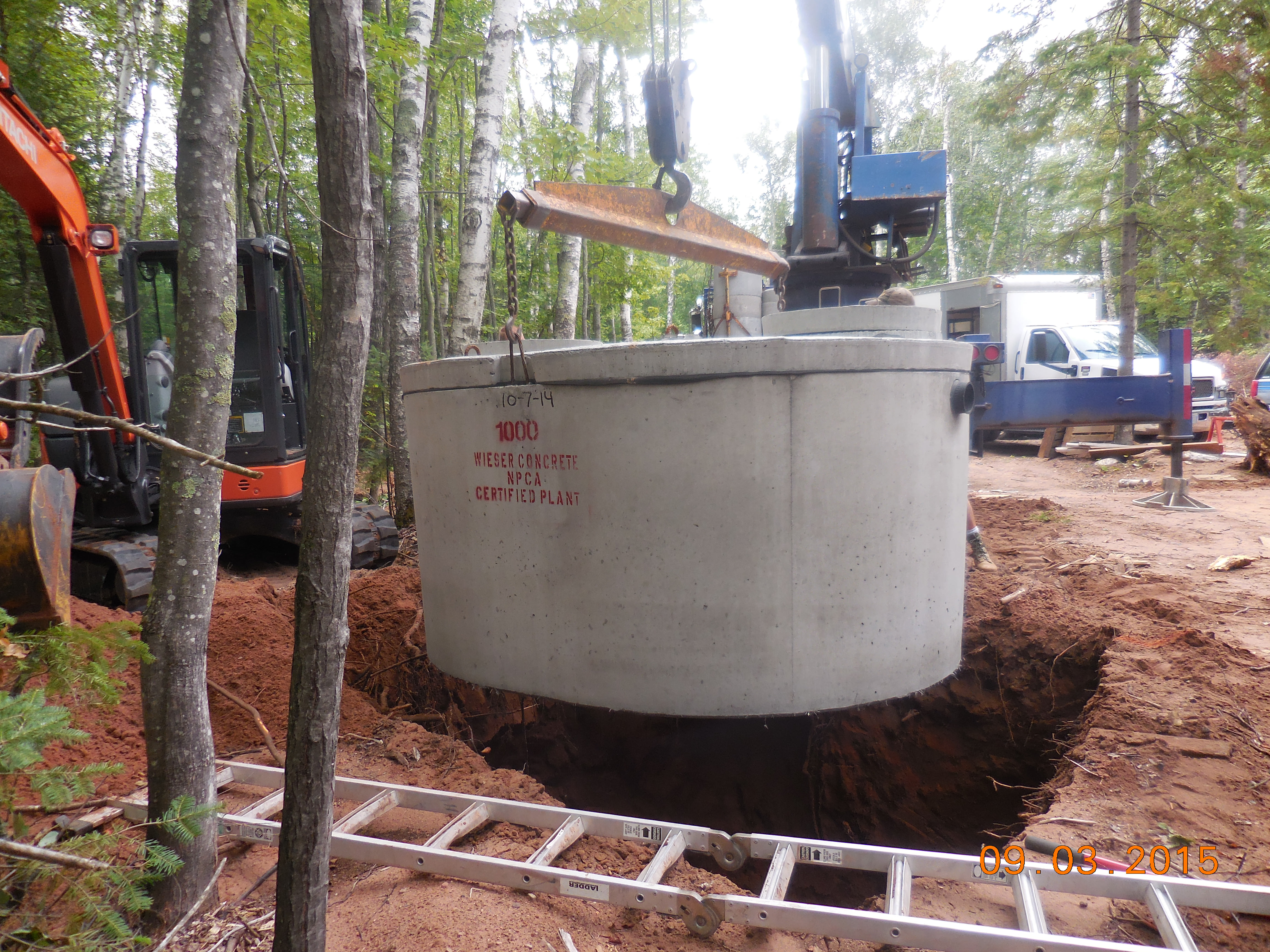

The septic is in and one bathroom is plumbed,We have some drywall and a real door on the bathroom.I almost finished the stairs to the basement and got the pump wiring installed in the conduit and got that hooked up ,just need to hook up the pressure tank now.The whole place finally is wrapped in some house wrap and we even found time to cut down 4 dying trees and cut,split and stacked those for my neighbor who lives there full time .
