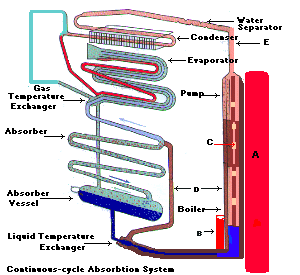

It's a maze of mystery plumbing
I liked this pix to take away some of the mystery.  I studied it a bit before so semi-understand it.
...from the link you posted on the other thread.
http://www.nh3tech.org/abs.html
