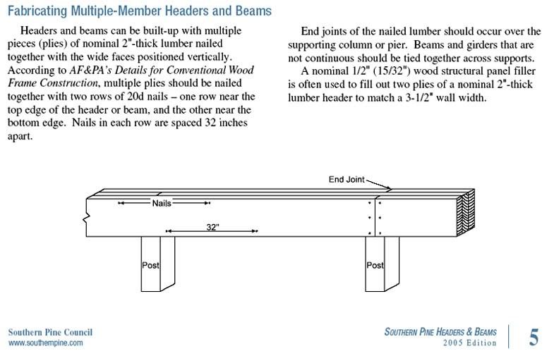

Not many people will try to figure the plywood as anything other than a non structural spacer. You can claim the section modulus of the plies that run with the axis of the beam. The breaks would then need to occur near the inflection points of the beam, roughly close to the 1/4 points of span where bending stress is very low and shear is still fairly low. Then it needs to be nailed off very well. An awful lot of figuring and ifs for marginal gain. Glue in a vertical lamination does nothing for the strength of the beam, it does make it stiffer but not stronger. Stiffer is still better, less bouncy, but ultimately no more weight bearing ability.  Technically you are limited to 1/8" of compressible stuff. I use scrap metal plate to shim where I need to. HTH
I never used any adhesive in building my cabin beams. Not a drop or a dribble.  :o I simply nailed them together about 1 to 1.5 inches from the upper and lower edges of the beam. The information I have from the Southern Pine Council reads...
No mention of glue at all and nails spaced further apart than most would think.  The nails are there to simply keep the components of the beam in alignment to retain their strength.
