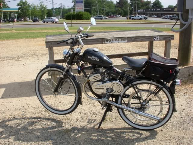

500 miles= -5 gallons of high test gas ;D ;D ;D

So, you're only getting 100 mpg on your Whizzer.  You must have a large engine on it as the 25cc engines I've seen are supposed to get 250 mpg and the 50 cc engines are supposed to get 150 mpg.  Is what I've heard wrong?
Yes, I have looked into getting a setup like this.  How have you liked yours so far?  What would you do different if you could start all over again?  Is that a Schwinn you started out with?
By the way, nice ride.

138 cc  :)
They're pre built.
http://www.whizzermotorbike.com/
It's a 4 stroke 138 cc engine with an automatic clutch. They are a little too big to meet some states moped requirements, including Va, but cops don't know how big the engine is.
Out of the Factory they go 35mph...10 minutes tinkering = 45, 2hours =50mph....the fastest one I've seen went 62 mph.
Those little 2 strokes your looking at don't have any power and don't last long. I've seen Whizzers with 20,000 on yjem and still going strong.
The only things I changed (Other than the 2 hour engine mods) were:
I changed the seat and put an offset post .
I put mountain bike bars.
I Added a rack.
I put thorn resistant tubes in it.
I may put a tach on it but otherwise, I'm happy.

Congratulations Peter.
What all is involved with the engine modifications. Does the dealer do that for you and does it void your warranty?

Some dealers will, some won't. Some build super modded engines.
The first thing is to bore the carb restrictor plate to 3/4". This takes 5 minutes. Makes a BIG difference.
From there, the skys the limit. Shave head, mushroom lifters, 26mm carb, different clutch...on and on. None hard or expensive. Quenton Gunthor, a dealer in NC holds the land speed record at 68 MPH. He also does mods and sells modded engines.
Yes, it does void the warranty.

Have you beefed up wheels, tires, brakes, suspension etc.  Seems I was reading at MotoredBikes.com forum that those components are not designed to handle motorcycle speeds, but rather bicycle speeds.  I don't think I would have any problem with 30 or 35 mph, but 50 or 60 routinely on a "bicycle",  hmmm might be asking for trouble.
What are your thoughts on this Pete?  You do have 500 miles of experience, and that is 500 more than any of the rest of us.

I haven't beefed them up except for heavy thorn proof tubes. The wheels are OK unless you hit some really rough stuff.
The brakes are NOT OK. They are poor for even 35.
You can get disc brakes as an aftermarket product and I may put them on sometime. The fellow who holds the speed record once joked, "How do you stop a Whizzer at 60MPH......Hit something"/
