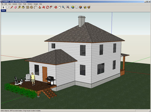

Ok, Here's what I came up with after a few hours. It's my future FirstDay home:

The house I'm building (30' x 57'); up is North; drawn with Sketch-Up (took about 1 hour)
