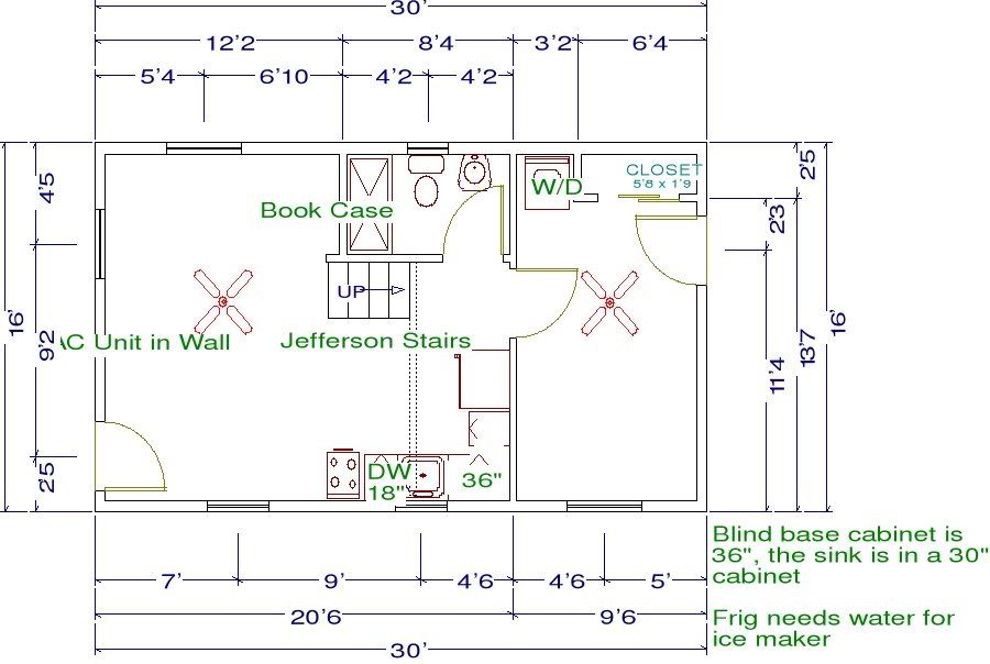

I started my small house this week. 16 x 30.  I have a question. The bathroom is 5 x 8, can i get a 36" door to work ok if the wall hung sink is 19 deep and 20 wide with a standard toilet and tub?  I want it to be handicap accessible for my dad.  It looks like the 5 x 8 at the link below but mirror.

The link is the first floor plan of what we are building. 12 high wall with upstairs. Our code requires 6" walls and 2x10 rafters for insulation in the North GA Mountains. It was cheaper to pour a concrete slab to meet code.
https://s986.photobucket.com/albums/ae345/billisnice/?action=view&current=billsogood.jpg

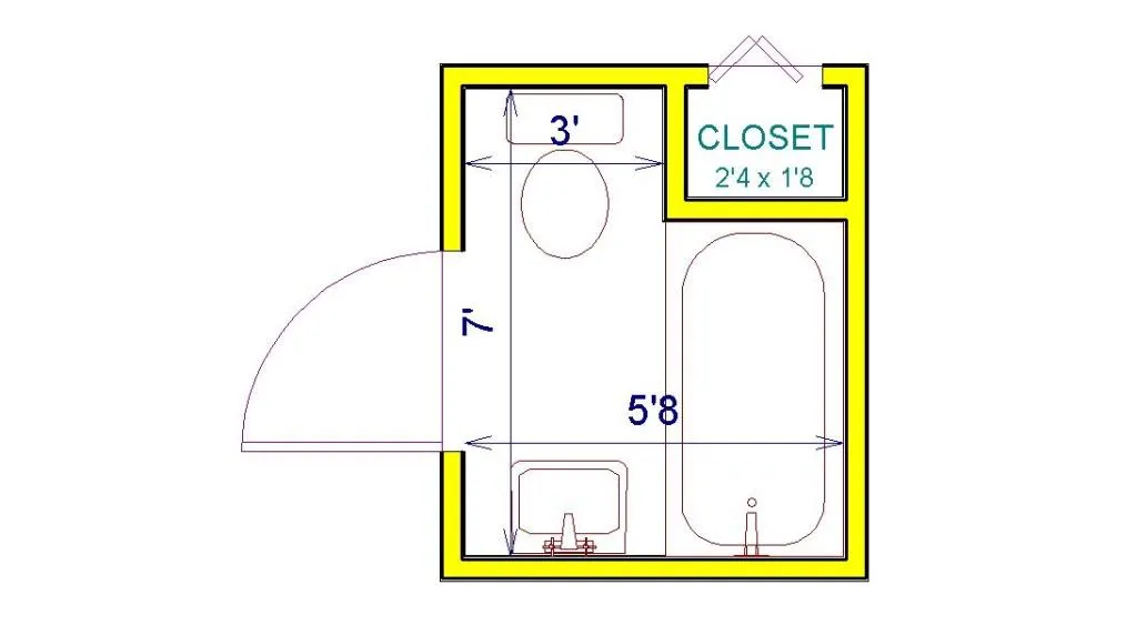

I have had to give universal design a lot thought and here are couple of questions:
Is the individual in a wheel chair or using a walker or arm canes?
Will he be using the bath as well?
With a walker or arm canes a 34" door cut down from a 36" is no problem and most can manage a 32" door.  With a wheelchair, standard instead of sport or armless model, 36" is about the minimum.
What concerns me about the layout, for a wheel chair, is that most will not be able to make the turn just inside the door on a 5' wide bath. 5'6" might do it but a straight shot to the toilet or 5' 8" is much better.  If he is using the bath, from a wheelchair, there will be two transfers, one from the chair to the toilet and one from the toilet to the bath.
Either way, do not forget the blocking for grab bars even if they are not to be installed now...blocking for a shower seat cost you nothing and can save you later.  Also, install levers instead of knobs on the door...same for the faucet.

Onkeludo2
#15
6 x 8' is great, but you can also get away with 5 x 7 if you use a door that enters the middle of the long wall.
The best design for me, assuming space is not an issue, is a sink directly across from the toilet and the tub straight ahead...heck a picture is worth a thousand words.
Almost forgot, the user cannot easily close the door in this layout unless a lanyard is attached to the door lever and the chair has drop arms.  Also, a roll in shower would be much easier than tub...but my aunt-in-law and my wife insist on a soaking tub.  Sheesh!  Women!

Perfect, wish i saw that before concrete was poured. lol
Onkeludo2
Looks like you have room for it so why not use a 40" or more outward opening bi-fold door.  I hate them and avoid them at all costs but they are problem solvers.
Like I said, I have had to work with this a lot. The drawing above is very close to what we put in my aunt-in-law's house.  Had to break up and re-pour a large chunk of slab to put that in her house.
