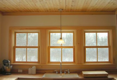

    * Windows & Ext. Doors ($13,000): Energy efficient windows and French doors were on our priority list. We opted for the Marvin Integrity series, which are fiberglass with a pine interior. We were able to reduce our costs a bit, while adding to the "Shaker" appeal of our house, by not purchasing extension jams for the windows, instead simply trimming them with 1"x4" clear pine.

    * Ceiling ($2500): As noted, we used 1x6 #3 grade edge-and-center bead pine. The effect is beautiful, although the boards can be difficult to finesse into place at times. Aside from the appearance, which we like, the narrow boards were a more feasible ceiling option for two people to work with than, say, hanging sheets of dry wall (especially true since we do not own a lift tool). We also painted the ceilings of the main living areas white while leaving the second floor (and kitchen) in a natural, rustic state.

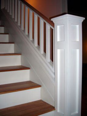

    * Stairs ($1500): Our stairway is nearly 48" wide, which allows a great convective flow of heat from floor to floor. Tutored by a Gary Stiegler article, we built a box newel post and cut our own balusters from 5/4" stock, which saved us a bundle. We purchased pre-finished birch treads to match our flooring and cut and painted our own pine risers. The oak railing is pre-fabricated. If we were to build it over again, we'd make our own treads as well as router a hand-railing. For now, however, the total cost for this project has been $1500.
    * Cabinets ($1500): Our kitchen is made from solid pine and maple. We installed 1½" unfinished maple counter tops along with a pre-finished 4" Boos chopping block for knife work. Both bathroom vanities (and closets) are under construction so we will have some additional cost there (perhaps a few hundred dollars); still the cost of all the cabinet work throughout the entire house will come in around $1500 when all's said and done.

Hi, I know it has been a while since this has been posted but I have a question as we are going to building our house similar to this in the next year. I would like to know how you managed to get those beautiful kitchen cabinets made for just $1500?
sjdehner
Hi!
We built our cabinets from locally harvested (Maine) higher grade solid pine. At the time thewood was not very expensive. The laminated maple top came from www.lumberliquidators.com at a shockingly good price. We bought an 8' & 12' slab for the kitchen as well as a BOOS block cutting board from our local hardware store.
In the future we might try a thicker hand-built counter top.
The hardware all came from Lee Valley online.
We found that staying away from prefab materials is a sure way to save money and get a unique end result.
