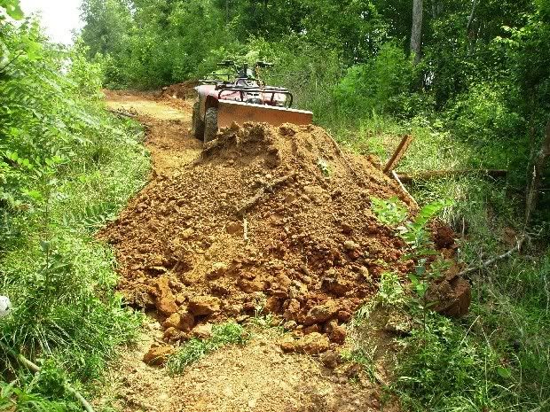

This weekend I have to build a retaining wall on a section that ithat I put a culvert in and is too steep to get the tractor over. I'm piling dirt up with the tractor and pushing it in with the atv.

@Peter. GREAT pics and nice tractor!

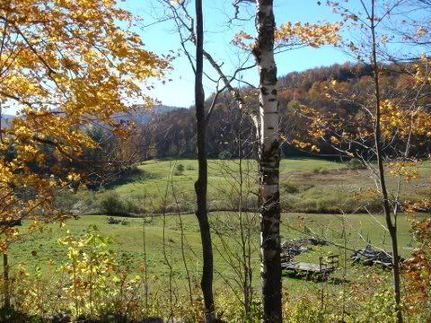

btw, here are some pics of the land.

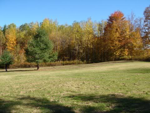

and this one

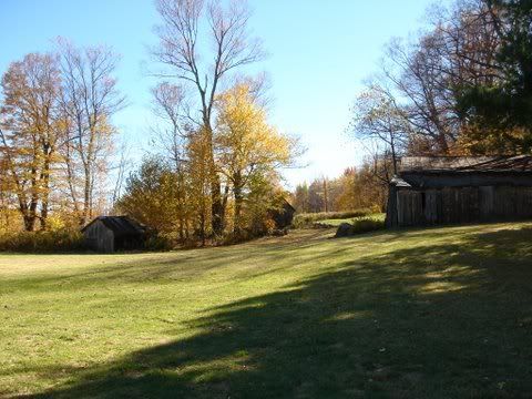

Here's a view just down the road (and the reason i love this area); looks like England to me

Those are beautiful pictures. What a great spot for a cabin. I can see why you would fall in love with veiws like that!
