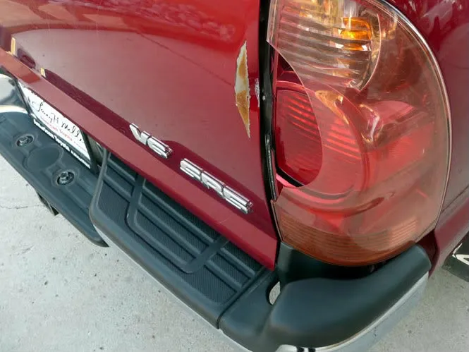

Not as pristine as the first impression.
Quote from: MountainDon on August 31, 2012, 08:38:22 AM
If you're saying that's not pristine Don...I'd best not show any pictures of my Bronco. :-\
