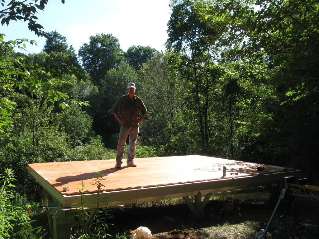

Is 3/4 inch T&G standard for the floor?
dug
3/4 T&G plywood on 24 centers is what I used for my floor. Some say it is a little spongy but mine feels plenty solid to me. I know that it is rated for that.
One consideration for 24 in. centers on the walls is that you may have to use thicker (heavier!) sheathing and drywall on the inside.
Looks good!
Tom unless you have already purchased your subfloor you might consider "Advantex" or "Surfloor" if you think it will be sometime before you get it under roof. Standard OSB will not hold up well when exposed to the elements.

I can't tell.  Are you using 2x6's?  It looks like you have 1ft of overhang on each side.  That would make me guess you have a 10 ft span for your floor joist.  I used No. 2 SPF for the span calculation (because that is the most common at home depot) and came up with a maximum span of 8 ft @ 24 in on center.  I wouldn't recommend it.
Also.  It looks like you spliced your built up beams in a spot that is unsupported.  I'm not trying to be critical, just trying to pass along some pointers that have been pointed out to me.  Hope it helps.
Tom
FIRST... I don't hear anything as criticism. I appreciate your input. Without this site, I doubt that I'd be able to pull this off.
Yes, I used 2x6. The runners are doubled and where it's spliced, it's glued and screwed. Should I put a support under these spots?
Also correct on the 1 foot overhang with the 10 foot span. I had wondered about this as well and had already decided that I'm going to put concrete blocks under the center with a 4x4 to support the span. Thanks for pointing this out though.

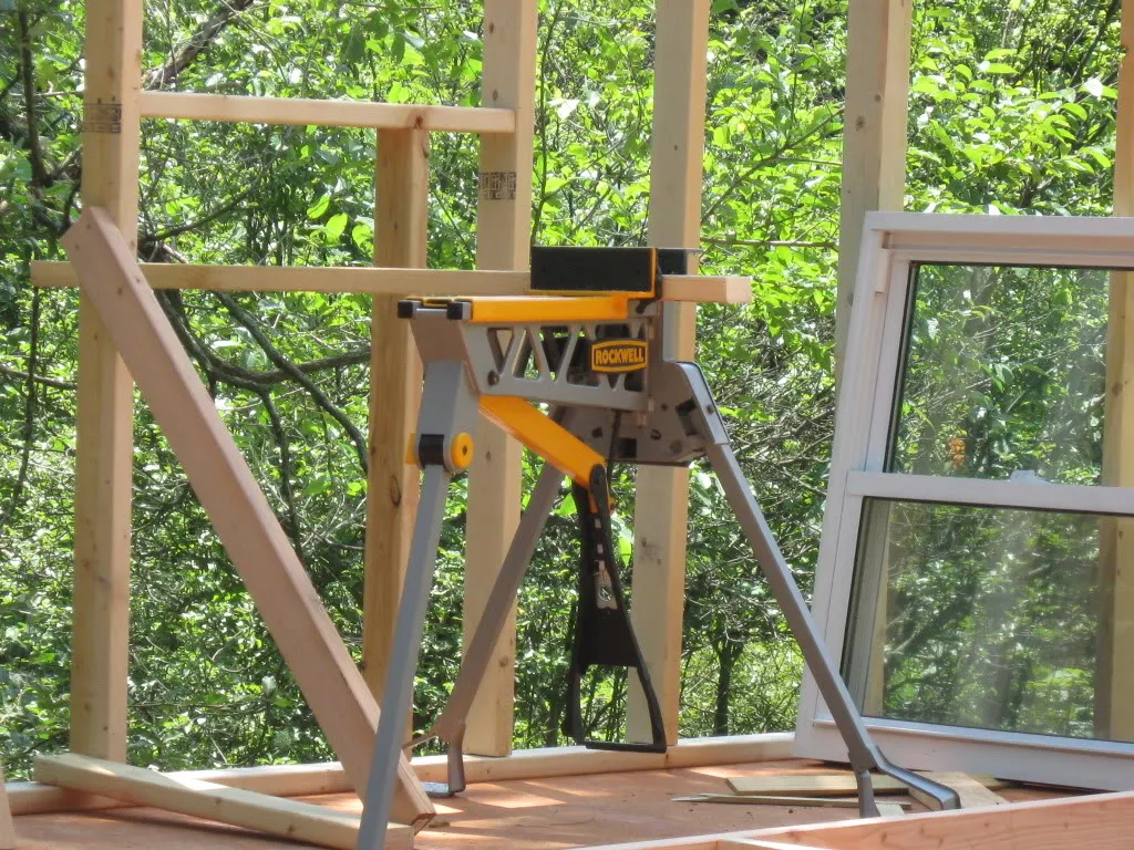

For those who work alone, I'd recommend the Jaw Horse. My wife bought me this for Christmas. I can't say enough good about it.

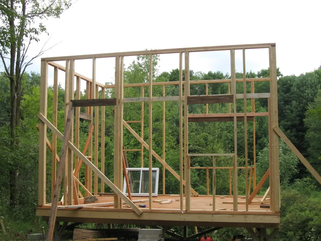

I have some cripple studs to put in yet, and two more walls to finish. Most of this stuff is pretty straight foward. The thing that keeps me awake at night is trying to picture in my mind the best way to construct the loft beams.
I've been going through several threads in here, trying to see how some of you have done this, but I can't seem to find anything that makes it clear. If anyone has some good pictures of how you did yours, I'd appreciate your ideas.
Thanks
If you have the Enchilada plans (Builder's Cottage) to work from I have a 4x8 @ 48" o/c loft framing w/ 2x6 T&G decking detail that you could adapt. This can also be done w/ double 2x8's. It is important to get a proper connection between the rafter and this deck beam/rafter tie as it triangulates the roof structure.
Cool tool, Tom.
I may have to check out the Jaw Horse myself.

I forgot to take the camera last time out. I have the loft joists in (not pictured here).
Michigan has been very wet this year. I've been hoping for a dry spell so that I can get the sheeting on, but no luck.
How much rain can strandboard take before it begins to swell?
Next question...
This will be a 12-12 pitch. I plan on running an 8 inch beam, but can I go with 6 inch rafter boards?
Thanks for looking in.
Tom if you are getting a great amount of rain I would consider giving it a coat of paint.  You are at the stage now where there is no place to drain the water (wall partitions up).  You might pay attention to any low spots in the floor where it will puddle and drill some drainage holes to keep it from pooling.  I always stress "Advantex" as I know how long it takes to do a project when you are working by yourself. It is a small price difference and for me it has already paid for itself. As far as a time frame I really couldn't say only that it will first swell and then start flaking off.
Given the size I would say that you can get along with 2X6 as rafters although 2X8 would be a better choice.  The only downside is that there is little room in the rafter cavity for insulation.  Basicly you have 5-1/2".  Deduct 1" for the styrofoam vents and that leaves you with 4-1/2".  R-19 I believe is 6-1/4" and if you compress it into that space you will end up with around a R-16.  The only way to get the value higher is using solid styrofoam or sprayed foam.
