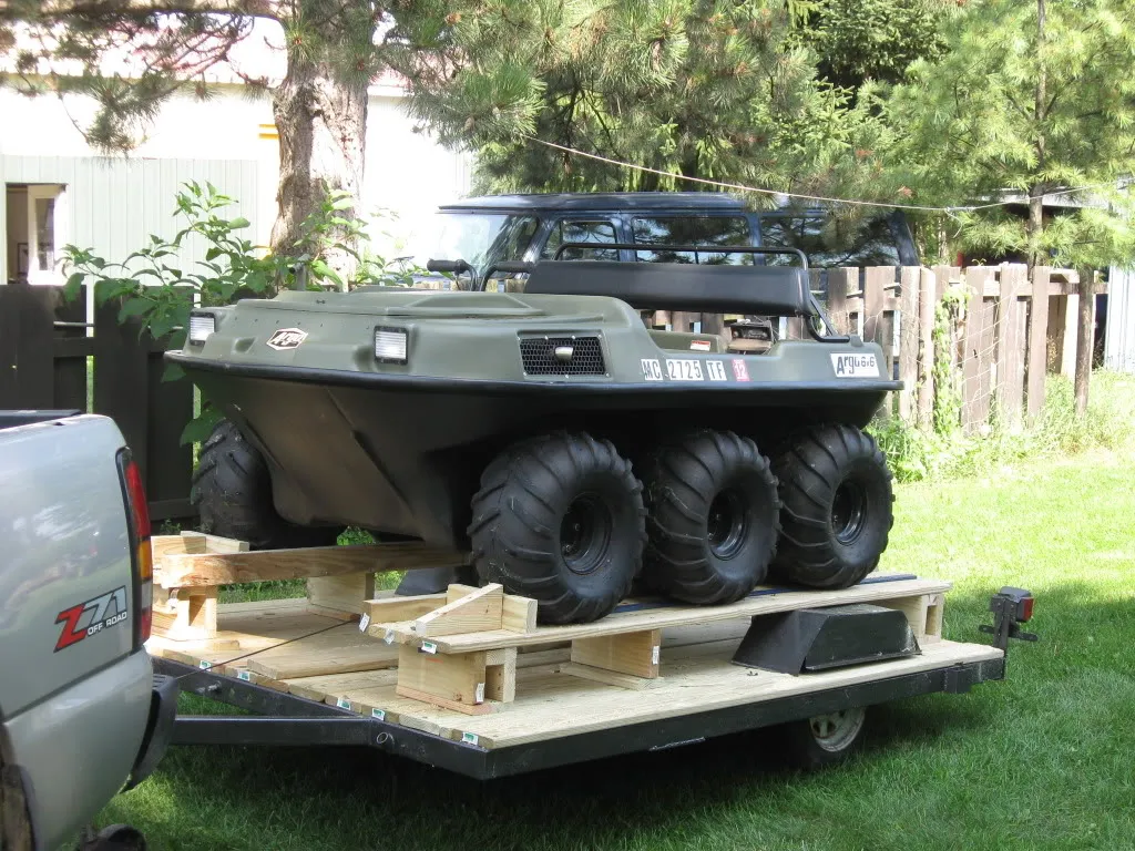

Well, being as I bought land with a swamp across it, my wife said that I'd better buy something to cross the swamp with. I told her it wasn't needed as long as she was willing to drag deer through the swamp for me this fall. My shin is healing nicely  ;D
The only problem with this vehicle is that is won't fit in our utility trailer, so I bought an old wreck of a trailer for $100. I fixed the tire, tore off the old planking, painted the rust with Navel Jelly, patched the holes in the frame with angle iron, painted it up and put new planks down. Then I built ramps up over the wheels because it wouldn't fit between.
This thing isn't fast (25 mph) but it's a riot to bomb around with.

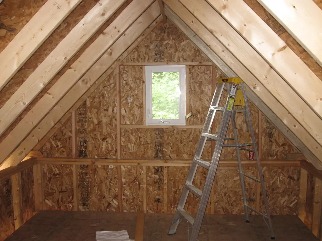

This will be a 12-12 pitch. I plan on running an 8 inch beam, but can I go with 6 inch rafter boards?
Thanks for looking in.
Don't forget the trimmers under your headers before you load the roof.  Nice clean job so far.  Keep it and have fun with buggy!

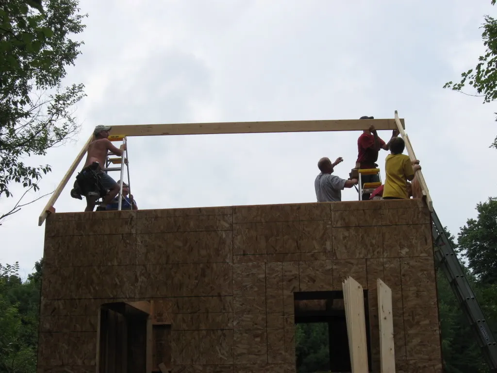

My friends all began calling me last night to ask what to bring and what time to show up. Without telling me, Rainelle spent the past week rounding them up.

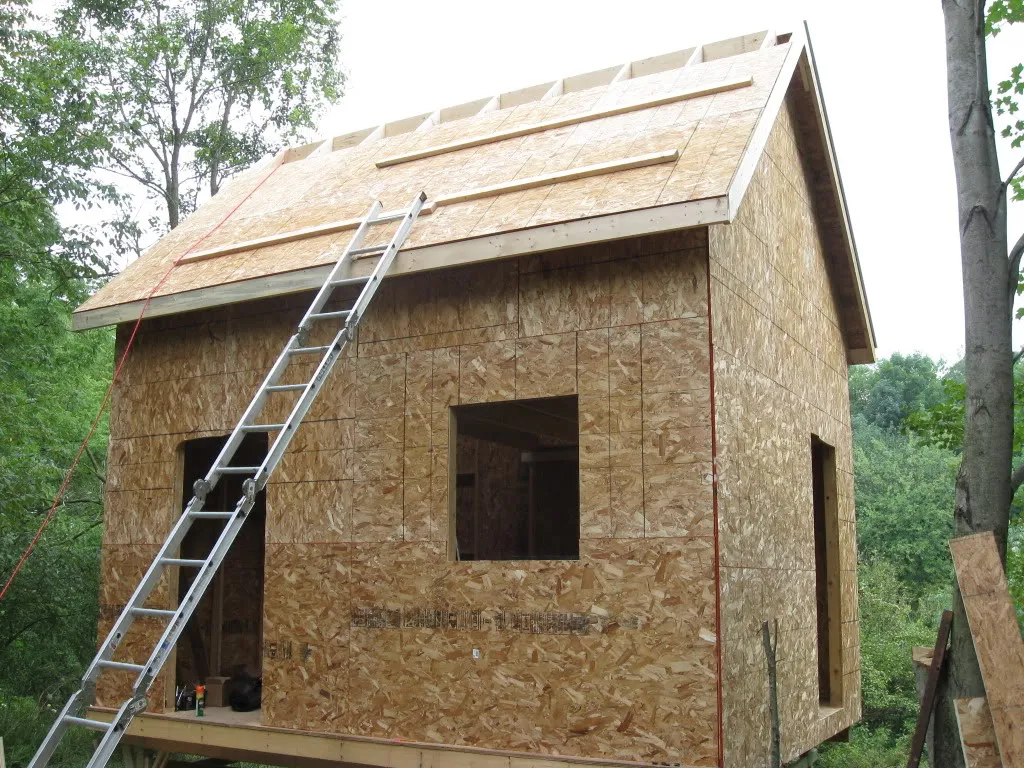

The weather man is calling for a 50% chance of rain today. The goal is to get this dried in today.
This post is a thanks to all of you as well as a thanks to my wife and my good friends who will give up their Saturday for me.
Well, the sun is coming up. I'd better get my day started.

Looks like you're doing just fine, working alone!  I was looking at getting some transportation while up at my place - quad, and then I saw some of those 6X's for sale.  They look like they'd be a gas to run around it.  My problem is that I don't have much water around my place, and I think I need the power of a quad...  I love the color of yours tho!

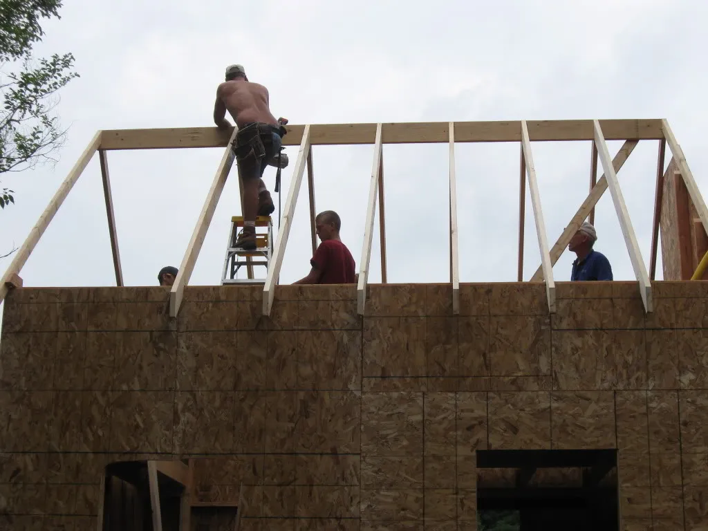

My guess is that you will want to line up some help for the roof.  Mine is 12:12 also, and I've tried at least twice to get up there and get started on it by myself, and chickened out both times.  I'm giving up and calling in the cavalry for help.
Getting the sheathing on shouldn't be that much of a problem, once you get to it.

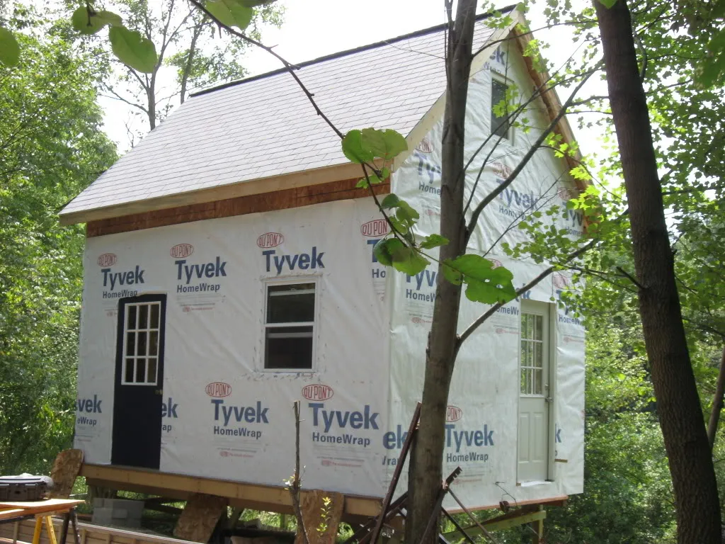

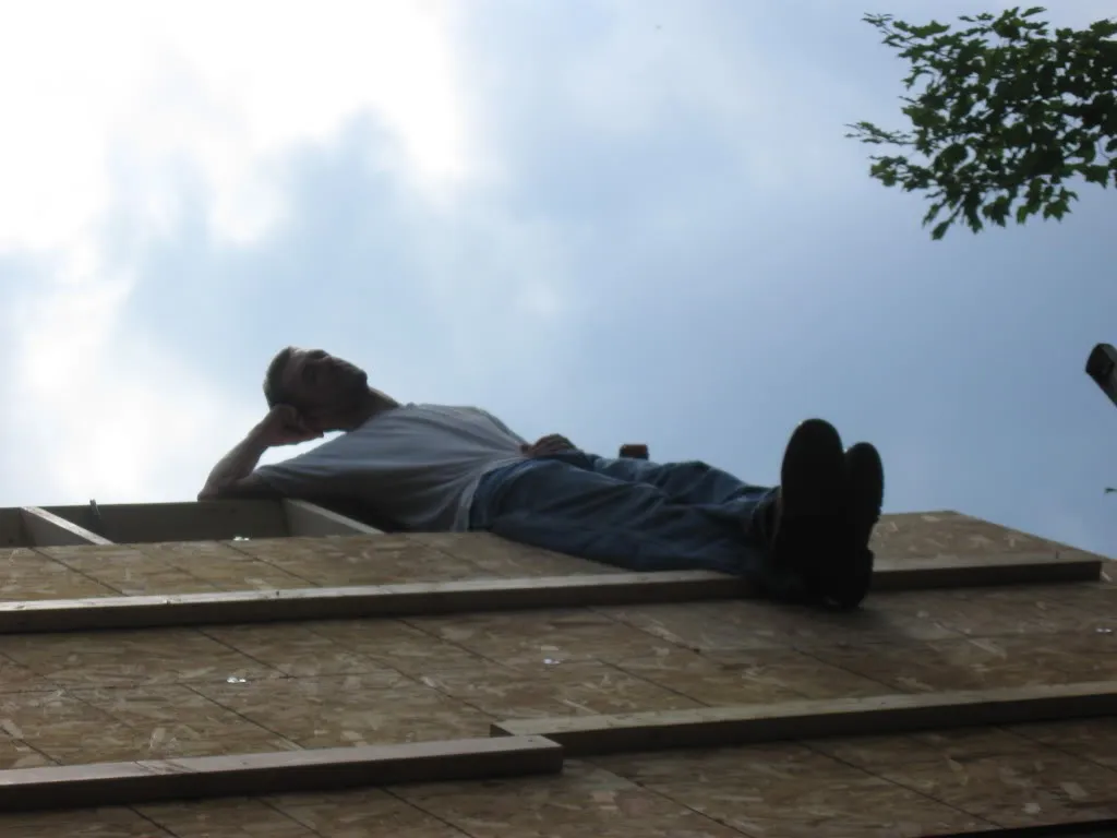

Well, the day began with clouds and then rain, and then sun. Welcome to Michigan. If you don't like the weather, just wait a bit.
Lots of laughter with good comapny

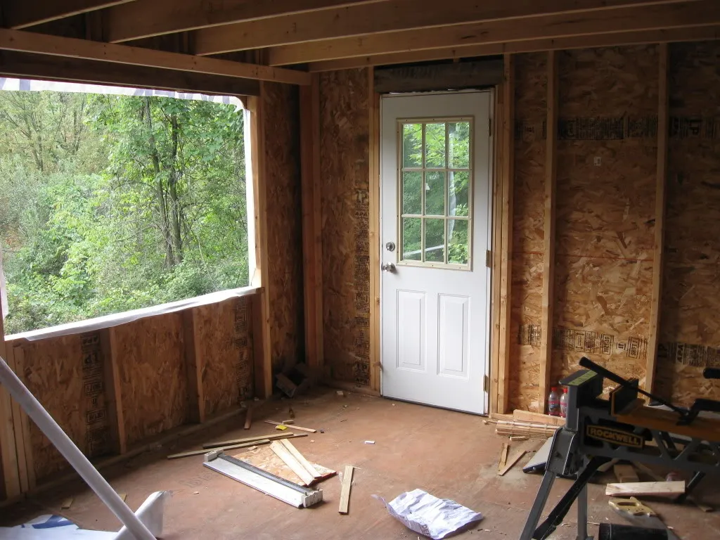

I wish that I had taken pictures of the interior, but those will come.

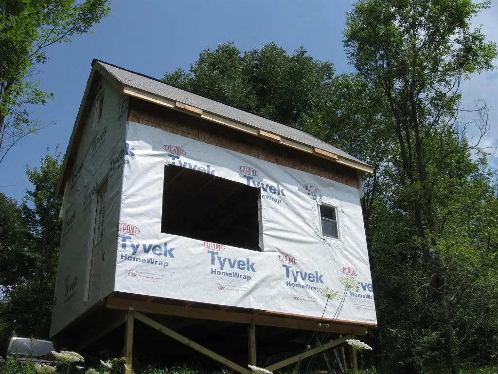

I really liked the idea of a 12-12 roof, because I'm no builder, and it makes the math easy. I also like the loft space, but like everything in life, there are trade offs. Roofing a pitch like that isn't easy. I was glad for some help when I got to the second side.
Putting the Tyvek on alone was an excercise in frustration. The side peaks are going alright, but it's so hard to keep things straight. Each time a wind came up, I'd look Heavenward and remind God that I'm trying to do this without the bad words  ;) So, if the Tyvek looks a bit messy, it's because I did it alone, and only fell off the ladder once... fortunately it was only a 5 foot fall. I'd post the pics of the bruises, but no one wants to see my old butt  [shocked]

QuotePutting the Tyvek on alone was an excercise in frustration.
I can relate. I picked the windiest of spring days to install my felt paper solo. Just when I had a 20 ft. section lined up and ready to nail a gust would blow, rip the paper, and I would have to start anew. I know things can get a little wacky working alone but I swear the wind seemed to laugh at me!
Rest assured it will make no difference once it is covered with siding.   :)

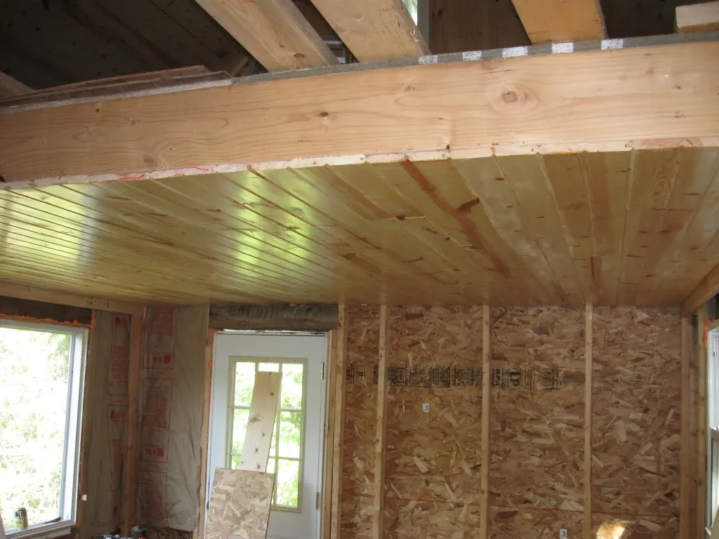

Solar Burrito, If you go to the previous page, you'll see where Redoverfarm was kind enough to tell me about kraft-R-mates in the rafters. MaineRhino was also good enough to post pics of what Red was talking about. The pics should explain the venting system. Just make sure that you give the air a place to escape at the top, like a ridge vent.
The kraft-R-mates come in plastic or in styrofoam. I chose the plastic, just because I've seen the damage that mice can do to things.
The kraft-R-mates leave a small air space that vents off to the ridge vent. As Don points out, without venting the loft area, it would cause problems.

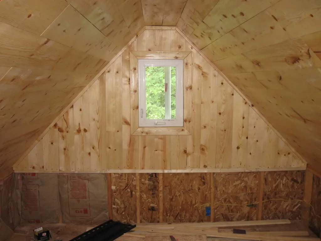

Arizona Highlander, Thanks. I bought all the windows off craigslist. I put a small one in each end of the loft. Being as I have no electric there, I figured that I'd do all I could to keep the air moving through there... especially during the polyurathane process  [yuk]
