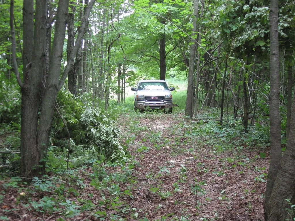

OK, I'm running solo on this picture posting thing. The wife has left me unattended. SUCH a dangerous thing to do.
Progress is slow, but it's progress. If wet weather isn't in my low back and legs, I can manage 3 to 4 hours of work before I'm done in. I love the sound of that Stihl 029 singing out on a clear day  [chainsaw]
I'm 95% finished clearing a driveway back to where the cabin will be. Now I need to get back out there and and witch for water. The water isn't hard to find, but finding a vane within easy reach may take longer. I'd like to put in a hand pump inside, but I don't know how hard it will be to drive a well point. Has anyone done this by hand? My other option would be to place the cabin near the water vane so that the pump sets outside the door.

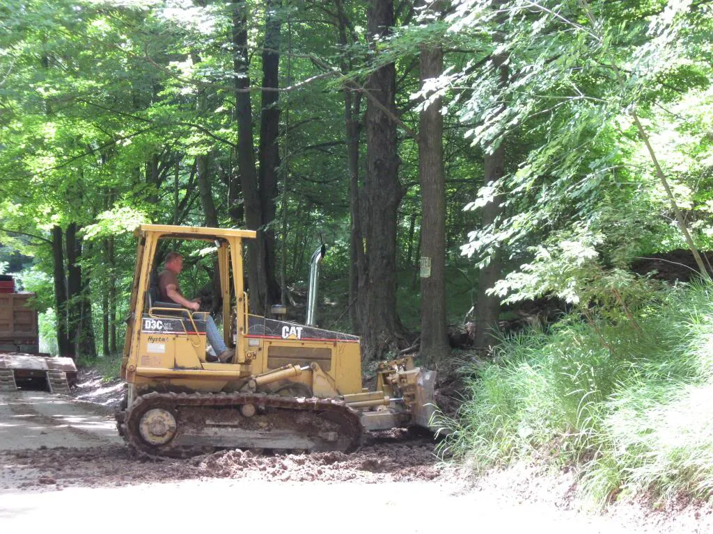

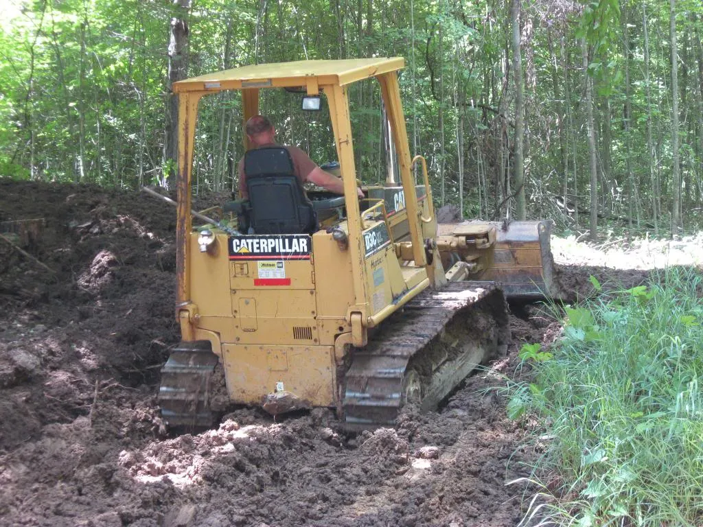

After a great deal of rain here in Michigan, I could no longer navigate the hill onto my property so I called a guy to come and move some dirt for an access. Unfortunately, it was too wet for him to complete the job. He was spinning around with his equipment. He told me that he'd come back after we've had some dry weather

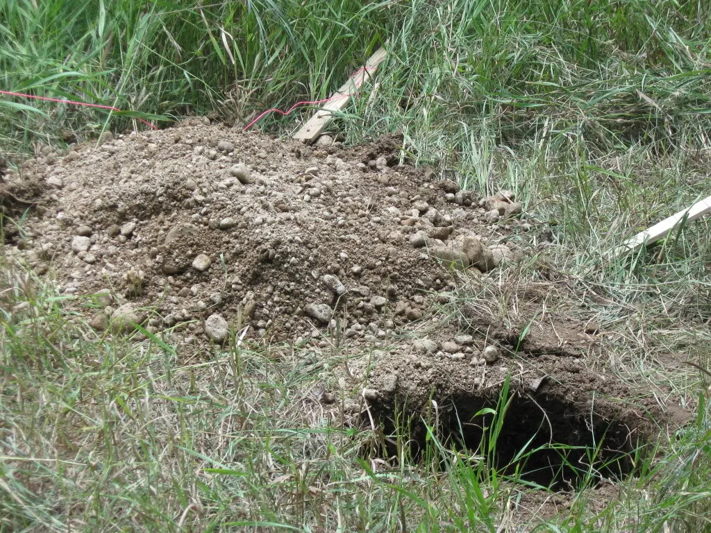

The good news is that I did get a start on the cabin site. I used a post hole digger and found dirt that seemed about the same as what they spread out on a gravel road. I managed to get about 3 feet deep before I couldn't go any deeper. I'm hoping that this will be good enough to deal with the frost this winter.
Tomorrow I'll fill the holes with pea gravel and set the piers.

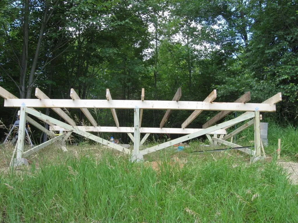

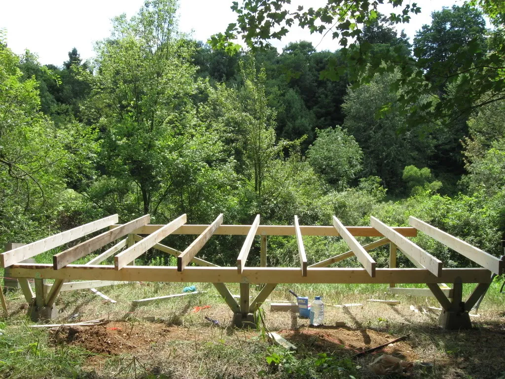

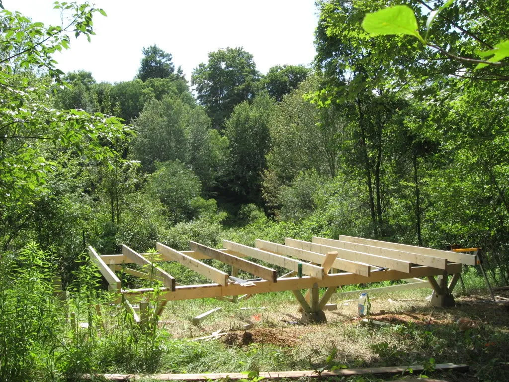

Here's the view from the front.
I plan on building 24 inches on center instead of 16. I'm assuming that this will be ok for the floor joist too. If not, I'm hoping that someone will advise me.
Take a look and let me know if you see any potential problems.
Thanks
