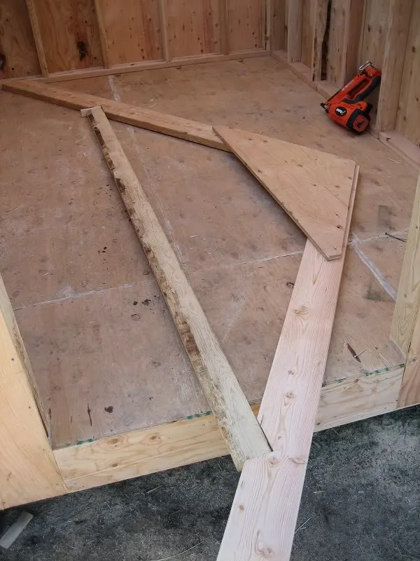

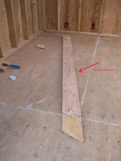

Hopefully one of the framing/roofing experts will see this and chime in.
I'm trying to think of simple ways to create a set of rafters.  What I'm thinking of are basically putting the rafters together (no ridge board) beforehand and then setting them into place, swinging them upright and nailing the blocking in between the rafter "sets" as I go along (after nailing them to the strong-ties that tie them to the top plate).  What I'm looking for are ideas for simple construction of the two together.  Given that the peak is a 90 degree angle is it mandatory (or even "best practice") to cut them so where they butt will be a vertical joint? or can I "lap" them on over the other? (my first guess is that I need it to be vertical)?
Regardless of how they meet at the peak, I fully intend to have plates (gusset?) on each side of the joint for strength and stability.
Anyone with an idea on this?
Thanks
Karl
Pre-building rafters was pretty easy on my 8x10 with 7 foot walls.  Might be trickier with your height and span.
I wouldn't lap them because then your gusset plate has nowhere flat to go.
I didn't have room inside to trace them out so used the back wall and made a plywood template.  Worked it out off the center line of the building and never even had to calculate the actual length.  Cut 5 inches off each end to mach the baseplate on my saw made cutting easy.  I'm still not good at cutting the birdsmouth but at least it's in the right spot.
Cutting Jig
Tack the peak together and then put a spacer in the birdsmouths that is exactly your building span (including sheathing).  Now fully nail the gusset plate.
Nailing Jig
Screw down a strip of plywood to adjust them before fully sheathing.
