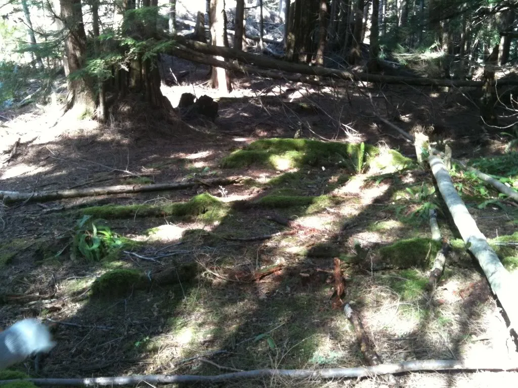

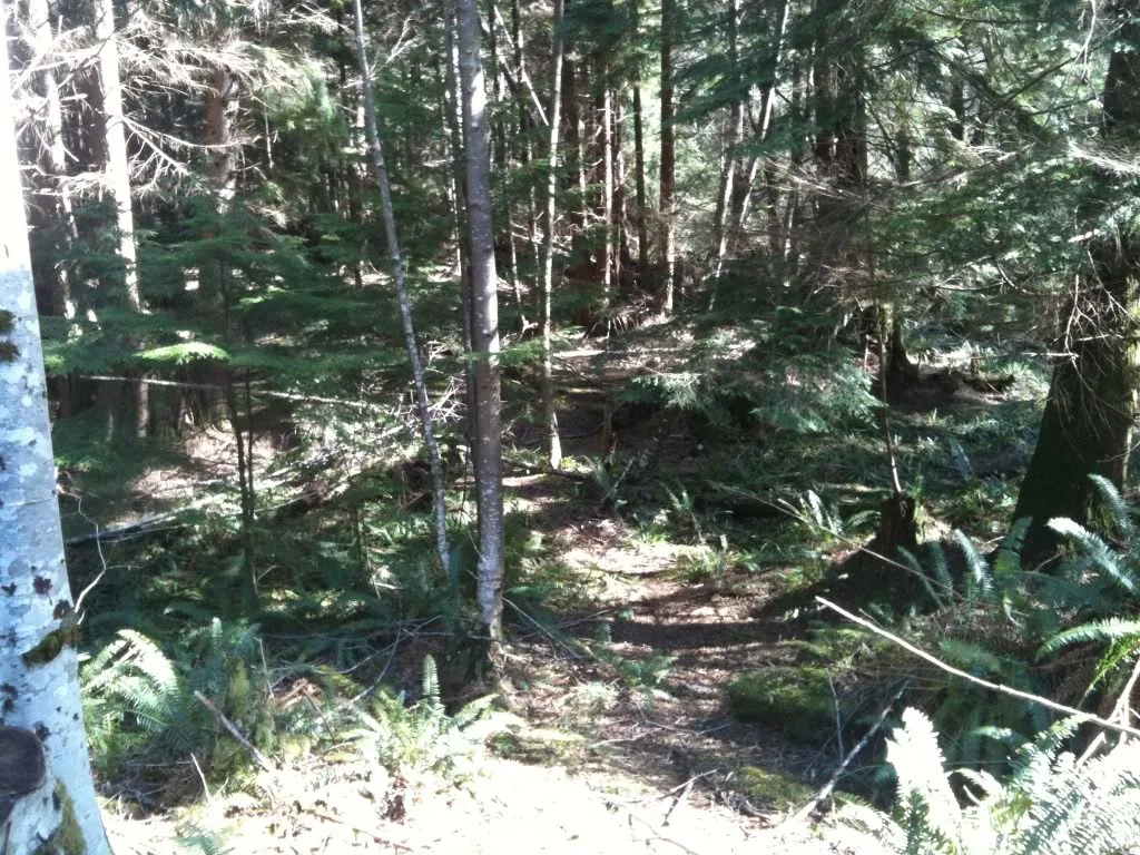

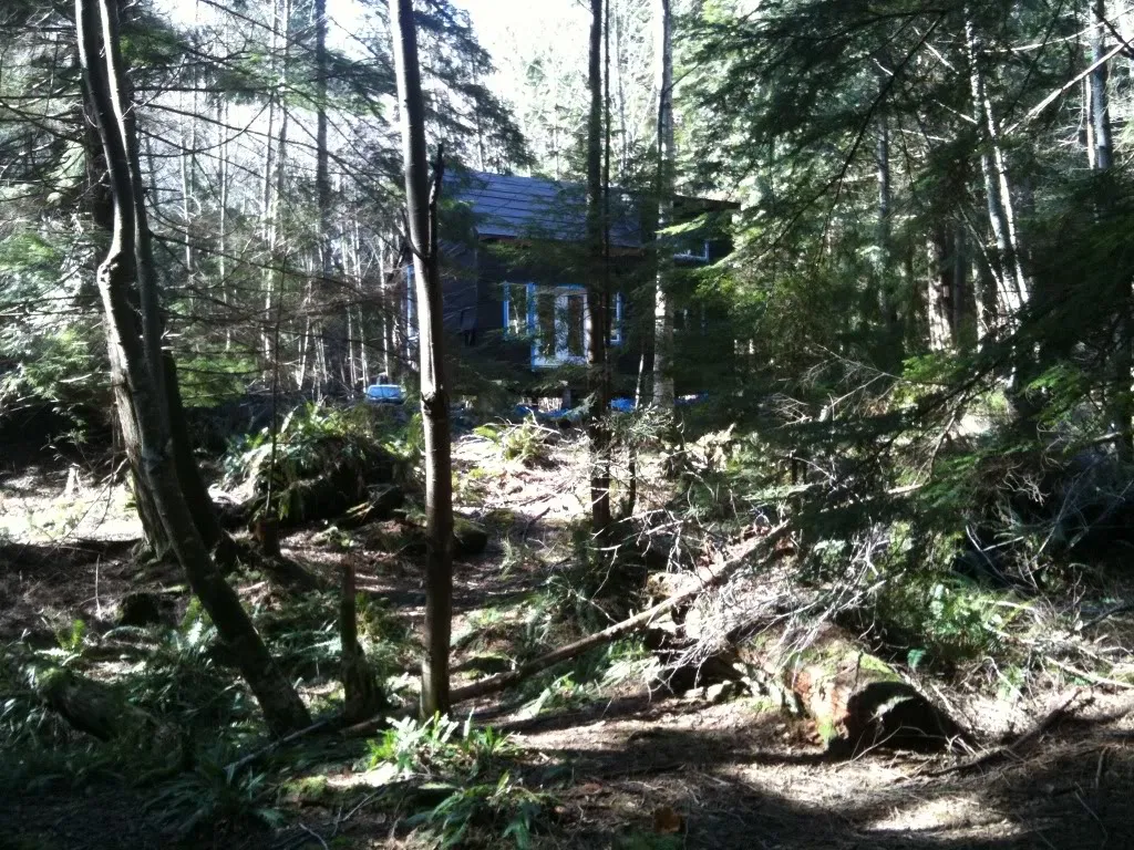

Buddamonk
A few shots of the location of the cabin.
Bobmarlons cabin is real close buy.

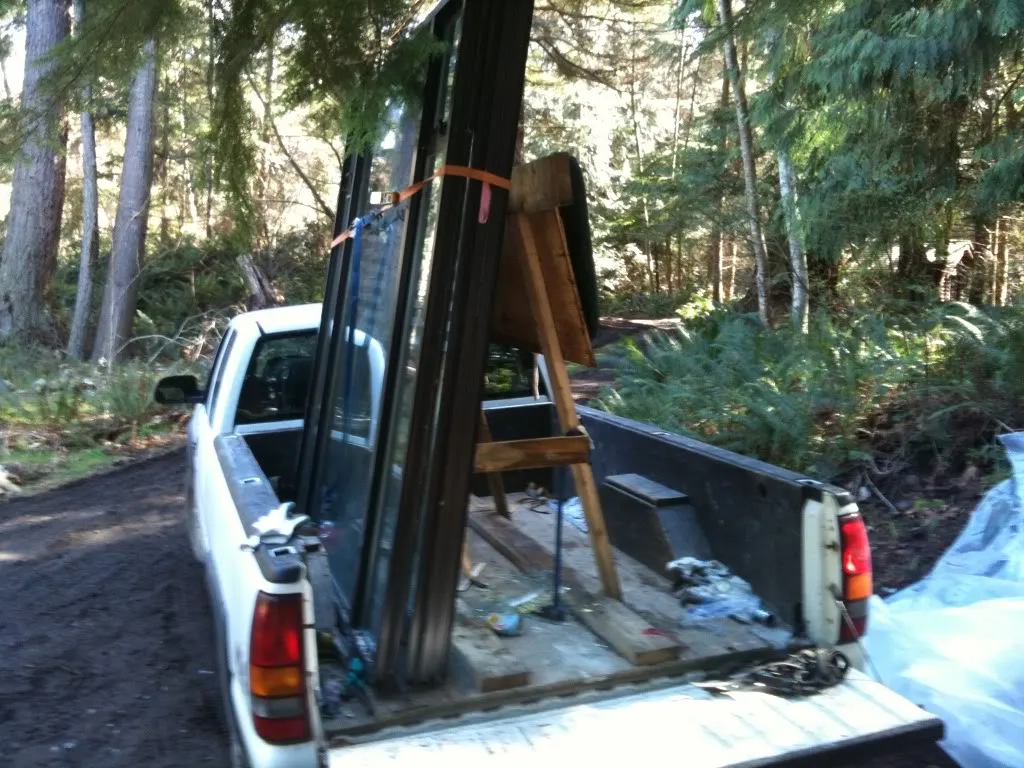

Scored some free windows and a sliding glass door.
