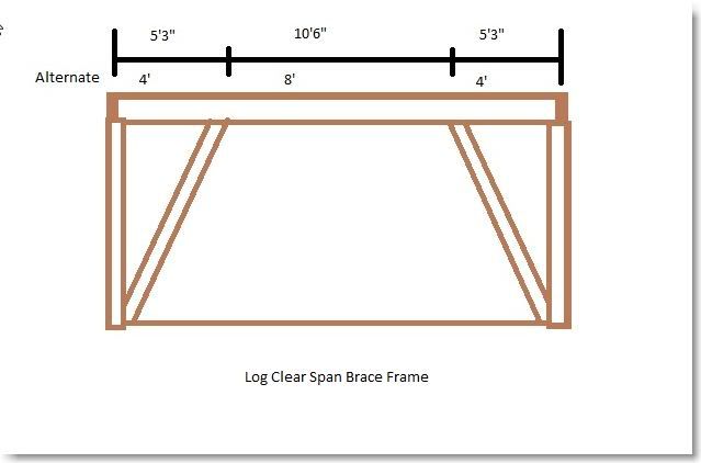

He recommended that we add the diagonal bracing also when I told him that my wife wanted more glass and exposure on the south side.  Mike has really spent a lot of time and effort creating and documenting ideas that work.
I used his 10'6 spacing in a couple areas then diagonaled down from a 21 foot girder 5'3 in each way from the ends leaving a 10'6 span in the center but taking the load down to around 20 feet clear inside to give me a wide open bottom area but still maintain the 10'6 engineered span on the top.
Since this moves the center load to the sides near the other footing it is essential that the ground can support the load either on it's own or by adding an adequate footing.
This gives diagonal bracing and a clear span for an unobstructed larger room while still meeting the original engineering numbers..
