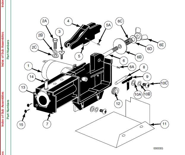

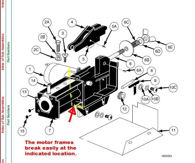

The facings are not the problem.  The metal box is the holder for the motor frame.  The side cover will open up to where you can put a 10lb roll of wire in.  The wire is then fed between two drive wheels.  If it has not been improved since the last one I bought, the frame holding the two drive wheels for the wire is plastic and it is what will break in half.
The same frame in a similar location on the Miller is made of aluminum and will not break.

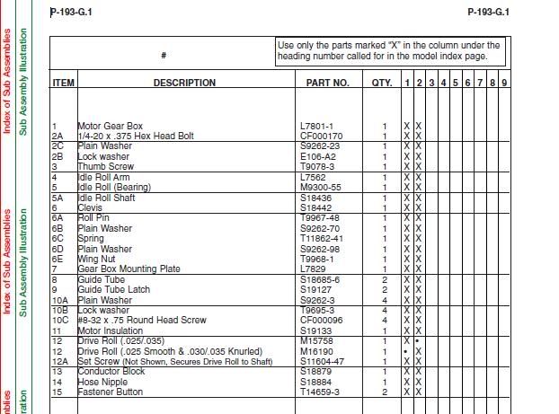

Here are the Lincoln details and part numbers
Taken from a current parts manual, they appear to be the same black plastic motor frames as the ones that broke easily on mine.
The problem area.
Note how the plastic casting is only about 1/16 to 1/8 or so thick at this area and is easily broken by leverage on the solid mounted end of the gun.
Proper name 7.  Gear Box Mounting Plate
n74tg
I looked at a Lincoln 125, 140 and 180 yesterday at Lowes.  If memory serves, all three had plastic where you say it breaks.
Thanks for taking the time to publish the drawing.

My pleasure.  I have done a lot of welding with the Lincoln but use it commercially and am a bit rough on things.  Not saying if you have one it will for sure break, but it is much easier to make a nice weld with the Miller also.  At this time I have 2 Millers and no working Lincolns.
If you decide on the Lincoln I would recommend keeping it on a cart or just be careful with the gun mount area.  The repair part is pretty cheap I understand but it is frustrating if it happens when you are in a hurry.
