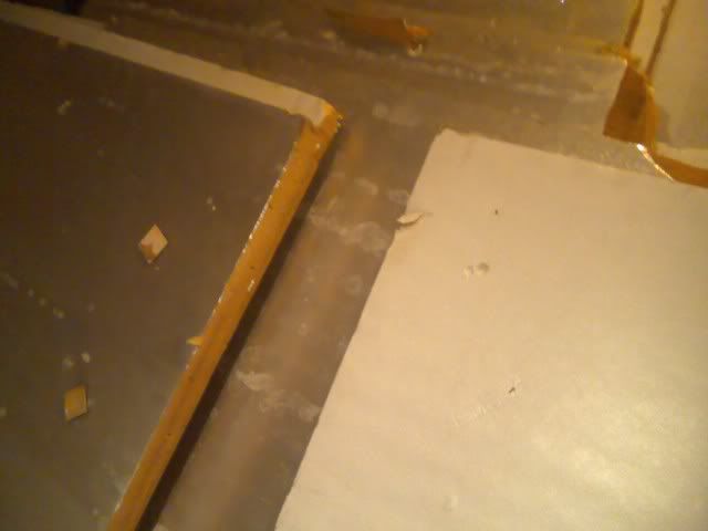

Here is a pic:
Sort of looks like the stuff they use to insulate coolers at grocery stores when they are manufactured. But maybe a little lighter weight than they use.  That size is a little odd.

I saw this stuff being installed in a flat, industrial ceiling at work, I believe.  It is formed with a rabbetted or lapped edge so the pieces can go together without a seam.  I am looking to learn what type it is and anything special I should know about how to work with it....
davidj
Looks like polyiscyanurate to me, aka polyiso - it's yellow and typically has metal facing.  This is typically around the R7-R8/inch.

Thanks for the identification.  I was able to Google it and learned more about the properties and proper application.

David is probably correct on the ID; that's what mine is.  Good stuff.
Just remember that if you want to take advantage of the foil facing, there must be an air space between the foil and whatever else is used in the installation.
