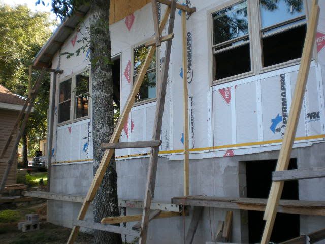

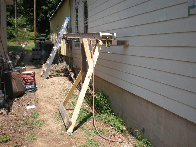

So, here is what I'm using.  I'll call them lean-to scaffolds.
I tried this on the side wall to make sure it works (and I wasn't too high off the ground); pic one
That worked well, so I built some taller ones
All my work at this level is done; today I moved the walkboard up to the window bottoms.
Notice there is a diagonal from the horizontal support to the tripod.  This keeps the walkboard from swaying when you walk on it.
So, far I've been pretty happy with the results.  My gable is about 25 feet above ground.  The tripods are built from 12' 2x4 overlapped anywhere from six to nine linear feet, with lots of 3" screws holding everything together.  And there are angle brackets attached to the leg bases with rebar pins driven into the ground to totally secure the legs from moving.
Anybody see anything terribly wrong about this design...speak up...please.
