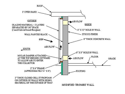

   You may want to consider a thermal mass system (trombe wall).  Instead of buried PVC or a raised floor, you could put vents in the bedroom wall near the floor and the ceiling.
   Trombe Wall Link . . . http://en.wikipedia.org/wiki/Trombe_wall
   I would install the wall on the south side. . . Limiting windows and doors to the east and west.

I would install that Wall system only if I was trying to add a heating system to a already built house, as my method is to naturally move already heated air.
