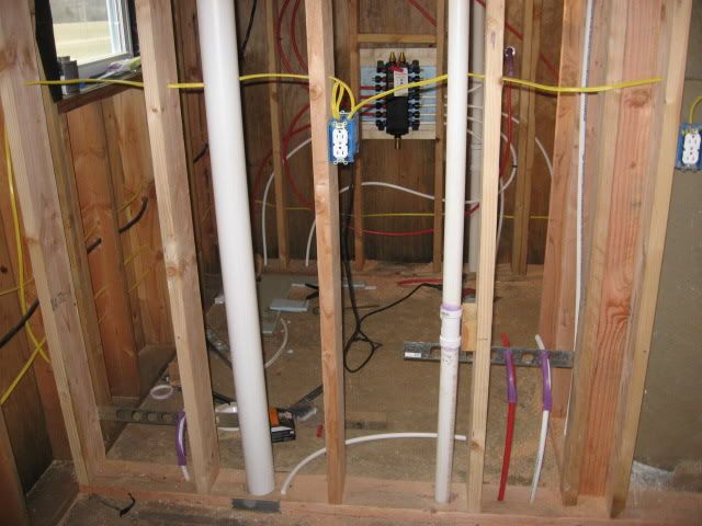

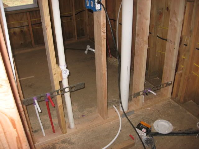

However, I did notice in your plumbing photos (reply#192) the it appears that the "T" fitting in your main vent stack is upside down.  It's hard to tell from the pics, and I could be wrong, but if that is your main vent (dry) then you should turn that fitting around.
Thanks for the compliment, bmancanbly!  And I think you're right, I do have the san-tee upside down.  Thanks for pointing that out.  It's one of the reasons I'm going to look at it for a while before gluing it all together.

archimedes
Some additional photos of the plumbing would be helpful.  It's hard to see how your fixtures are set up in the pics.  You may have added more venting than you needed to.  Not a bad thing, just more work.  Hard to see though.

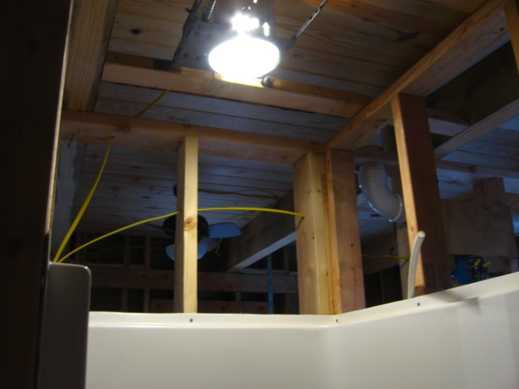

We have power!!

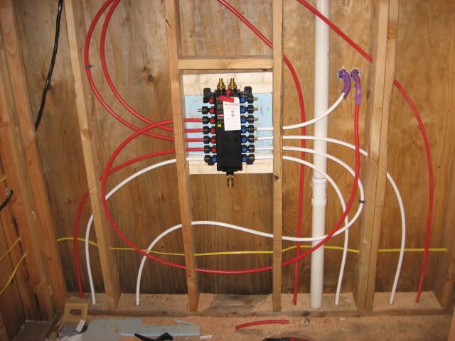

The DWV is all glued and ready.  Red- your marking method worked great!  I started from the bottom and worked my way to the top.  Had to stop and squint at some sections a few times but no major problems.
Started in on the pex runs.   Looks like a crazy spider is loose in the house!
Getting closer to insulation and drywall!!  I'm going to let someone else have that fun  ;D  I had planned on hanging it myself but I've been talked out of it by several people.  I was surprised to see how little more money it would be over materials to have it done.  Plus it will be done right and much more quickly than if I was to attempt it myself!

jdhen, the water line for the toilet should be on the left side.
Like Scott said but with the availability of flexible supply lines in various lengths it will work.  The down side is that if you ever have to work/use the shutoff it is a little cumbersome to get to.  On mine in the loft bathroom it is completely on the right side.  But I had issues being the open beam and it was the only place that would work.  18" supply line will get it.

jdhen,
I was wondering where you picked up that pex manifold?   ???
pocono_couple
great pics, jd -   did you get the pex locally or did you have it shipped. what brand is it?   seeing what you did helps a lot when it comes to the stubs for fixtures..   i will be tackling the plumbing in a couple of months..   your discussion about starting in the basement and working up was also a help .  any other tips that you came across and would like to share would be welcome!   nice job on the house...
jdhen
Scott and Red- thanks for noticing the error. I may just do as Red says and use a longer connector to get it to the toilet.  I'll have an easy shut off valve right accross from the toilet at the manifold.  It will have an access door.
John and Pocono- I purchased the manifold through pexsupply.com.  The tubing and crimp tools are vanguard which is the original maker of the manibloc.  Everything I read says to keep all the componants from the same company.  Vanguard pex and tools are sold at Lowes.  I tried to find some of the plumber preferred brands like wirsbo but couldn't find it locally and it was hard to justify the cost $300+ of the tools anyway for such a small job.

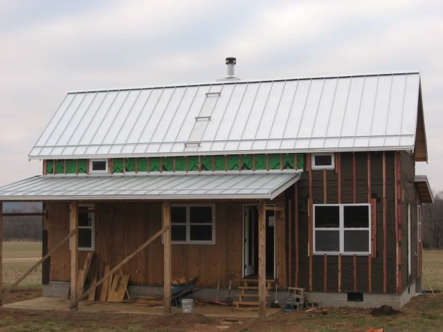

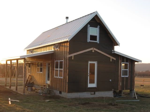

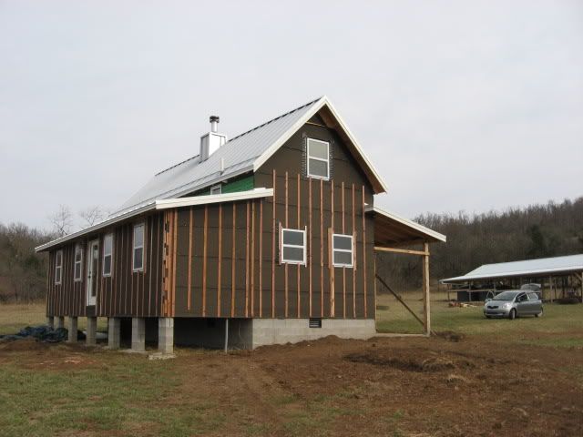

Still chipping away at it!  I've taken advantage of the warmer temps and have started adding the furring strips for the rainscreen.  I had a local cedar mill cut 3/8 inch thick by 2.5 inch wide strips.  They did it for pretty cheap and it was easier than ripping plywood into strips.
Looks a bit like a jail now.  The strips extend up to the triangle created by the gable ends.  Above that we'll be using cedar shakes so the drainage plane will be created with Obdyke home slicker.  Below that will be horizontal plank siding- likely Hardie board.
On the east side I added the first set of rafters for the addition so I can add flashing and side above it.  The add on will happen later....I'm going to need a break when phase 1 is complete ;D

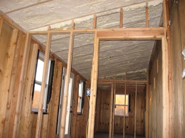

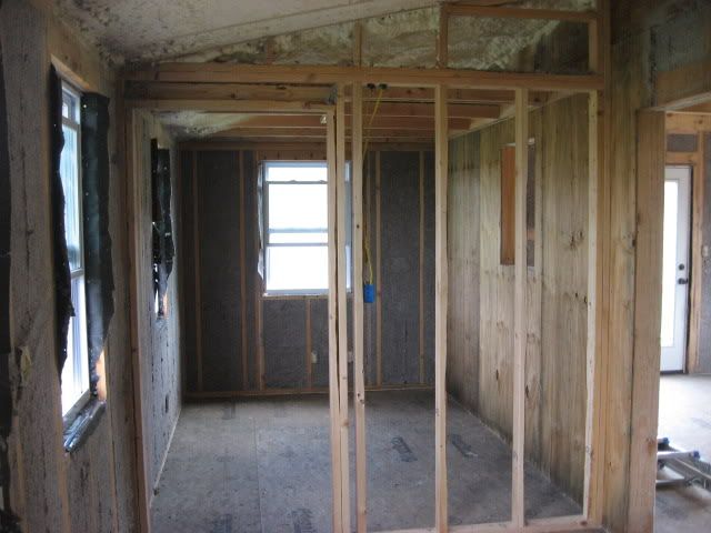

Yesterday we had the north shed ceiling insulated with foam.  I had intended to ventilate where the shed meets the end wall but after several snows with large amounts sliding off the 12/12 pitch we had snow push back up into the vents and drop into the living space.  The 2.75/12 pitch is not steep enough to allow the snow and ice to continue to slide off.  So, my roofer closed off the vent space with z flashing and we had the bays completely filled with foam.
Unfortunately I realized after the fact that I didn't heed my note on the wall and forgot to add a ceiling drywall nailer  d*.  Looks pretty hard to retrofit a nailer in so I'll have to come up with something else.

 jdhen It is good to here that we now have another member of the "Oh S*#@" club.  I am a active and participating member.  ;)
Even a 3/4" thick board will work but a 2"X2"  (1-1/2 X 1-1/2) toenailed into the rafters.  Take a caulk line equal distance from the wall on each end and snap for the width of your filler.  Take a utility knife and score the foam both on the line and against the wall.  Then take a really sharp putty and skim the foam to the depth of your filler.
If you knew someone that had a chair makers "scorp" that would help to remove the foam also.

John- you have a solution for everything!  [cool]  See, I thought that would be too tough to get it right but I was thinking of trying to get a 2x4 jammed up in there.  I'm going to try what you said.  Not sure I can find a scorp but I'll do my best with a sharp knife.  I suppose if I gouge out too much I can use a can of foam to fill in the spot.

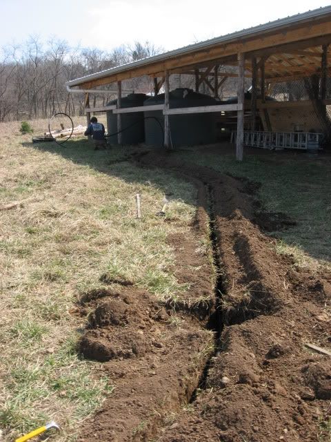

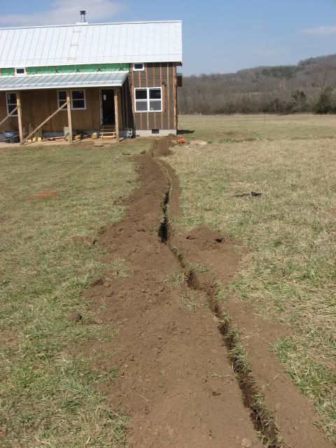

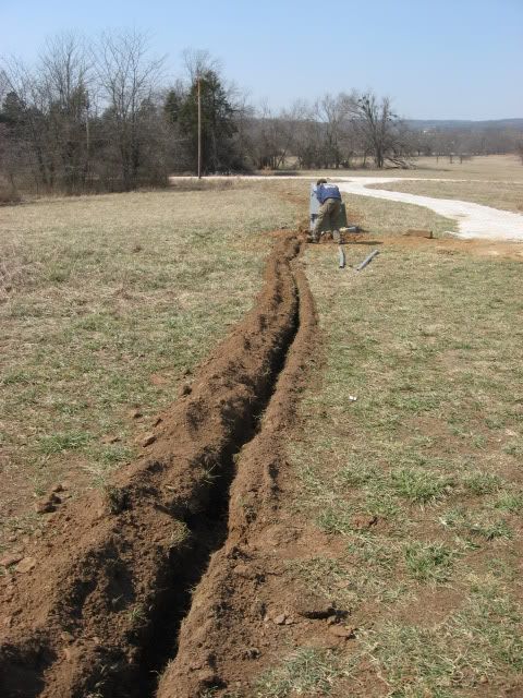

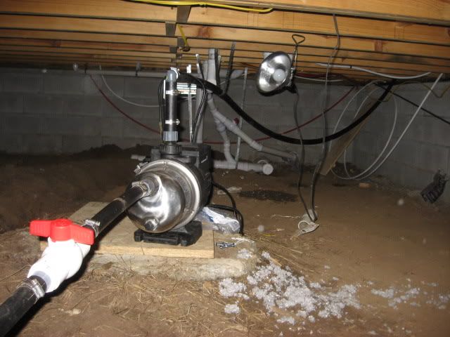

Fought with a small 18 inch trencher for the good part of a day!  Placed the water line and fed the electric line to the barn.  Unfortunately, the chain loosened after and hour or so and the rental place didn't tell me I needed a 7/16 allen wrench to tighten it (I had one size larger and smaller  d*)  As a result, the dig went very slowly as I had to stop and hit the chain when it bound against the track every time I hit the smallest pebble!  Luckily, the ground is not rocky but it's not rock free either!  My neighbor came home with about 40 ft to go and he had the proper wrench so at least I didn't have to fight it once I was thoroughly exhausted!  At least I only had to pay the minimum back at the shop  ;D
Finished crimping the pex and had no problems there.  I did have an issue with my water pump though.  I bought a grundfos mq3 because it's recommended for rainwater and used by many who collect it.  It's on demand, with a small internal pressure tank.  Very quiet yet sufficiently powerful for our needs.  My wife and I hooked it up and fixed a couple of leaks with the supply line where I'd only hand tightened the connectors.  We tested the pex manifold, lines and on demand water heater and everything performed well.  It was all going great until I decided to tighten the primer plug just a little more when it snapped, spewing water everywhere!  I quickly shut the pump down and the tests were over  :(  I've since contacted the company I bought it from and they will ship me a new plug this week.

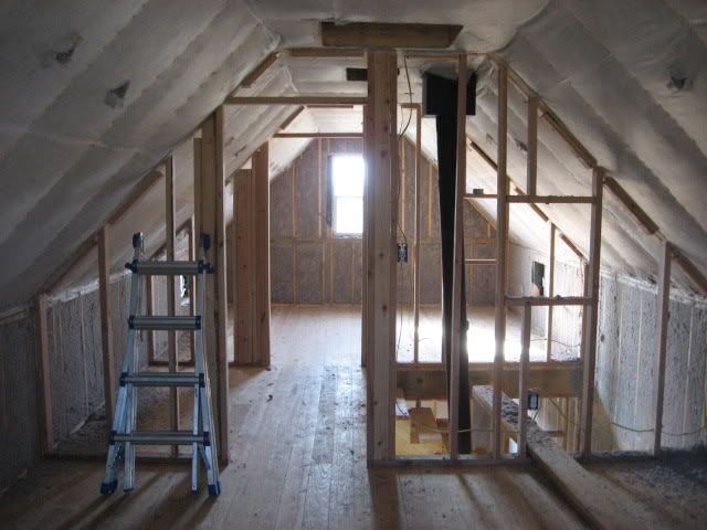

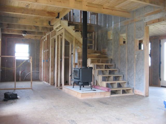

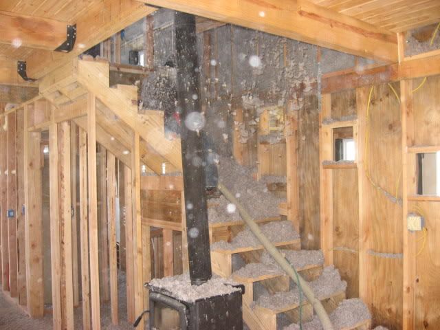

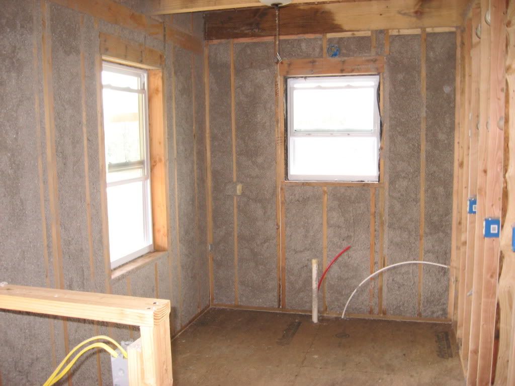

On a brighter note....we have insulation!  Wet blown cellulose in the walls and dry between the rafters.
It was tough to photograph while they were spraying because it shoots everywhere!
We'll give it a week to dry and the drywall crew will be back on monday to get started.  Then it's painting time..... at least we're making progress!

Now you are getting insulation when it has started to warm up.  ;)  But I am sure you will need it this fall.  Yes I used one of those trenchers at my parents for a waterline.  Unfortuneately it was on a steep down hill grade.  Spent more time trying to keep the machine upright than I did digging the trench.
How did the let-in on the shed roof work out for your drywall attachment?
Looking good jdhen
jdhen
Yeah, Red.  I admit the timing is not right on that one  ::)  Could have used it a while back but you know you can't insulate before electric and plumbing!
The let-in worked just as you said.  Used a knife to score it then pulled enough out with my fingers to wedge the 2x2 in place.  Thanks for the advice  :)
