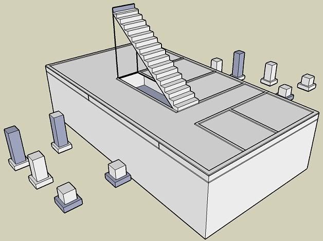

No siding today, I doodled over another liesure pot of coffee this morning. One thing to check early in design is that the stairs work.
You had said you wanted a 10' ceiling. I assumed that the 2nd floor would frame with 2x10 depth, this should yield a 130" overall rise. There was a 14' long hole drawn. First I divided the rise in increments of risers until I got an acceptable rise per step. With 17 risers the rise is about 7-5/8". That would mean there are 16 treads, so 168" overall run/16=10.5" tread. A tad steep but they work. Maximums are 7-3/4 rise x 10" run.

Wow! Nice work- thanks! I'll have to check the SC code- they follow IBC 2006. We wouldn't have to have all of the stairs within that opening- I don't mind if there's a bit of slanted ceiling under the stairs in the kitchen. So we could add another step or two. And I don't HAVE to have 10' ceilings, although I would like them to be at least 9'.
