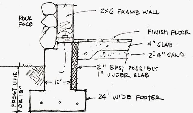

CREATIVE1  then I think I would make the footing wider to cover the thickness of the cobblestone.  At least the footing.  Depending on how deep your footing is under the finished grade you can either use cobblestone from the footing top or use solid 4" block to get to where you want the cobblestone to start.
These probably need to be laid like bricks being self supporting with a brick tie occassionally.
One of your questions is going to be where do you insulate your interior slab?
The best would be to do a an inverted "T" type footing wide enough to support your stonework and then float the interior slab inside a couple of inches of EPS insulation.
