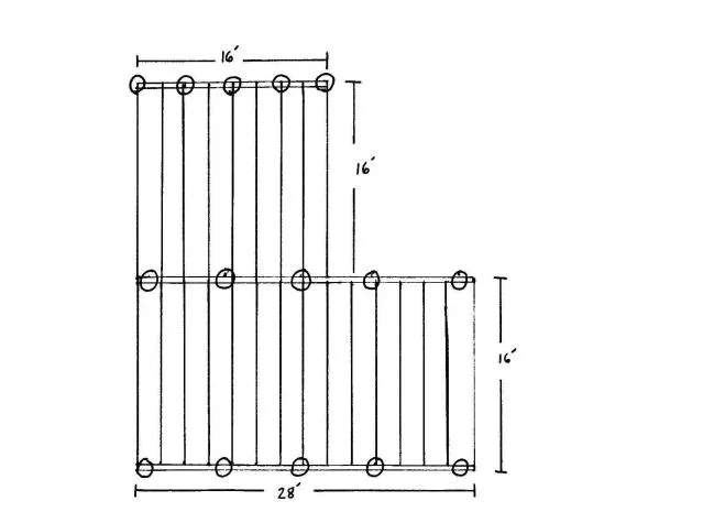

I'm building the 16x28 and would like to add either a 12x16 or 16x16 onto the side of it.  I'm not sure how I need to layout my piers, beams, and joists for this.  Can I share the beam of the 16x28 and either overlap the joist or use hangers on the rim joist for the addition?   Would I be pushing my piers and footings to the limit with the extra weight doing it this way?  My soil is a sandy clay (2000 psi as far as I can tell) I'm using 2'x2' footings with 12" steel reinforced concrete piers, and 6"x12" beams.
Would I be better off running another row of piers perpendicular to the ones for the 16x28?  Or would a layout like this work?

I would suggest treating the 16'x16' addition as an independent foundation. Turn the beams 90º and run the joists the other way. That will take the double loading off the shared beam and piers.
Then the beams are in the right position to support a gable roof if that is your choice.
Check costs, a strip footing with a 16' long block wall on it with a sill and no girder might be simpler  ???.

Never even thought of needing the beams in the right postition for the roof.  d*
Do I need to do anything special to tie the two 16 foot beams into the side of the 28' one?

For tying the beams together use a metal bracket or a wooden brace with screws both ways like is done at the corner of a table
