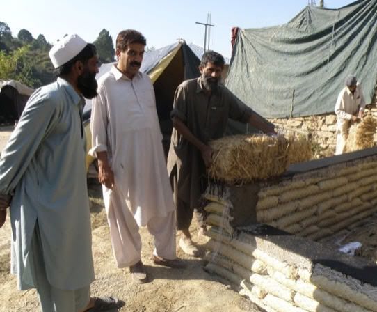

Here is the lead article in Science Daily: http://www.sciencedaily.com/releases/2009/04/090403104229.htm
Then go here to see the project (click the Gallery) and find construction photos of the inexpensive Pakistan houses that are being built: http://www.paksbab.org/
