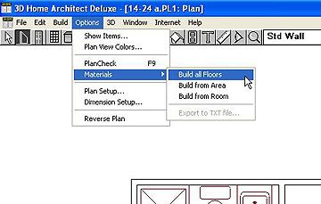

tesa, there are not materials lists because of the possibilities to modify the plans to your likiing.  John designs his plans that way.  Your materials list will be specific to your design.  You can do a take off from your own plan - use a spread sheet for each item and add them up.
Sorry I can't be of more help now.  I'm just a lowly volunteer and have to split to my real job. :)
Beavers

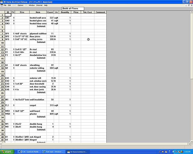

If you have the 3D Home Architect program it's easy to generate your own materials list.  It will give you all the materials including lumber, windows, doors, cabinets, even furniture and appliances.  I haven't figured out how to do roofs using 3D, so I haven't been able to generate a materials list for that yet.
It gives you a nice Excel spreadsheat that you can enter prices in, and use to calculate costs as well.
