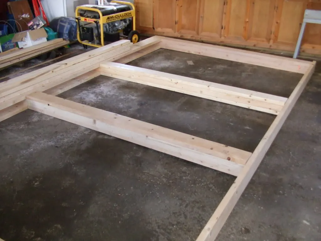

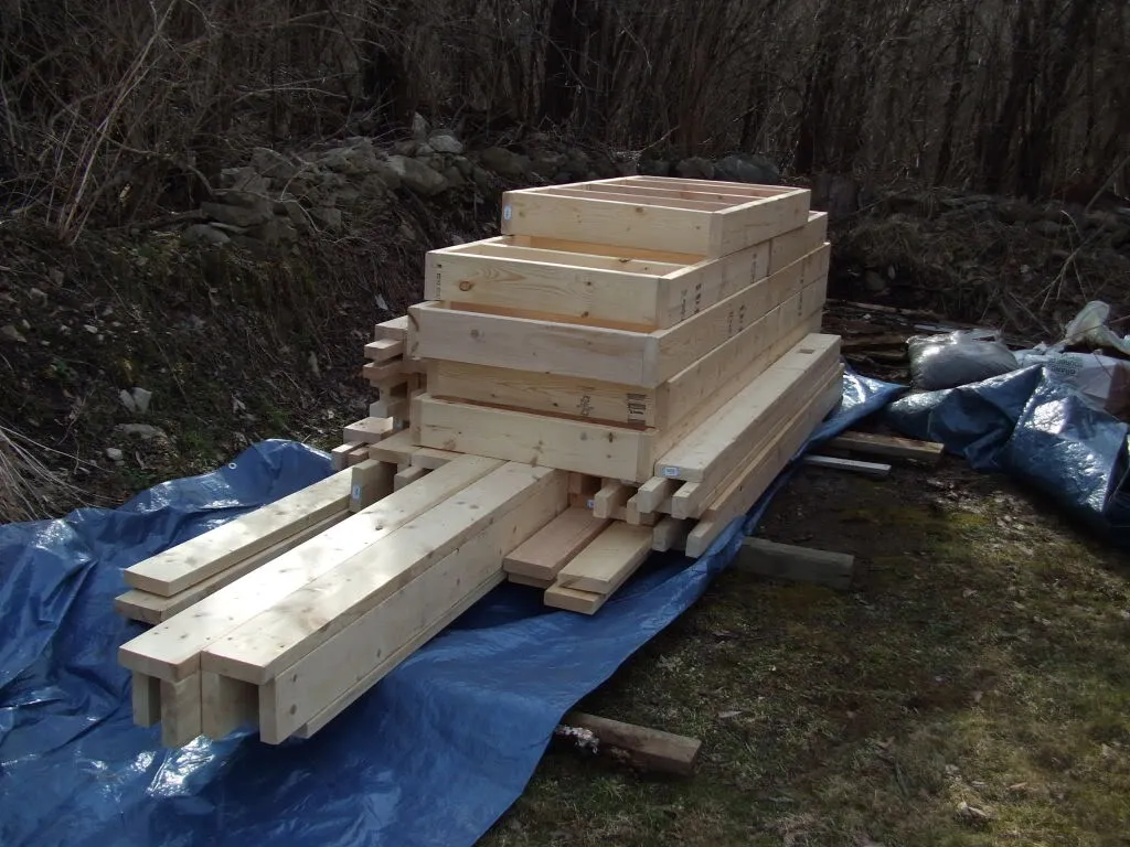

I am building this screen house at my land in the adirondacks this summer.  The back screened portion is 10 x 14 and the front porch is 4 x 14. As I am 5 hours away I need to pre build as much as possible.
I am building the post out of 2x 6 and the top "beam" out of 2x 6 as well.
This is all of the pre build for the post, beams and knee walls.

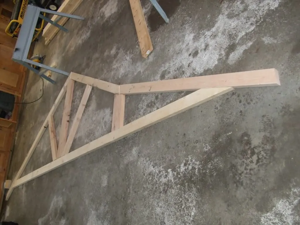

Next I will be working on the roof trusses.
devildog
thats areally good looking truss!  looks like a good plan. make sure to take alot  of pics. id like to see how it comes together.
Should be a nice place to sit and enjoy the outdoors without the bugs.  :)
I'm curious, how are the truss components going to be fastened together?

   I am planning on making gussets out of plywood.  I have purchased construction adhesive and plan to screw them in place.  I think I will first attach them with an air stapler and come back with screws.

I prefer the 3"x5" metal fasteners for gussets myself, they aren't very rustic but I think they hold and look better personally.
Otherwise, looks great. I built my own trusses for my 12x16 and did wood gussets initially but switched to metal for strength

Plywood gussets should be fine; CSX 3/8" can be used.  As for glue I would recommend something like polyurethane moisture activated glue like Gorilla Glue or a two part glue like Weldwood Resorcinol Glue over construction adhesive. For plywood truss gussets you want the plywood as flat against the truss wood as possible. You do not need or want a thick layer of glue. The thinner types as mentioned will squeeze out some as you nail the gussets on. The polyurethanes are messier to clean up; sticky just like foam insulation in a can is (close cousins). Hand nailing is preferred over a power stapler. An air nailer could be used, but each nail should be "finished" by a good blow with a framing hammer. This will squeeze the materials together better than an air tool can accomplish.
Galvanized 5D or 6D box nails spaced about 2" apart is what they used to use back in the 50's & 60's when they built on site trusses for ag buildings. On the flat side of a 2x4 there's be two rows.
If you'd like I could scan a picture or two from my old "Designs for Glued Trusses manual.
I also believe that plywood plates, installed properly, are better for this than any metal nail plates. The metal plates you see on factory produced trusses are rolled or pressed into the wood under evenly applied high pressure.
Don't use screws; they are never recommended for structural wood framing.

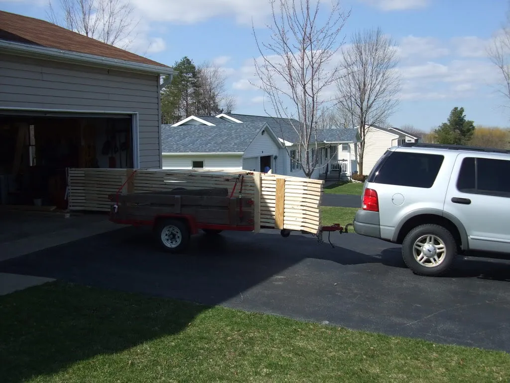

I finished my trusses but I think I need a new (larger) trailer.

new land owner nothing wrong with that .  Most of my loads look similar.  It works doesn't it.  Here you are allowed up to 4' overhang w/o a permit.  Anthing under needs to be flagged.
The Little Trailer that Could!....or was it Engine??? Anyway, the pic makes me smile.   ;D

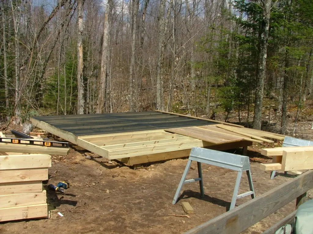

Spent all of this week on sight getting started.
I have the building up but not shingled.
Still trying to decide on the exterior wall treatments.
Also met with the building inspector and paid my $33.00 fee for the building permit.

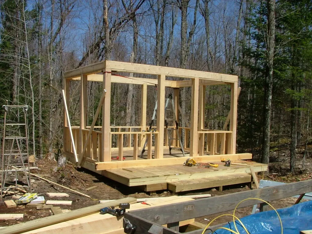

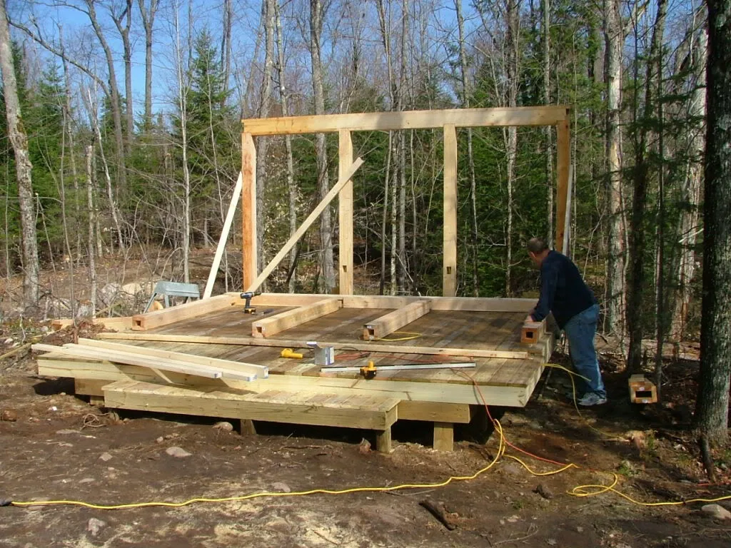

The deck with the back portion screened for bugs.
I built the posts out of 2x6 and assembled it on sight
Here is the back 10 x 14 screened portion.

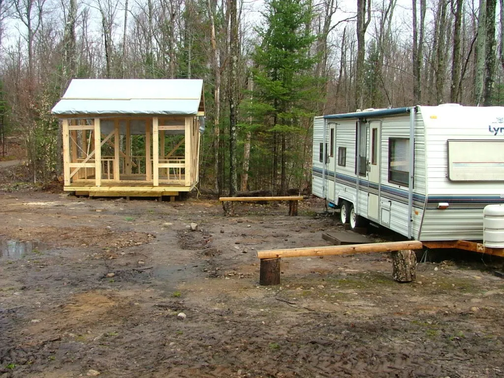

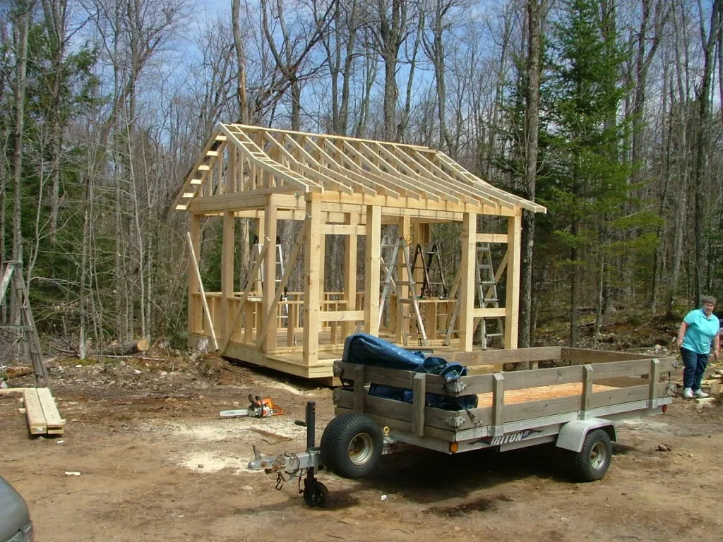

The building is up waiting for a roof
Ran out of time so I had to tarp it until the next trip

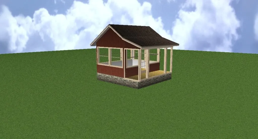

Looking just like the computer rendering....cool :)

I did not work off any plans pre say.  I used punch software to create the roof lines and to try other options.
The total building is 14' square with the back 10' x 14' to be screened and the front 4' x 14' to be a porch.
I have a 8 12 pitch on the higher portion and 4 12 on the portion over the porch.
For the deck of the screened portion I used 2 x 8's and for the front 4' of the porch I used 2 x 6's.
This will give the door something to close against.
I also pre wired the building and just insereted the wires into the posts as I stood the walls up.
This worked well and did not have fish any wires.
