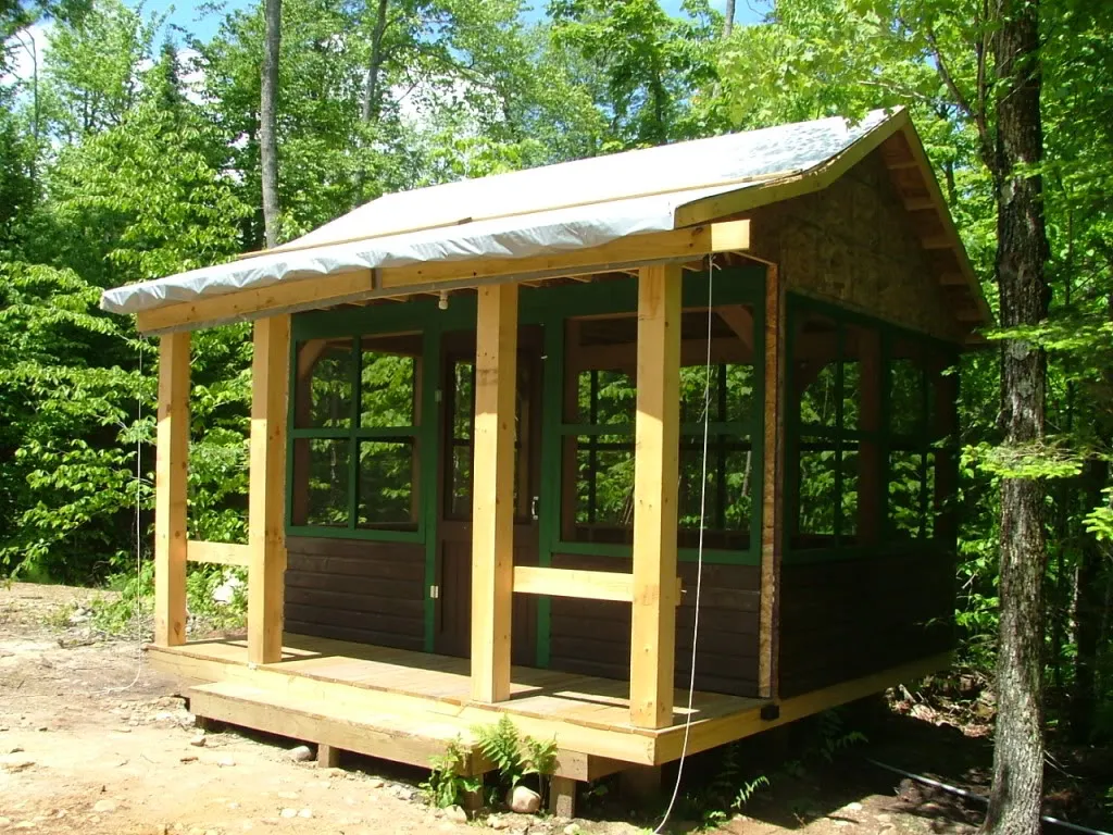

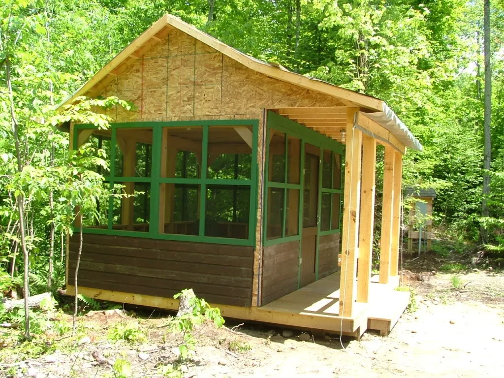

Taking a trip up to my land this weekend.  Won't have much time to work but should get some of the loose ends tied up.
I have been working on my screen frames.  I also started to buy the "Novelty siding" for under my screens.  I will cut to sze and stain the first coat before installing.

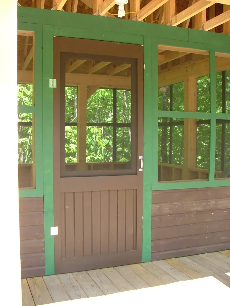

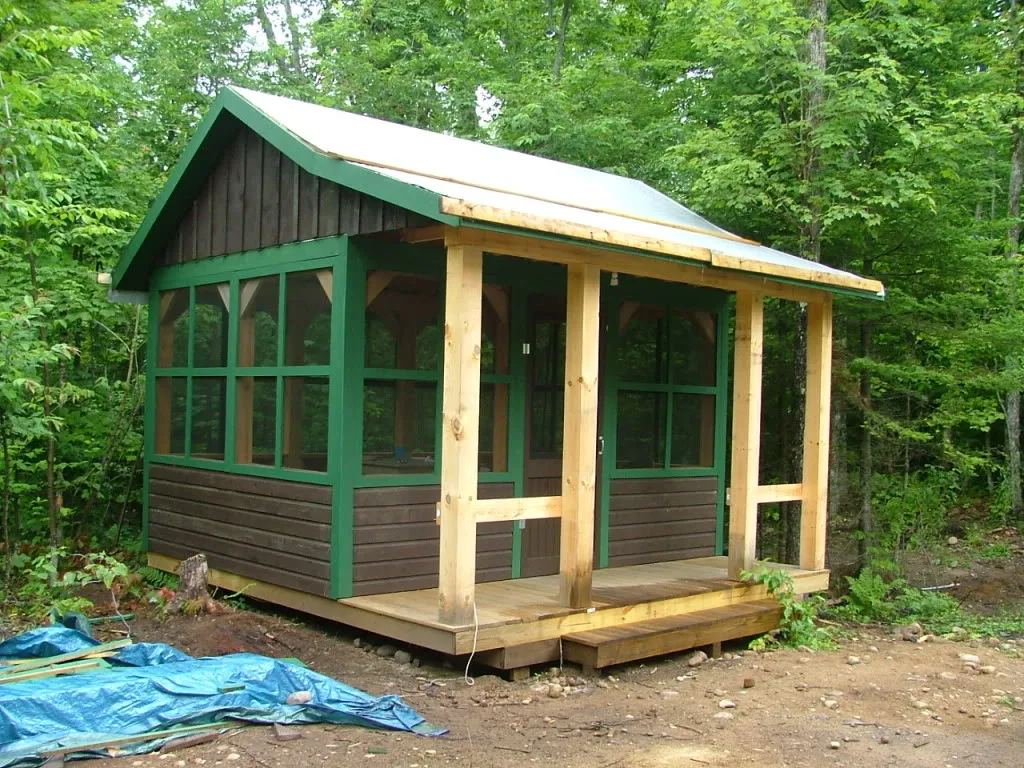

Went up to my land for a couple of days.
This is the door I made.  I bought 5/4 stock and it seemed to work out well.
Still have the gabel ends to finish and corner boards to make.
I think I will wait till it is cooler to shingle the roof.
Nice progress.  How are you going to finish the corners?
new land owner
Just basic corner boards.  I will carry the front ones over the sides to cover the end grain.
secordpd
Wonderful job, how did you make the posts, were they 2x4 or 2x6 mitered.  What a great idea, because most 4x4 posts warp or split, this way it's stable.  I actually used this method to make legs for a craftsmen style dining room table I made for my niece and her family

new land owner
Thanks for the positive comments.
I build each post out of three 2 x 6's.  I ripped one down so that when nailed together the post was 5 1/2" square.  It worked out well when I was running the electric.  I drilled hole in the deck and ran the power before erecting the walls.  I had previously cut out the posts for electrical boxes and then just pushed the wire up the post as I stood them up.
As for the trusses I used a 8 12 pitch on the back portion and a 4 12 pitch on the front.

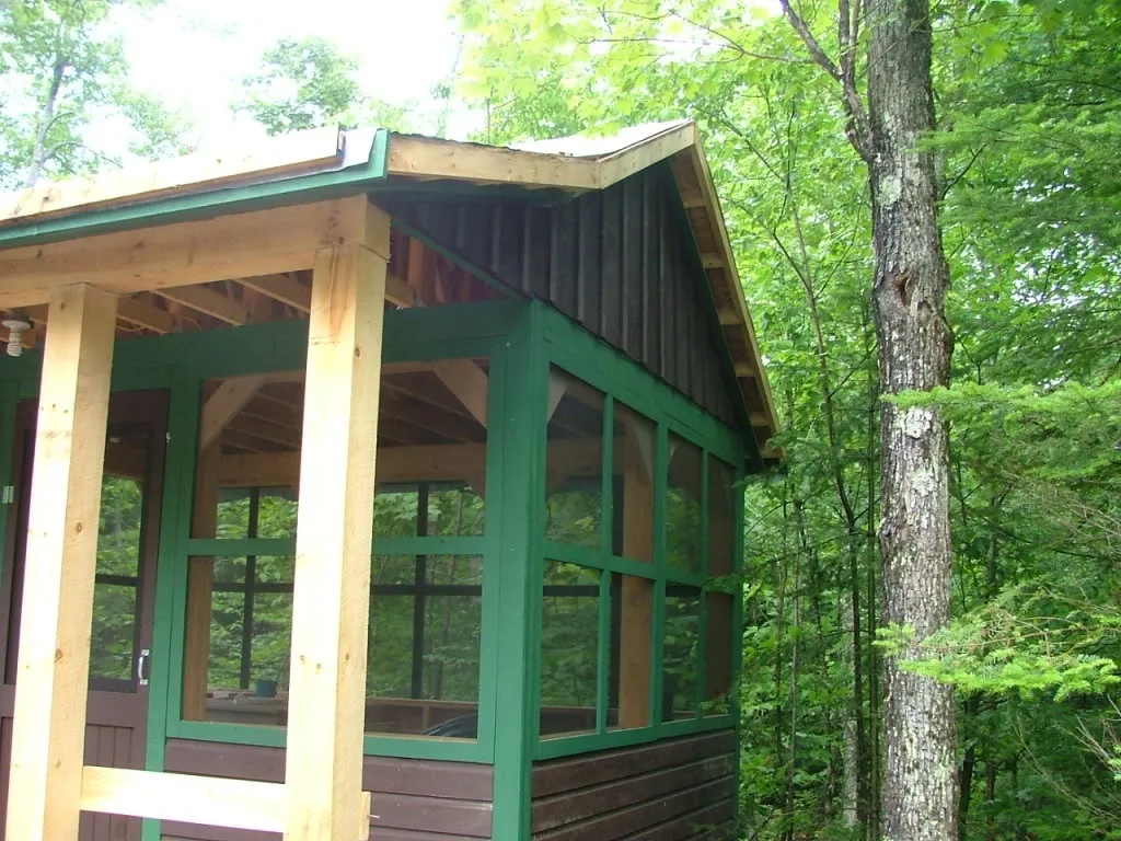

It is hard to believe how the project slows down when the main portion is complete

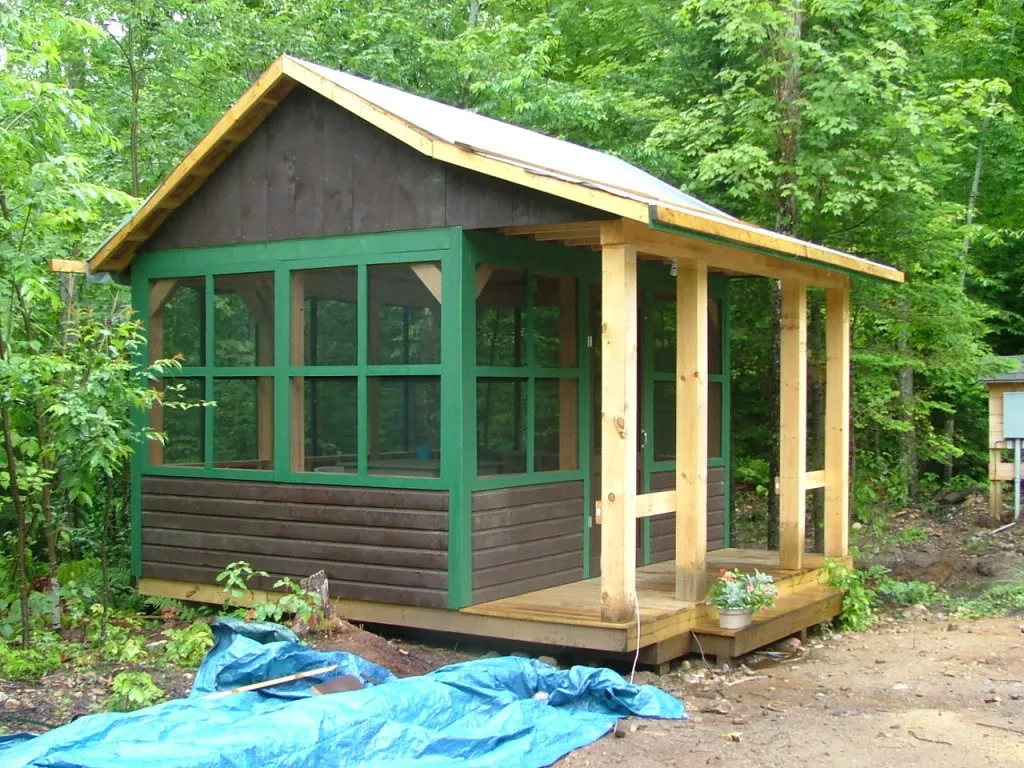

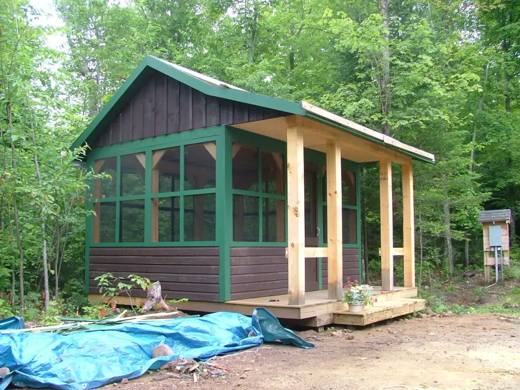

I was at the camp for a week and worked two complete days to go from this..
To this...  I installed the corner boards, some of the trim and added the rough sawn lumber on the eves that will later get battens.
I did take some time off to ride the four wheeler, take out the canoe and climb a mountain.
new land owner
Thanks don
       I am going up this weekend and hope to get all the trim up.
I have the trailer loaded with the trim stock aready stained and the baton boards cut and stained as well.
Plan completing the roof sometime soon.

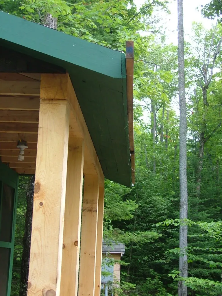

new land owner
I had a good weekend and got most of the facsia and soffit materials completed.  I have been staining everything on all four side before I put it up and ran out of materials so I hope to finish next weekend.

Went up for a three day weekend.

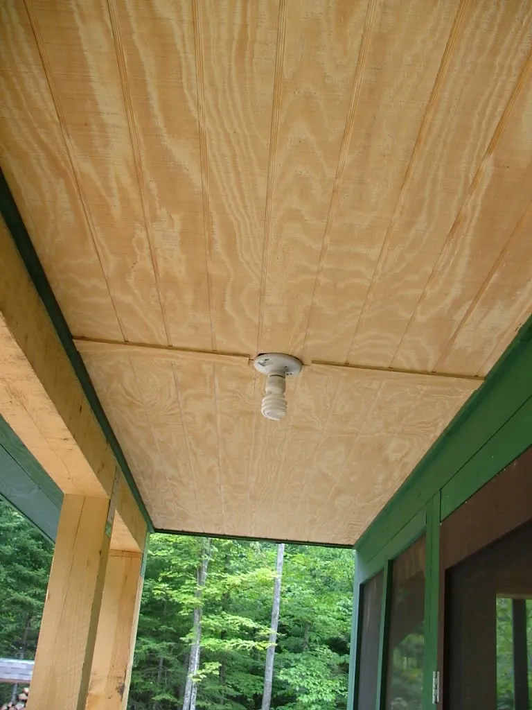

Put a ceiling on the front porch, found that birds were starting to use my screen house as their own.
I like this material it was on $17.00 a sheet at lowes.  I think I will do the entire inside ceiling with this material in the spring.
I also finished all the trim work and all that is left to do is to shingle the roof.

I used a similar product from Lowes to do the soffit area of my cabin.  It is rough and doesn't take protective finish very well.  I stained mine with a oil based stain.  Interior ceiling might collect dust.

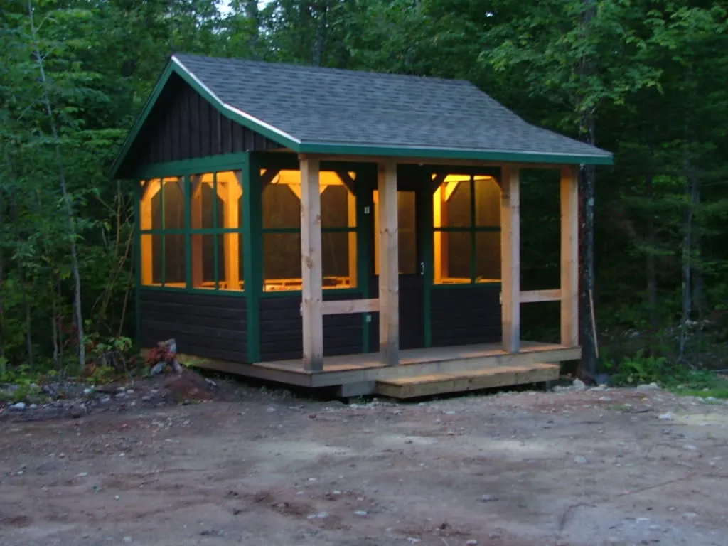

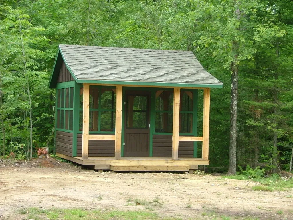

I went up this week and got my roof complete.  Everything went very well, I had no issue with the pitch change.  I did have an issues with the temperature.  One of the only days this year in the 90's up there.  I had to stop and finish the next day.
Can I say I am complete?  Once I put the last Shingle on the roof I was telling myself I am complete.  It seems that now I can think of many small projects still to do.  My brother inlaw is going to cut some steel Brackets for the top of the front posts.    We are going to paint them flat black and use some square ended lag bolts.  I also still have not decided what type of railing I want to do on the porch
Here is the "Final" product.
I took this picture at night I thought the lights made for a cool looking picture.
