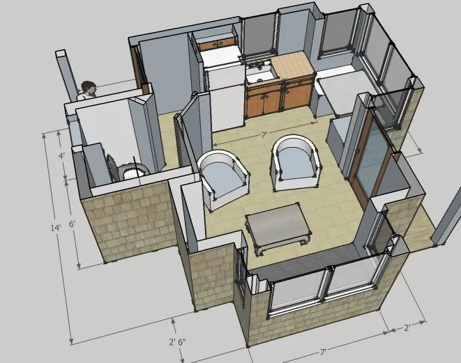

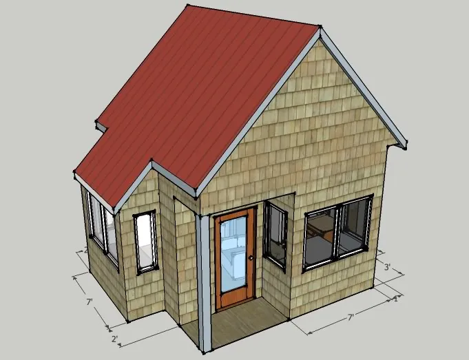

I have been playing with Sketch 7 this week, here are a few images that illustrate how small these houses are (they easily fit inside a 2 car garage). Thanks Bart.

w* to the forum.  Yup - they are small.  Nice renderings.
Nice Job bparr!
Great study model.
I don't know if Bart Cubbins, the 2nd place contest winner is still visiting this site but he would love to see your work.

bpaar, that's a very good looking plan.
Especially the entrance/bathroom part is very well done.

The plan is very clever. Bart Cubbins is the designer (this is his version 1a). I may have reversed the location of the vanity/wc , but otherwise followed his plan to practice using sketch.

Any chance the sketch 7 data file could be made available? I've become obsessed with this floor plan ever since
I first saw it here.

One page 17 of this thread Bill Parr had posted images of the SketchUp model of Barts Cottage he was working with.
Today, Bill has shared the SketchUp file and it can be downloaded here: http://www.countryplans.com/Downloads/Barts.zip
This is a large zip file and should be saved to your own computer. The upzipped (extracted) file can be opened and viewed by SketchUp ver. 7
Here is a link to the free SketchUp program: http://sketchup.google.com/intl/en/gsu7/download.html
Thanks to Bill  :D :D :D
