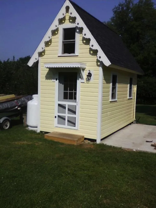

I have posted the details of this build  at  http://countryplans.com/smf/index.php?topic=13525.0   on this site.

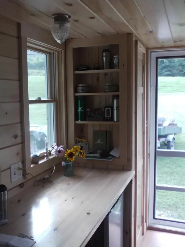

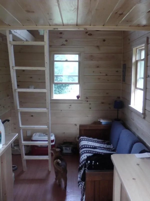

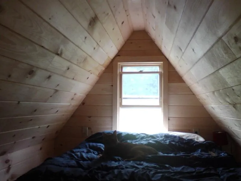

It was a lot of fun to build this little house during the summer of  2014.   Its intended use was a place to call home base and maybe stay a night or two a week  at my in-law's  orchard where my wife works, but it turned out to be much more permanent than that.   We have actually been there almost full time since July of 2014 with the exception of the month of December.    The dimensions are  8 by 16  with a loft that is  a little more than half of the total footprint.     It does not have a bathroom because we are able to use the  orchard bathroom which is close by.    We do have a portipotti  for middle of the night needs!    There is a 14k vented gas heater installed which turns out to be way more than necessary - very toasty in the loft!
Since the photos, I have installed a sink with a pump faucet that is connected to a 5 gallon water jug.    Don't hesitate to ask any questions!   jt
A handsome project and a very workable small house. Congrats!
Jason the cabin turned out great.  Have you ever figured out a ball park figure of the cost?
pocono_couple
thanks guys..   we spent around 10k altogether..     I was trying to keep a detailed account.. but  i tend to lose interest in things like that. get back from the  lumberyard and stuff the receipt in my pocket as I quickly get back to work  :)      and then I say,,  "next time I will be a little more organized..  "    maybe that will happen next time!  :)   jt

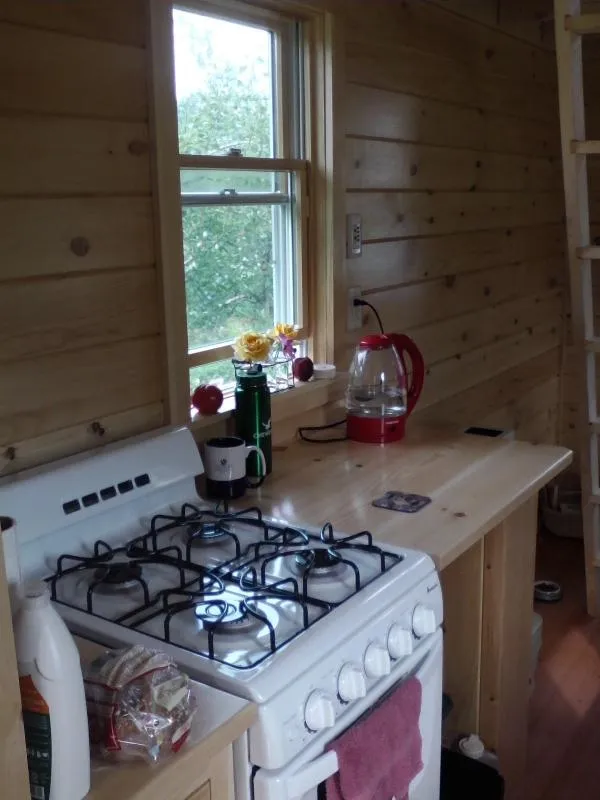

paul s
exactly how big is the gas stove for cooking, even the model and mfg would help me, great job
