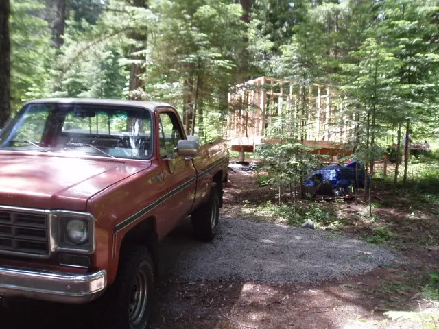

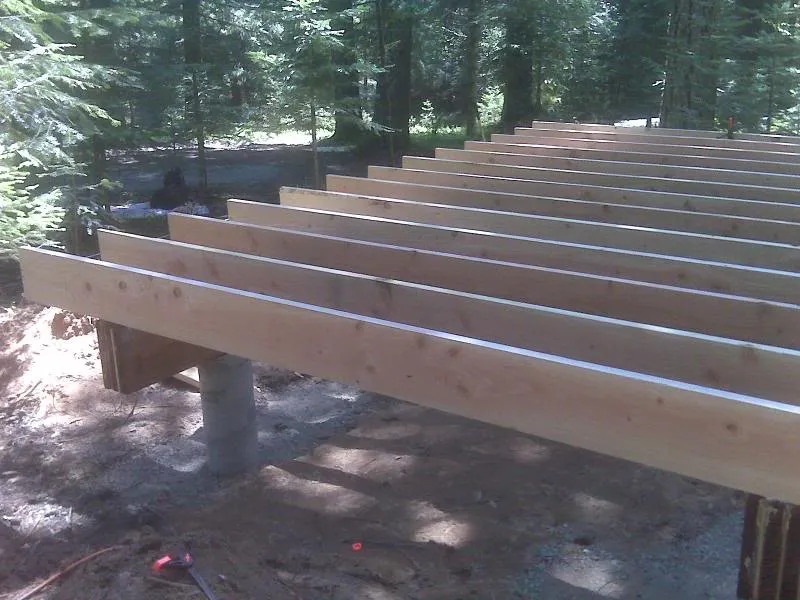

Got the well replumbed with new pipe, fittings, pump, and exterior piping to two freeze proof spigots.  Trenched 150', and used PEX for the runout.  Used a 1HP Harbor Freight pump for now, and have good pressure.  Since the county told me that there is a "lost power line" in this vicinity, and they were not able to locate it, I decided to hand dig the trench 3'.  Glad that part is over!

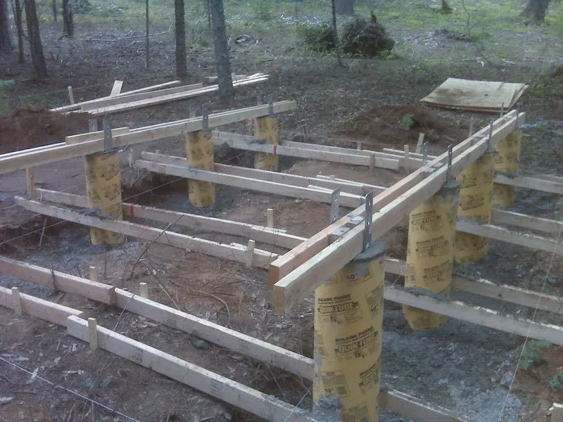

Poured 56 bags of 80# Quickrete 5000 into 10" tubes with BF24 footers for the foundation.  Dirty work, but glad I'll never worry about whether its enough.  I know my bracing wasnt perfect, but it worked.  Used the Simpson mounts CF66(?) as PEG and Don advised, and let it cure for a week.  A BIG thank you from everyone thus far for all the sage advice.  Used a great deal of your input, and for a novice Ive got some results.  Also found that my local lumber yard does carry Advantex (but nobody here in the NW is listed with them).  Used Simpson strong ties everywhere I could, etc...
BTW: Is there a general rule in regards to cross bracing these floors?  Every other joist @ 45 degrees or something of the sort?

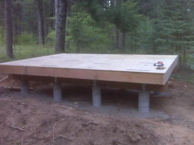

The last two days I got busy and got thus far:
Jerry rigged bracing for concrete:
Joists (2x10 @ 16" o/c):
Subflooring done!
Thumb, meet hammer...hammer, meet thumb...

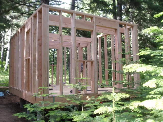

Will be "prebuilding" the two gable walls on the deck before vacation time to get a head start on things.  Curious whether its a good idea to add hurricane ties (ie: H 2.5's) for the 2x6 studs?  Planning to use 2x8's @ 16' o/c  for the ceiling joists (for a double loft) and rafters since I want it stout for snow country.

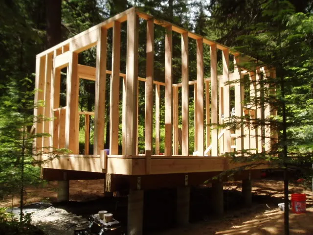

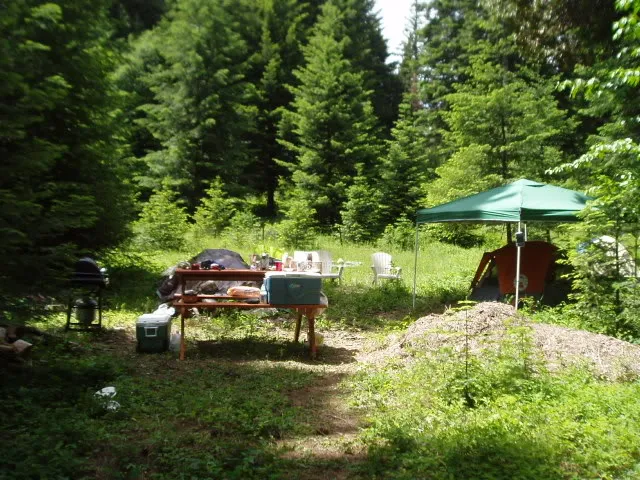

Had a few days off after a week in DC, and got to swinging...decided to go with the Huber Zip System siding and roofing rather than the standard sheets/tar paper (nothing wrong with it though I was physically limited as is!).
Camping spot w/ BBQ:

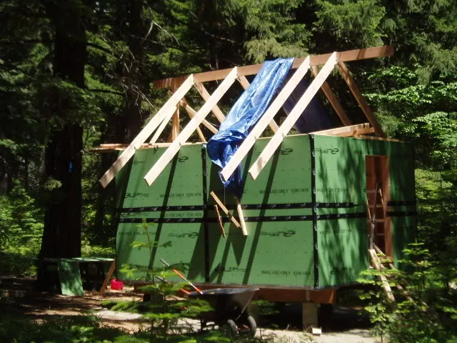

2x6 framing (was a heavy lift):
More framing:

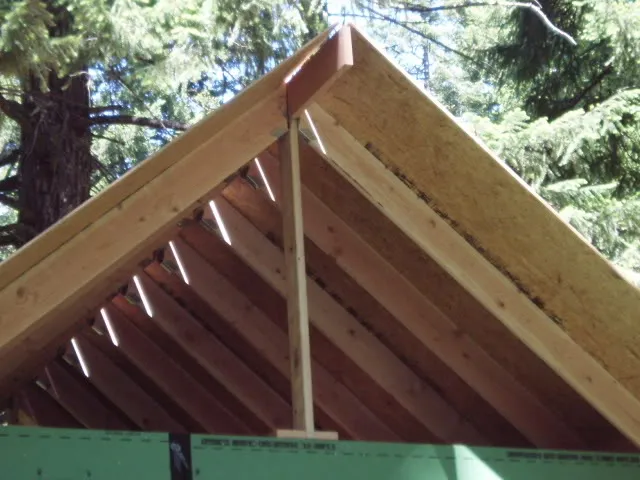

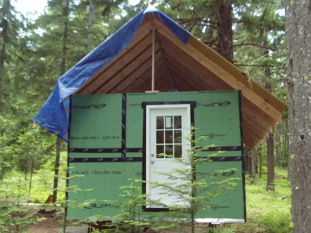

Sheeting up, and scratching my head on the rafters (2x8x12's).  Had two books that made little sense.  Finally told myself that this wasnt rocket science and sharpened my pencil to figure it out...unfortunately I think I overlooked one issue...the gable overhangs.  Should I just cut out slots for 2x6 crossmembers with my recip saw and knock them in?  Or, is there a better/easier way?
Anyone got some ideas as to how I should add the support members for the outside rafters (24" overhang)?
As it sits today:
BTW: I'm new to all of this so go easy on me for the oversight.  I've learned that a 10:12 roof makes for heavy work with 4x8' sheeting, and one can never have enough nails or Zip tape.  Most of what I've applied I learned by browsing this site and my doodle pad.  If I'm missing anything please let me know.  Next on my list is finishing the roof sheeting, gables, metal roofing, and hardipanel siding.

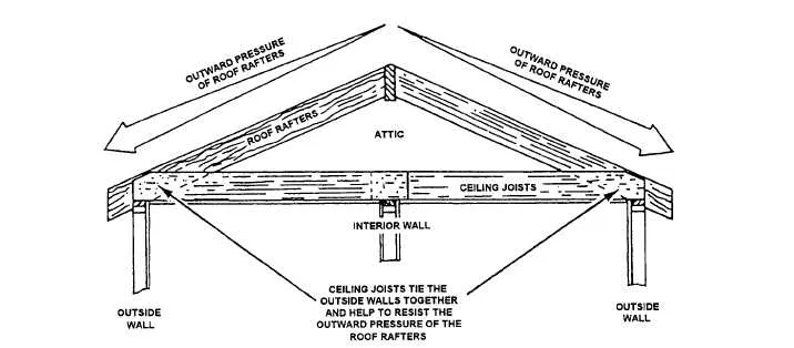

I assume they are there but do you have ceiling joists to keep the walls from spreading?  They don't seem to show in the picture.
I assume you could brace the overhangs with soffit framing.  (Note that I am a structural steel guy that knows enough about framing only to be dangerous).
http://www.tpub.com/content/construction/14044/css/14044_47.htm     check this out.

The right side shoe on most skillsaws is 1-1/2" from edge of saw to edge of shoe. This would give you a 1-5/8" plunge cut for notching for the lookouts then a sawzall for the vertical parts of the notch. That would give a better cut. Then rip some shim to take up the difference and put it under the lookout.
The ridge should be wide enough to extend to the bottom of the rafter plumb cuts and then the hardware is unneccessary. Not trying to pick it apart just save folks looking on some bucks and possible inspector trouble.

The tpub link above was not very readable on my computer for some reason.

Thanks for all the great stuff guys.  I did add ceiling joists (pbucket wont load right now, but there are 7 joists w/ 2x8's).
Poor photo:
Does anyone have an example of the soffit framing?  I'm assuming this is different from the lookout design?  Sounds like I need to plan on notching out my rafters this weekend and wrapping up the gables.

I generally go 2' centers when doing gable overhangs that way. In heavy snow country they should really be up on edge atop an angled gable rake wall, there's ~640lbs bearing on each flatways 2x6 at design load. If you ever see that much snow don't be too suprised if it doesn't make it. A couple of brackets under there would help if you are concerned, look around at Arts and Crafts period homes as you drive around for ideas.
For a level soffit, which would be the best structural thing here apply the subfascia, stringline it and adjust it straight. Run a level from the subfascia back to the building wall at each end and snap a line down the wall. That is the bottom of a 2x4 ledger nailed at each stud. Lookouts are nailed alongside each rafter tail back to the ledger. I usually box the ends of the level soffit at the building line, some folks carry that "pork chop" out to the end of the overhang at the gables, looks too heavy to me on steep pitches with large overhangs though. Apply finish fascia and soffit. If that didn't make sense I can probably find an old photo.
It looks like the ceiling/floor joists are tied to the wall studs and not the rafters, that is a weaker connection there, maybe a few long oly screws down thru the plates into the cj's. Also the joists need to bear on a ledger or something so the floor weight is not just hanging on nails.

Interesting.  Do you have any examples of how this would be constructed?  Is it similiar to pg 43 (figure 53):http://www.awc.org/pdf/WCD1-300.pdf?
Made sense enough to me...
I did use Simpson hangers for the joists, and added solid bridging.  Would lag screws be appropriate for adding strength to the ceiling joists?
Yes, Fig 53 is what I was describing as the best way to frame the overhang.
