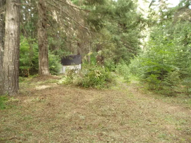

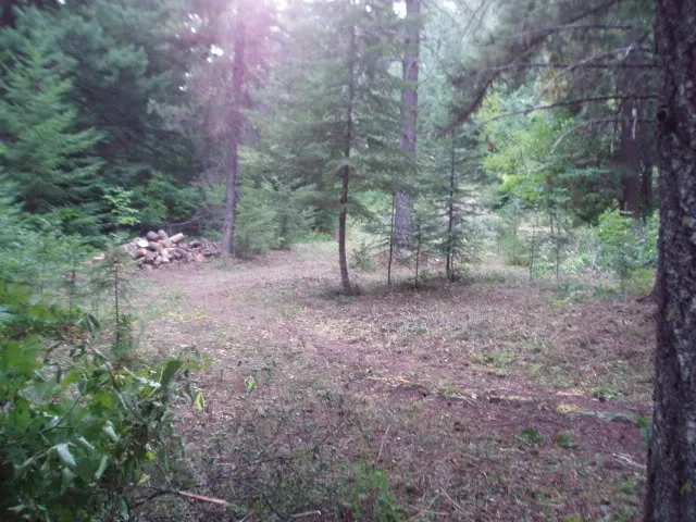

My wife and I are about to begin an adventure by building a sub 200 sq ft "cabin" (12'x16') on our 2 acre lot up on Mt Hood (~3,000 ft elevation).  It's been in my name longer than I've been alive, but even though I'm "grand father'd" we don't want to face all the permitting requirements, as we would like to build a larger residence later sometime, and while I've worked as a mechanic and welder, I have little experience in homebuilding besides some projects.   Had plans to start last Summer, but the place needed to be cleaned up which took a good deal of time (okay...A LOT of time).  Finally graduating after 12 years of University, and sprinting into the career marathon had some leverage on my spare time as well... Already have most the tools including saws, ladders, welders, generator, air compressors, common sense, etc.
Anyhow, we plan to use our "Big Enchilada" kit, and the 12'x18' plans.  I swung by the county planning department to inquire about building a sub 200 sq ft "utility" building.  Already figure'd out where to place the building, but still have about 2' of snow on the ground.  Will be shooting for something like Bishopknight did with his cabin: http://countryplans.com/smf/index.php?topic=4569.0.

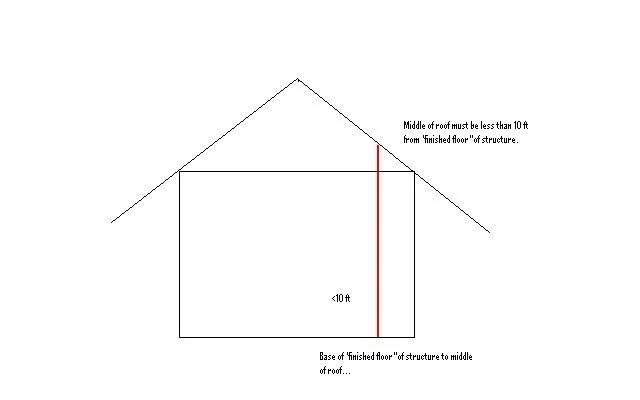

Also have to figure out how to meet the State of Oregon requirement that the middle/midline of the roof (between the crown and eaves) must be 10' from the bottom of the "finished floor"/bottom of structure.  All three (3) planners had different definitions on this one, but I want to make certain that I'm staying kosher.  Plan to use metal roofing, and figure that this will allow me to adjust angles/extend eves if necessary.

Let us know what you find out about that rule - it doesn't seem easy to understand - does that mean a low pitch roof - in a high snow load area?

Yeah, all I could understand was that regardless of <200 sq ft, the mid line of the roof (from crown to eaves) could not be more than 10 ft from the finished floor.  Nowhere in any of the county handouts (nor OAR's) could I find anything regarding this, but got numerous answers from the planning department from "finished floor", "ground", and "bottom of structure not including pillars".
Thumb, meet hammer...hammer, meet thumb...
That's a hard one to understand.   ???
Are they really meaning that the 10 foot distance is a maximum distance from the floor to the roof, and not a minimum distance, or even an exact measurement. I could maybe understand if it was a minimum distance, and that would be easy to meet.
If it's a maximum that seems nuts; it would totally make it impossible to make a 10 ft high interior ceiling height for example. Plus it seems screwy in light of the need to build to 150 lb snow figures.  Steep would be a good roof for those conditions.
Best of luck on sorting that out and I'm really interested in knowing the answer.

As the county planner described it on a napkin (I'm not joking):
What's funny, is that NONE of the public material mentions the 10' rule, and I searched the Oregon Code to no avail...I'm going to have to reconfim this with upper management who might be able to describe it on tissue paper for a more formal description.

With it being stated that it's a minimum of 10 feet, that should be workable without too much bother.
DirtyLittleSecret
Okay.  Got clarification from 5 county planners today as I was driving back from Olympia.
The 10 foot "rule" states that the maximum distance from the "finished floor" (where one stands) and the "median height" of the roof...
So my concerns are a little alleviated, but will probably be forced to use 7' walls and low eaves to meet this requirement.

#18
Quote from: DirtyLittleSecret on February 23, 2009, 11:45:12 PM
Any other ideas would be much appreciated.
That's a stupid rule!
There I feel better.  ;)  I really do have trouble understanding why it's a maximum distance? ???
Seven foot ceiling height is going to feel cramped, IMO. BTW, that is the bare minimum code height for finished floor to lowest projection from the ceiling. Sort of precludes the use of any ceiling fans and limits ceiling light fixtures too.
That 10 foot distance would also mean nobody could build a room with a ten foot ceiling height and that is a commonplace feature in many upper scale homes I've seen.  ???
You have all my sympathies in dealing with that rule.  :(
