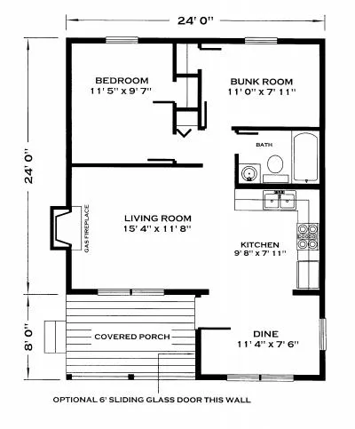

alcowboy
Here are images of both the floorplan and the completed project. I hope this helps you guys better than my messed up descriptions.

Now that I see the proposed plan things are a little clearer. When you stated a 24 x 32 building I automatically assumed the beams would run in the long direction. Assumptions nearly always lead to misunderstandings.  d* The illustrated plan is actually a 24 x 24 building with a room bumped out under a shed roof. Then the porch is placed in the inside corner formed by that. That's how I see that. Others may differ.
When thinking about this also remember that the exterior porch floor should be 1 to 2 inches below the finished floor level inside.
Viewing that floor plan on the screen, I now visualize it as three parts; the 24 x 24 main cabin, the 8 x 12 room and the porch.
The main cabin beams would run sideways across the screen, in the same direction of the roof peak. There would be a central beam between them. The roof loads would then transfer down to the two 'outside' beams.
The dining room would be built as an addition. That would require an additional beam placed under the 'bottom' wall as drawn on the plan. (12 ft wall with twin windows).
Lastly the porch would be added using PT wood from the porch deck down.
The above is not as easy as building a square or rectangle and adding a porch on one side or end. At least it's not so easy without detailed plans. Not impossible; simply more difficult. At least that is how I see it. If anyone has a better method please add your thoughts.

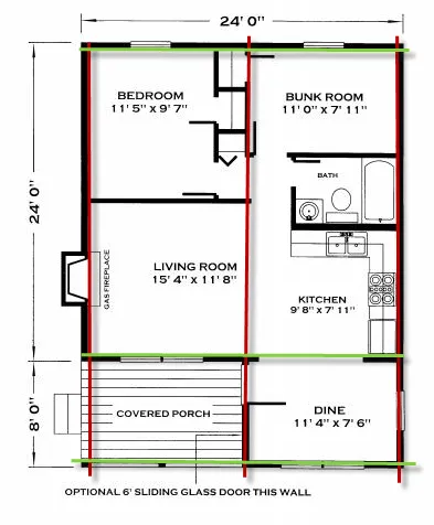

Yes Don:
A agree with your analysis.
In the above diagram the red lines are girders carrying the floor and wall loads. The green lines are where the roof loads will land (assuming a truss roof for the main building and stick framed at the porch and dining areas).
This can show us where the load bearing walls will be and where headers will be a concern.
