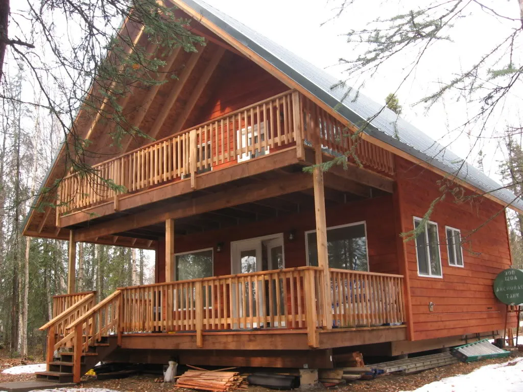

I am now finishing the interior of a 24x24 with loft and 12/12 pitch roof. You can see the whole thread under  "1 1/2 story nearing completion in Alaska"  in this forum. https://countryplans.com/smf/index.php?topic=5513.0 I have attached one exterior picture----two-decker porch would be nice for a lake view site.
View? I always thought the second story balcony was so you could get in and out when the snow got to be 10-12 ft deep.
;D
rwanders
That too!-------that's why I didn't build any outside stairs to the balcony----we just jump into the snow.
