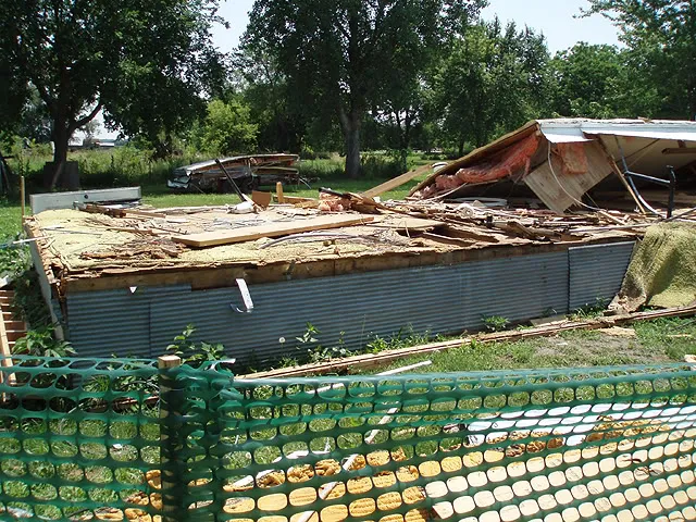

My wifes parents had some land that was home to a 1970 something mobile home that they used to rent out.  So we have land, septic, water, and power all ready to go...just have to get rid of the mobile home.  It had been sitting empty for about 10 yrs. since the last renters trashed it and moved out.  Since then it has made a nice home for racoons, cats, and who knows what else.  I tried every place I could think of trying to find someone to haul the trailer away, nobody wants them, the fire department didn't even want to burn it down for practice. So, we had to tear it down piece by piece.
June 2008 The start of the demolition.
Fast forward a month or two...

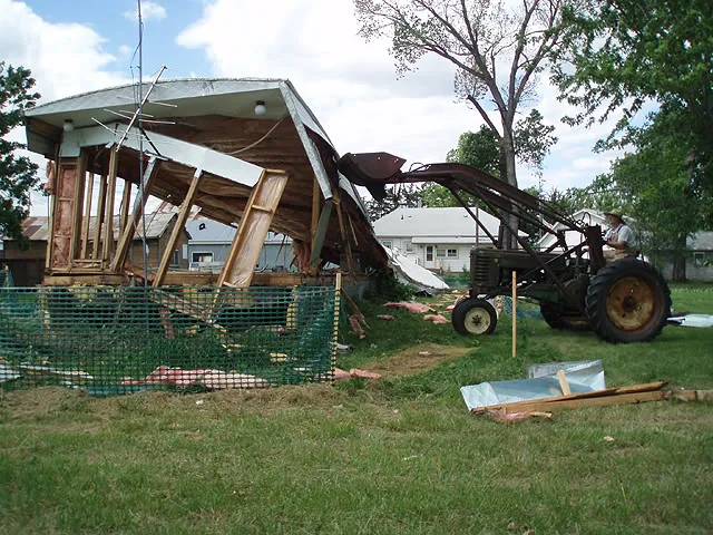

I couldn't believe how strong this trailer was, I knocked out most of the studs and the thing still didn't want to fall down!
My father in law finishing it off with the "Old B"
After we got the roof down, I cut it into sections and loaded it onto a trailer to haul to the dump.  All the aluminum siding went to the recyclers, anything that would burn got burned and the rest went into a 20 yrd. dumpster.  I was actually able to salvage quite a few 2x4's and 2x6's out the mess, along with the trailer frame.
I'm so glad to be done with this part of the project!  It was the filthiest nastiest job I have ever done, a moldy racoon crap filled mobile home is not the funnest thing to tear apart.  :o

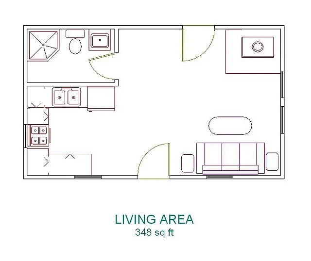

Here is the floor plan for the first phase of construction, the 14x24 builders cottage.  I'm hoping that we can be moved in by this time next year, not paying rent will free up a bunch of money for the next phases of building.
Planning on 12' walls to add a little ceiling height to the 14x16 loft.

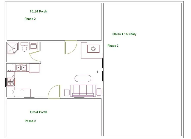

The second phase is going to be 10x24 porches front and back with shed roofs.  I can't figure out how to get the roof right on 3d Home Architect, so no drawings of the roofs.
Third phase is going to be either a 20x34 or maybe a 14x34, we aren't sure at this time.

I have a question about the roof. How much snow do you get? Will it build up where the shed roof ties in. My neighbor in the mountains has a single shed roof added along one side of his 16x24 cabin. Last time I was there there was a couple feet sitting there, whereas the other side (no shed addition) had slid clear.
And another thought/question... the space beside the corner shower seems wasted. I'm wondering if there's some way to slip the toilet or sink (free standing pedestal sink?) in beside the shower. That would shorten the bathroom or give space along the wall (behind the door) for a linen closet.  ???
And for myself there's maybe not enough window space.
Where / how is the loft access?

We don't get a ton of snow here, maybe 30" a year.  I never thought of the snow build up on the shed roof.  I'll have to look around town and see if anyone with a shed roof has much snow build up.
The floor plan I have posted is kind of a work in progress, I'm guessing I'll end up changing some of the datails as I go.  I was thinking the spot next to the shower would work well for the water heater.  I'm thinking a 20 gal. electric in a cabinet with storage above it.
As far as windows, front and back door would have windows, also a window in the one gable end, and two small dormers on the front of the house.  Seems like enough to me...windows are freaking exspensive you know.  ;)  ;D
Loft access would be located on the back wall just outside the bathroom.  Most likely the ladder design that John has plans posted for on this site.

As for windows, like I stated, it's a personal thing. I like to have enough windows in all rooms, including bathrooms, so during the day it's usually unnecessary to turn on a light to accomplish any task the area is designed for. Even more so with the increased use of CFL lamps. The life of a CFL is shortened with frequent cycling.

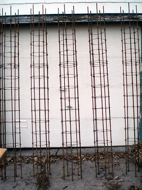

I'm still waiting for the ground to thaw enough to start digging for my piers.  In the mean time I've been working on building forms and tying rebar, for the footings and piers.
I ended up splicing two four foot sections of sonotube to get my 8' lengths.
Got a great deal on the rebar, and picked up the PT 2x12's for my beams.

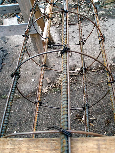

I spent all weekend tying the rebar cages for the piers.

Good looking cages - I have made a few on various projects.
Beavers
#15
Quote from: glenn kangiser on March 08, 2009, 11:26:18 PM
Thanks Glenn
I went thru almost 900 feet of tie wire...my fingers are a little sore now.  :-[

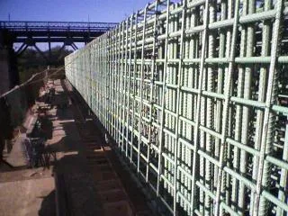

I was watching the iron workers the other day at work, man are they fast!  Would of taken one of those guys less than an hour to do what took me all weekend. d*
Looks just like the pros did it.  Excellent!

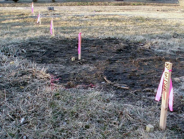

It's finally warm here, and the ground had thawed!

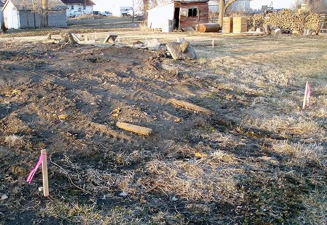

Wife and I did a little surveying yesterday and got all the piers staked out.  I went with 25' offsets, so I have plenty of room to work with the excavator.  After I get done with the digging, I'll set the batter boards.
Also got the mini-excavator rented for this weekend.  Finally get to start digging!
Just gotta find some gold plated shovels for a proper ground breaking ceremony.  ;)

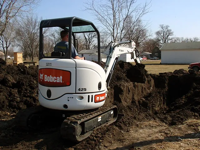

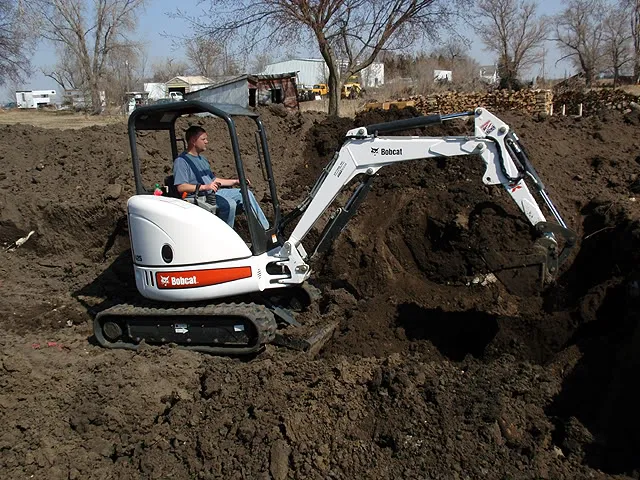

I got my footings and waterline trench dug this weekend!
While going over my numbers one final time, and figuring how much I had to cut, I realized I made my first screw up on this house.  d*
All this time I've been planning on 8' tall piers sitting on top of 10" tall footings.  I've been planning on putting the footings 48" deep, making my house 4'9" above grade.  Somehow I forgot that on top of the piers will be a 11 1/2" tall beam, and on top of that will be 11 1/2 tall floor joists... that would put my floor at 6'9" above grade!  :o  d*
I already have my forms built and rebar tied, so I decided just to dig deep and sink the footings to 6' below grade, putting my floor back to 4'9" above grade.  This will still leave my floor at almost 4' above base flood elevation.
Friday on the way home from work, I stopped and picked up the excavator.  The place is closed on Saturday and Sunday, the guy told me just make sure to have it back by the time they open on Monday morning.  So I got the excavator for the whole weekend for only $250, plus it olny had 6 hours on the hour meter when I picked it up...nothing like brand new equipment!  [cool]
I got the trench for the water line dug Friday night and got started on the footings.
I didn't like the idea of working in a 6' deep narrow trench so I decided to step the trench out some.  I wanted to be sure to have plenty of room to work on the footings.
I dug out the stepped section first to about 3' deep, and then moved down into the hole to dig the final 3' deep narrow trench for the footings.
I dug ramps to be able to get in and out of the hole.  I had trouble getting back out though, and was kind of worried trying to think of how the hell I would be able to pull this thing out if I got stuck!  I ended up using the arm to push myself back up out of the hole.  :o
I was really amazed at the volume of dirt I created with this hole.  I wasn't really expecting this big of dirt piles, going to have to see if the neighbor will rent me his bobcat to move some of my dirt piles.  I don't think I can get a concrete truck close enough now.
I calculated I ended up moving about 160 cubic yards of dirt, and put 13 hours on the excavator to get it all done.  A couple of times while digging it hit me as to how big a project this house building thing is going to be.  I know while staring at the huge hole I had in front of me I wondered what in the hell had I gotten myself into!

It would be a good idea to run some rebar up out of the footings to tie to the column cages. This pic is something I was thinking about to pick up some bracing, it has never seen as much as a postage stamp.. Pieces of plate stuck through slots in the sonotube to make mounting points for heavy angle. The plates should have a hole through them inside the column with a bolt or piece of rebar in it to keep it locked in place.

I'm planning on tying the footing rebar to the pier rebar.  I'm stubbing out 3' vertical bars to tie into the piers.  It's kind of tough to make out in this pic, but rebar like this coming out of the footing.

hmm Looks like a Northwest Dragline.  Beavers, looks like you are really getting into that excavating. :)
