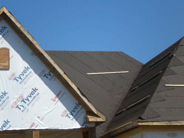

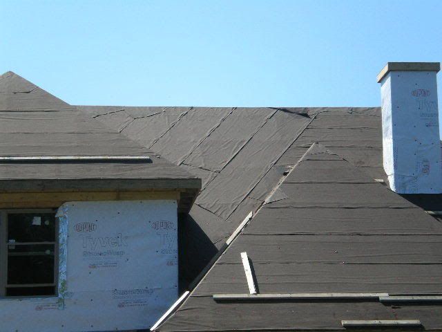

I came across a house under construction this weekend that had lots of water on the concrete floor inside, as well as pretty wet (on the inside of the house) exterior wall sheathing (OSB) even though house had been wrapped in Tyvek.
Upon seeing the roof felting job I wondered if the water didn't come in under the diagonal edges of the felt.  I don't think there is any horizontal layed felt under the diagonal.
So, is this just real shoddy construction, or is it maybe an actual code violation.

 Look shoddy to me,  most of the felt is running properly,except that diagonal stuff. It appears thats it's been on / exposed for some time,  as does the Typar, the facia and rake boards.

As far as code violations concerning paper and felt , yes maybe  BUT I've never seen a inspector "inspect" any of that. I fact a a meeting back in 2003 with local builders and the  building code officials some one asked about them inspecting Vycor / paper issues and they all said (three jurisdiction's )  " No , we expect you guys to do that , as you'll be the ones getting the call backs IF there are issues". So I highly doubt that aspect gets inspected normally.
Shoddy.  :o  The IRC states that underlayment felt shall be installed parallel to the eves, starting at the bottom and going up the roof with a minimum 2" overlap.

Can't disagree.  The Hip's look like it was done right but the main definitely looking for disaster.  If the valleys were not overlapped the correct way with the wrong direction it would sort of be like a funnel.   It would be interesting to see how they run the shingles. ;D

No, guys this is NEW construction in a very nice subdivision, and supposed to be by a "custom" builder (at least that's what the sign in the front yard says) and built on a golf course lot.  Windows and doors are already installed and high end quality.  Yes, the area got about 11" of rain from Gustav, but where the water got in and wet the OSB sheathing the windows were closed.  There are obvious water marks on roof truss bottom chords as well as floor joists between 1st and 2nd floor.  The roof decking is the type of OSB that has the foil "radiant" barrier on the inside.
