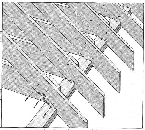

You don't say but is this a single story cabin?
If it's a single story all you need is to have the ceiling joists sit on top of the top wall plate. Toe nail them in to the plate. The rafters would also sit on the top plate, adjacent to the joist, toe nailed to top plate. The rafter and joist would be face nailed to each other, as illustrated below. That would be the usual method. H1 or H2.5 Simpsons could be added as desired/needed.
Drawing from Wagner's House Framing, available through this link...
http://www.countryplans.com/books.html
It's at the top of the list and an excellent reference.

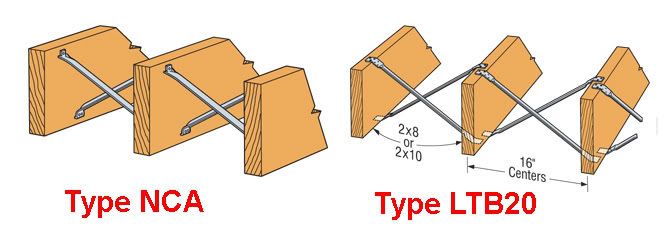

I haven't decided what type of bridging I'm going to use. I'm going to have one row down the center. It'll either be (a) solid blocking, staggered for ease of nailing, or (b) Simpson bridging as illustrated below... Here I face my dislike of the cost of the Simpson vs the sheer convenience. I could probably have all the Simpson bridging in place in less time than it would take to cut the 2x10's accurately.   :D

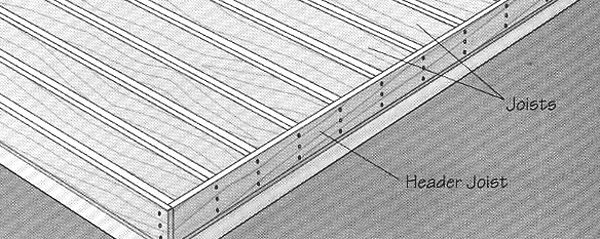

As for the rim joists they'll be much like this illustration... (each joist toe nailed to the beams with probably 4 nails. Plus cross bracing from posts to joists, nailed, maybe even lag screwed.
I've seen that corner as shown or reversed (lengths like the inside joists). Then apply the subfloor sheathing. Build on top.

Hi Don thanks.  Any idea what the Simpson cross braces cost each?  How many do you need?  I would think that maybe two locations on the joist pair maybe?

Price? Not sure  ???  I've seen them someplace around here...
On a 16 ft joist you only need a pair criss-crossed in the center of the joists.

A simple butt joint placed over the end of a joist is all that's required, the nails angled into the joist.

Cheaper then I even thought possible  :)
Try and buy wood for that. Cheaper enough to go hog wild and put them at 1/3 and 2/3 if one was a real worrier.  ;)
